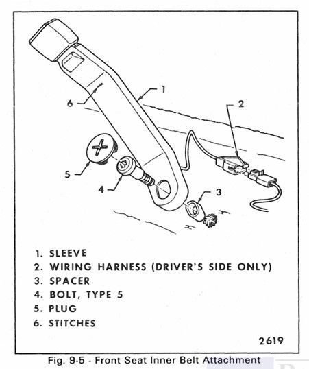

Yeah, I saw that graphic in the service manual. I was trying to get behind it with a pick, so I could press in on one of those tabs, but it didn't seem to want to budge.

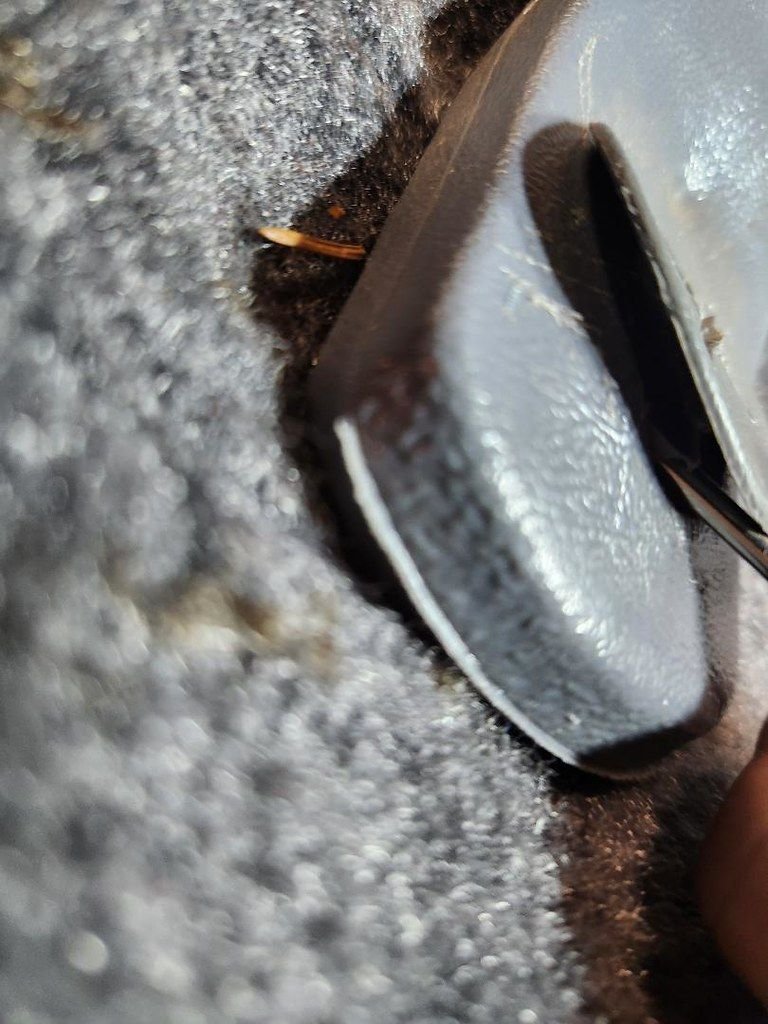

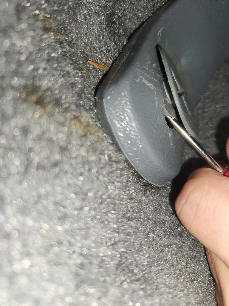

Took a peak behind that trim disc again, and was able to find that "open" spot in the disc that goes inside the sleeve. Again, signs that someone has been in here before with those scratches in the plastic.
Was then able to lift the edge of that gap with a small screw driver.

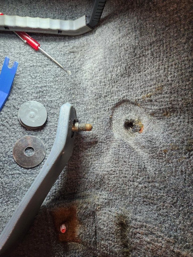

Using this large stainless fender washer to turn the slotted disc (it was a near perfect fit by the way) while keeping the screw driver behind that inner disc, I was able to "unscrew" the cover.
And out she came. For future reference, here is the backside of that round trim disc that covers the bolt, and you can see the gap in it.

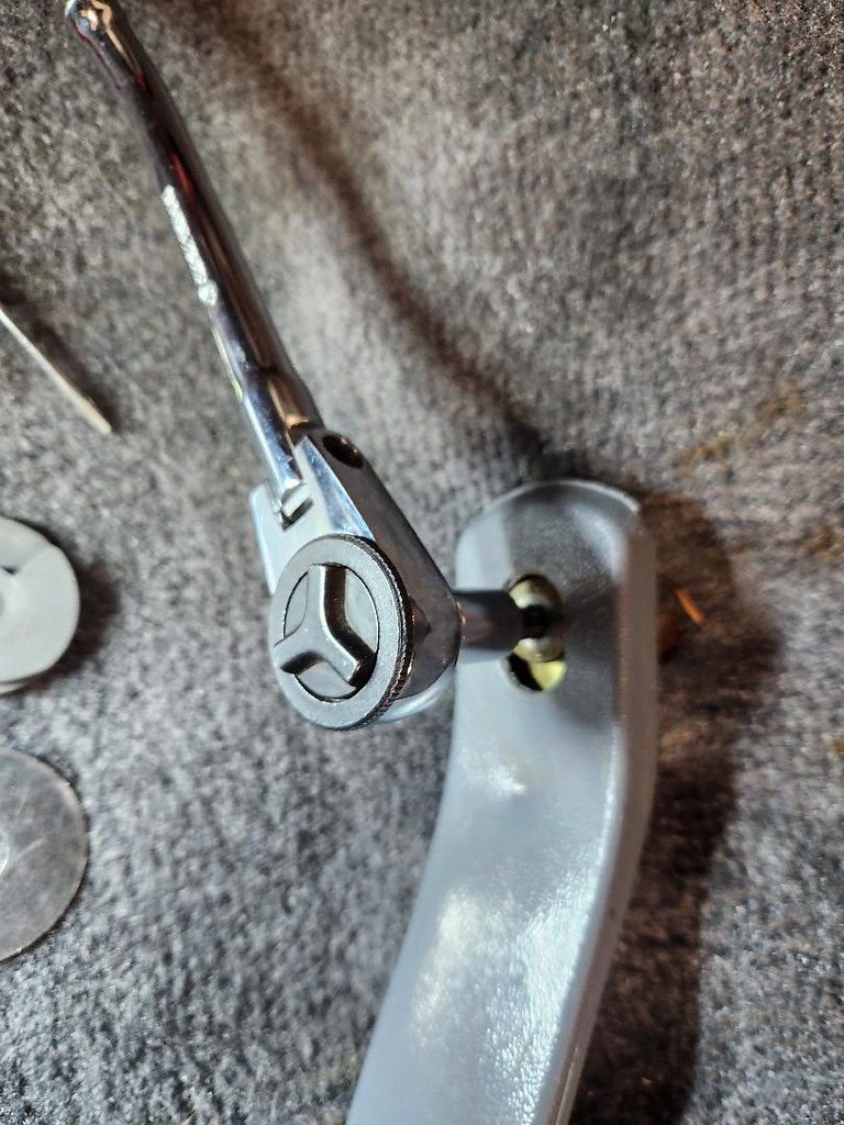

Out with the Torx bolt that holds the buckle to the floor (T50).
No issues.
