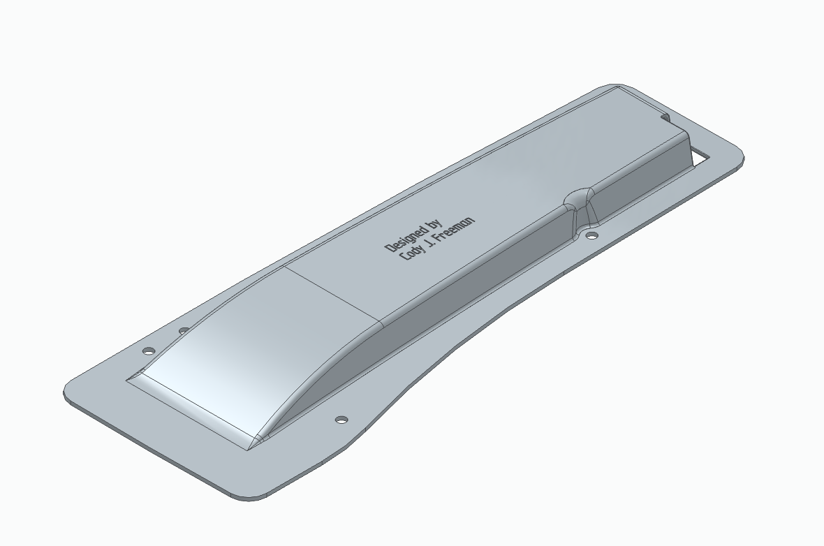

Anyone want a replacement center console lid base plate? It's not perfect, but it is pretty darn close. This one didn't take too long, and It is just a starting point for the modifications I intend to make for my full console anyway, so file is available upon request. Only requirement is that you don't sell reproductions.

Would a guy be able to take the broken Hawks one he has and use this to make it a working center console lid?

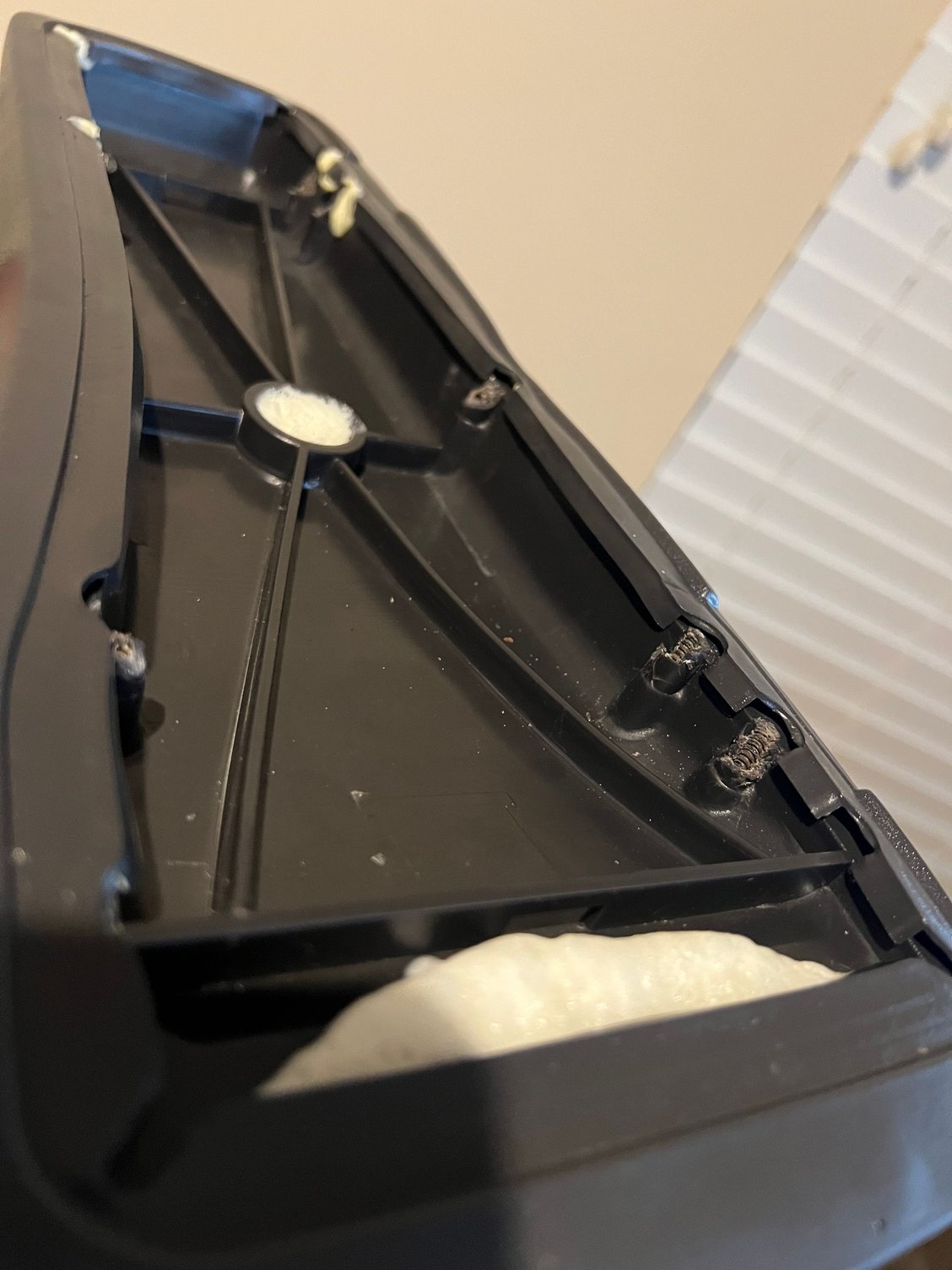

Depends on how yours is broken. If it is just the base plate that is cracked, then sure. That's why I made this model.
If it is the upholstered top that has stripped out threads, or if your issue is with the metal arm, probably not. I am working on a solution that would use a Dremel and epoxy though... Not sure how it would hold up.

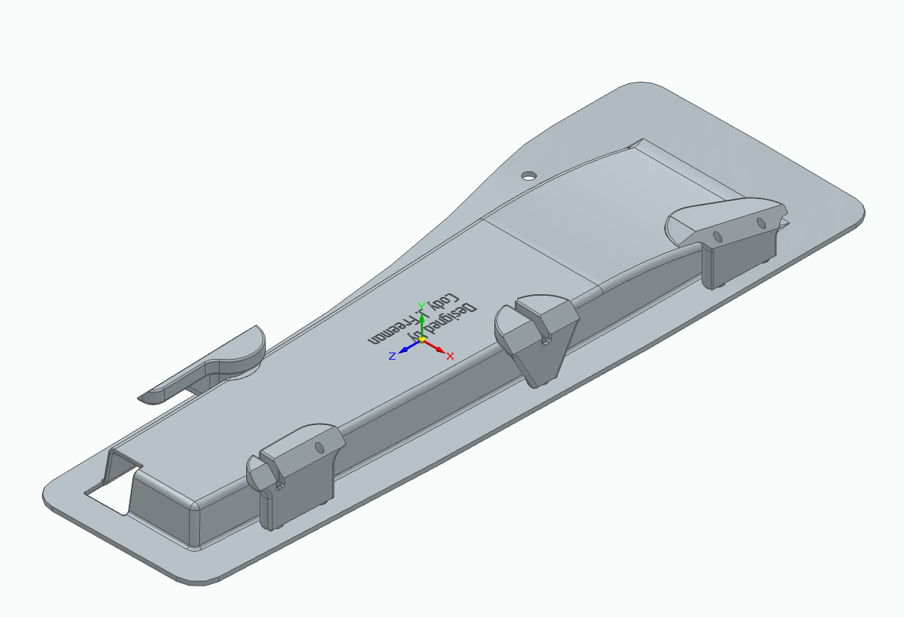

Something somewhat like these parts. I'll try printing these off and messing with my existing sh!tty console lid at some point here. Still need to do one more part.
