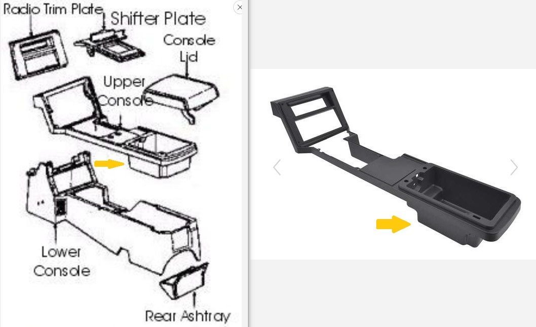

Re: Reproduction Console Top Quality
The step or bump (arrow) on the glove box is for the spring on the later "ratchet" style e-brake handles. The spring is all the way to the right and gm could've just added a bump on the corner, but whatever. The early type i believe the spring was mounted differently. So the step is not necessary. That said, i modified the spring mounting on my 89, so i could use my 84 upper console.
Well dang. I've had an '89 and a pair of 92's. Shows how often I look in the console, lol.
I only noticed it was different when I tried to put the console top on. Can't see why GM put the step all the way across. That space is rather limited to start with.

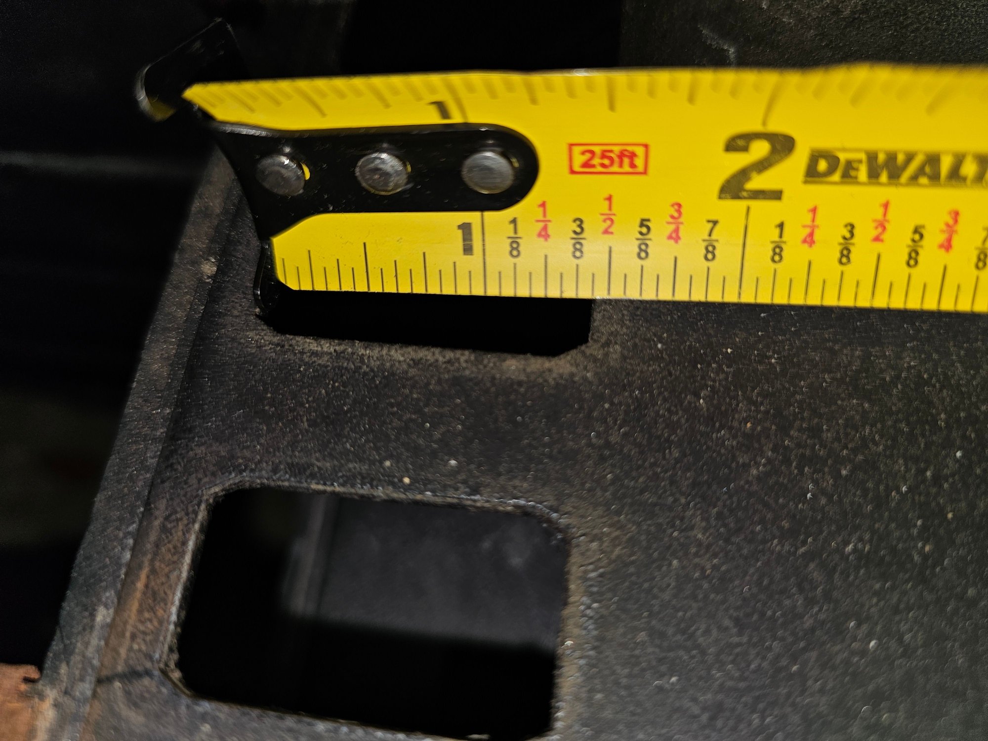

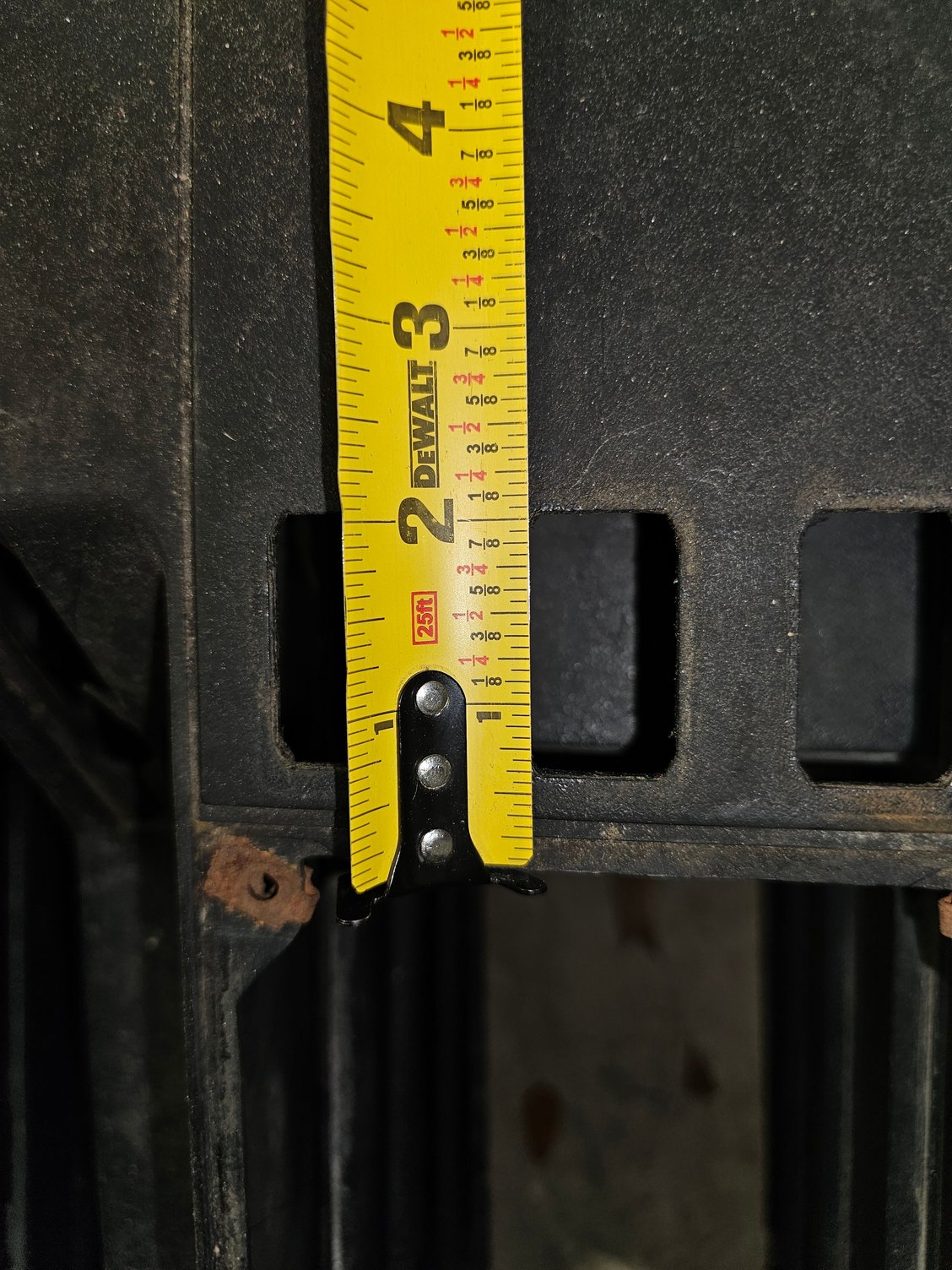

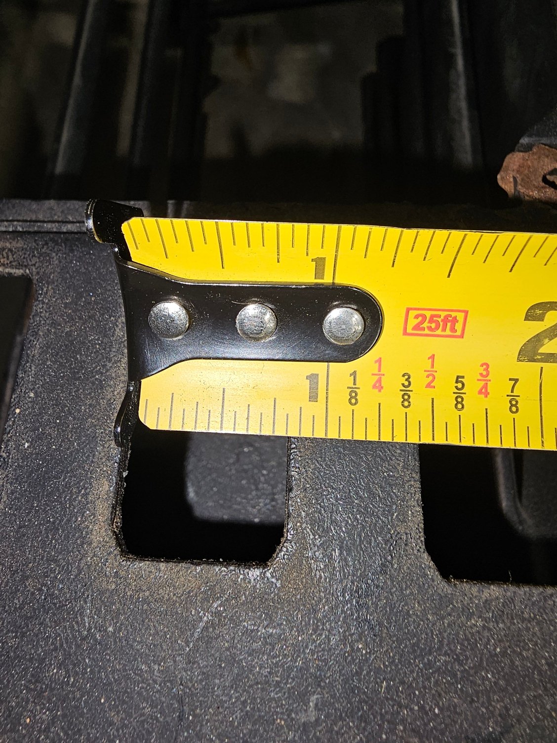

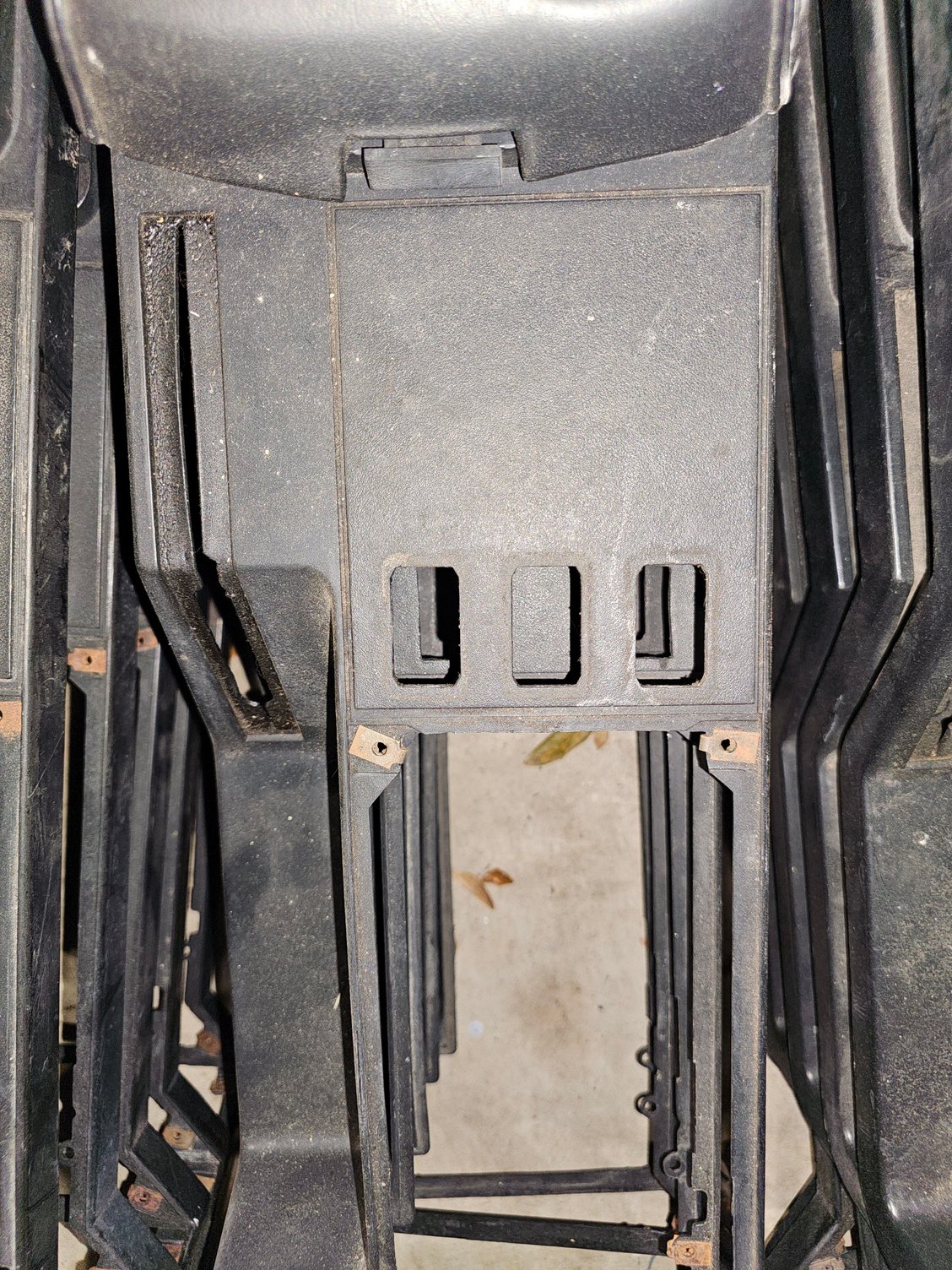

Well, I decided to get an NOS upper console. I didn't want to experiment with the repro units.
Now, I need to cut out the switch holes. I did this on my original years ago but it was a little sloppy in the fit department.
Can anybody provide a photo of the cutouts on a factory console looking straight down?
Old Feb 20, 2026 | 11:25 AM
Bald_eagle_machine's Avatar
iTrader: (8)
Joined: Jun 2014
Posts: 81
Likes: 47
From: Chiefland, FL
Car: 1988 Trans am GTA
Engine: L98 350 TPI
Axle/Gears: Factory 9 bolt w/disc brakes
Here you go.... couldnt ask for better. Sorry i dropped the ball about sending you my consoles. I have a feeling you are chasing perfection, and my consoles are all used, so they probably wouldn't have fit the bill.
Old Feb 20, 2026 | 11:29 AM
69-er's Avatar
Joined: Oct 1999
Posts: 688
Likes: 225
From: Alamogordo, NM, USA
No, don't worry about it all! I would have been the one to contact you if I was going to go with a used unit.
Thank you so much for the measurements!
