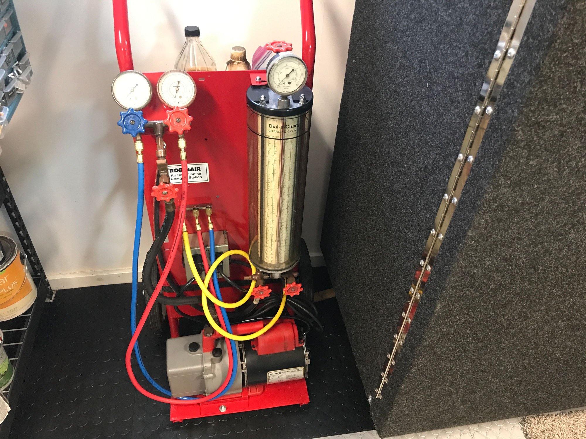

I got this, just restored it, I’m set now.
