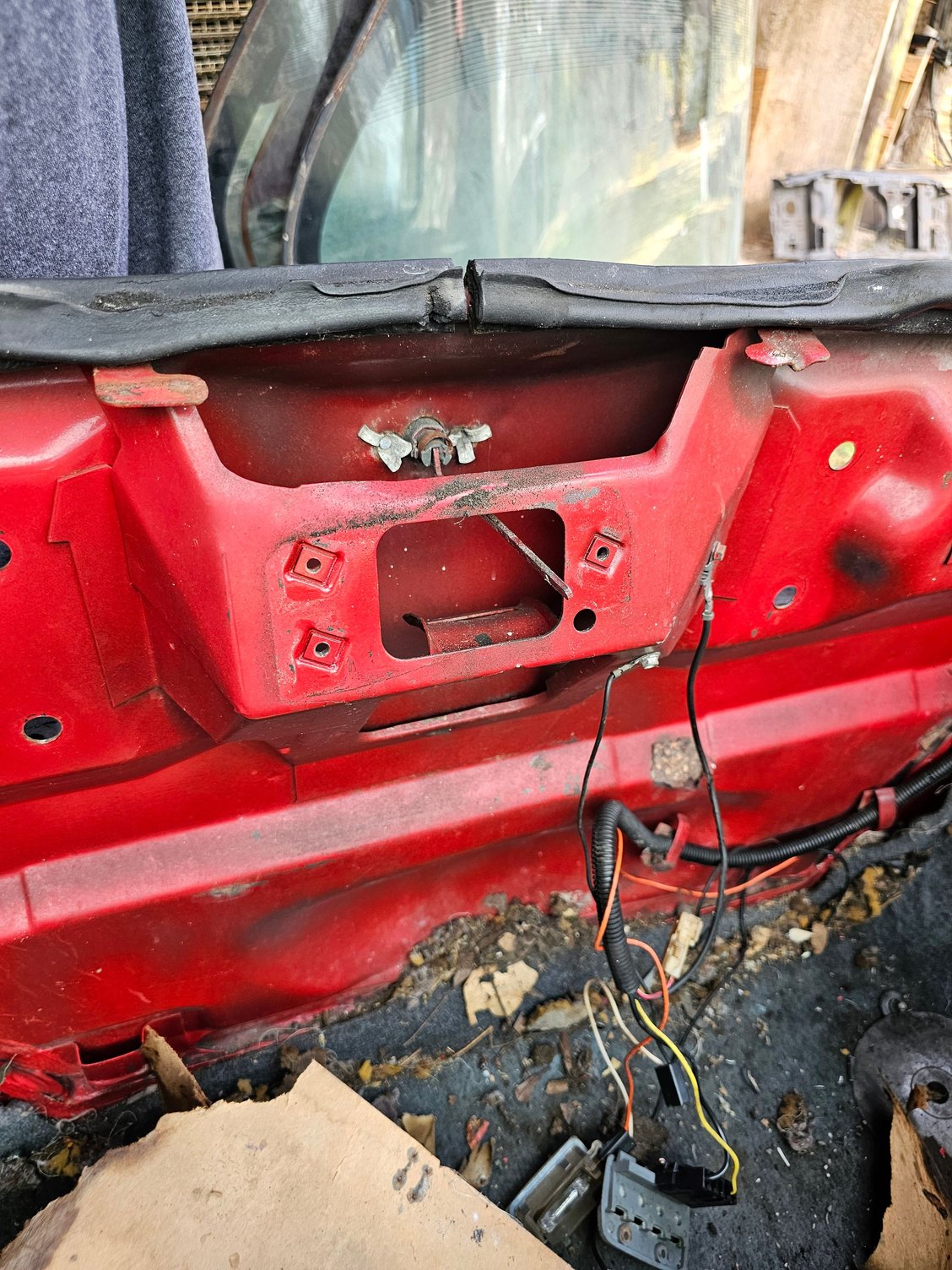

This is the bracket that the 86+ PPD hatch motor gets mounted too:
While I do not have a picture of the 82-85 "manual" Hatch Release Solenoid bracket,... the bracket that was used in 82-85 was NOT the same as the one needed for the 86+ PPD motor. So; to install an 82-85 Hatch Release Solenoid you would need to drill the spot welds from a 82-85 bracket, Drill the spot welds and remove the bracket from the 86+ body, and then install the 82-85 bracket in it's place.
Most guys in your situation that don't want to repair their PPD hatch motor don't want to do all that work. They simply find a way to forever secure the PPD motor in it's lowest position (drill a hole & bolt it in place forever, weld it,.. what-ever )

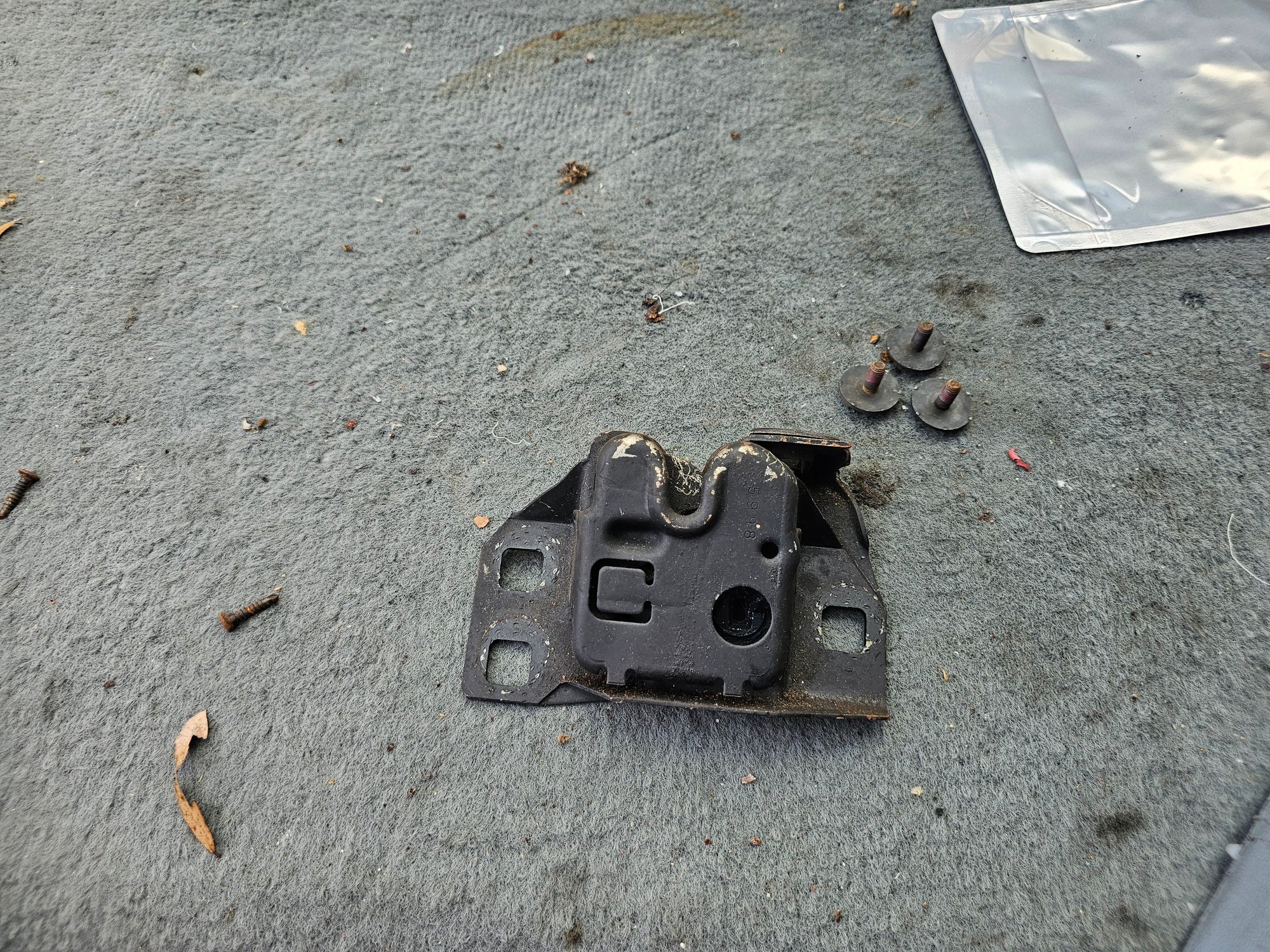

Ill have to get a photo when i see my friend. He drilled out the rivets for the latch from the power pulldown and bolted it to a plate with 2 bolts that mount to the factory pulldown holes. time consuming but you use what you have.
