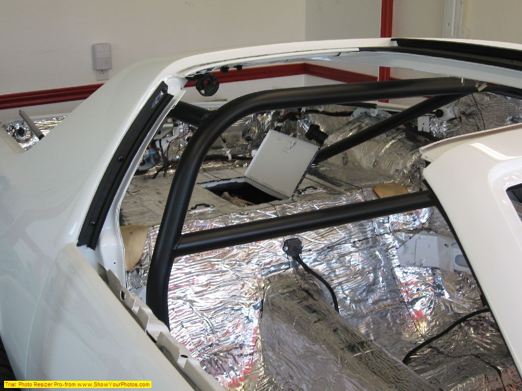

OR...you can make a fuel pump door like some people have. You will get a 50/50 mix of opinions on doing it. My thought is if you do it right, it can work and be very useful if you need to pull the pump again.
J.[/quote]
This is "The right way". I have never looked back on this mod.

Spike-z...that looks fantastic! Do you have more pictures...or a write up on your method? I love the hinge, and what appears to be a rotating latch. Youre right...thats the way to do the trap door. Put a rubber seal around it, paint all exposed metal, and it will last just as long as if you never cut it.
Did you cut your carpet to allow it to open? Or do you still have to pull the carpet up. I still think even if you have to do that, its still 100 times better than dropping the tank. 1000 times even.
J.
EDIT...spike... once I blew up the picture..I could see it better. IS that an electical breaker box door??? That has a nice flange all the way around it?? Or something similar...
