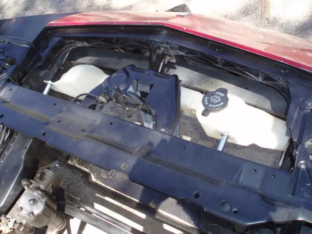

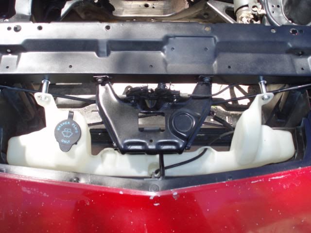

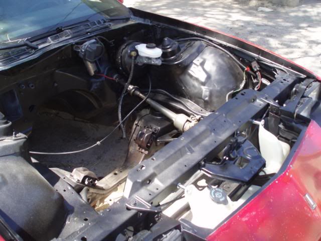

Originally Posted by New2Chevy
I decided to use the 4th Gen washer fluid reservoir. Check it out:
It fit in there like O.J. Simpson's Isotoners, though.
I stumbled across your thread and never realized the 4th gen reservoirs were a mod we could do! I'm re-routing my intercooler pipes and these two mods would really help open up room and reduce clutter! My only concern with the washer reservoir is whether it'll interfere with a FMIC...will have to get some dimensions on it. The radiator overflow is money, previous owner just had a makeshift catch can off to the side. Any tips or things I need to look out for installing either of these?

Hey. I'm not sure if the reservoir will interfere with the intercooler or not. I don't think it would because it is mounted high up, at least, on my car.
