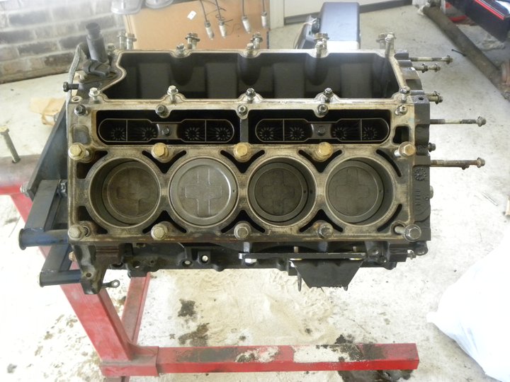

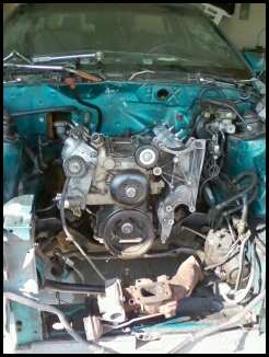

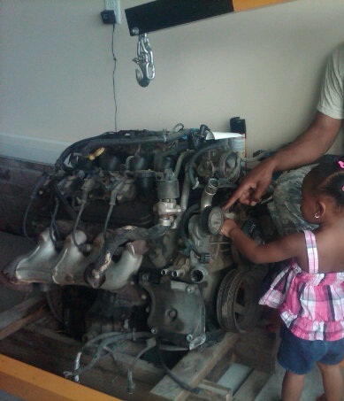

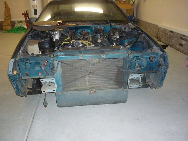

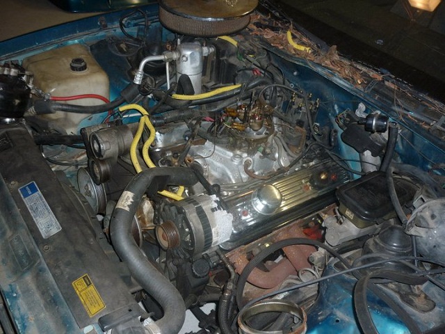

This is what i started with. 305 tbi I managed to get this heavy car, with a 305, stock heads, 350 cam, and headers to break 15s in 1/4 mile (15.7 best time). Now i needs more power. And little girl wanting to learn engine
Attached Thumbnails Another 5.3 engine swap-c.jpg   Another 5.3 engine swap-c2.jpg   Another 5.3 engine swap-untitled.jpg

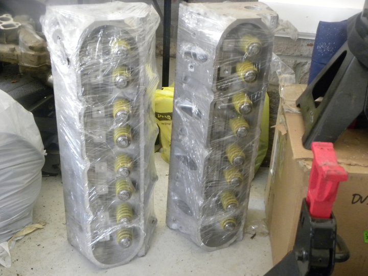

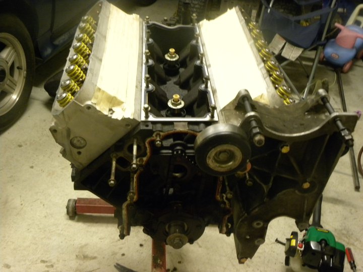

The heads have ls3 2010 camaro valve springs rated for .550 lift. But i got a ls1 00 cam specs rated at .500 for next to nothing. May upgrade to a z06(.525) later. Want to see how this one works first. Alos my son getting his hands dirty as well.
Attached Thumbnails Another 5.3 engine swap-block.jpg   Another 5.3 engine swap-heads.jpg   Another 5.3 engine swap-untitled1.jpg

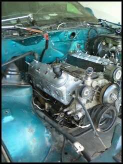

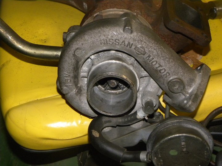

Mostly put back together, got 2 of the nissan skyline turbos while i was in japan. Came off of my skyline, which i blow the the engine due to my friends mis information. " Nissan never made and interferance engine" bull. ( valve Timing off turn engine over boom) Turbo look good. If anything i will use this a mock up ones and upgrade later. Just shooting for 5 psi for now. Should have brought my nissan gtIr pulsar (sr20det awd)back. Or do something different like a rb25det swap in my third gen. But love that v8 rumble.
Attached Thumbnails Another 5.3 engine swap-work.jpg   Another 5.3 engine swap-rebuilt.jpg   Another 5.3 engine swap-turbos.jpg

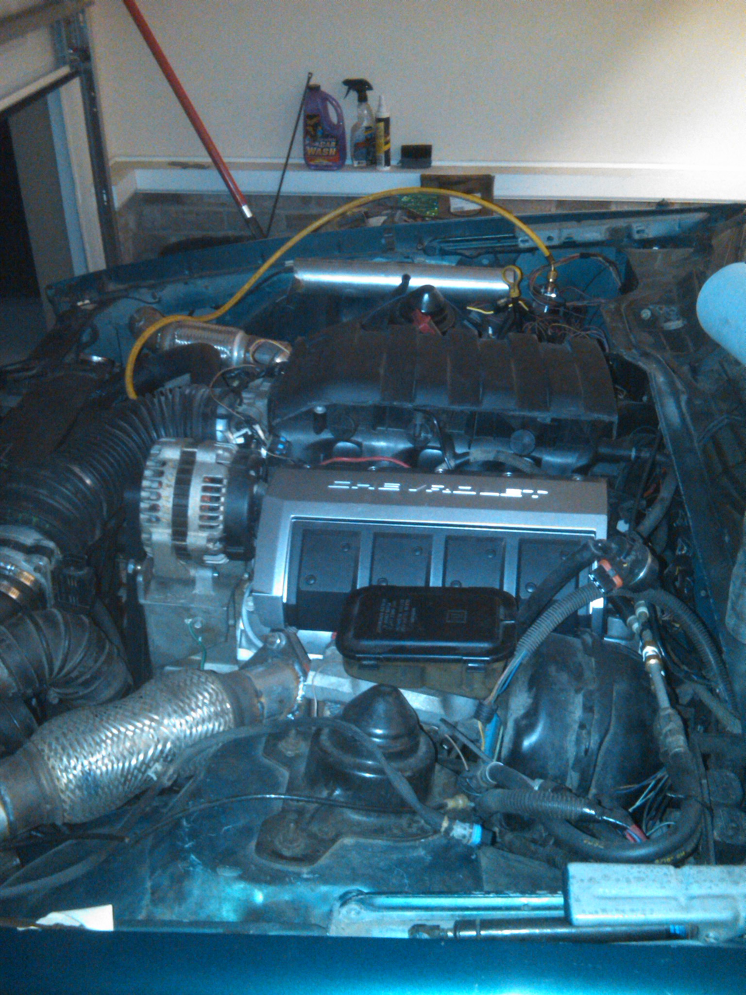

After struggling to line of the custom motor mounts with the tranny bolted up, for hours. Finally in
Attached Thumbnails Another 5.3 engine swap-engine-bay.jpg   Another 5.3 engine swap-engine.jpg   Another 5.3 engine swap-e3.jpg
Old Nov 11, 2010 | 12:02 PM
Willie B.'s Avatar
Joined: Dec 2008
Posts: 224
From: NC
Car: 91camaro
Engine: 5.3

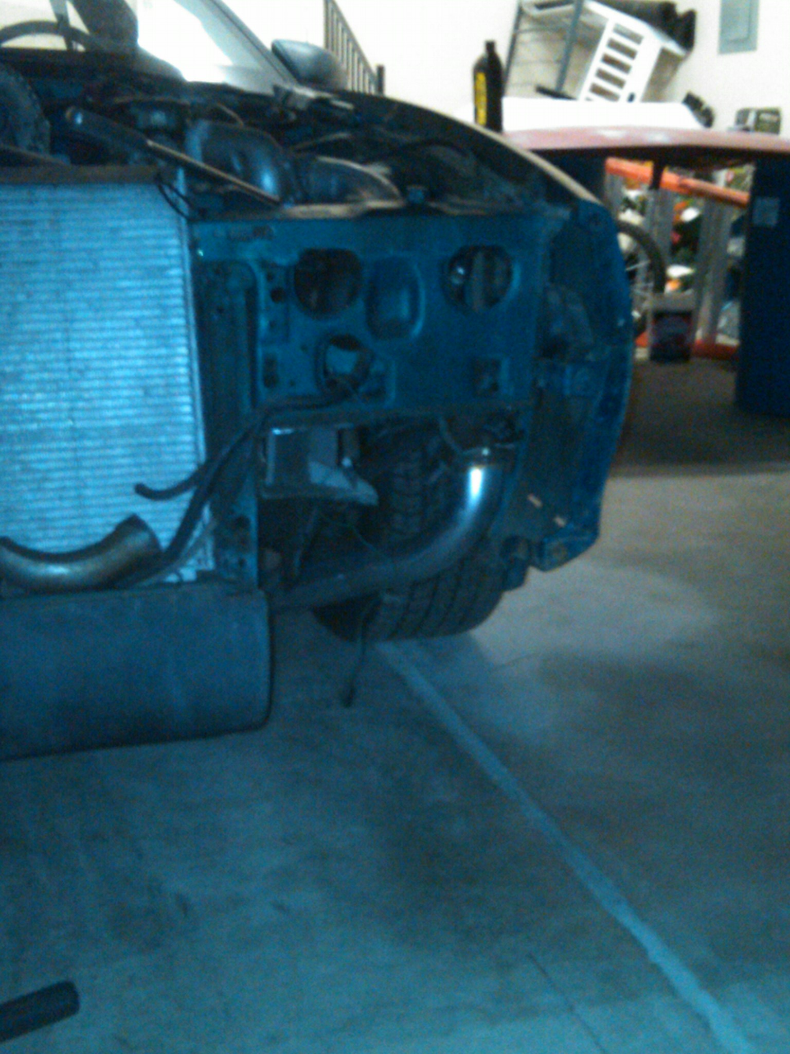

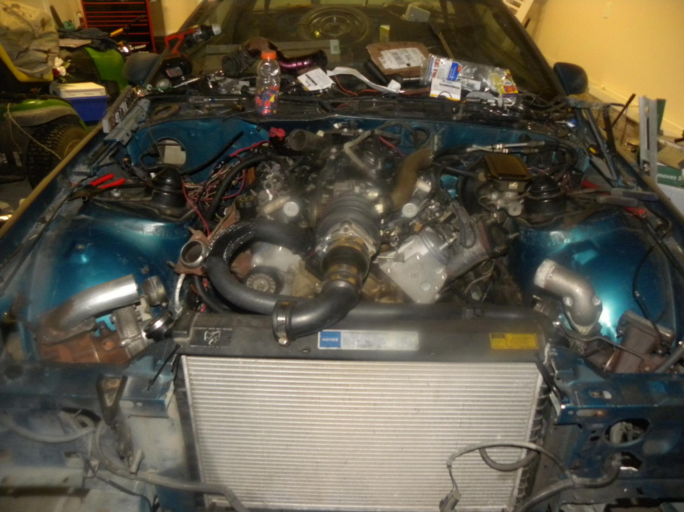

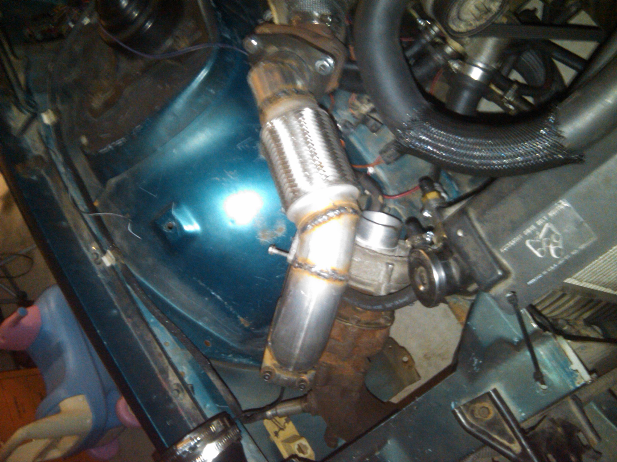

Decide to mount the turbo in front out of the engine bay. Also decide to keep the truck intake and mounting hardware i wanted a cowl hood anyway.
Attached Thumbnails Another 5.3 engine swap-engine2.jpg   Another 5.3 engine swap-turbos-mounted.jpg

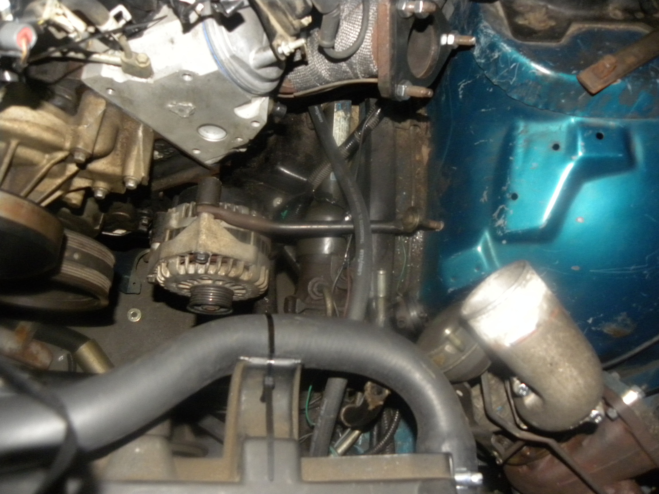

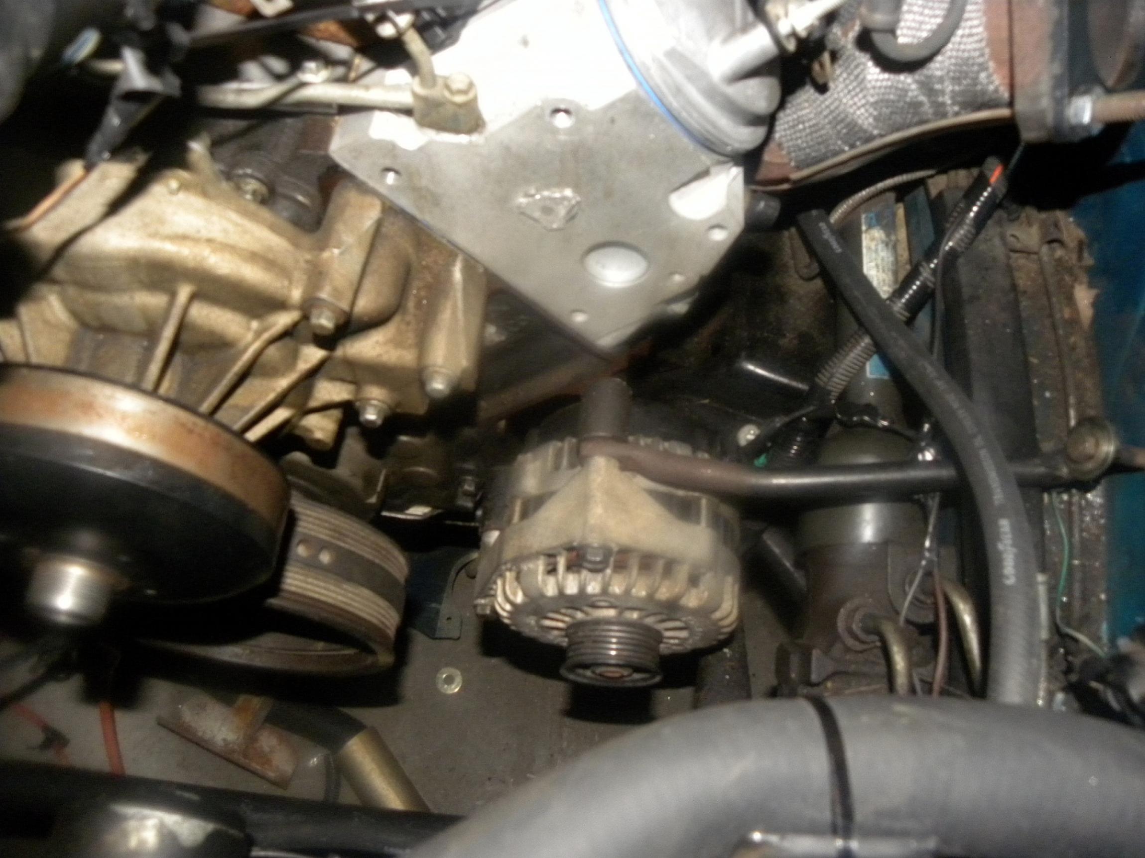

Relocated the alt so i can use that cowl hood. So what you guys think? Think it will work? I used a straight edge to get the alignment right and use that bracket from my 305 for extra surpport. Also mounted the turbos inside the engine bay so i woundnt have to use a salvage pump.

Is the alt mounted to the fenderwell?

I sure hope that's just a brace that's sitting off to the side for the time being.

No its bolted straight to the block with the two mounting bolts. I used that fender mount as extra surpport. I was going to have the bolt on the fender welded. @ Zones89rs I would have went sinlge believe me i thought about it. But i already had these turbos and its cheaper for me.

Well, i decided to go back with the truck accessories. I got a hood from the junk yard for $29. And decided to cut it, then get a hood cowl for it. And weld it on or bond it if i go with a fiberglass one. Its cheaper than actually buy a cowl induction hood or ram air. I figure its cheaper to mod the hood than buy the f-body brackets and intake. Intake $50-100 with injectors maybe or maybe not. Power steering bracket $30-$50. Alternator bracket $80-130. Also the Corvette fuel filter and new line $? My choice hood $29, scoop $50-100. Plus weld or bond time, priceless My measurement for the cut was 15" W and 22"L. Well below the scoop measurement. If someone is planning on doing a 5.3/6.0 swap and your planning on getting a cowl hood or ram air. I feel confident say that the truck intake and alt will fit under that hood. Just be sure to check hood measurement, I'm sure a 2 1/2"-4" inch raise will clear.
I hope that means no brace from the alternator to the fender...

Yep no brace all the original stuff that came with 5.3

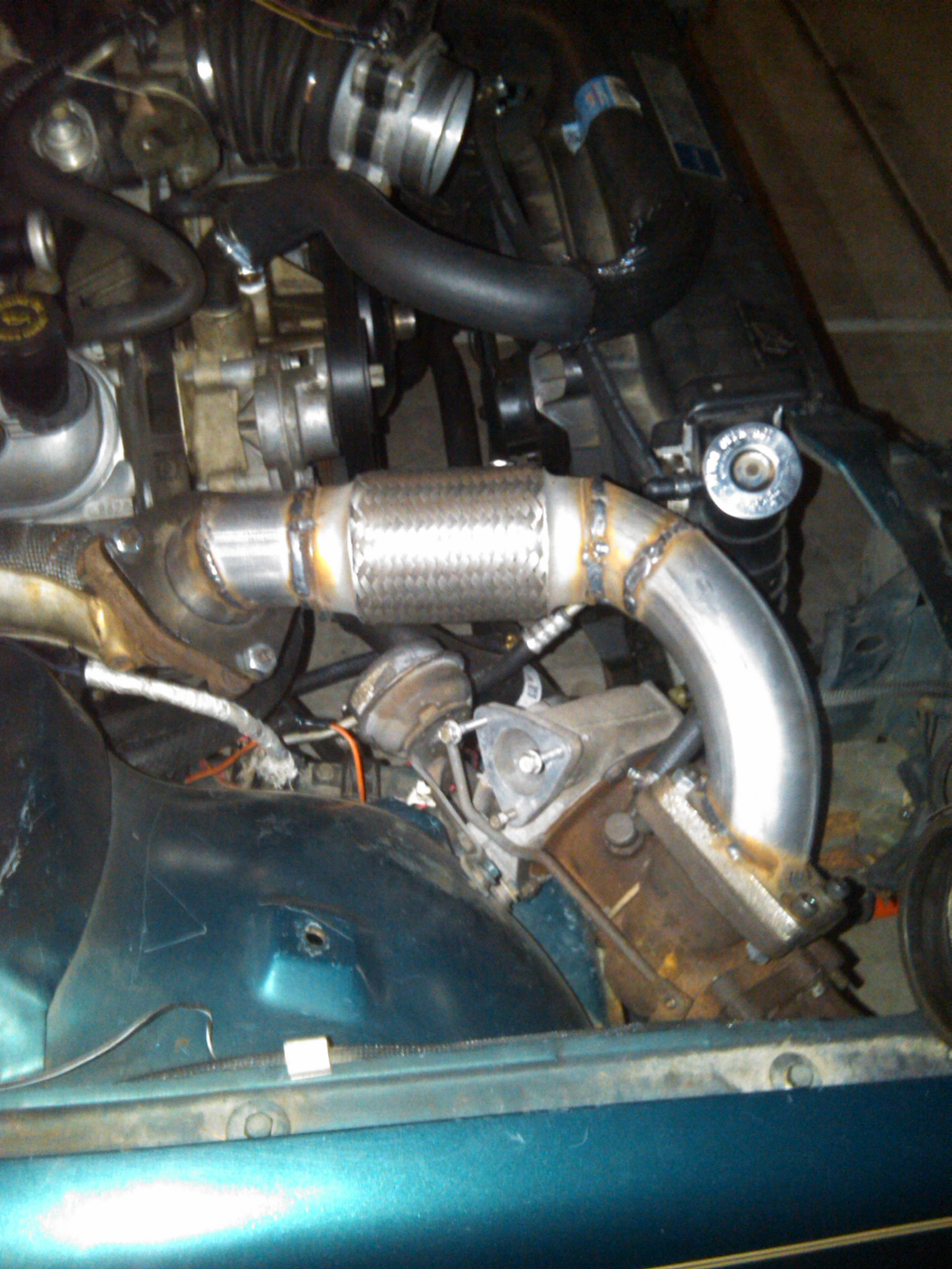

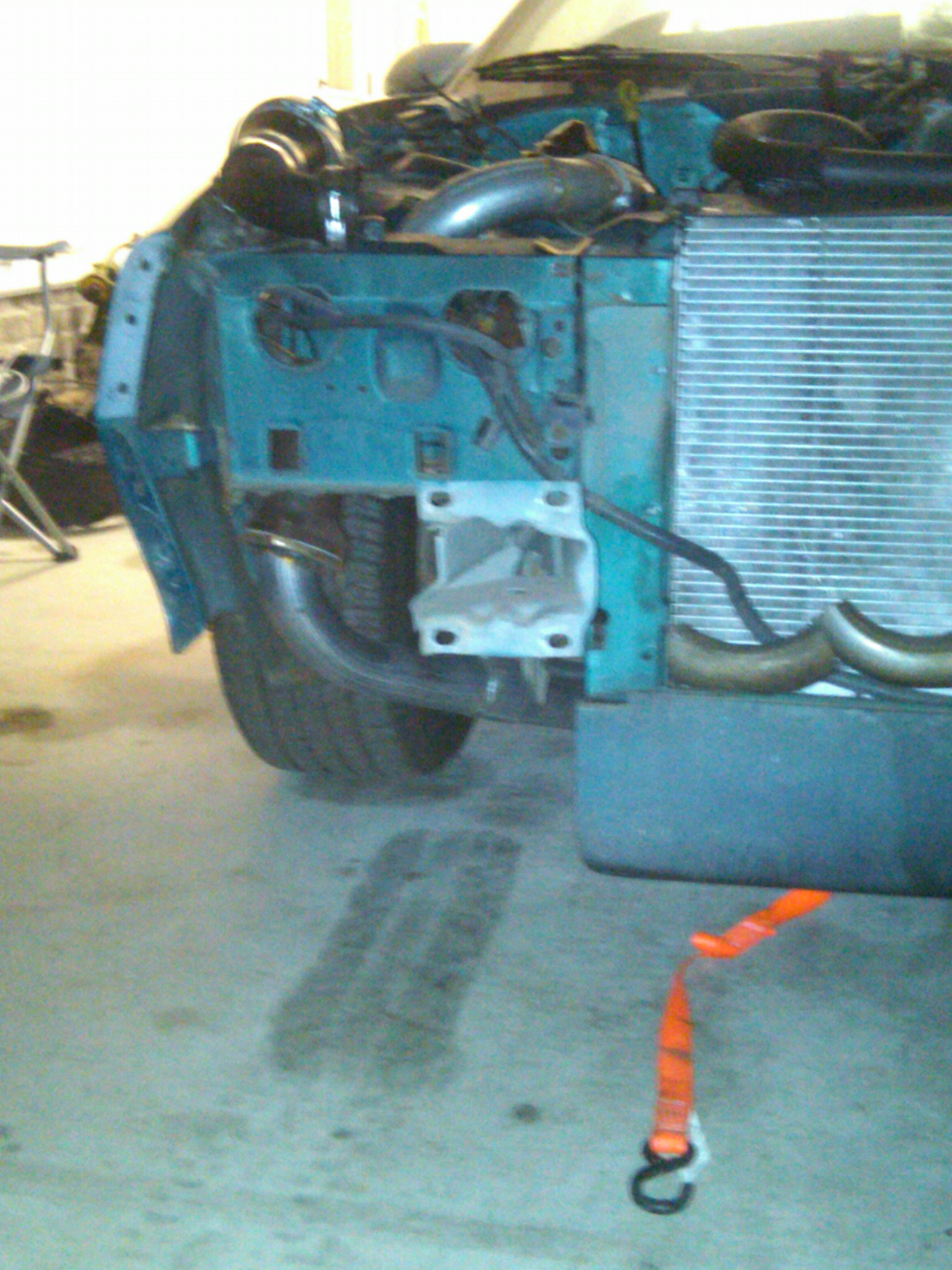

Hot piping for the driver side turbo done. Next is the passenger side, I turned her over before i started the piping I need to check my grounds and voltage to the pcm. It turn over but didn't fire, and i fuel( because one of the fuel lines start leaking when i turned the key on).
Attached Thumbnails Another 5.3 engine swap-turbo-piping.jpg   Another 5.3 engine swap-turbo2.jpg

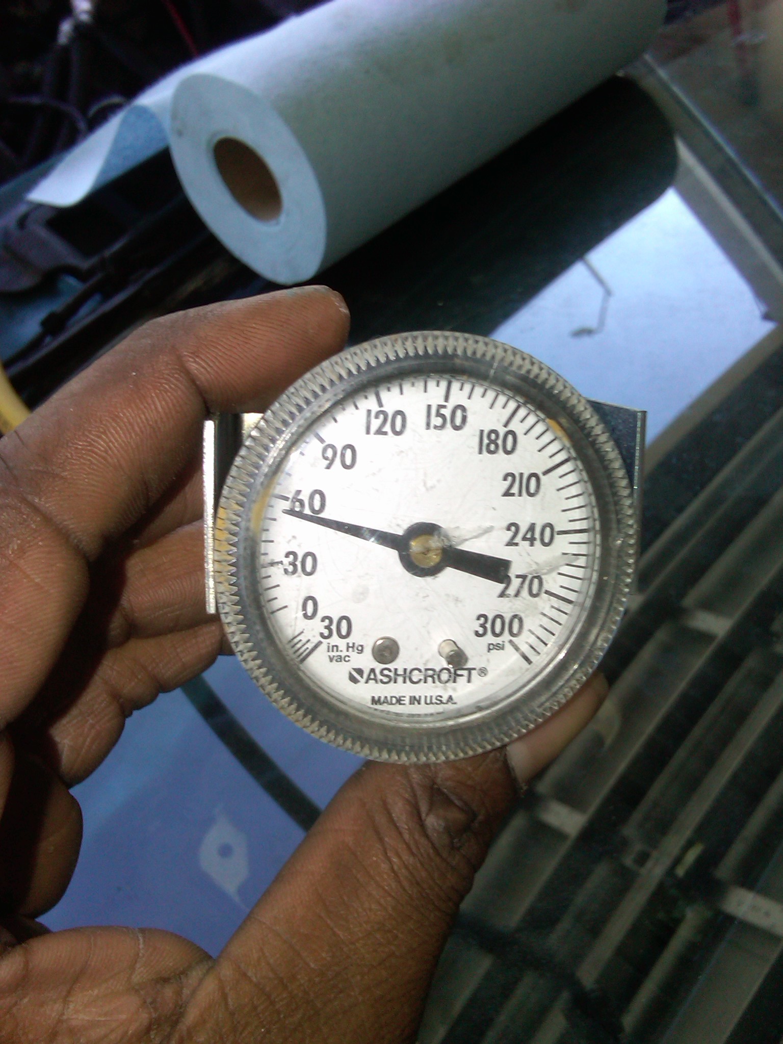

So my exhaust is done, but the car still wont start. Turns over strong, I checked the grounds not sure if have only three grounds have anything to do with that. I had a scanner hooked up to and it read the EGR valve of course since i blocked it. And the other was EVAP. Also i checked for spark(pulled a spark plug and turned it over) it was hard to see since i was also turning the key, but i thought i heard it. Any suggestion.
Attached Thumbnails Another 5.3 engine swap-e6.jpg   Another 5.3 engine swap-e7.jpg   Another 5.3 engine swap-e4.jpg

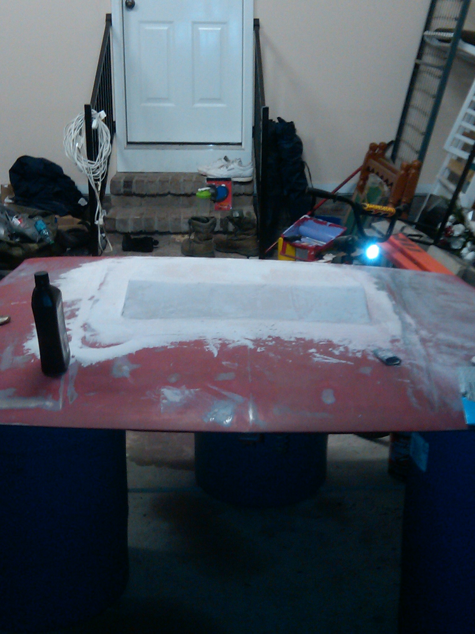

More pics of the exhaust and my hood hope it turns out good if not oh well, i just have to save and just buy one.
Attached Thumbnails Another 5.3 engine swap-exhaust.jpg   Another 5.3 engine swap-e3.jpg   Another 5.3 engine swap-e5.jpg

So I got some starting fluid and sprayed it in there, and it fired off for a few seconds. So that means im not getting fuel, so it would be vats or really dirty clogged injectors. guess i need to rechecked that vats module. Could there be anything else

Did you hook up a fuel pressure gauge to see what kind of fuel pressure you're getting to the rail? How are you regulating fuel pressure? are you using the vette filter? or are you using an adjustable fuel pressure regulator? a fuel rail with a built in regulator and return port? what kind of fuel pump are you running? LSx engines need 58 psi at a minimum to run

Yeah i guess it is VATS. Because my for pressure is right a 60 psi when first which the car to on position. Man thats $30 i just gave to Baker Electroix for nothing.

A shot of the engine covers and the pipe still need to wrap the headers and paint the intake piping.
Attached Thumbnails Another 5.3 engine swap-engine-cover.jpg   Another 5.3 engine swap-intake-piping.jpg
