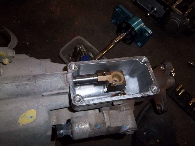

The only things to keep in mind if you're going to use an MN12 is that there is no torque arm mount on the mn12, so you'd have to relocate your torque arm in which a lot of people are buying transmission crossmembers with the torque arm mounts. The other thing is that I don't think you'll be able to use the GTO shifter, no big deal you can just buy any stock/aftermarket f-body shifter and it'll work if you change the cup to the f-body cup. You also have to use the ls2 starter, as the f-body/truck starters will not fit in the bellhousing of the MN12
Here's what i'm referring to as the "shifter cup" it's held in by a roll pin
