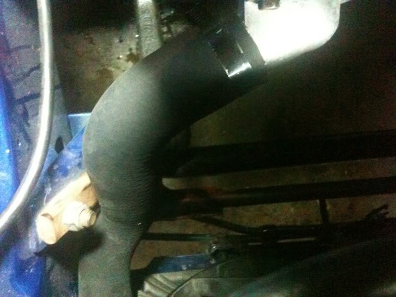

I put the new Dayco 71321 hose on tonight and it looks like we have a winner.
I didn't even measure it, I just looked at the picture that was posted in the link in the 2nd post here, and went off that and made two cuts then I was done
You can see that it is just barely touching the bottom idler arm bolt, I don't think it was going to hurt anything but me being the paranoid person that I am, decided I was going to do something about it...
That's about a 3/4" length of heater hose (whatever size the smaller heater core line is), that I cut off and stuck it over the end of the bolt to keep the hose from rubbing on the threads of the bolt. Like I said, it probably would have been fine because it was just barely touching but I took precautions against the possibility of having to mess with a busted hose.
I still think the flipped 98-02 F-body hose fits better...

that's the air bleed going to a 3/4" heater hose. cant see it but I had made an adapter on the lath using a chunk of brass. turned the ends down and left a flare so they cant slide apart.

with my be cool, i think i need a small metal tube between the idler arm. I thought it was good but appears to rubber more than i thought.
