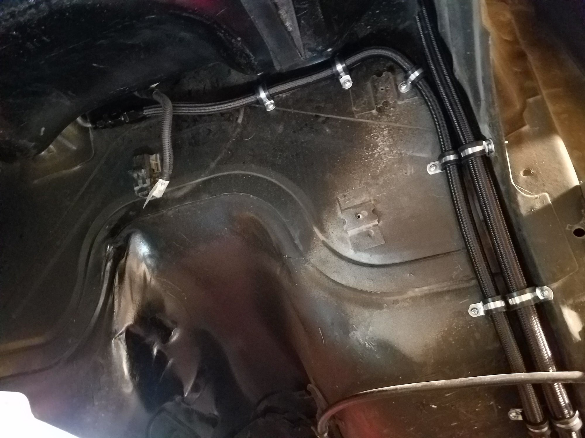

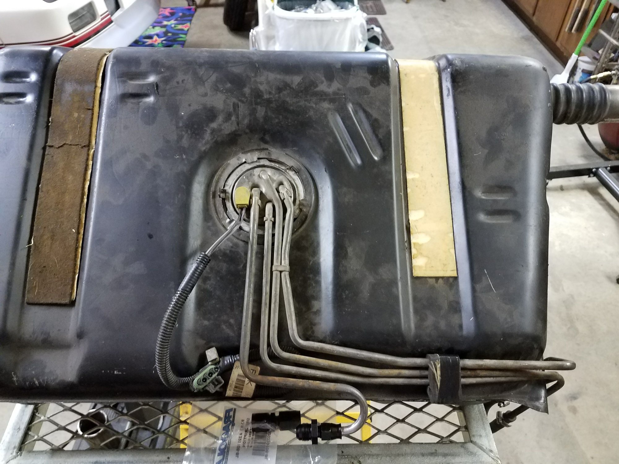

Notice any progress? That's because I'm fixing mistakes. 1 step forward and 2 steps back... My driver side down pipe was in need of a rework after the power steering gearbox and fittings were installed. It was rubbing against the lines and dangerously close to the fittings and the steering shaft. Also the v band to the turbo was rubbing on the inner wheel well.. I couldn't handle it. Had to make changes and I'm glad this night is over. 11pm to 3am in the books. I've powered through till 8am before, but tonight is not one of those nights.

That is a really poor decision to put fuel hose in the wheel well.
Old Jul 14, 2017 | 01:48 PM
I agree. It goes against my better judgement. Its just the best option for me and the lines will be protected by a steel cover. Here are my options and I'm not impressed with option 2 as it would be routing next to hot exhaust pipes. A poor decision was the way they built these subframe cars. The underside layout alone does not favor any sort of sensible routing for much of anything other than the drive train itself. My spohn torque arm is twice the size of the stocker and almost rubs the tunnel now. There is no room for lines there anymore. I'll take my chances in the wheel well for a few inches over routing the lines next to the drive shaft or hot exhaust pipes running down past the firewall. Like is said, the 6 inches of fuel line in the wheel well will be protected by a steel shield I'm going to make. The lines will not be exposed or visible. My skinnies up front won't be near these lines. Can you can suggest a better idea. I'm all ears?

What size is the fuel line?
10 feed / 8 return

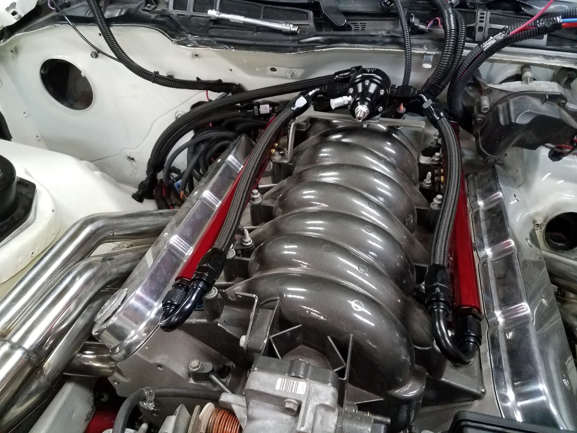

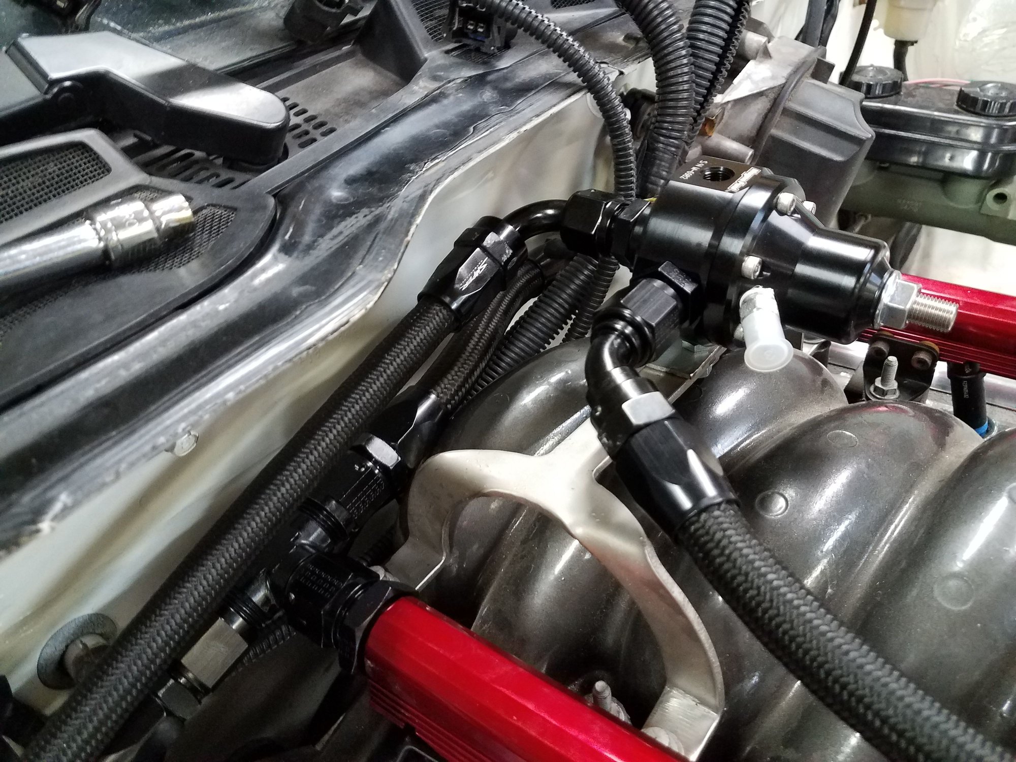

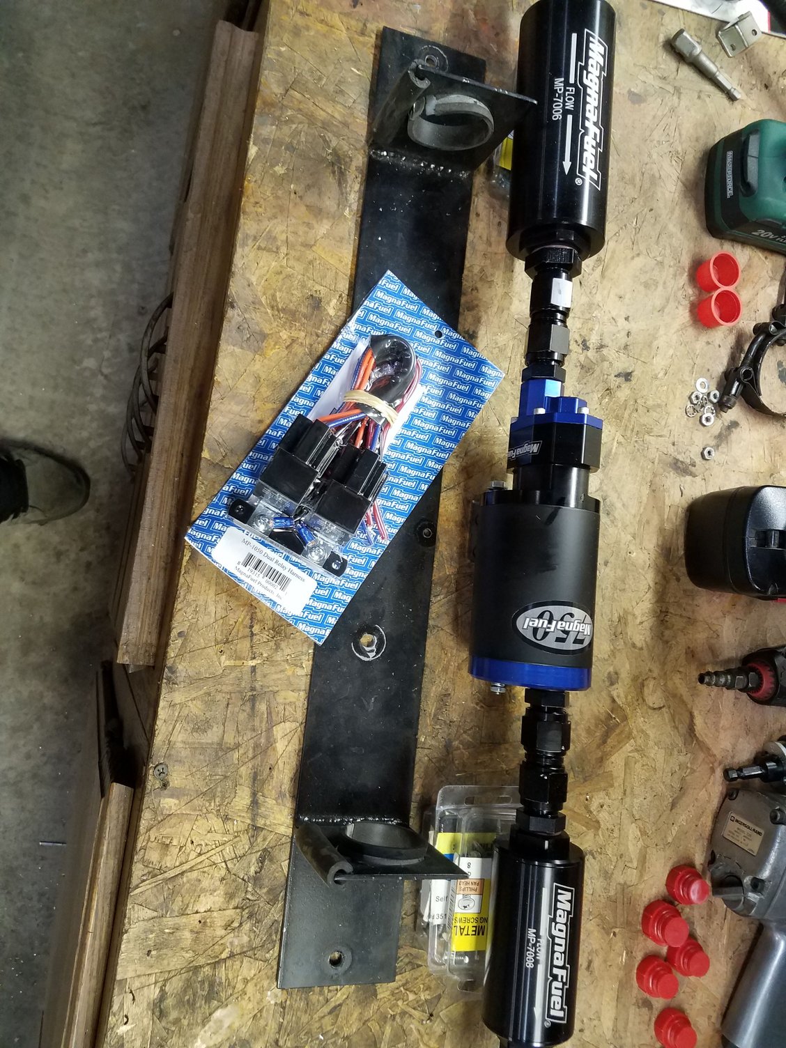

Thank you! After much debate I decided on finishing the fuel system this week. Having trouble posting photos tonight so well see how this works..

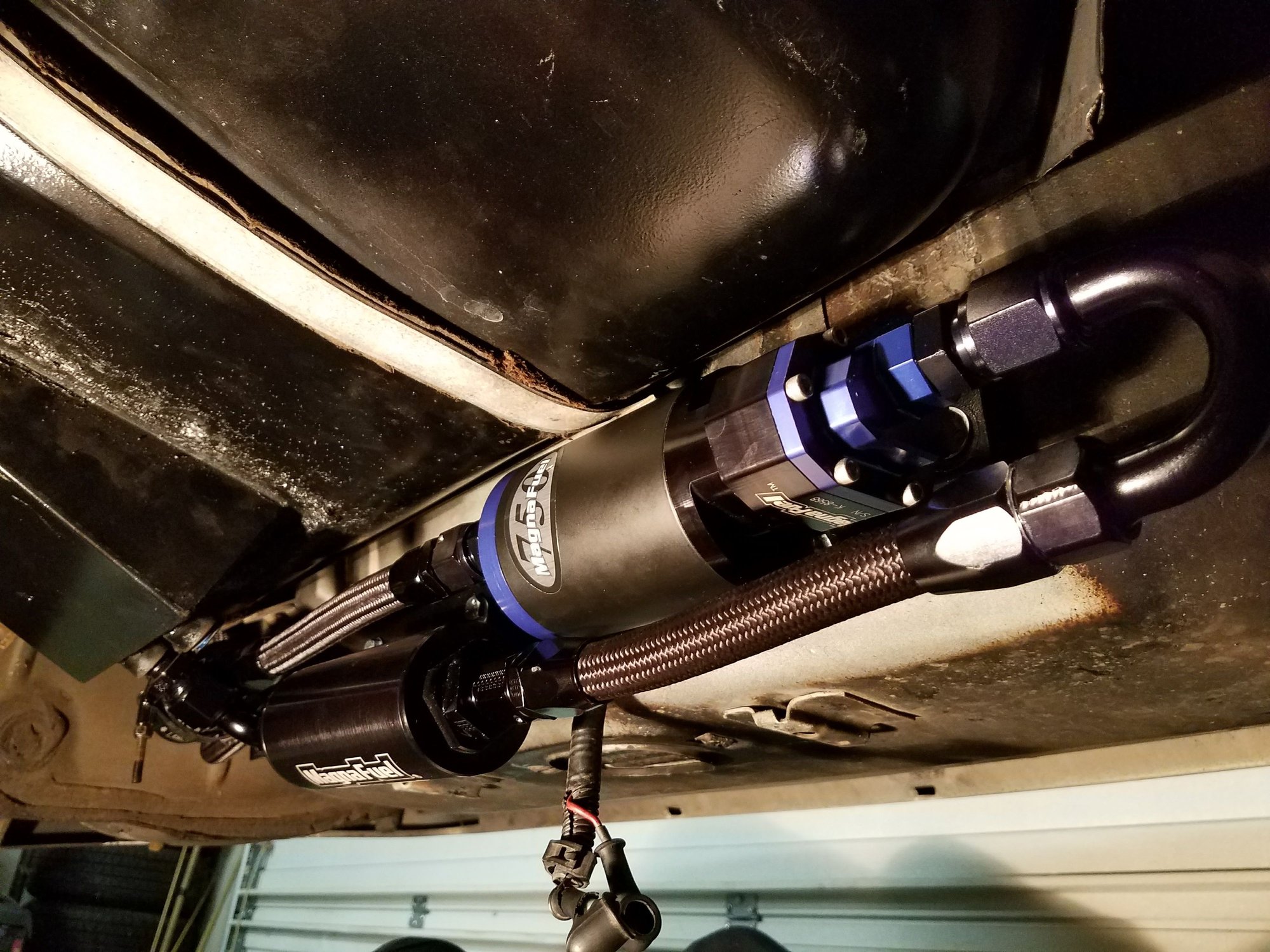

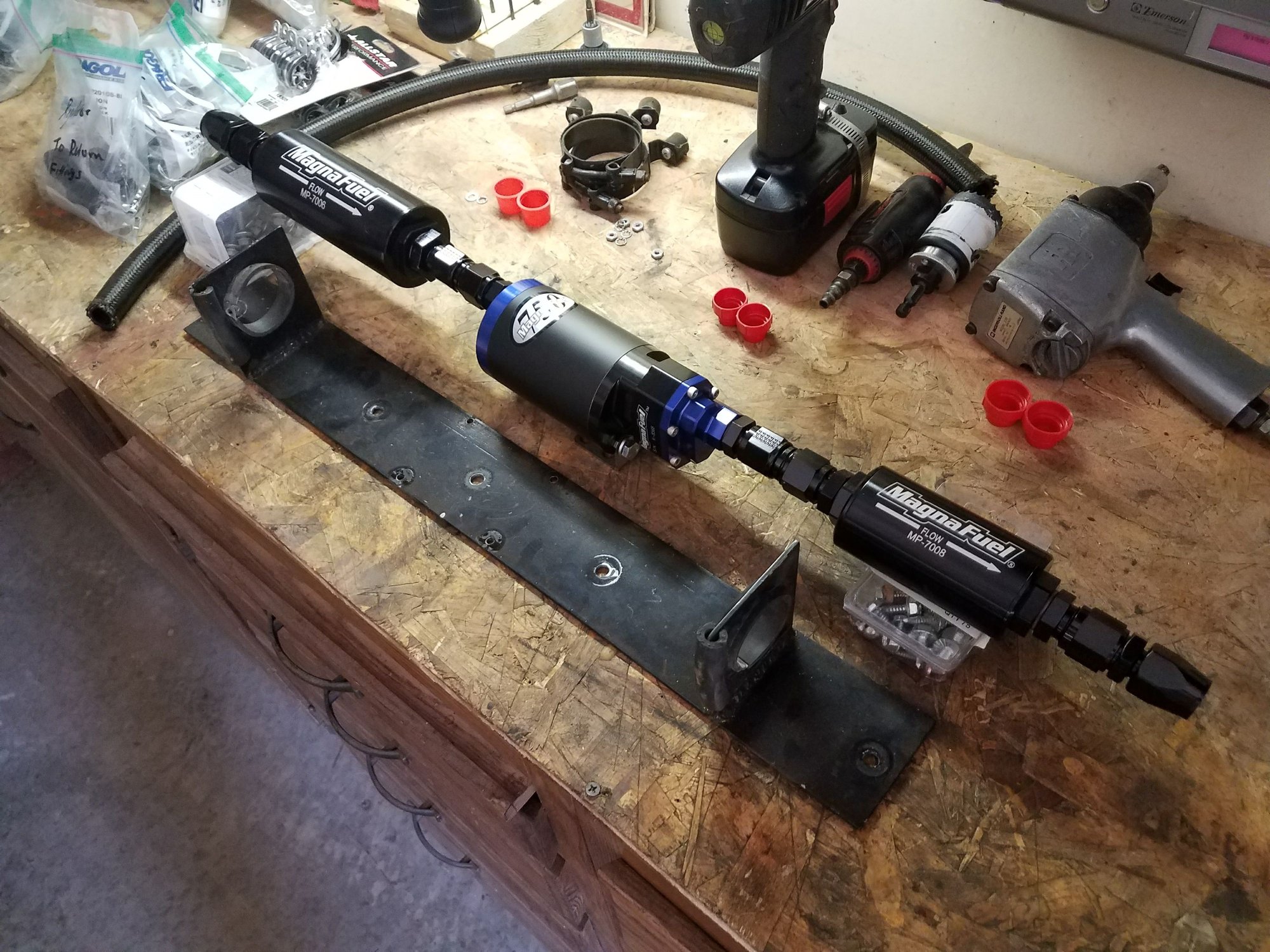

This is how much fuel line actually ended up in the wheel well. This will be covered with a custom fabbed shield. Magnafuel dual relay kit showed up this week. That is my final task of this fuel system.
Moving on to the plumbing of oil lines and coolant lines to the turbos this coming week. Then! The vintage air system is going to be installed! Almost there boys! Tune in next week for another episode. LOL
Magnafuel dual relay kit is worth every penny
