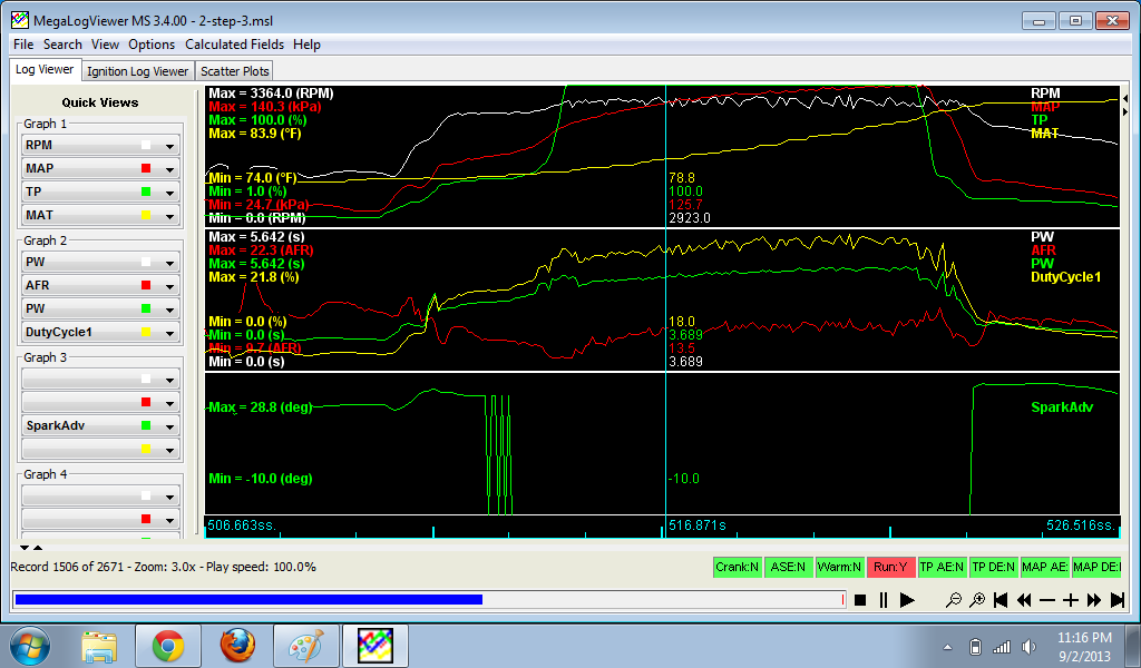

I've tested the megasquirt's 2-step capability to build boost and I think I may be able to build around 4-5 psi on the footbrake which should help my 60'. Now I just have to build the launch control circuit on the board and wire it to a switch. I was going to use the old cruise control brake switch but that isn't working. Thought about puting a pressure switch on a brake line but that might be more hassle than it's worth. I think for the time being, I will put the 2-step on a toggle switch or push button and just release it when I take my foot off the brake.
According to my datalogs, it takes me 2.5 seconds from launch till full boost. It takes about 1.5 seconds to go from launch till 4 psi. So if I can leave at 4 psi from the getgo, I should hopefully be at full boost by 1 second into the launch, well before the 60' mark.

Check out this datalog of the fastest run. Notice max rpm for the whole run is only 5770!!! These motors are absolutely amazing!

BTW when I broke the engine I was going about 10 mph. I had just got the 2-step rev limiter wired up and I was behind a grocery store getting the settings where I wanted for about 5 minutes hitting it on and off. I think what happened was since the launch control retards timing to -10 degrees btdc (10 deg atdc), and cuts spark only, the heavy testing and fuel washed oil off the bores causing the rings to heat up. Then when I made the last test I hit the switch on 5-6 psi and did a huge burnout leaving and I believe the stock rings butted from the heat and dragged the bores causing it to crack the piston ringlands. Will never know for sure but that's what I'm going with after looking at the possibilities.
Here is datalog of a 2-step hit right before it broke.
