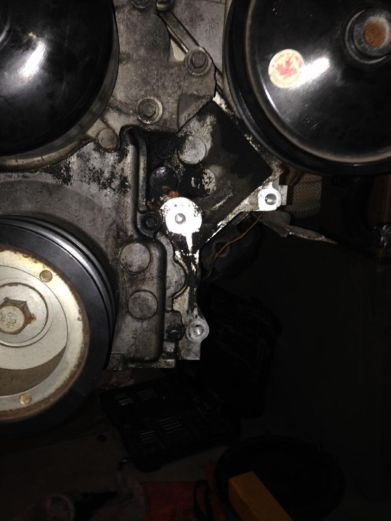

Been a little bit. Found time to remove the a/c, egr and the alternator. What a difference with all the open space. Took some time today since the a/c is gone to take the manifold off and try on the truck mani. What a pita to remove the dipstick, you can see I banged up the paint pretty good in some areas trying to wiggle it in. Finally got the dipstick out and noticed that its not the frame the flange hits, it's the kmember.

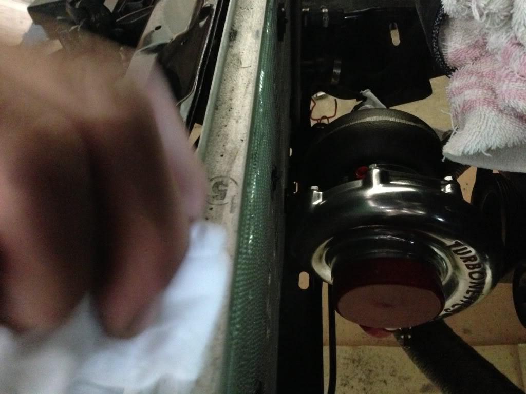

Little update...
Fans are mounted on the radiator. I test fitted it and the top fan will need to move down one or two rows, however I could squeeze it in and it fit perfect. Ill get pics soon.

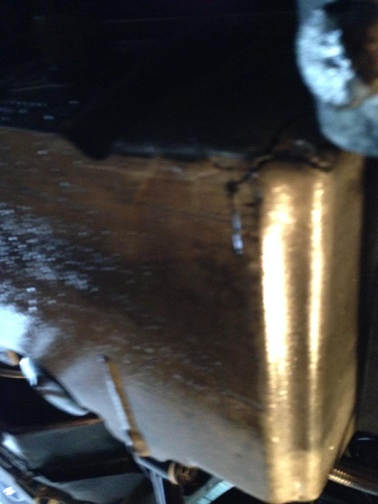

Also realized BOTH manifolds will need to be cut. The passenger side I actually got bolted on but I had to take a stud out to get it on. I figure ill be able to cut a triangle out if that makes any sense and use a hammer to bang it into place. I imagine it should fit fine but then ill have redo the crossover.
Driver side wouldnt even bolt up. It hits the steering link plastic cover.

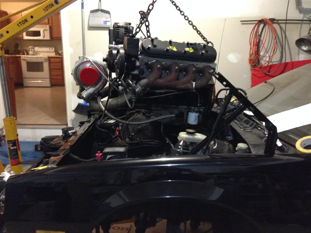

Update:

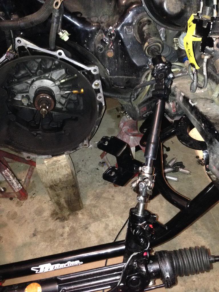

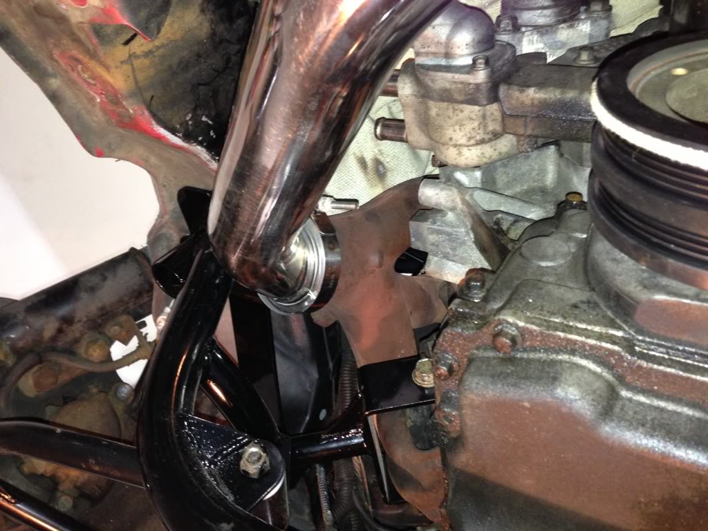

I took out the steering linkage, and gear box. The manifold then fit very well.

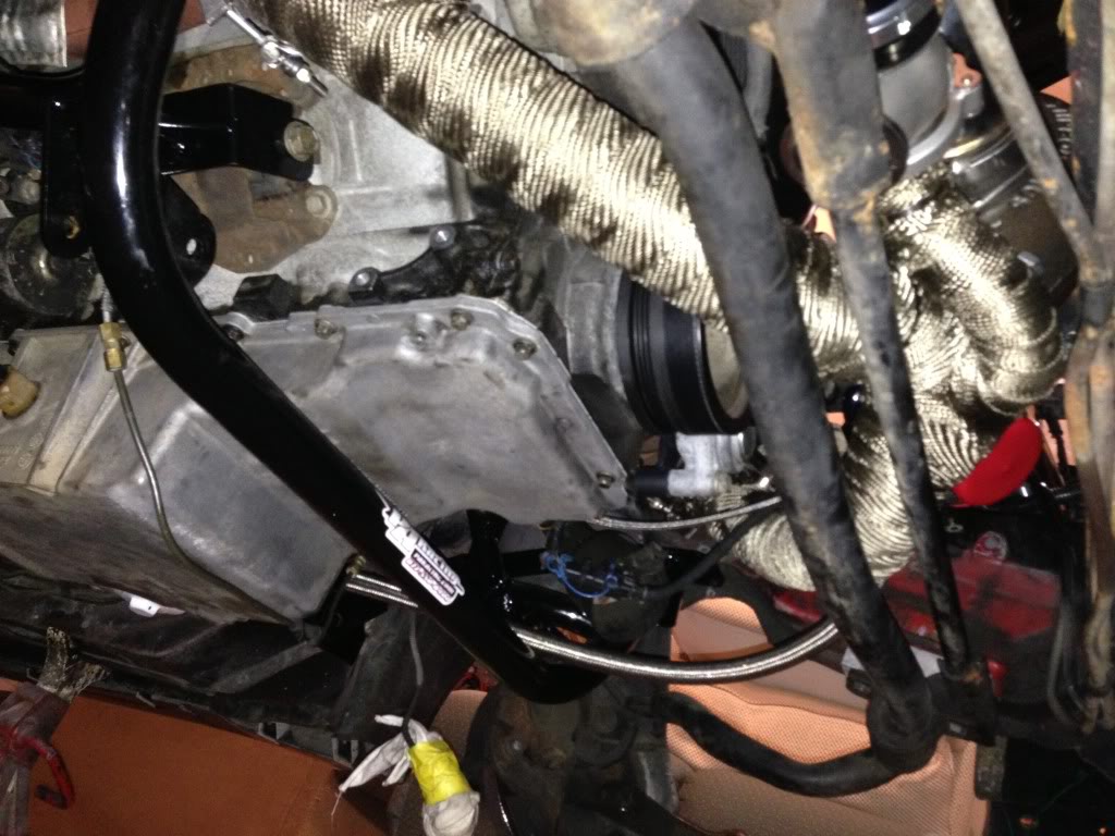

Hopefully getting them in was the hard part, next will be v banding them.
The pass. side is the real problem. It's extremely close to the kmember and I had to take a stud out so it would even fit.

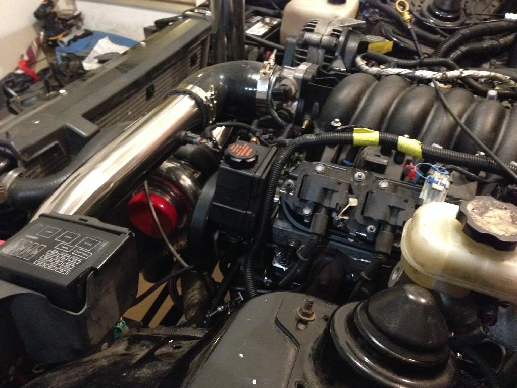

Last but not least, I put the crossover on.
You can tell from the picture that its too close to the rad., so I'm going to see if I can cut some of the tube off the crossover to make it sit back and higher to accommodate the sway bar as well. I figure ill need spacers anyways though. That's about where I'm at now. I'm going to be buying some vbands soon and will get pictures up soon.

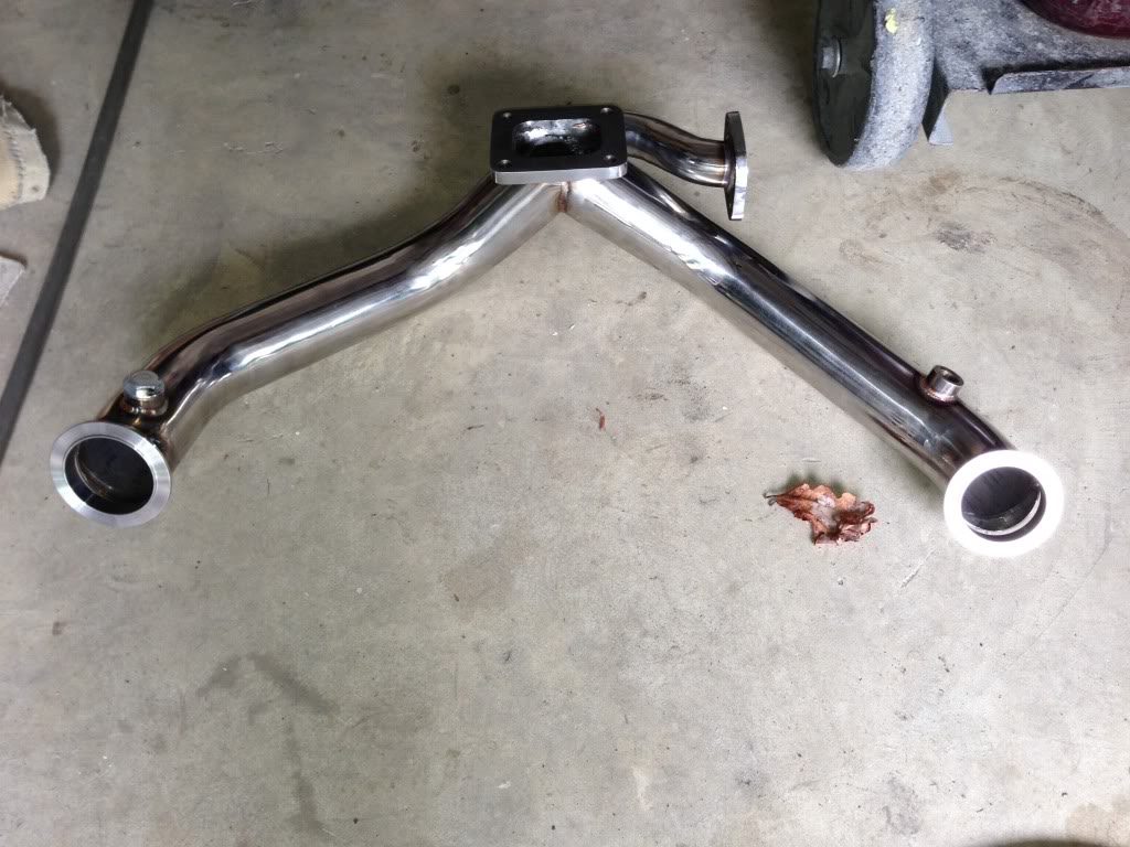

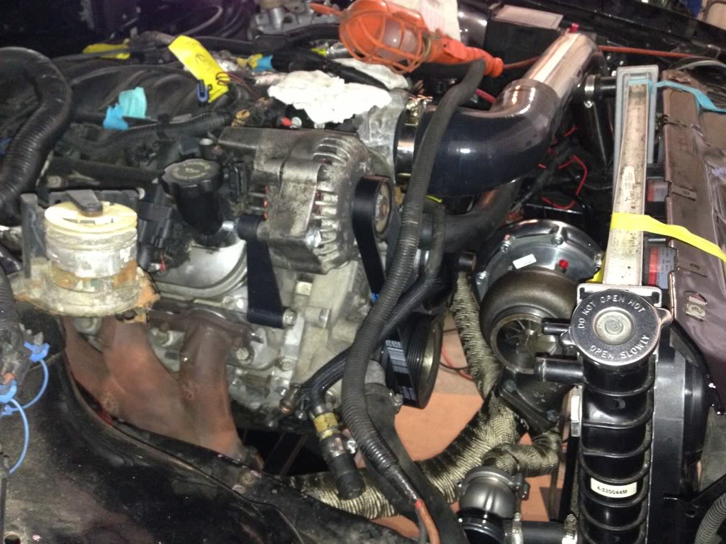

Got the vbands and also tacked, fitted, and grinded/cut the hot side to face up and backwards a bit to accommodate the turbo.
Everything seemed to fit fine so it'll go out for welding Tuesday!
The little bit of clearance to the radiator. It i see any problems, ill stand the radiator up but I think it'll be okay.

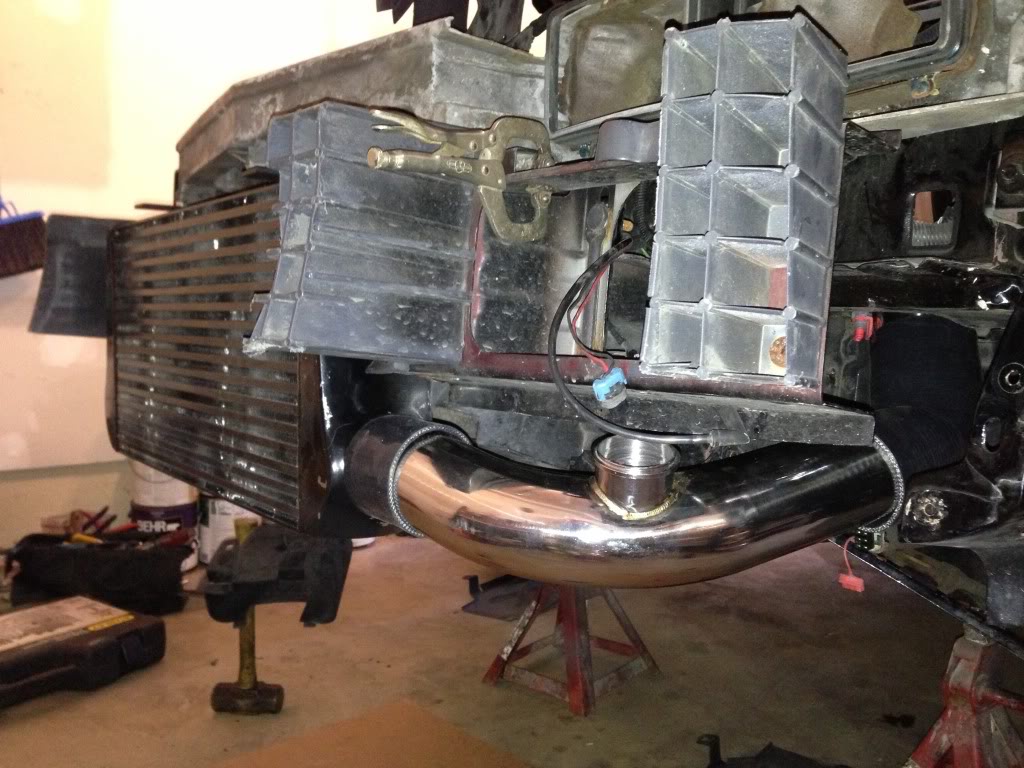

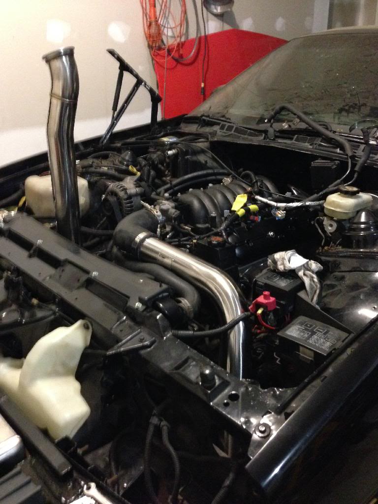

I want to do a quick "U" right off the intercooler which will wrap around right behind it and run between the rear of the intercooler and a plastic shroud. Then have a 90 degree welded on and cut a section of the shroud out to accommodate the pipe which will then have a short 45 degree welded to that which will then have a straight coupler to the compressor outlet.
I'm not sure if the sudden 180 degree turn though will cause a restriction or not for the air to flow smooth/properly. You can see in the pic below
If I can get it done how I want, it'll be perfect IMO as ill have no worries for ground clearance with any of the piping.

Also got my BOV pipe back. The flange as you can see in my earlier post pointed straight up at the bumper support, now fixed.
Without turbo
with it
You cant really tell, but the rad. support got notched so i had a little more wiggle room.

Underside with the swap bar back on. (had to make some 2 inch spacers)

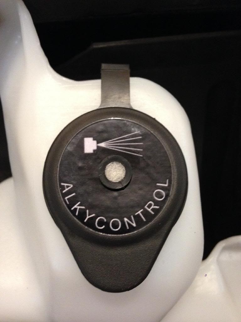

And last but not least, more stuff!
Thats basically where im at now. I did get to start it just to satisfy myself, which i did lol, and couldnt be happier!
But theres still alot of work that needs to be finished.
Still need to order the fuel system, install the clutch, finish the piping obvisouly, figure out what im going to do about steering (pondering a thunderbird rack&pinion) and throw in the injectors and map sensor i have laying around. Thats all the big stuff imo.

Got the rack and pinion mounted and the k-member mounts welded on!
Now I just need to finish the steering linkage.

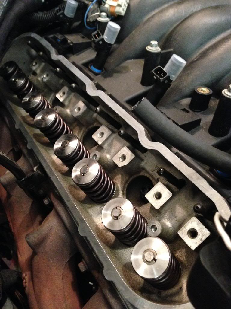

Heads bolted down
Still need to finish the valvetrain. I only put the v/c's on because I brought them earlier that day and wanted to see what they looked like

PROGRESS!
...finally!
Motors out

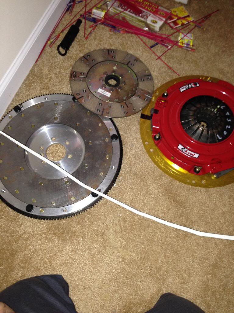

Old centerforce dual friction clutch.. which lasted about a year before slipping.
Material left
New Mcleod dual disk

Car is coming along pretty quick ATM, so I'll go ahead and post a nice update hopefully followed by another in a week or so!

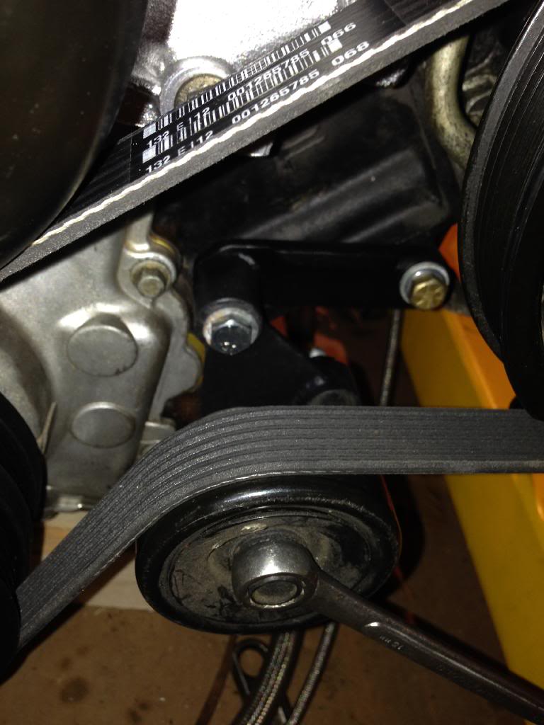

Ran into a few small problems while swapping everything over to the lq4.
Area I had my tensioner mounted on the ls1
And on the 6.0
So I went ahead and made a bracket that reached over to where that boss would/should be in the block

Steering = done! (For now)

Probably will entertain the idea of what I can do the down pipe that came.
I'll probably end up using as much as I before it hits and v band it and go custom from there.
Also...
Motors in!
Harness is already hooked up, trans, front suspension, and the motor is almost finished.
Got the valvetrain finished, valve covers and coils all hooked up.

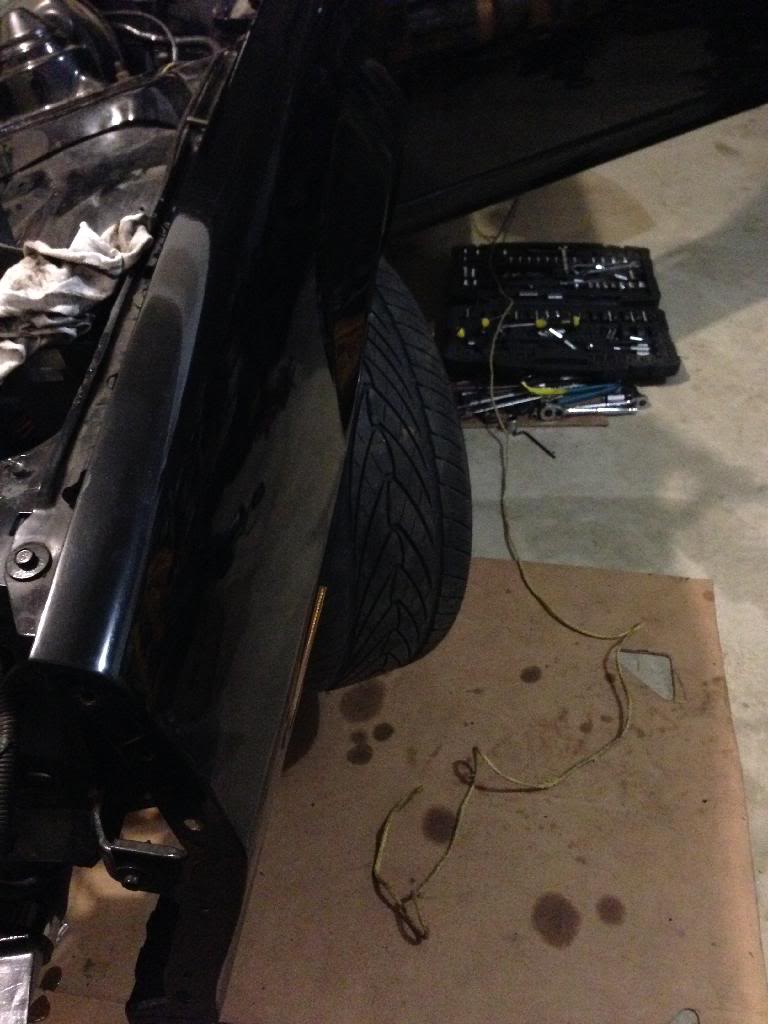

As for the steering...
Close, but it's still a fingers width away all the way around.
And as for the turning radius..
That is until the steering wheel hits it's stop. I obviously haven't gotten to driving around with it yet but hopefully soon.

Piping also done
Front bumper mockup

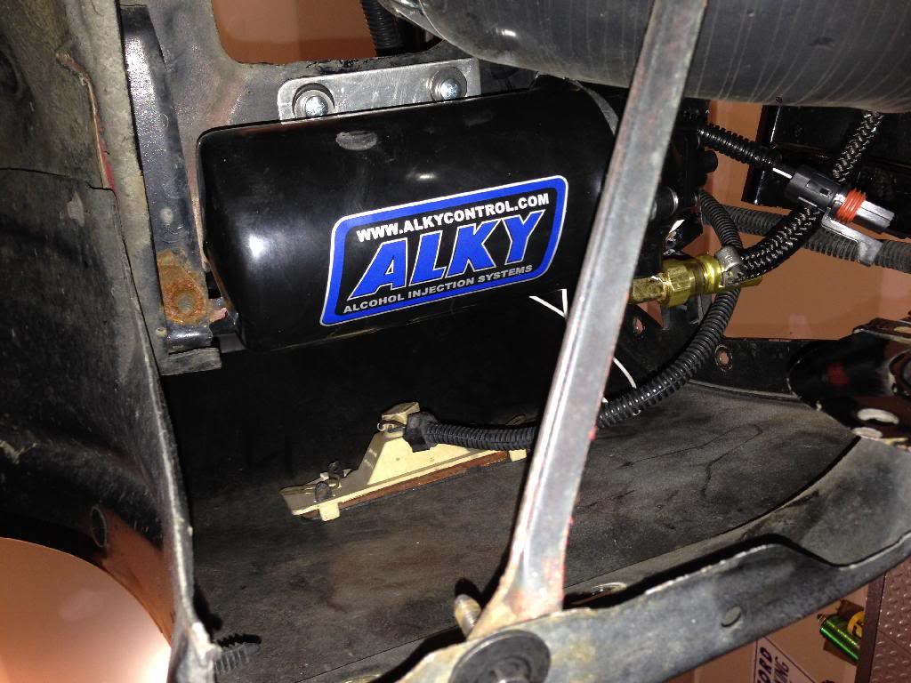

Pump mounted
That's about where I'm at right now. Hopefully by the end of the day I'll have the meth kit finished besides wiring. All that is left after that is to mount and run a vaccum block and the fuel system.... Still. Just waiting for it to come in which should be any day now

Nice!!! Any pictures of clearance with the steering components?
Old Mar 7, 2014 | 08:47 PM
88blackiroc's Avatar
Joined: Aug 2010
Posts: 486
From: MD
Car: 88 Iroc-z
Engine: ls1
Transmission: t56
Re: Front Mount Ls1 w/ Truck Mani Kit
I'll snap some tmr. Clearance I'd say is about a two finger widths from the manifold at worst.

Well FML.
Driving to work yesterday and hit what looked like a concrete block on I395 around a bend.
Destroyed the rack and pinion, which broke the k-member and severely bent a a-arm, which cracked the oil pan. Of course it was the first day I would of driven it to work and afterwards I was having the exhaust done. I figure it'll be about 1000$ setback.
