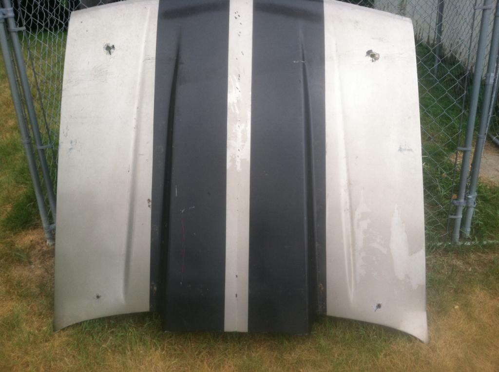

Well car has been put on hold. Job search commencing.
Although I found more rust. Looks like the quarters were replaced, and has now rusted into the rear frame rail sections, along with more rust in the tunnel and floorboards.
) Last pic is Dinner for a month
