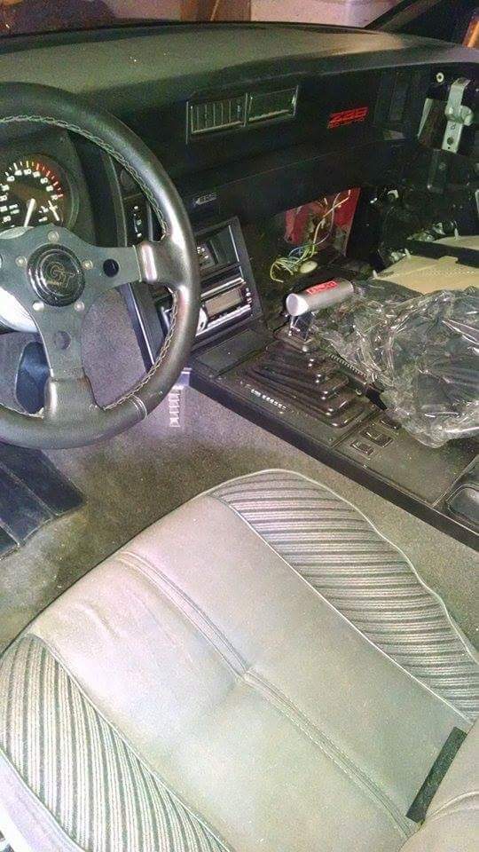

Hey everybody just a couple questions and a little update. I got seats out and carpet about ready to come up its $289. On hawks for front and back does anybody know of a place any cheaper? Also I'll post a picture of the issue I'm having... I've found carpet for the sides of center console which is $25. For set. Or can you remove carpet clean up plastic and it look good without it? I guess I'll see when I remove it lol.
But can't seem to find where to get the carpet for under dash on side of trim..

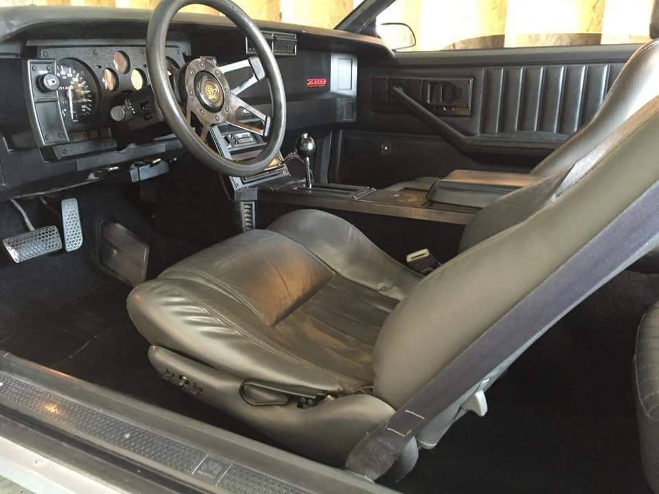

Update long time no see: Got the interior finished 145 mph instrument panel, new carpet and 2000 t/a seats.
Threw a rod in the old crossfire 305 2 weeks ago.
But I have a 99 manuel camaro I'm ready to put the ls1 in the 82 (change of plans not a 5.3 turbo) both have uncut harnesses and I'm wondering how or who can help me find adapters or who will modify mine for a reasonable price or give me the pinout differences hooking up to a cfi harness ive only been able to find info on TPI and TBI. Ive called speartech haven't got back with me yet and don't want to pay 630. Also if I get tubular k member who is cheap and durable I've heard bad about spohn.. but with mounts and k member will ls1 be ready to JUST SIT in engine bay? Thanks guys.

I think those are Formula seats. Full leather back, no plastic. Always wanted to find a good set of those.

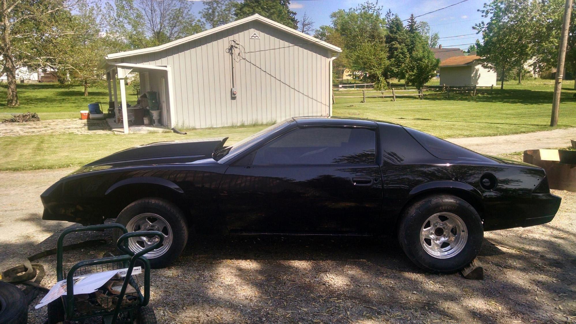

What size tires are those? 18" rims?

Re: Need a lot of help!!!! Opinions
They look like the 16" American Racing wheels

18 iroc replicas I thought maybe they are 16s I don't have the car at my house right now in the middle of a move or id let you gus know. I just sold a set of wheels off my 82 regal
For $500 bucks paid alot more then that for them last year I'm not sure how much these are worth but I'd let these go for pretty cheap too but idk if it'd be worth it after shipping if any body would want them on here. I want to by some black 5th gen wheels . I see pocket on here does alot with wiring and seems to be really knowledgeable is crossfire injection any different wiring? That's where I'm really stumped on this whole thing
Paid 200 then 100 for repair on driver seat at local upholstery shop. Got them for a decent deal i think. I've seen some of them seats for. rediculous prices lol.
