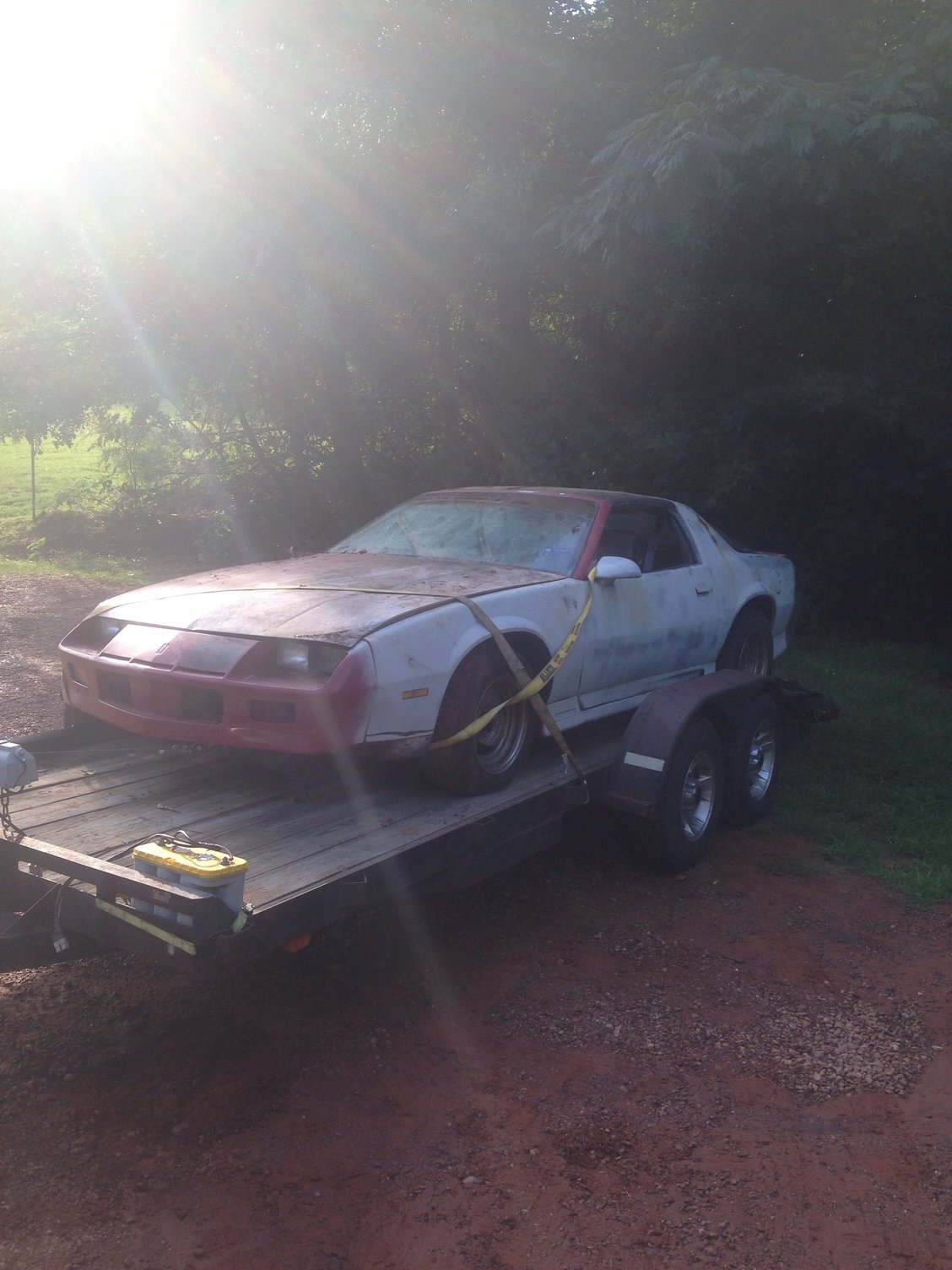

Went and picked up my car today and man was it a pain, but it made it here. Now the real fun begins!!

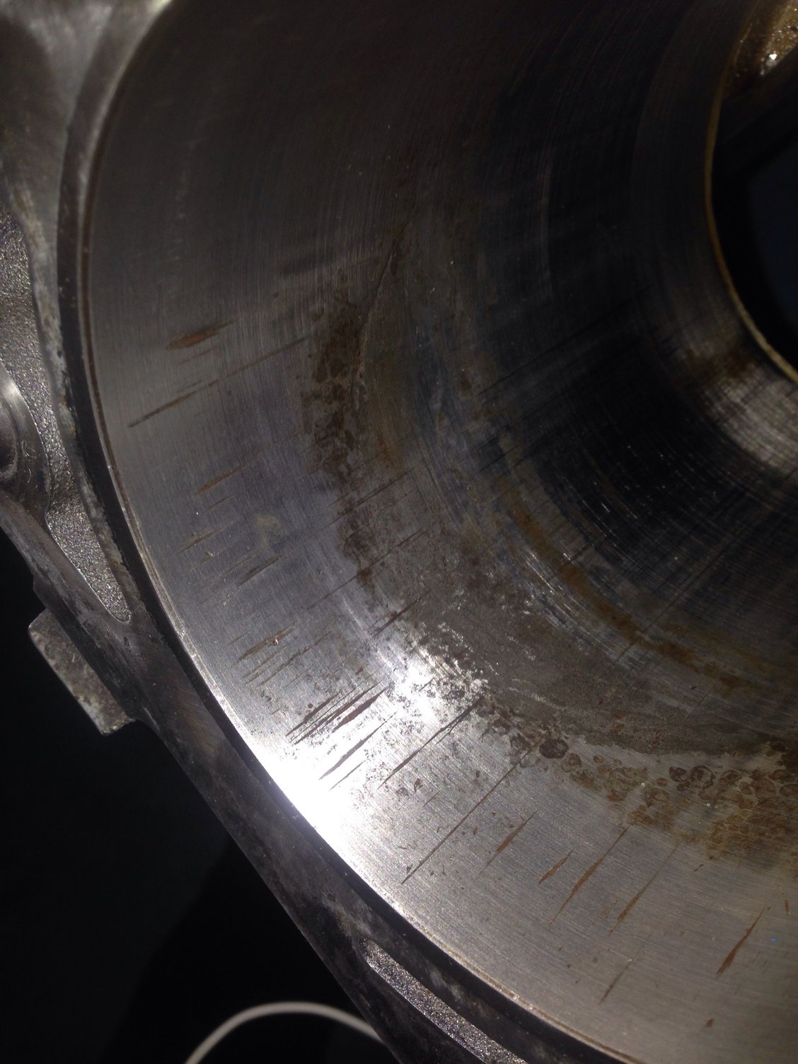

Got the engine into the shop today the cylinder bores were worse than I remembered. You can see the deep gouges. Not to sure if they will clean up. May give the worse one a hone and see how it does. If it doesn't clean up my have to adjust my plan.

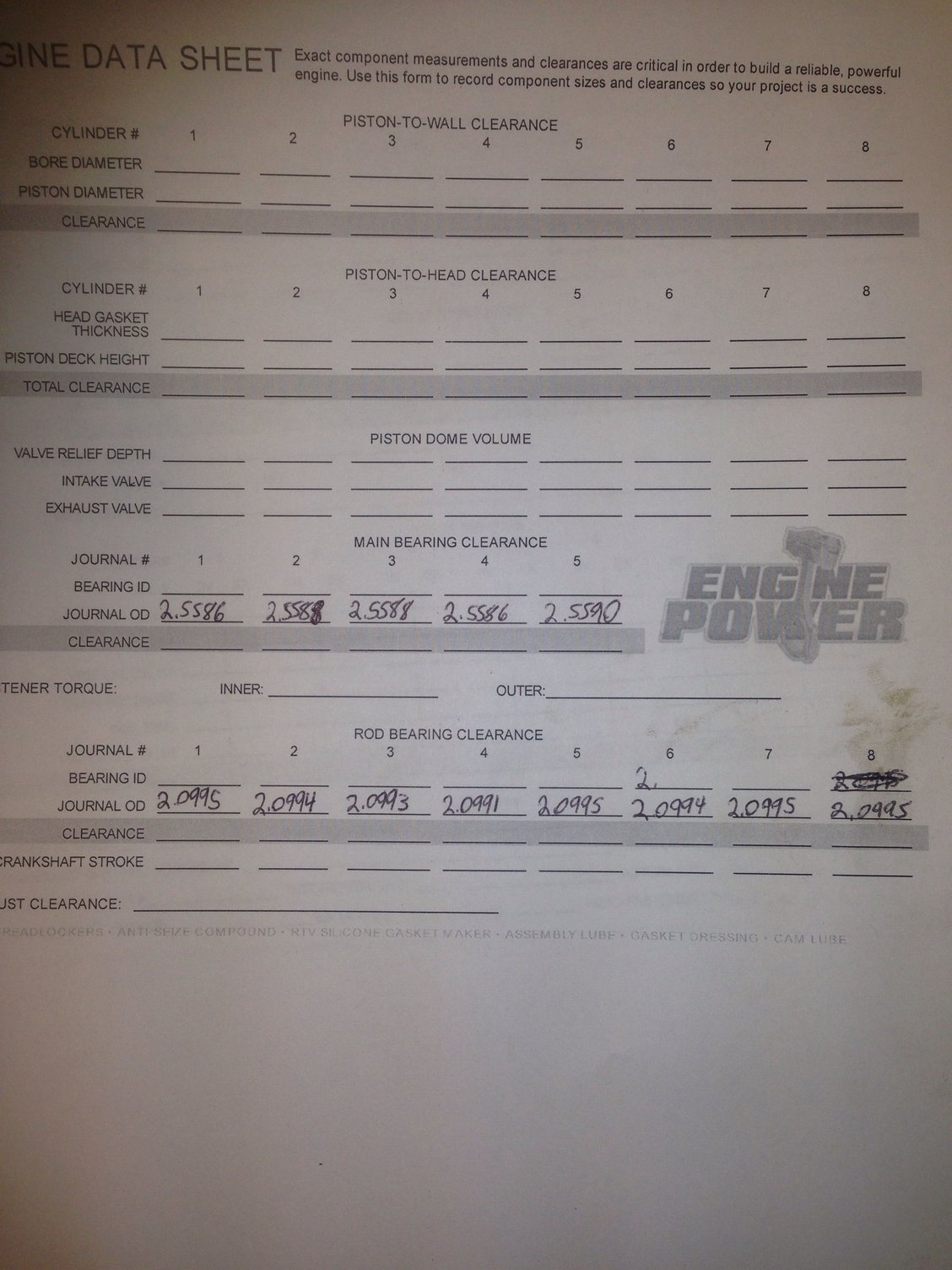

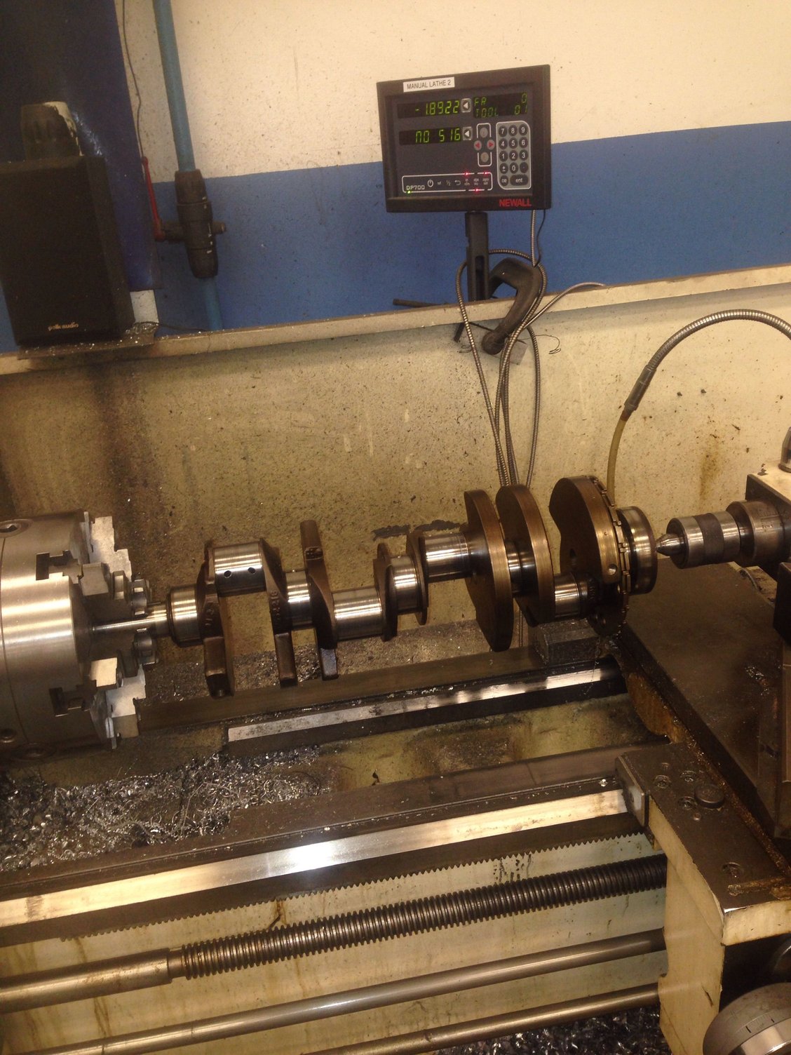

Stayed after work to check to od of the rod and main journals. From the spec sheet I have they look good.

Talked to one of our engine builders and he said that he is pretty sure that the cylinders will clean up. And said that we could hone the block maybe sometime this week. Which is freaking awesome! Also going to polish the journals while we're at it too. So I'm getting a lot of the machining done and saving a boat load of money. Will post some pics of it during the process.

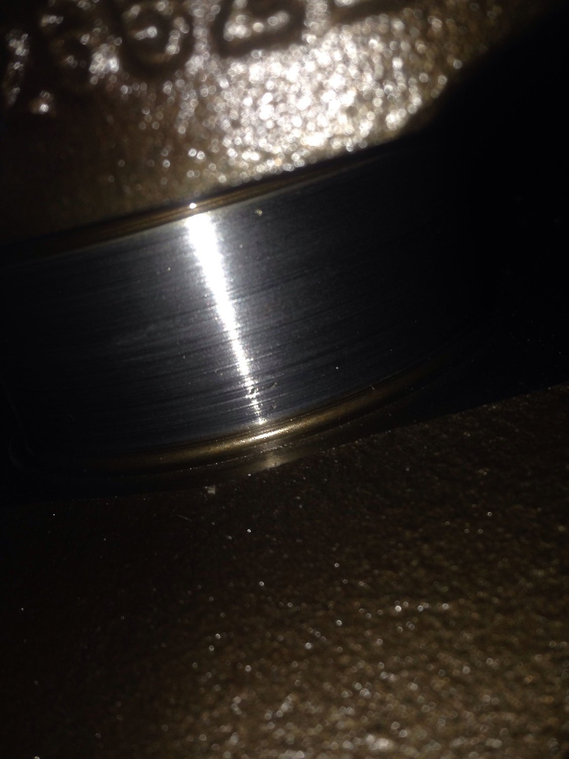

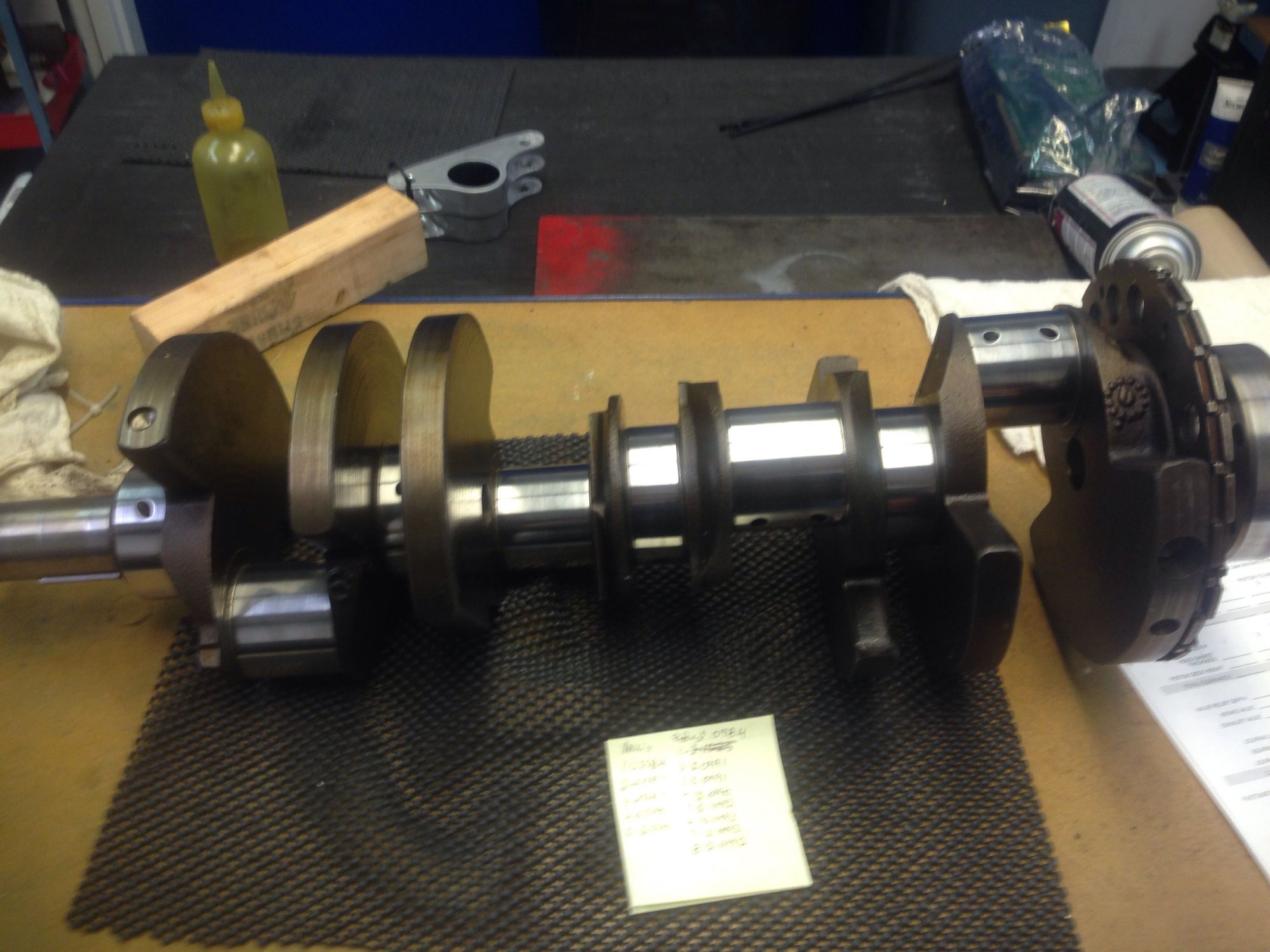

Polished the crank during lunch it cleaned up really nice. Didn't get a chance to measure it yet. I will before I go home today.

If those bores won't clean up with a hone, (likely not, with the rust that is also present) it may be time to review where you plan to be at the end of your short block build. With having the access to the machine shop and wholesale parts, you may want to focus your budget on building a solid short block first, which can easily be upgraded later when more budget is available. (cam, heads, etc.)

I think that block will clean up. It depends on how big you want to go i guess really. Not sure on what the max those can be bored, but .010 will 4 sure clean em up imo. Thats kinda a lot to hone too... Depends on what machine you guys got. Still can easily be done. I was going to ask why forged pistons but I see you want 600hp or more. Ive heard nothing bad about those 243 heads. Sounds like you have a good shop there and are in good hands. Very interested in final #s!

(edit) That crank cleaned up great! Do you chamfer out the oil gals?

Here is the crank after polishing.

Looks great.

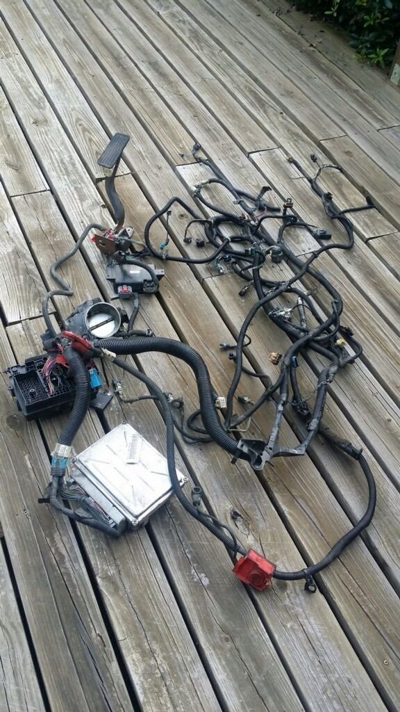

Trading the transmission out of the car I picked up last weekend for a DBW truck harness. Soon the fun of wiring begins!

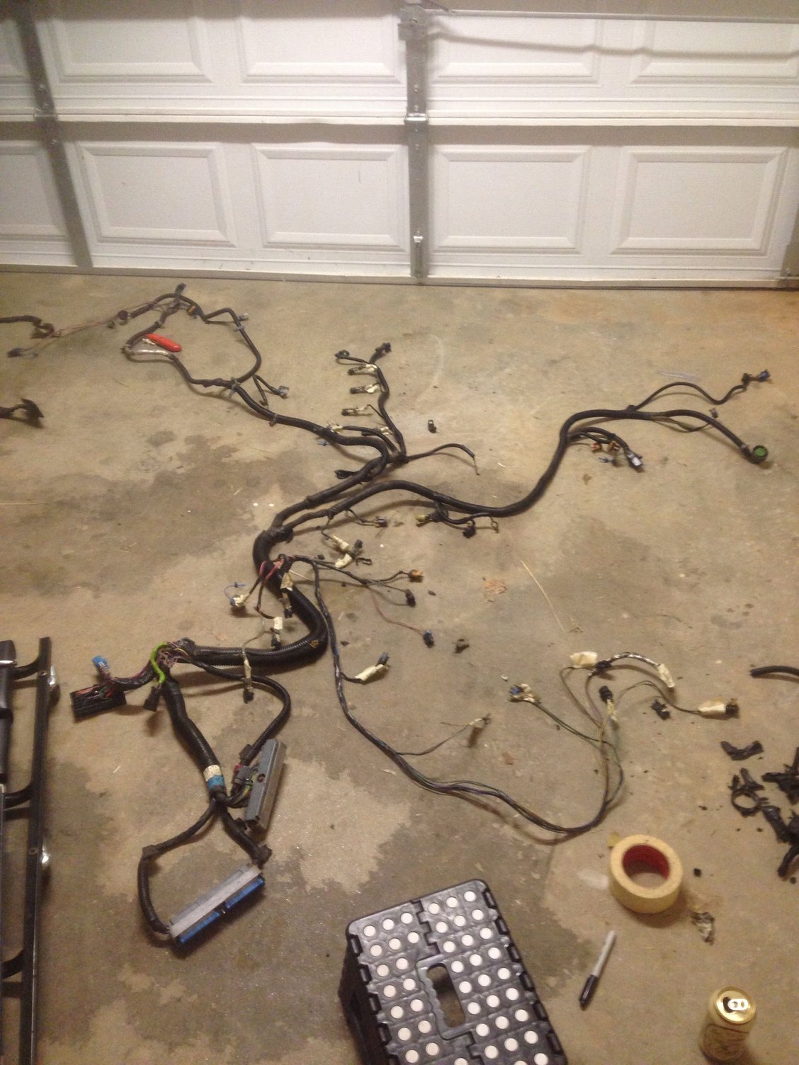

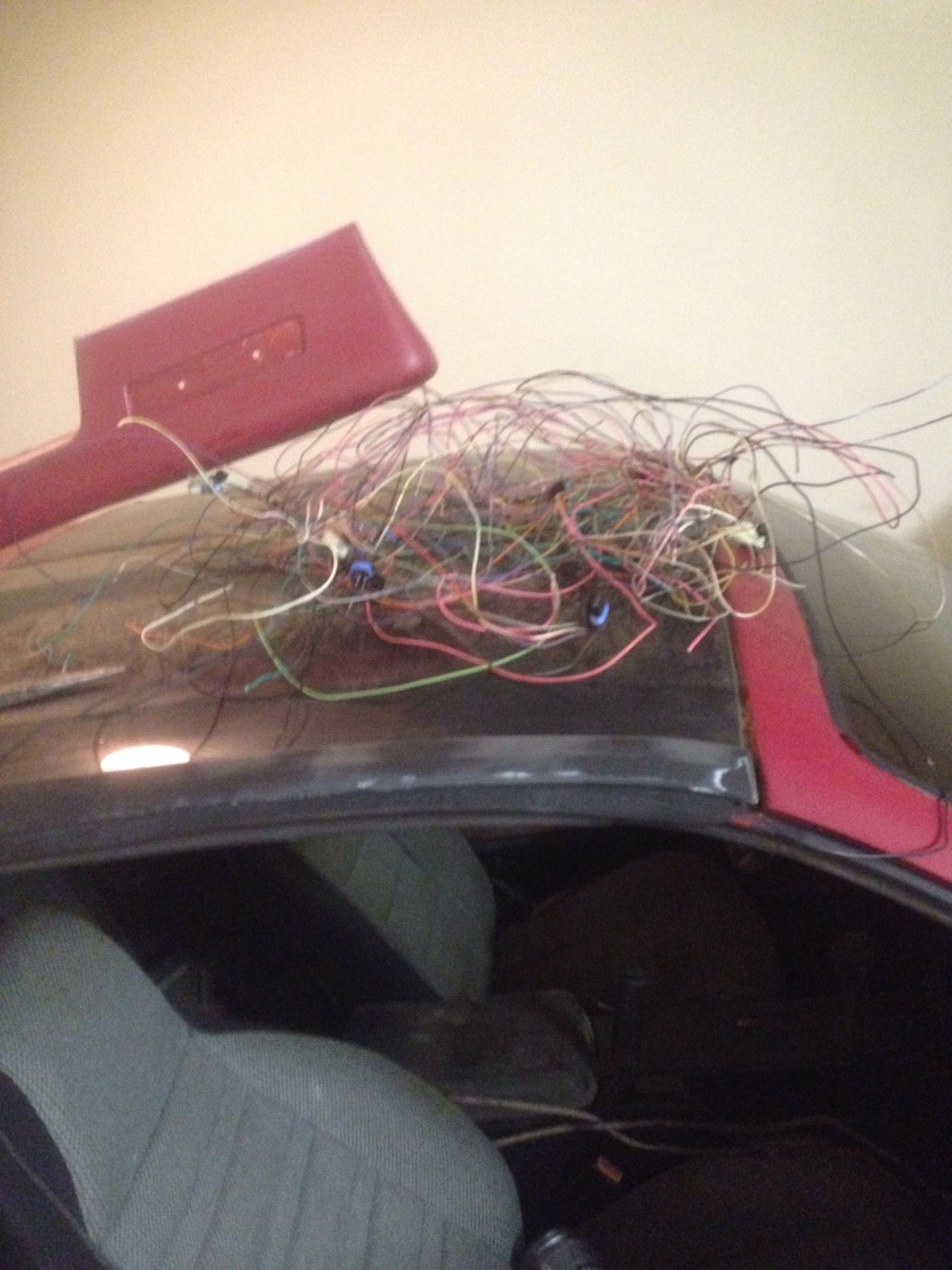

Started on the wiring today I hope everything is right from the best I can tell it is. I only have one connection that I'm not to sure about. But I will find out when I start connecting to the thirdgen harness.

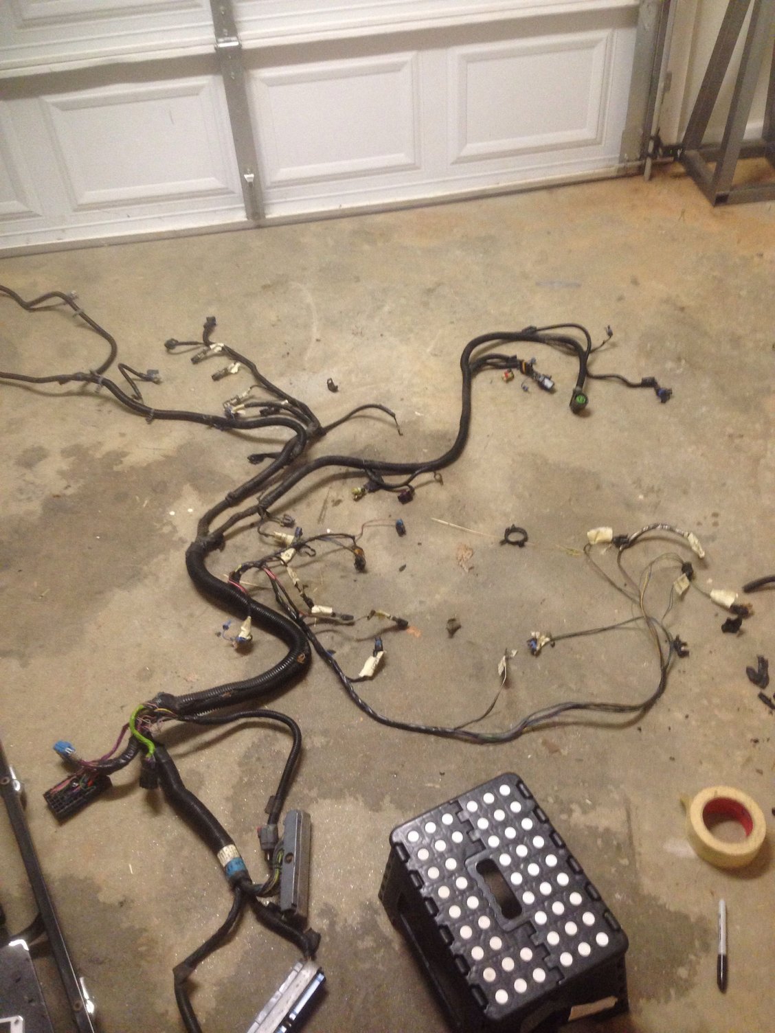

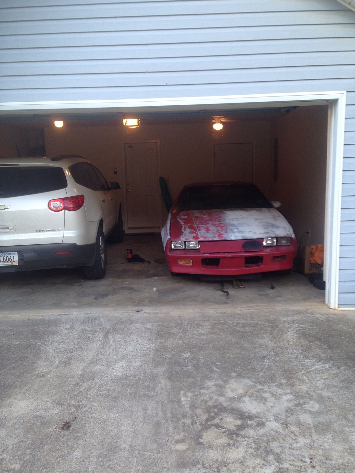

Got the v6 pulled out of the car last night with the help of a buddy, and few cans of Yuengling. We had it out in about an hour. Granted we pulled the trans two weeks before. Now on to the fun part of moding the harness for the swap.
