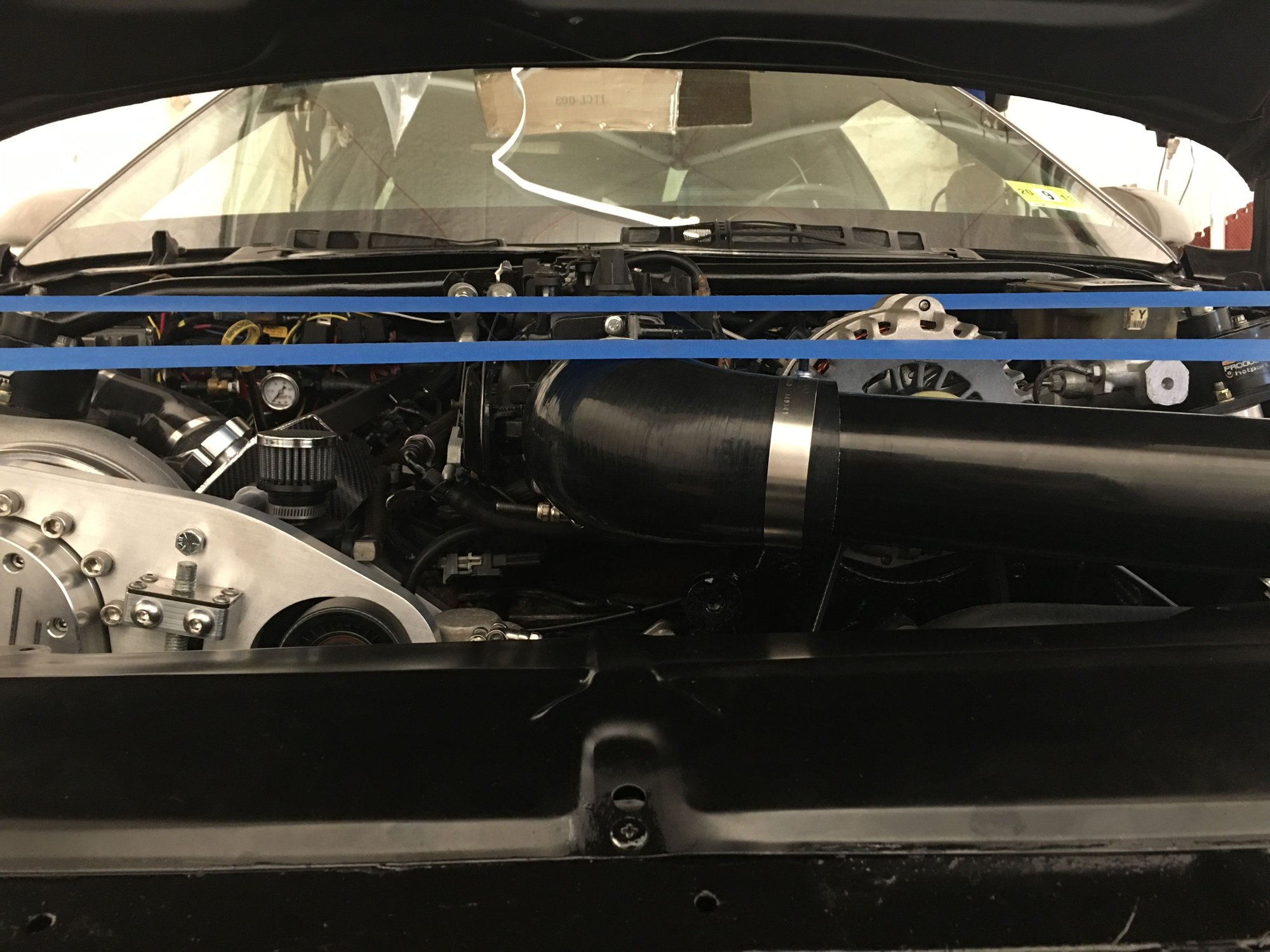

5.3 truck intake and stock firebird hood?!
Hey Guys, Ive read the stickes and some say you need the LS1 intake as well as relocating the Alternator... but then I read people have gotten them under the stock camaro hoods.
My 5.3 is running good but I have a 4" cowl hood and needless to say its tall and alittle annoying on the street. I originally wanted to find a power buige hood but they are impossible to find or $$. So I found a local TA hood for $100 and another for $125 a distance out. I'm not sure of any hood line differences between the camaro and firebird that the camaro can fit them. I'm running solid universal steel SBC motor mounts that I made fit which actually lowered the motor I think compared to stock.
I took some tape and marked my engine and I can only see the intake and alternator sticking up 1-1.5" from the fender line. This doesnt seem like alot and I dont think the stock TA hoods are perfectly flat but maybe clearancing underneith the hood supports?
LS1 intake performs worse than my stock truck intake so Id rather not, thought about the procomp style intake due to costs or even the BBK etc. Perfect world my truck intake would fit lol.
If not I have to factor in the additional costs.
hood = $100-125
Alt/ps relocation bracket = $130-250
New belt = $20-40
Intake = $100-$500
Heres some pics of the tape lines. Can anyone measure under the stock TA or bulge hoods?

See pics

Thats looks very close. I think it may rub on a stock t/a hood with some of the underhood bracing removed. But your alternator might hit for sure

Yea its very annoying... like 1/2-1" is killin me!

Back to your topic, I think the truck intake may partially rub the hood which is not really an issue.The alt though..especially that position of that tab sticking up is at the point where the t/a fender/hood lines curve down. When i had my 383/hsr intake I had to cut a section of underhood bracing because the throttle body would hit this spot.I cut a section of the hood liner for it also and then i was able to fully close the hood. Could never let the hood drop close.Just a slight puch down for it to latch or it would rub.
You can shave the truck intake ..or i ask..is that a ls1 alternator or the truck/h.o alt? maybe find something smaller?

The intake and alt are def high, getting cheap $120 alt relocation brackets is possible but the intake is still the issue. I dont want to get rid of the truck intake as they perform so well and make gobs of tq below 3k which is where i spend most of my time. Honestly I would love a power bulge, my car had one and then I hit a deer and the antlers put dents all across the top and I junked the hood years ago... wish I had kept it!!!
The alt is a larger case style, 130amp minimum and I need it to power my Meth injection and my mark IV fans that pull like 70amps. The original alt is not too much smaller and puts out like 100amps I believe. I think the alt would clear with the power bulge hood but idk about the intake being that its centered in the hood and high in the front. I'm never going to use hood insulation lol, just want the hood alittle lower for street driving since the 4.5" cowl is a bit tall ya know lol.

I agree the intake is gross but that's why I make a cover plate wrapped in carbon fiber lol.
I thought I read a thread where they fit a stock 5.3 under the bulge hood with stock accessories and brackets. Something about the alt being in the right place for the bulge part of the cowl.
I agree tho with most of what u said. Doesn't look good without at least a relocation or intake mod. Only way to tell is to get a hood.
Motor mounts are SBC solids and I personally think they are lower than stock style 3rd gen mounts as the tabs are physically shorter like 1/4-1/2". And I had to Lower my trans to get the correct motor angle.

Hmm your in a pickle my friend. Its a killer setup i must say...as it stands i think you just need to ride the no hood look and be a badass. Is the cowl hood fibreglass? It can be altered with body work and chopped down and reinforced also to sit at a height you like. Its a bit of work but can be done...not a cheap fix unless you dont mind doing it yourself.

Yes, for sure. My 4"-4.5" cowl has a ton of room above the front of the motor and the cowl. I measured only 1"-1.25" above fender line int he pics shown. As long as the inside of the hood is 1.25" or higher you should clear.

Just wanted to update the thread!
Decided to pull my cowl hood and test fit the power bulge with my current configuration. The stock 5.3, stock truck EFI intake, 130amp large case alternator (all my Supercharger IC piping) and Ive used a 1" spacer for the TB which also pushes the TB linakage up and forward 1". My motor mounts are standard SBC solids which I think are slightly lower than 3rd gen specific solid mounts but have no idea.
Bottom line is IT WILL CLEAR the stock hood! Only modification being removal of the large case alternator and running a stock small case alternator!!!! Whoop Whoop! Which sucks as I need to remove my new alternator and get a new smaller case with less amperage lol but I thought I needed to cut the hell out of the hood or change all the accessories around to clear everything. If you try to use a large case alt you will need to cut the underhood bracing right above the alt to get the 1" or so clearance needed (basically cut the cross bar) and it clears. But you wont be able to have an engine cover on the intake anymore
Finnally some definitive proof it will fit! This means it will prob fit a stock hood as well if you remove the engine cover as well since nothing really pokes into the power bulge cavity.
Now I need to fix all the dents (way more than I thought) and get to the body work and paint.

Yes! Stock accessory brackets in stock locations. Only difference is LS1 waterpump and large case alternator and supercharger/piping.
Motor mounts are cheap $30 eBay SBC solid mounts drilled to fit 3rd gen Kmember. See pic
Stock 5.3, remove engine cover and swap or use OeM small case alternator. Everything clears.

Re: 5.3 truck intake and stock firebird hood?!
Originally Posted by cosmick
I was one of the first, probably the first, to get the truck intake under a stock Camaro hood.
The 'bird hoods drop off quicker as you move forward of the front axle centerline.
It is possible to put Camaro fenders, hood, and nose on your bird.
Yes, their is no definitive answer on the firebirds. Its very tight due to the drop off of the fenders/hood. But it does clear with the bulge hood and the small case alternator and no engine cover.
EDIT: does the camaro fender/strut tower supports have a different angle than the Firebird? I always thought the fender supports were different between models.

Updates. Stock hood is on for good now. spent a week body working the hood and shot it with the car paint just to have the clear coat shoot **** all over the hood lol... ugh. I'm not doing anymore this summer so its done till i get the time/want to redo the hood again. Everything went on and went for a drive for the first time in weeks! Feels so nice to be able to see out of the windshield again... although it felt really weird for a while and to look at it.
Small case alt hasn't rubbed yet but charging is down a bit at idle... damn. I thought the 140amp would be at least the same as the 130amp large case at idle. With the fans on and stuff I'm lucky to get 12.5-13v at idle and it only goes to 13.5 where I was at like 14.7 with the 130 large case.

Update!
I had replaced my large case truck 130amp alternator with a tuff stuff 140amp black powder coated alternator and had charging issues. At idle I was barely seeing 13v with not much on (Fan 2nd speed, meth pump, headlights etc) wiht the 2nd speed on the fan on I would see 12.5ish volts. Lets just say it wasn't going to cut it.
Contacted Summit about it and they said it shows up that the one I have fits the application but wasn't correct for the application. They told me they would swap me a more expensive powermaster 150amp small case (case is slightly different, looked like it was more for an Fbody) for mine free of charge. Thats a $160 tuff stuff alt for a $230 powermaster lol... I was like HELL YEA! They also said the powermaster has a higher voltage set point of 14.8v. The Power master although sold as 150amps rating is actually a 165amp alternator. I got a power card with the dyno specs of the alt (each one gets its own testing) so the one I got made 105amps at idle, 150amps cruising and 165 max. Pulley DIA between the 2 was slightly different, powermaster was a hair larger like 2.2" vs 2.3" (inner Belt DIA). I swapped it out and this time took care to sand the mounting bolt bosses so they had a good connection (ground) to the accessory brackets to help with case grounding. New powermaster charges much better at 14.3v at idle and haven't seen it dip below 14v on the gauge even at night , fans 2 speed on, headlights etc. So far loving the new alternator!
