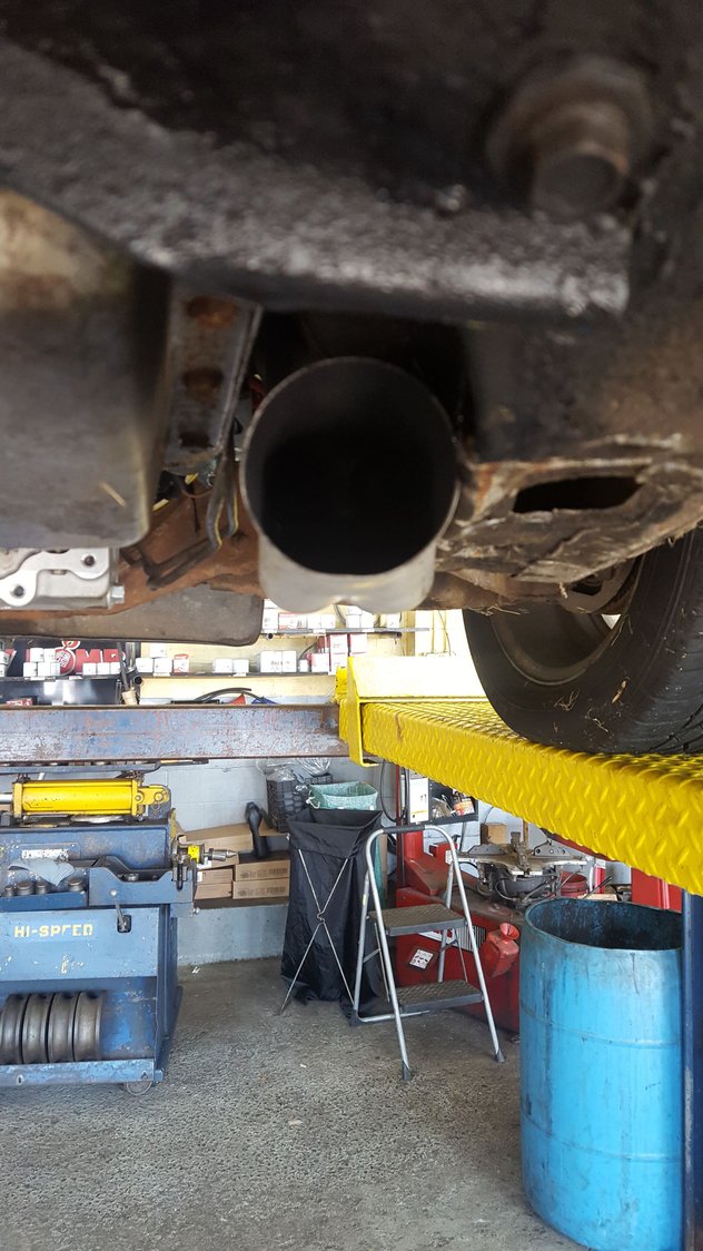

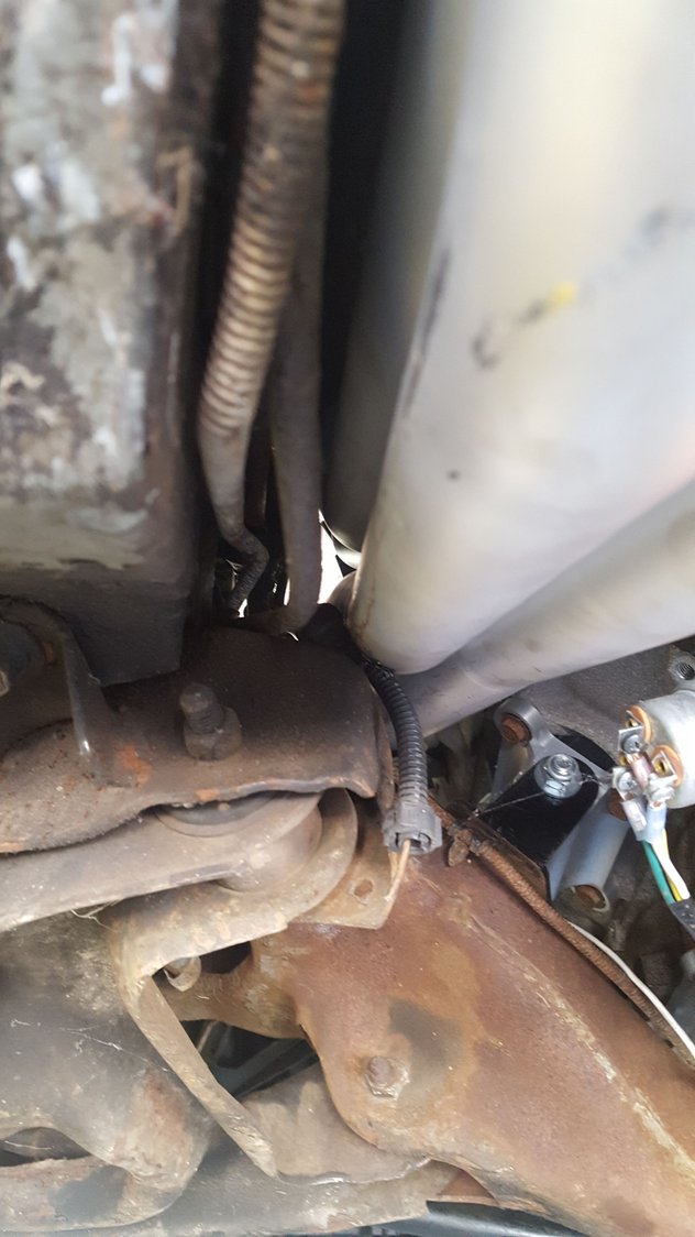

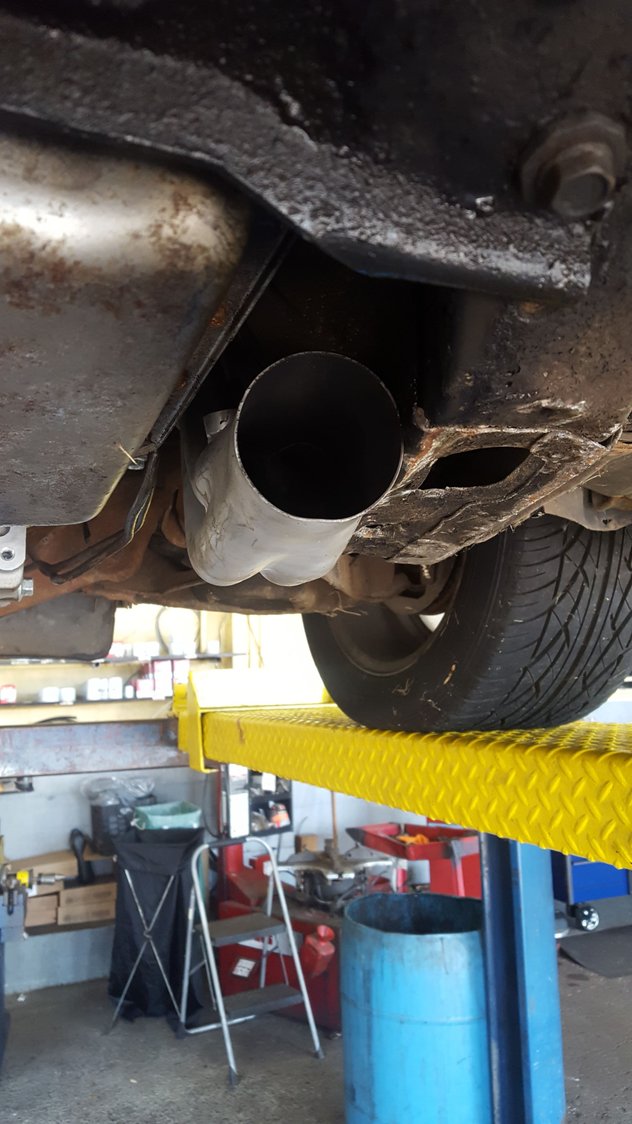

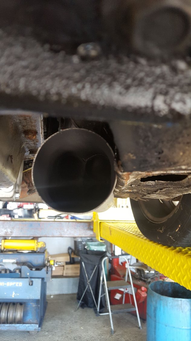

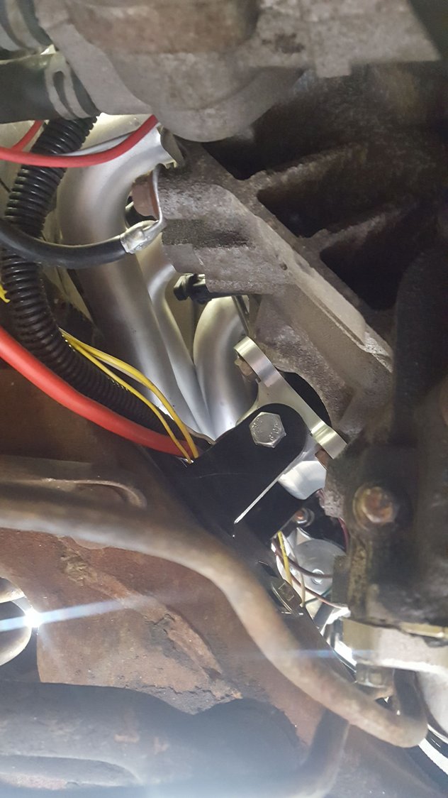

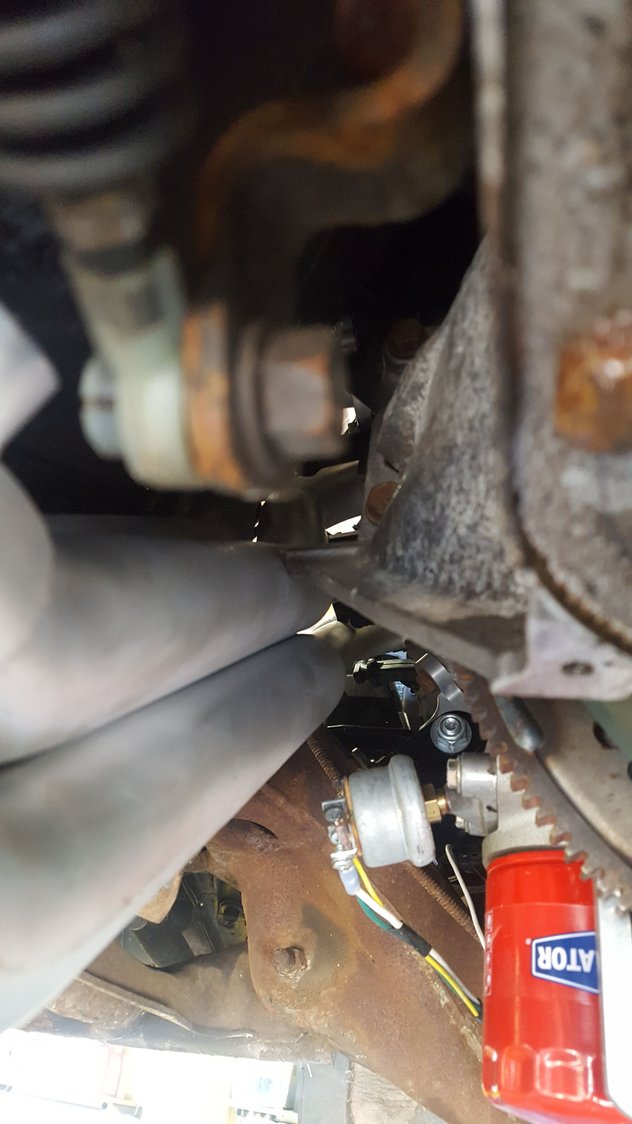

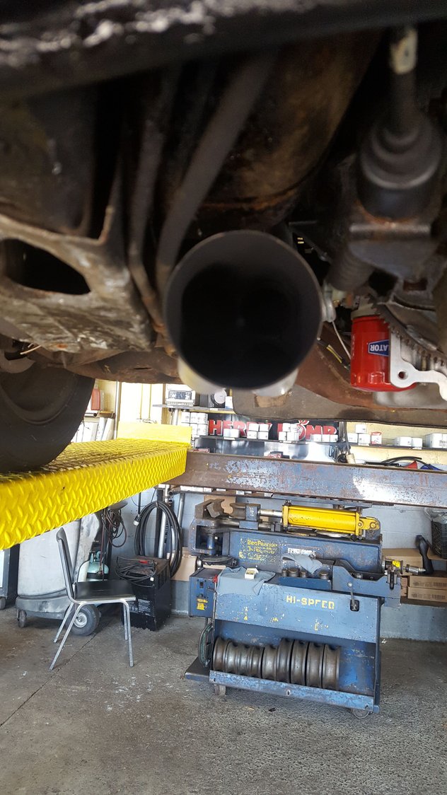

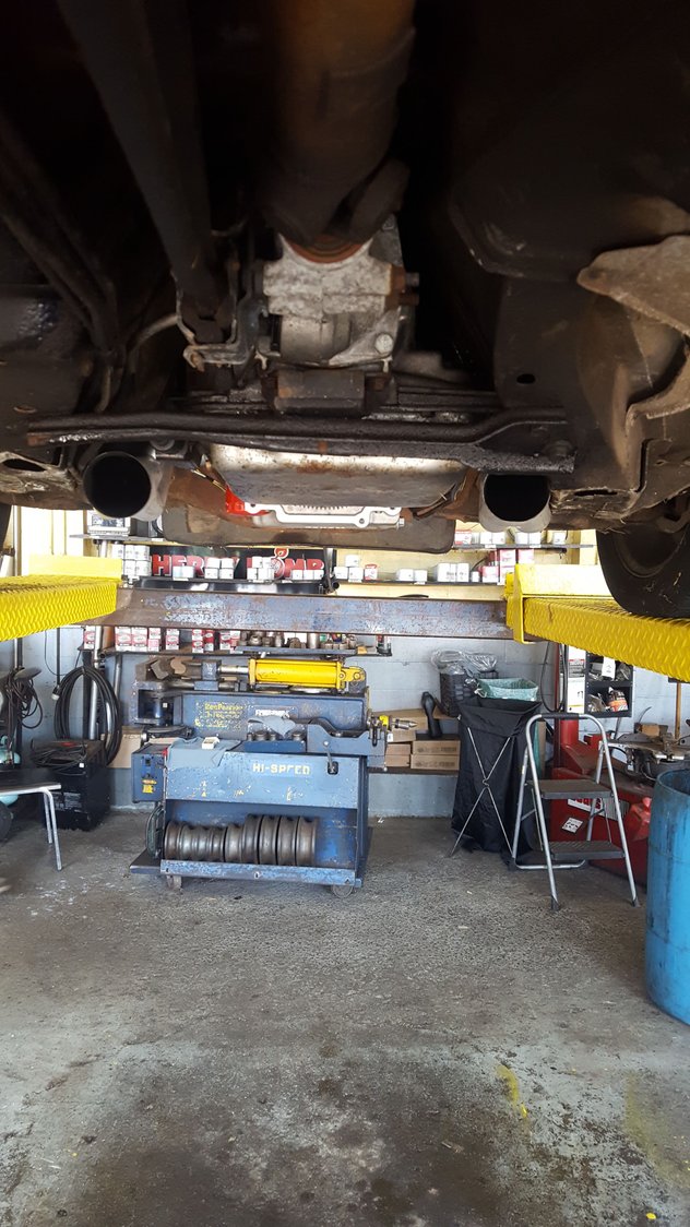

Hello i having trouble installing the stainless headers. My driver side is perfectly fine a little tight but in. The passenger side is a whole other story. It seems to be stuck on the transmission flange/ dust shield. I already shaved roughly an 1/8th off it. Have any LSx swap guys run into this problem?

If your speaking of the ear that sticks off the side on the passenger side, I just cut mine off with a cutoff wheel. Mine were hitting that spot only. My drivers side went in really easy with plenty of room. I'm using the 2" primary tube ones. I also have a tubular K-member so I have lots of room under there

Sorry for the late reply, put the car on hold.

BlackMamba94's pics look about how bad the RI headers fit.
