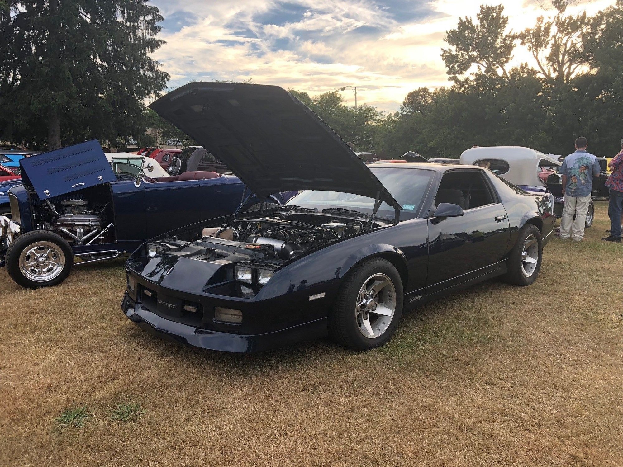

1986 305 TPI/Tremec TKO to LQ9/Tremec TKO
Old Aug 30, 2017 | 07:18 AM
86Z's Avatar
86Z
Posts: 1,992
Car: 1986 Camaro SC
Engine: 305 TPI Procharged D1SC
Transmission: Tremec TKO-600
Axle/Gears: Moser 12 Bolt 3.73 posi
well i decided i'm swapping out the old technology for ls based. i have my eye on an 02 cadillac lq9 6.0 possibly pick it up this weekend. i think this would be a nice upgrade. i'm going to eventually swap a ls1 intake on it. most likely keep the DBW. would like to retain my stock A/C compressor up top. holley makes all sorts of brackets now.
in my research sbc bellhousing should fit the ls minus one bolt. i have a lakewood scattershield 15020.
more to come!

drove the camaro some more. purrs like a kitten.. love the ls platform. i started looking at camshafts and i had to come back to earth and remember my original goal which was reliability with some nice power. don't need a whole lot. so i picked up a brand new hot cam kit with LS6 valve springs for $250.00
waiting on an ARP crank bolt and a valve spring tool for install. then i'll tune her appropriately with the wideband.
she received a lot of attention at the car show friday night specifically the motor
Golf land? I got check it out this summer!
Yes, Golf land.
