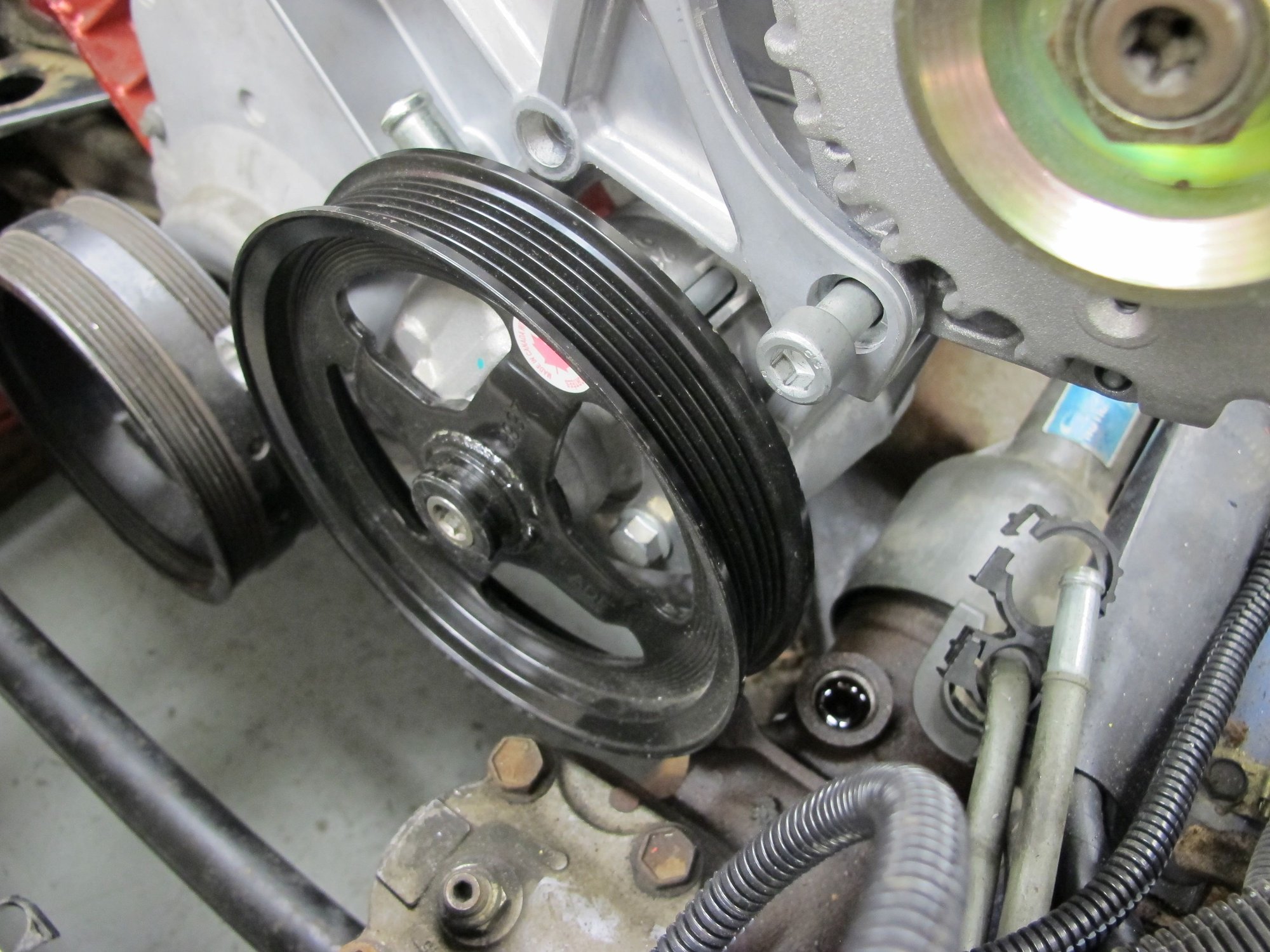

Hey everyone... I am in the process of getting my LS2 together to install later this month which leaves me with a question regarding the Holley accessory brackets.
Is anyone using the Holley drivers side their Alt/PS bracket? It is currently mocked up on my engine and I am concerned the ps pump pulley is going to hit the steering box. Curious if anyone else is running this?

The fitment results you will achieve with the Holley alt/PS bracket is dependent on the specific engine brackets you use and what accessory drive offset you want to use.
This image shows the PS pump pulley clearance with the engine mounted using the Hooker 3rd-gen F-body LS swap engine brackets and the Holley bracket installed at the truck FEAD offset.
Hey Todd... Appreciate you chiming in here.
My setup is with the Holley/Hooker engine mounts and the Corvette spacers for the brackets.
Based on the pictures you posted it is hard to say if the belt will go on the PS pulley and will it rub during movement of the engine. Do you have any insight as to if this will work?
The other potential option I see is running the Low LS Accessory Drive Bracket (P/N 20-155).
Let me know your thoughts.
There was no potential interference issues present with the Holley alternator bracket positioned at the truck offset. There maybe be interference with it aligned at the F-body, or Corvette offsets as you've discovered. The stock F-body and Holley low-mount accessory drive set-ups would both work great on your car...this image will give you an idea as to how much clearance you would have with your steering box in such cases.
