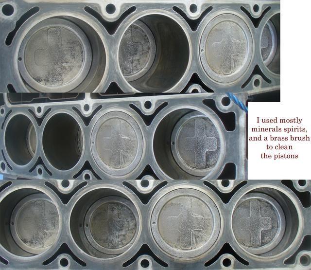

For example this fellow purchased a 'built' engine from a well known engine LS engine builder
https://www.corvetteforum.com/forums...ine-parts.html
And what do you know... there are hundreds of microscopic failures. Everything from the timing equipment, thrust surfaces, cylinder bores, camshaft burrs, lifter bores, **** you name it. Its all @(#*@'d by the machine shop that supposedly does this for a living. You run a motor like that and it goes, oh I don't know- 20k seems about the norm. Then it falls apart ("not our fault" they will say) from floating debris- because guess what?
Regular people do NOT appreciate the microscopic details that go into building a high mileage engine.

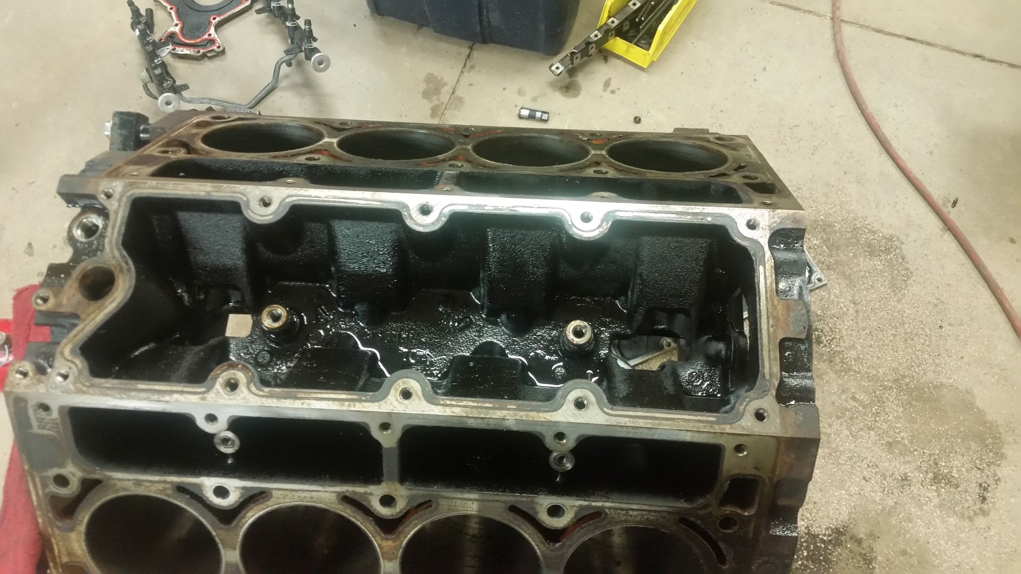

The valve train pic was at about 140,000 miles. The engine block, we'll if I pulled a valve cover and it looked black like that I would pass or expect to rebuild.

I agree 100%. I have been burned by 3 junk yard motors that appeared to be "fine" on the outside and sold "was running when pulled"
LS1 - Had a hole in the piston from what looked like a nitrous hit gone bad, cracked liner. Worthless scrap heap.
LQ4 - Looked great and was told was a rear end total that had only 34k miles on it. I decided at the last minute to pull a head and I am glad I did. Water was sitting in two of the cylinders and pitted the walls and ruined multiple sets of rings. Was able to part it out so I only lost time.
LM7 - Was running but pulled the pan and found the bottom end was crusty carbon from lack of oil changes and likely a clogged PCV. Carbon had scored the main bearings. Translation, junk motor.
That's when I gave up and built from the block up.

Heres mine
day1
Wash it
wire brushed heads clean
pull the heads
Clean as much as you can
Inspect the lifters
Inspect the crosshatch (cylinder condition)
Old Jan 23, 2019 | 01:36 PM
Kingtal0n's Avatar
Posts: 3,306
Likes: 77
From: Fl
Car: 5.3L turbo 2800lbs RWD
Transmission: 4l80e
Axle/Gears: 3.512
Re: Rookie on lsx
Put some refreshed heads/guides/springs on
make sure the gasket goes on the right way
use new head bolts
Wham top is done
Pull the pan for inspection at some point
You inspected the bores, the lifters, cam(as much as possible), the rotating parts visually and where you finger fits.
it spins nice, good compression ( I compression tested 11 engines to find the best one FIRST), Looks good, run it.
I have 20k on this engine already. I put a new oil pump because I thought it was bad (it wasn't I was just impatient).
Replace the rear main seal also because 20 year old crusty leaky ****.
Just-
Don't dismantle it. Don't machine shop it. Day 1-2 its done ready to drop in. ONE or TWO DAYS
Even if you machine shop it, what do you get back? Lets say all the work was done perfectly and its like a 0 mile refresh motor.
A: It wont support any additional power
B: Being high performance enthusiasts we are far more likely to ruin the engine for other reasons besides mileage (i.e. 20psi of boost pressure and fuel pump failure, or oil related, pinched cooler lines or moments of stupidity with oil is typical)
C: You could probably have had 3 or 4 of these motors sitting on the sidelines for what one machine shopped motor costs
D: The time to swap a JY motor in and out of the car is often 1/10 to 1/100 the time it takes to get a motor back from a machine shop

In my opinion putting money into a motor is a bad idea in general.
I hate spending $2000 on a set of heads, $500 on a cam setup, $2500 on a rotating assembly, $2000 on machine work, etc etc...
Then having it blow up in your face from something stupid, like the oil pan design for the vehicle was inadequate during a hard launch and the pickup starved.
Or the oil relocation lines got pinched somehow at the track (its happened to my friends) or clogged and motor starved for oil.
Or the orifices that drain oil back to the pan were inadequate and the oil volume in the pan dropped and the pickup starved for oil.
Or a cam bearing walked out and the motor starved for oil (happens all the damn time)
Or the insert your favorite here
So there are two schools to this. The first one is, fix all those problems first, THEN run the expensive engine.
In other words, use a 'placeholder' engine or a 'copy cat design' that already has the above bugs worked out, like the pan has been tested at the G-forces anticipated, the oil relocation system is bullet proof and uses non-pinchable teflon lines and has an adequate bypass config for the rare occasion that something clogs, the engine is setup with an oil pressure switch to shut down the engine if the pressure drops, the engine is setup with an oil pressure monitor/logger so the owner can review the oil pressure during all previous runs, etc...
Once all that stuff is sorted out, you can probably spend big money on the engine and get away with keeping it... oiled. At least.
But still you are open to internal issues such as cam bearing failure. And keep in mind that any of the above oil related issues will tend to trash all of the expensive parts. Some more than others. For example I would never re-run a cam or lifters or crank or rods in a motor that had experienced an oil related failure, no matter how clean it looks. It may be harboring infectious materials or a design flaw that you won't realize until it trashes a second and third engine. So I tend to reserve this 'school of thought' for people with spare $$$ to throw away in case of engine failures. And very few street car people have that sort of luxury. yet you still see this happen, somebody will spend 10k on a setup over the course of 5 years and never finish or barely finish the job then something catastrophic sets them back another 5 years, and then the car sits or disappears and we never hear from them again.
Alright so enough storm clouds. There is a second school which I have adopted after 20 years of the above nonsense which eliminates the majority of those issues and brings the engine cost way down, perhaps to around 5% of the total cost of the above, and still gives all the power you could possibly want. Yes turbocharging is the ideal route for this method; we can use a stock engine "$500" and make 700hp this way for example. However some do not like the idea of turbocharging or do not understand it fully and wish to avoid it. In that case, superchargers are relatively easy to bolt on and can support nearly as much power on the stock motor, for example procharger would put a stock motor right around 500hp even with $500 worth of internals. And if the motors oil system fails you just move the supercharger to a next engine and keep going. And finally nitrous, although the most expensive for a long term installation, nitrous is essentially on demand power of any injectable quantity. A factory motor that initially provides 300hp (or 350hp with a cam) can be bumped up to 500hp with a 150 shot, which is a fairly typical quantity of nitrous for small V8 engines. All three of these systems have learning curves and are potentially disastrous if not used correctly, yet all three of them allow for the use of a cheap engine, allow us to avoid putting 5k or 10k into an engine and still have the same output and expand-ability(you could always modify the motor as you go for more N/A power while off the nitrous or boost, as the setup proves itself). In other words, say you put a 150 shot on a stock 350hp engine for 500hp, but during the course of the next 2 years you gradually build the top end of the motor up as it proves itself in the application. First year maybe you do the heads for example, and now its a 420hp engine up from 350, plus the nitrous still. Then maybe something else to improve reliability such as logging systems and safety switches. Stuff you may have glazed over to begin with due to extra complexity and cost is now 'small jobs' while the vehicle is already running and driving for a couple years.
$.02

Agree to disagree. This is just not a true representation of these engines at all. The school of thought is build it right the first time and enjoy it. Cherry picking obscure and rarely seen failure modes as substantiation for not putting money into a motor and or for taking it to a machine shop is lunacy. You are not doing the OP any justice on helping him with his goals. In fact OP, I would get all of your LS engine specific related questions answered on LS1Tech. There is very little risk in putting a new top end on these motors if you already have a confirmed good bottom end. The aftermarket is solid, the installation aids are out there, and it isn't brain surgery.
LS Wet Sump systems are proven time and time again. You are not going to run the pan dry on a hard launch. The stock sump baffle keeps the oil right where it belongs during a launch. Only on severe road course racing are you really going to need an aftermarket pan baffle to ensure that long sweeping turns doesn't push the oil to the side of the pan. Even then, a crank scraper goes a long way. This is fear mongering and doesn't help the OP.
What relocation lines? I am pretty sure the OP isn't running a dry sump. Most of us don't because it has a higher cost of entry and its not necessarily needed. Again, not helping the OP. The LS oil system has failure mode mitigations if the pan return is clogged.
This is rare and typically applies to engines running an unnecessary high volume oil pump and spring at 8k rpm with an OEM windage tray and sump baffle for extended periods of time. You read about it in the tech blogs as theory but rarely do you see an actual failure due to it. Not needed for OP. N/A 6.0 builds don't have this problem.
You are more likely to have this happen to a junk yard special than a fresh rebuild.
I appreciate the debate but you are overstating the risks of building/modding a motor. You are just as likely to screw up and nickle and dime yourself on all the details of a nitrous and or turbo system. There are lots of engine part-outs forsale on the boards where a nitrous hit went wrong and blew a hole through the motor. I see that far more than a heads and cam motor blowing up, I see it even less if the engine were built for it. There is a lot of set-up and planning with forced induction, more so than a head and cam swap. The rewards are there and the dollar spent per hp gained is certainly great on paper, but they are not trivial set-ups.
OP, Take some time and read up on heads and cam swaps on LS1tech. You will start to see proven 6.0 combo's and what is required to get there. There is so much helpful stuff on that site and plethora of info to ease your concerns. Also, there are a tremendous amount of quality shops out there. Do your research, they aren't all crooks as this thread alludes.
I already provided that it was generally safe to work over the top end. I even provided pictures of a job. you are only repeating my advice pal
... my position is that any dollar you sink into any engine (some is necessary, sure, but to minimize that is the key) is historically a bad investment both because it costs more than the other options in the long run and puts more stress on the bottom end whenever it needs to run a higher rpm with a large cam and heavier springs. Boost will enjoy a lighter spring, a smaller cam, lower rpm, less stress on rods, and make more power. And turbochargers are cheaper than heads and worth more power than any NA head on the same engine.
Its 2019 and nearly every manufacturer has figured this out. Engines are being downsized and providing more power with boost.
NA builds are nearly obsolete in the modern world... archaic, like a carb. Its a last resort for people without technical skills and imagination when starting from the ground up. And those are the most likely to make build mistakes that cost $$ and teach hard lessons.
Most NA builds that experience issues do not report those issues due to embarrassment. So you have to imagine for every 1 or 2 failures we see there are possibly 10 behind the scenes that don't stand out. They get a dyno, some numbers with 500 miles on it and then where did they go? Whereas the SBE reliability list for boosted engines comparatively provide 20k-50k mileage or whatever
I def agree to research, but during such research try to figure out where those people went after they built their engines and what happened next. Most sell their cars... ask them why
Oh YES I am HIGHLY overstating the risks. My theory is that by going 10000% on each and every risk, by the time it sinks in it will be at a 'just manageable level' for the average user.
Its a trick I use as a teaching assistant to help students with their upcoming exams. By pushing with emphasis the most intuitive aspects in a variety of viewpoints they get a 'feeling' about the idea, rather than a memorized note they will just forget later.
For example all that stuff I said about the oil system failures. Obviously, I have no idea if this guy (or anybody else) will have oil relocation lines, or a poor pan design, or any of that stuff. However, by clearly showing examples of each seemingly random style of oil related failure, I am putting a high emphasis on the IDEA that oil related failures occur for a variety of reasons, and hopefully the reader will then become more AWARE and THINK about that kind of stuff as he/she moves along in the build.
It isn't that I am trying to say "watch out for this exact type of failure" you got the wrong message if that was what you read. Its more like I am saying "Look out for a variety of oil related issues because one little oil mistake will trash an expensive engine" as many have discovered.

If you did it wasn't easily inferred from your posts. You indeed did show pics, which was very helpful to the OP, although I found it ironic that your heads were machine shop fresh. You have to at least appreciate the irony in that. No shots fired and what you are saying about turbo's is 100% true, just maybe not applicable to what the OP wants. I also don't think it necessarily shows lack of creativity. People don't build hotrods for efficiency. There is some expected give and take when it comes to dollar spent per unit fun had. That's where the creativity is. Good debate from different points of experience.
So the heads, I will elaborate, how did I select a machine shop for that? How did I know I would get a good job done? And how does that play with the current situation's "dont spend $$" idea.
Here is where I got those heads:
https://www.ebay.com/itm/REBUILT-5-3...frcectupt=true
27,000 customers purchasing heads with excellent feedbacks started me off. I figured it was better than walking into a random machine shop where maybe 1 or 2 people I knew had work done.
Next I emailed them and got answers I liked. The guy on the other end seemed offended when I asked him "are you sure its an MLS head" which was a good sign. "we've been doing this since XXXX and blah blah blah" I knew I was in the right place.
Furthermore, Being ebay, I knew I could get 100% refund if I didn't like it.
Furtherfurthermore, I already had destroyed the heads I owned (trying to get the broken studs out) and those guys were willing to take my ruined heads in exchanged as a core.
So that was nice of them on top of everything else.
Next look at the cost, $369 shipped. This is where I get to point out that these are not a $2000 set of heads that have been worked over and with a bunch of expensive parts in them. I felt fairly confident that even if I ruined these heads, for $369 the risk was acceptable, even with them 'being from a machine shop'. While I avoid having things done (by anyone else) in general, after such extensive (all 30 minutes I spent) analysis of the situation, cost, 27,000 customers, emails, etc... I was willing to risk that part on my stock engine.
Now, double or triple the cost of those heads and forget it. I'd rather go to a junk yard and pull another set, slap some springs and go. You start jacking up the price of the heads on a budget FI build and I start to worry about all kinds of unrelated hardware failures, mis-matches, and so forth, all for nothing because I can just raise the boost pressure a little extra to compensate.
