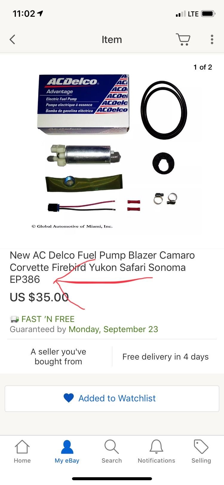

Question are you sure you are getting the TPI pump not a TBI, the TBI is rated at 13-15 psi.
Also you have to have something past the gauge for back pressure otherwise really an open loop should have alot of flow but no pressure. Think open garden hose, then putting your thumb over the end, you reduce flow but increase pressure. We tend to measure pumps in psi but it is really pressure and flow combination that makes a solid fuel system.
Re: LS-5.3 Swap: Low PSI at fuel rail after new pump....
Are you kidding me?? I went back to my purchases and saw the pump. I searched and found that its in in fact a TBI! What a fail. That’s it! Sorry for the enormous pics above. Lemme try to fix.
How do I delete this embarrassing post? Hahah.
I swear. Ebay let me down. I guess I need to do a better job in checking part numbers? FML. So cheapy ebay special pump was probably a damn TBI. THEN I get a genuine AC Delco TBI pump. Wow.
Thanks gang. I’ll keep everyone informed when I get the new/correct pump in

Again..get a walbro 255 and don't look back for a few bucks more that will support way more demand,its direct fit. A TPI pump is still not adequate enough imo.
Thanks for the feed back. Got the new Denso pump in. Fired right up. Wow. What a fiasco. Ugh.
Saving up for a quality Walbro next. Just need to get car running for now. I know that sounds counter productive. But its done.
Thanks again for the help. Good stuff.
Called it lol. Well glad its up and running. Now time to work on the other small kinks as you move along.
