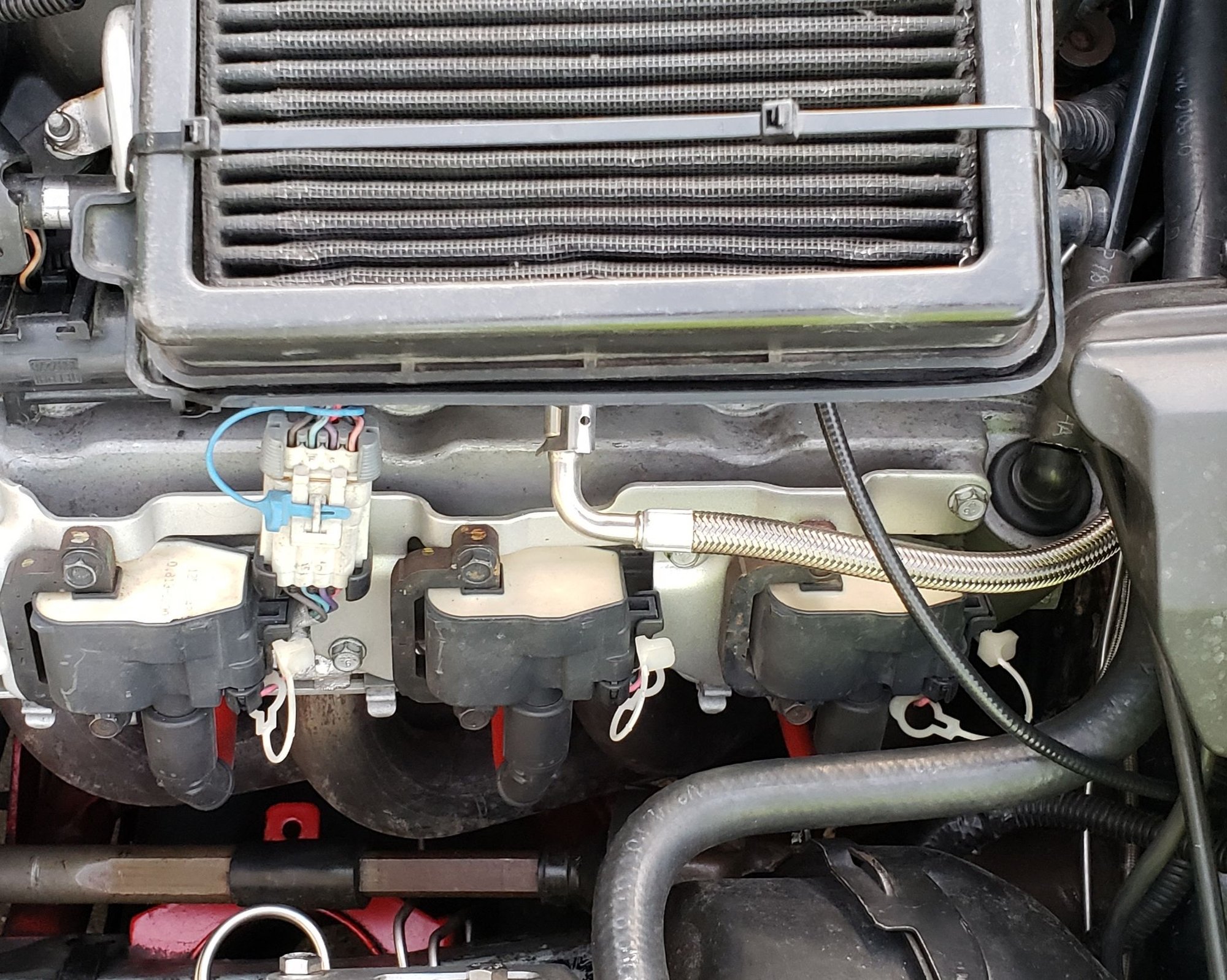

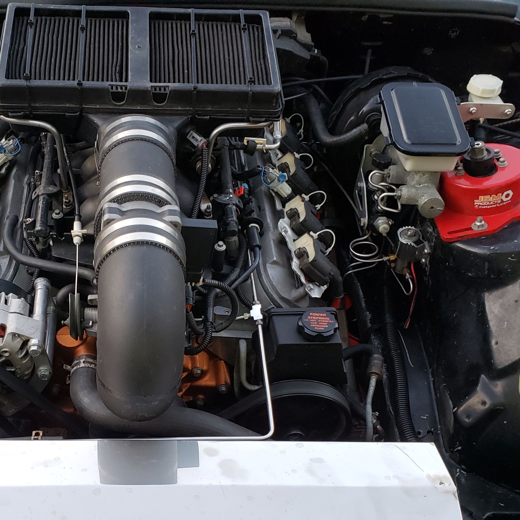

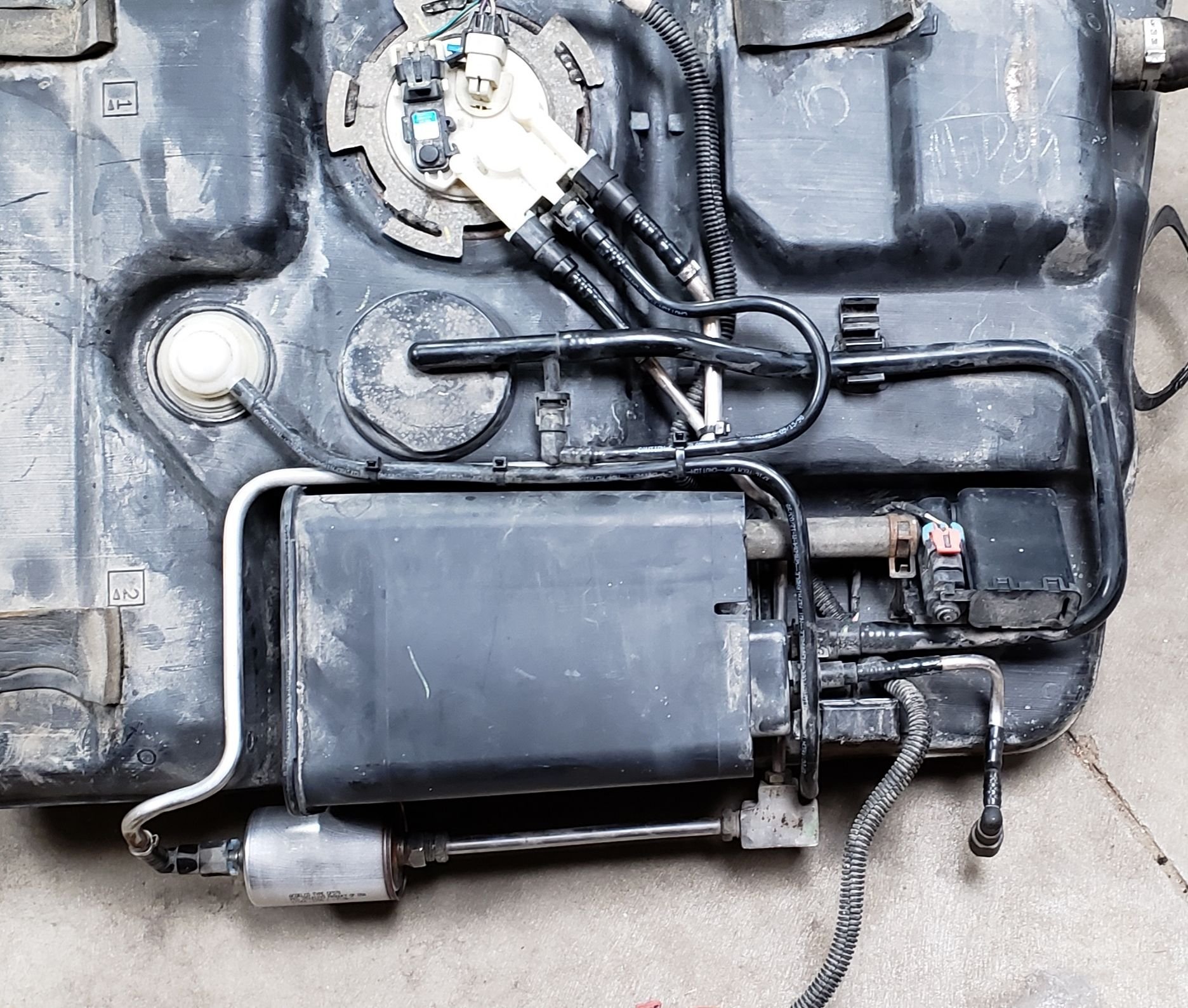

I used stainless and rerouted the feed line and fuel filter to effectively eliminate the return line. I used parts store repair parts for the plastic line and fittings. On the engine end I used a russles 05 GTO replacement, its braided stainless and looks great for $25. I have a tool that will allow me to make the factory quick disconnect flare on the fuel line, that's a tough one to come by these days.
