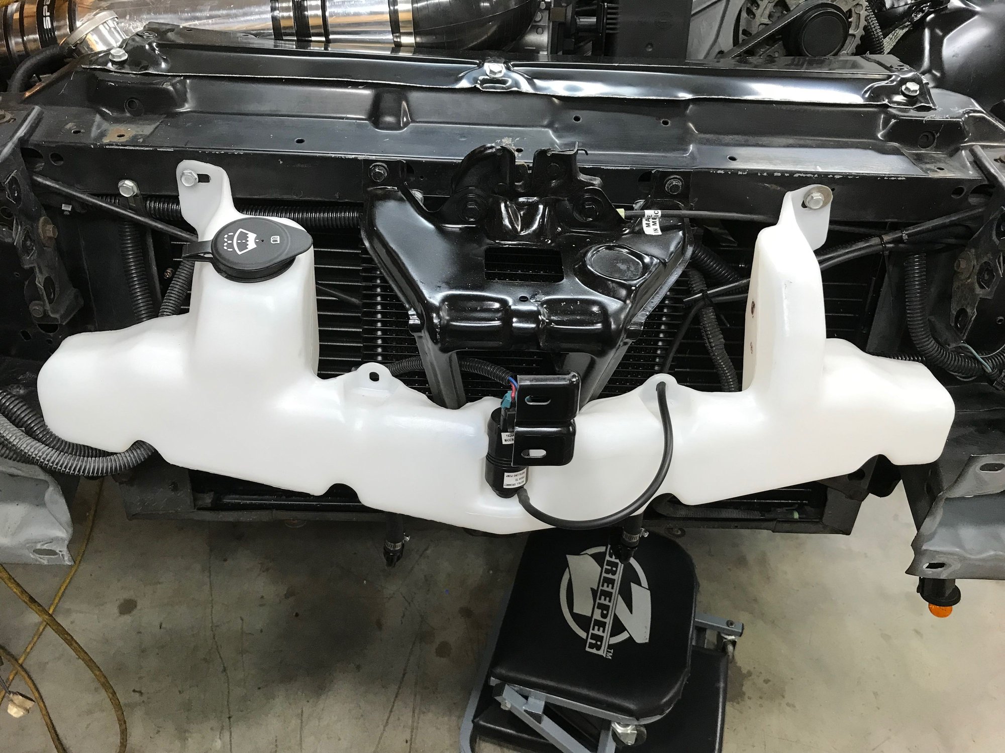

I used the Holley Frostbite and It fits ok. I had to trim the rubber supports and modify a early 70's camaro radiator top support but it seems to work ok
With fans
radiator support
