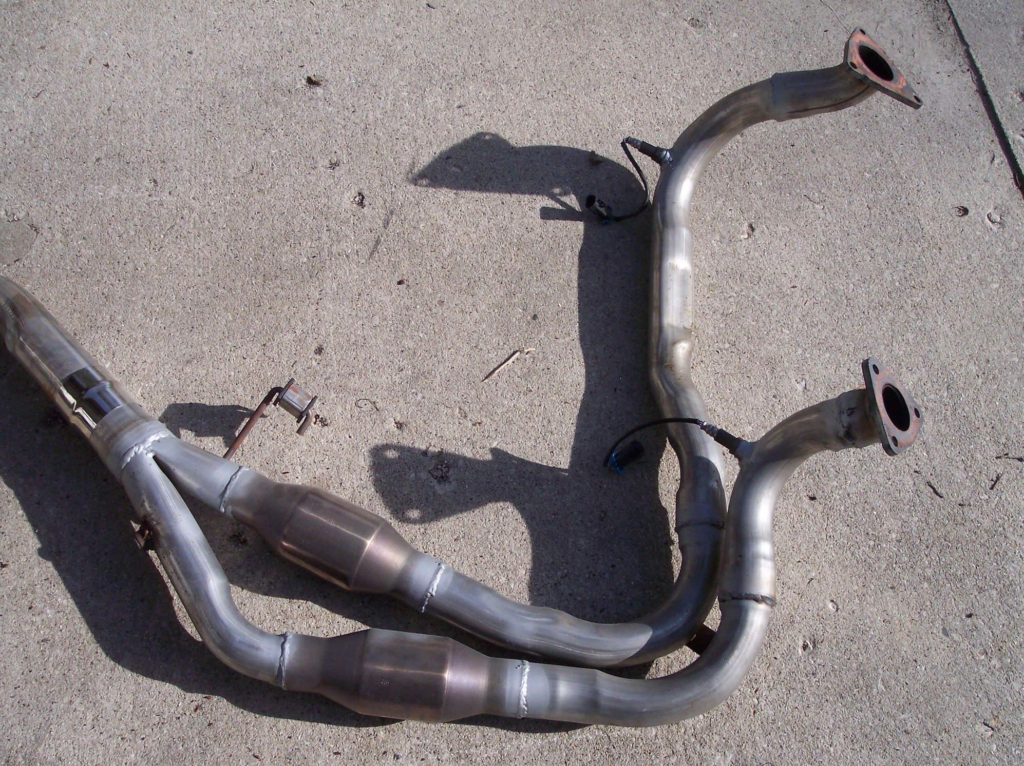

This is the Y-pipe I used with the 2002 f-body manifolds. Clearance was very good. I used an off the shelf 3 inch over the axle to the muffler. The muffler was a 3 inch single in and 3 inch single out that exited under the bumper

No I used a 6L80. This would work for a 4l60 thou because it went under the front of the trans. I used an off the shelf 3 inch from there back with 3 inch in and out muffler with one exit under the drivers side bumper hidden from view.
