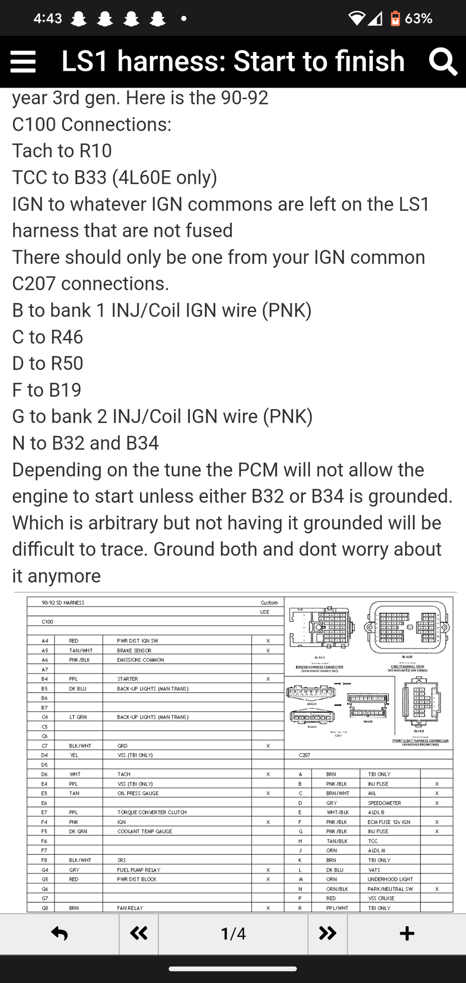

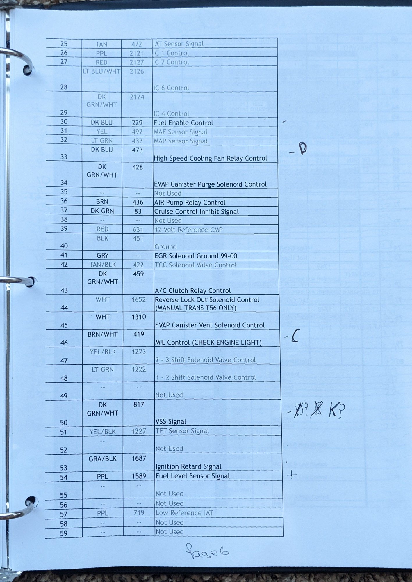

Knowing that we need to splice the 3rd gen harness to the 4th gen is a massive help. However, we are running into related issues. I have attached all of my findings and notes that are related to my questions to hopefully help understand the questions.
We noticed that in the '87 connector C207 the fuel pump relay is located in pin D, but in the '88 pin D is a fan and the entire C207 has no fuel pin at all. Are we missing it or is it located somewhere else, if so, then where?
We noticed that the '87 connector C207 pin K is a VSS buffer to the ECM, but the '88 pin K is just an ECM buffer. I remember reading (Pocket's LS1 wiring guide) that pin K in the '87 was connected to R50 in the LS1 ECM, can we do the same in our '88?
What do we do with C207 pin N? Does it go to B32 and B34, or just one of them, if so which one?
Are the any wires in our '88 C221 connector that we need to rewire for the LS1 ECM?
I read that VATS needs to be disabled in this swap but didn't understand why. Could we get more explanation?
On the '88 C100, what is the difference between E6 and G4? How do they connect to the LS1 ECM and what do they connect to? R9, R30, or something else?
Is there a more detailed description of what each pin does for the '88 C207 connector, what we have is extremely simplified?
Any help is much appreciated.
Pin D C207 is for 85-87 EFI cars. 88-89 Will use C100 G4
Since there is no direct wire from the ECU to electric speedos, the buffer box circuit is recycled. C207 pin K goes from the C207 to the buffer box. Jumper pins C&F on the box to allow a strait shot from the C207 to the speedo. Unfortunately, your 88 camaro will have a mechanical speedo, so none of this is relevant. You'll need either a mechanical driver box or to switch to an aftermarket electric gauge
P/Neutral goes from the shifter to the ECU on auto cars. It is an optional circuit to bump idle when in park/n. B32 for 0411 PCMs. Years past, info on the circuit was sparse, so using both pins was the norm. B34 doesn't do anything without a manual tune in the ECU
88 Should not have a C221
It's a checkbox in the ECU tune
G4 is the fuel pump + feed. E6 was a relay override, often called the price connector. It went to the old ALDL under the column
Qwiktrip posted a link to exactly that
