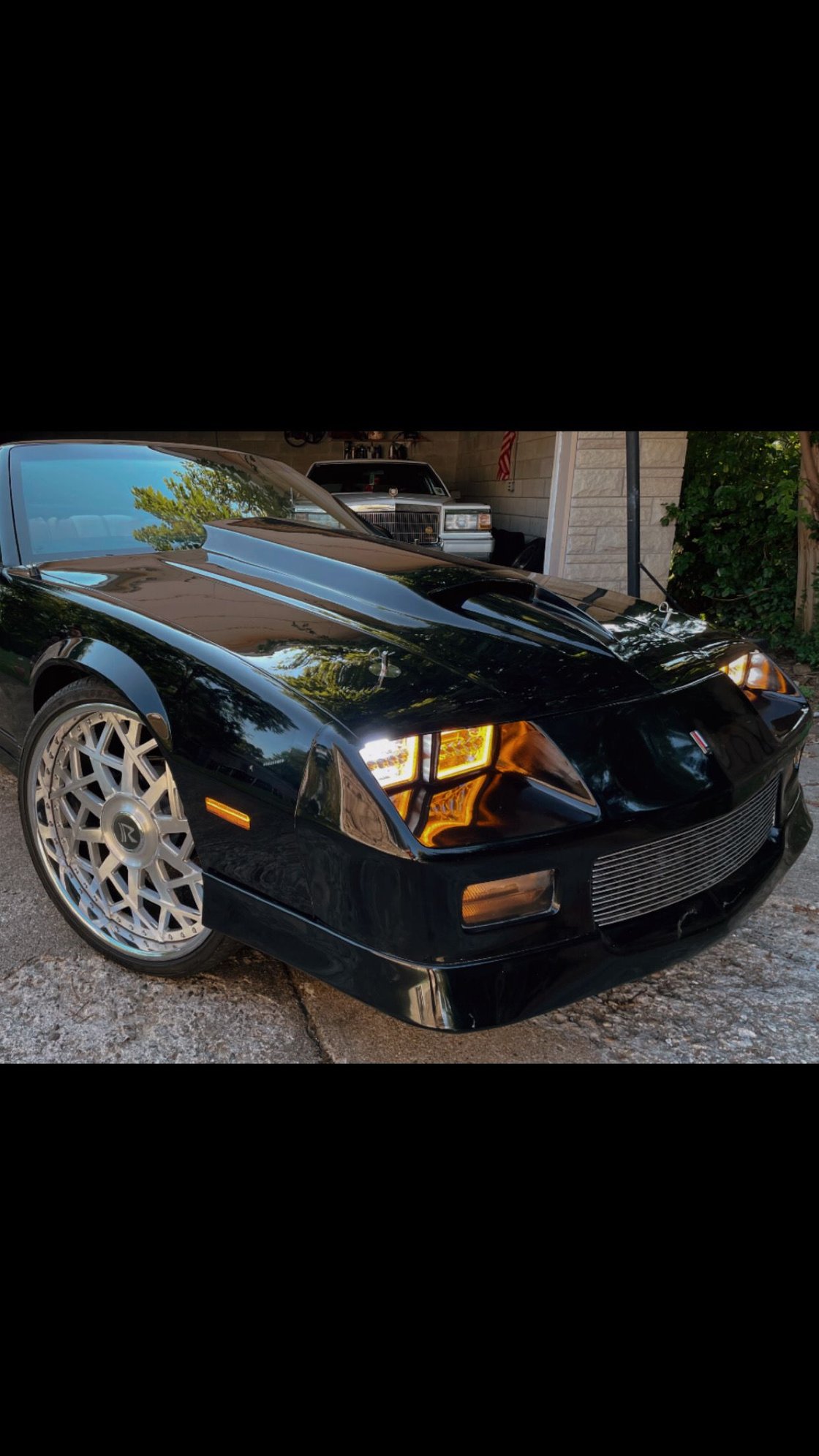

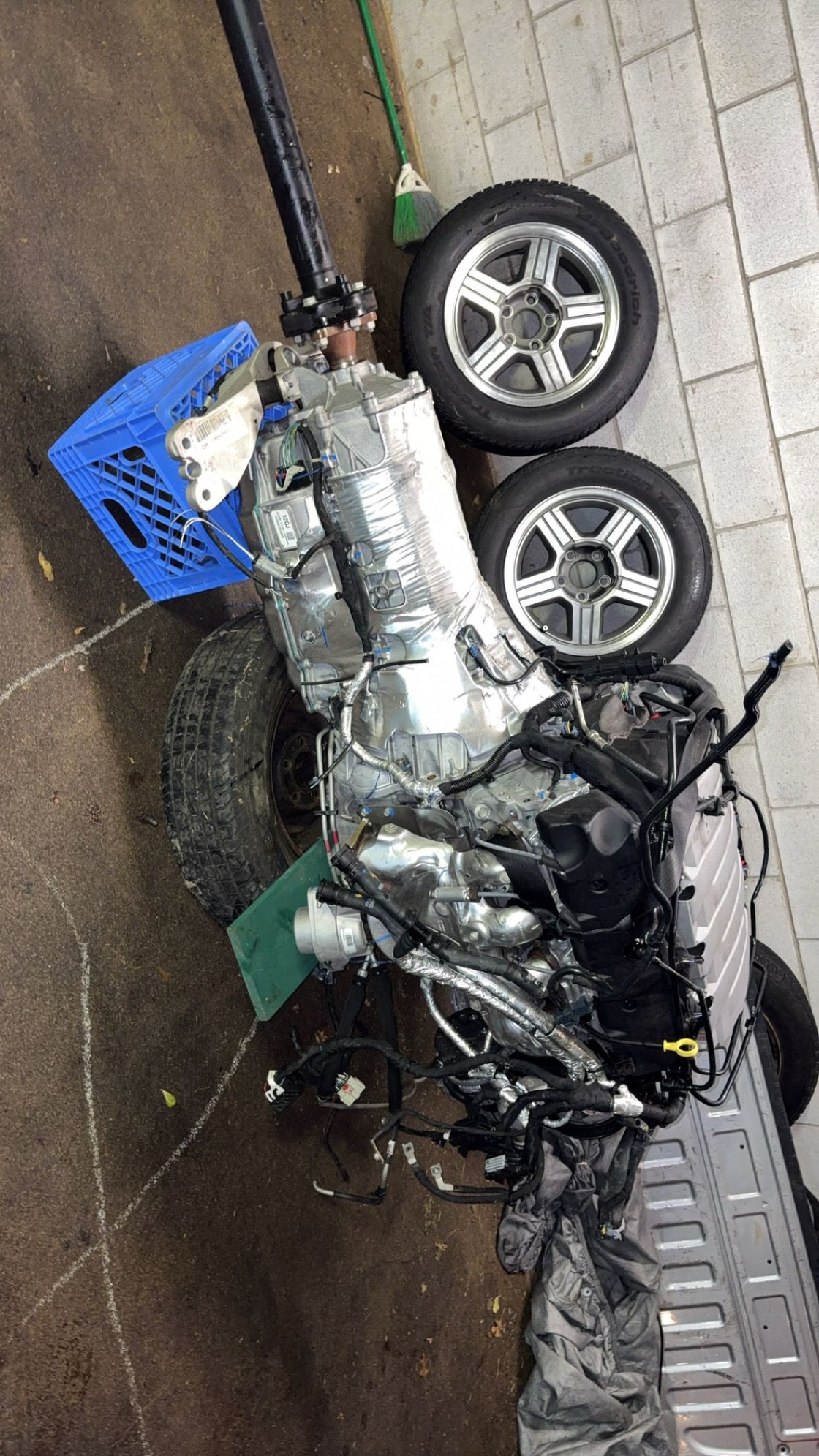

Project:
1989 ThirdGen IROC Camaro Convertible
Donor Car: 2023 CamaroSS
Engine & Transmission:6.2LT1 8Speed Auto
I’m going to try to make this as blunt and straightforward as possible, I don’t know the first thing about motor swaps lol honestly I’ve never done anything remotely as complex. I recently bought a motor and transmission out of a 6gen for a swap on my third gen Camaro. It’s very complicated and there are apparently some things that can go wrong when doing this, who could of known 😂 but the thing is, my buddy had a basically brandnew CamaroSS and he totaled it but the motor trans was flawless with crazy low miles and he gave me a price I couldn’t refuse (under7k for both with the ECU) with low miles that’s almost unheard of, so I took on the project. Here’s the problem. After I bought them I started doing research on the swap and who could do it or help me I’m not afraid of getting my hands dirty and learning new things. And I got some pretty high prices from legitimate sources. Some backyard mechanics in my city offered to take on the job for a few thousand less but, I don’t trust it. I want to make sure this job is done correctly by a skilled professional who has done this before and is highly qualified. Over qualified. Lol this is my dream car I finally have it. In the past weeks I’ve been talking to people about my project and I’m getting alot of different answers most contradicting eachother about the project..
I’m humbly asking for all skilled third gen educated and experienced LS/LT Swappers and any and all of the kind to help me make my dream a reality. I need advice. I don’t know where to even start. To paint you a picture, I have my Third Gen Camaro in the garage with basically a brandnew LT1 engine and 8speed transmission sitting next to it lol I have pretty much all accessories still on the motor and I have the computer I also bought the steering wheel column and the key fob ( I was hoping I could do a remote start keyless push to start situation aswell) but I’m mainly concerned on this swap. Any and all opinions and advice are welcome and appreciated but again I’m looking for experienced people and advice on this swap. For example to start it off, I was told that I need new injectors and a DOD delete because apparently when you do a swap on this motor it will destroy it within months or less. I have no idea if this is true or not. As I said I’m about as experienced as a toddler in this situation so I’m lost. I get the concept and I’m learning but I really want this swap done right and I have blood sweat and tears invested in the car already so I’m really hoping I can get some help.. Did I come to the right place?

The way I'd go at a project like this is I would pull everything out, motor, trans, radiator, AC and condenser, all hoses and lines, drop the k member and raise the front of the car up and move the new stuff in from the bottom and lower the front back down to get an idea of where things are gonna sit. Then start taking measurements.
Another thing I'd do is get rid of that GM 8L80/90 transmission because they're trash and find yourself an 8HP70 transmission for that sweet motor
