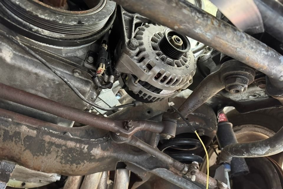

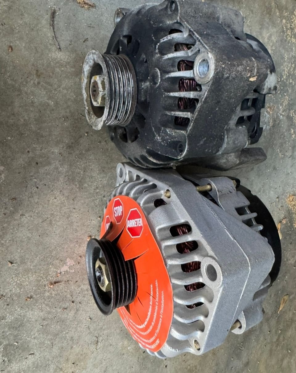

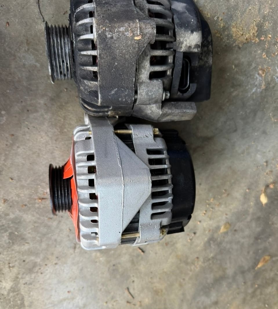

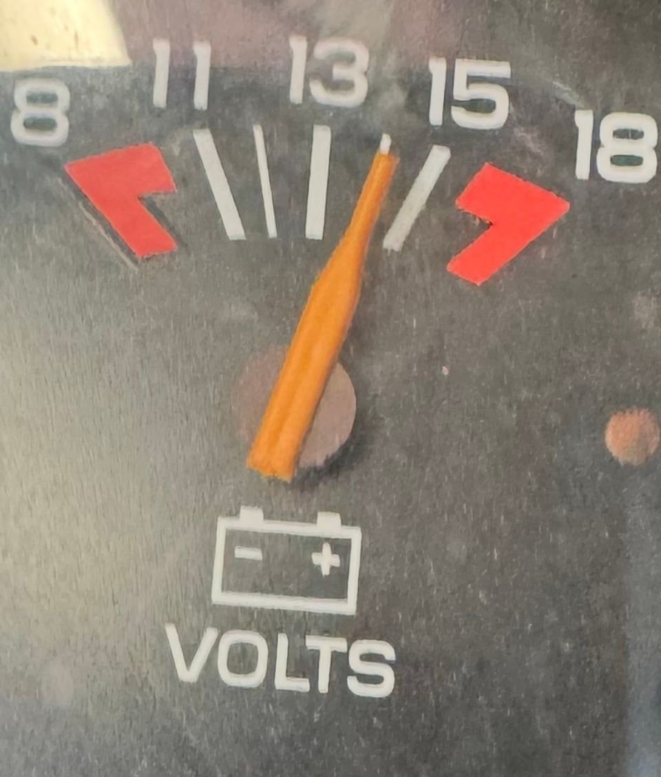

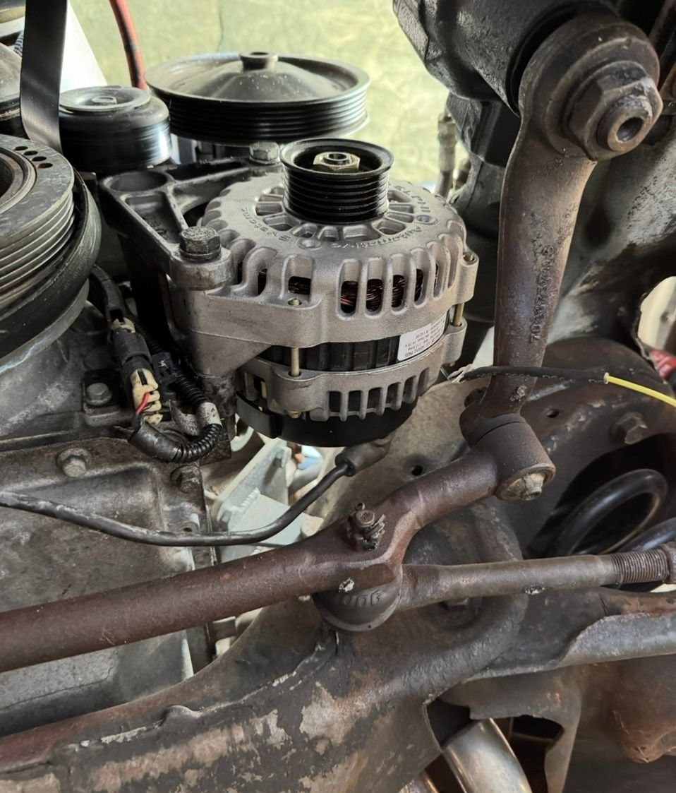

I underestimated the alternator factor of my ls swap. I connected 12v to the 4 pin alternator exciter wire… sans resistor. It worked, but the charge was weak. And the alternator predictably failed prematurely. More research in ls1tech led me to the truck 145 amp alternator and Holley pigtail with resistor inline. This alternator fit and cleared the pitman arm. And my charge is finally over 14v. It’s a beautiful sight.

what engine / brackets are those?
im guessing camaro with the alt down low like that?

Yes, that's it. I used 4th gen alternator brackets which mounts the alternator low under the power steering pump. And I now know a direct 12v connection to alternator exciter input eventually caused it to fail.
