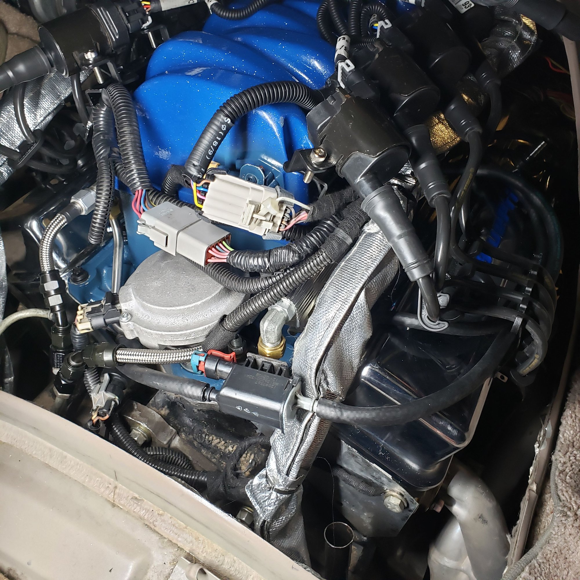

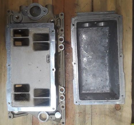

When I bought my Indmar setup it came with the TPI style lid. I picked up the later LS 4 bolt 90 lid for it. I do not see that intake fitting under a thirdgen hood though. It takes almost all the room in my non body lifted Express van engine bay height wise.

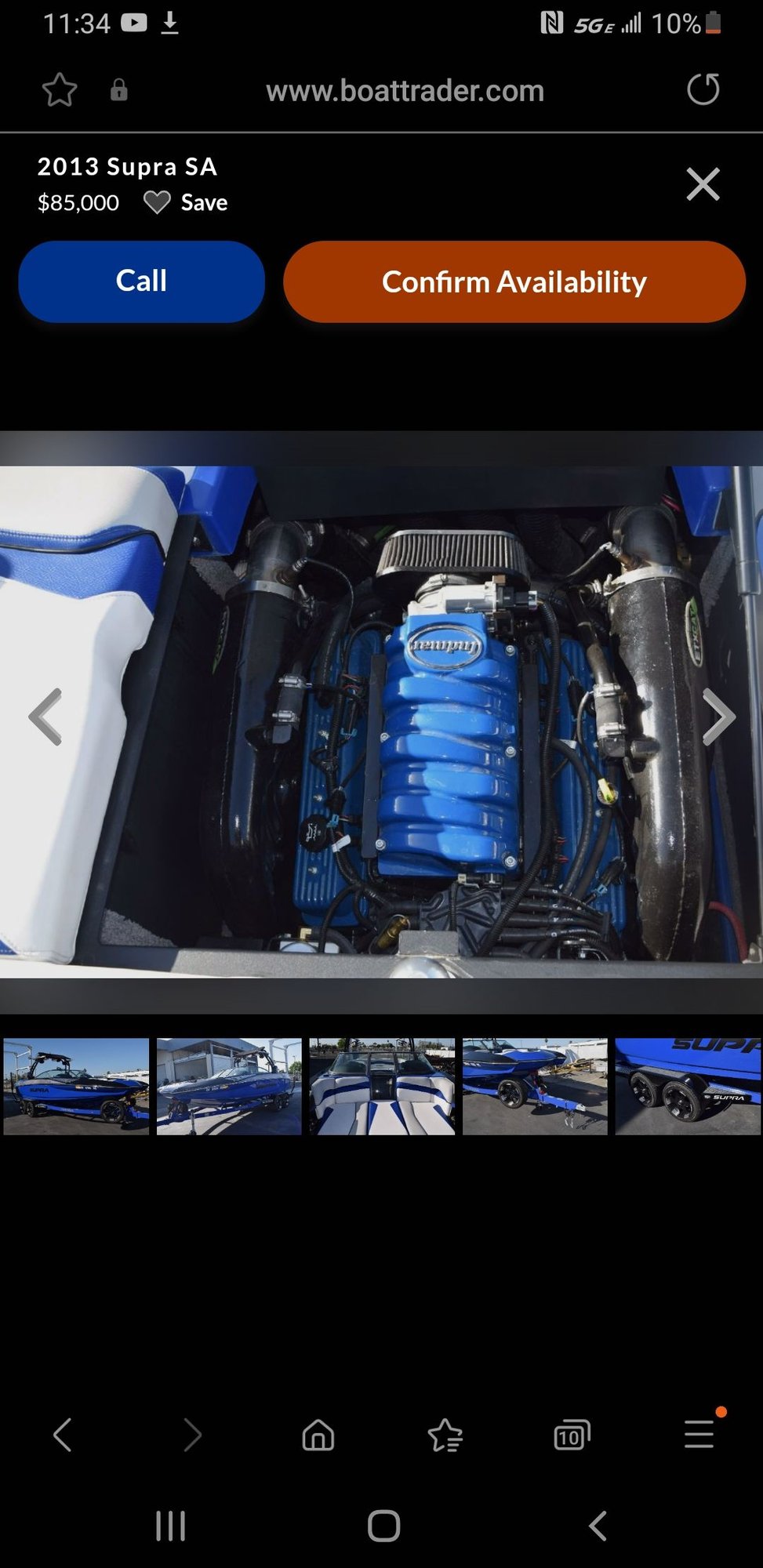

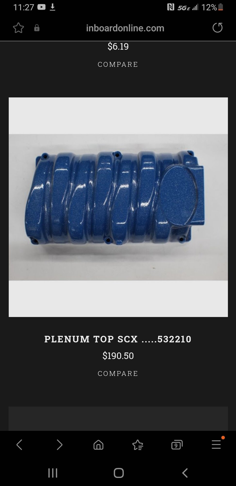

The marine end of things has some nice interesting intakes that I wish Holley or Eddy would have picked up and offered it to the guys on terra firma. That looks like a nice mid range intake and something if I would have known about would have installed LS intake on a gen1. From other posts I think you tow/haul quiet a load. Another interesting intake- price is $$

That is the Ilmor intake. Difficult to work with because it lacks a traditional coolant outlet to allow for a thermostat housing. The ports are also much smaller than the Indmar which exactly matches my heads that Lloyd Elliot ported to the dimensions of a GM FastBurn intake gasket.
I do a fair amount of towing and hauling. The Indmar manifold makes great low-midrange torque with the 219/219 @ 0.050 on a 112 LSA cam I have in the high compression 383. It makes over 400 ft/lbs at 1,500 rpm and 450 ft/lbs by 2,000 rpm and over 500 ft/lbs @ 3,500 rpm.
I have discovered the 6.0L GMT800 truck my P59 tune is based off had factory traction control and in my setup without a BCM and traction control off switch there is not a way to disable it. If I spin the tires it cuts power immediately. I think the P59 PCM is getting ABS wheel speed data from the stock 1997 ABS unit via the Serial connection that was factory wired to the OE Black Box PCM thus it just added traction control from the swap. I actually do not mind it because I drive a lot on gravel and dirt roads going out to our lakehouse and it is easy to overpower traction on those roads.
The only thing I have not been able to get functioning yet is the DBW cruise control. Despite having all the necessary inputs (including the resistance of the brake lights on the TAC module brake light switch input) the PCM refuses to disable the cruise control lockout function. I may temporarily install an 0411 PCM just to see if the combination of the older TAC module and newer P59 PCM are inhibiting it for some reason.
