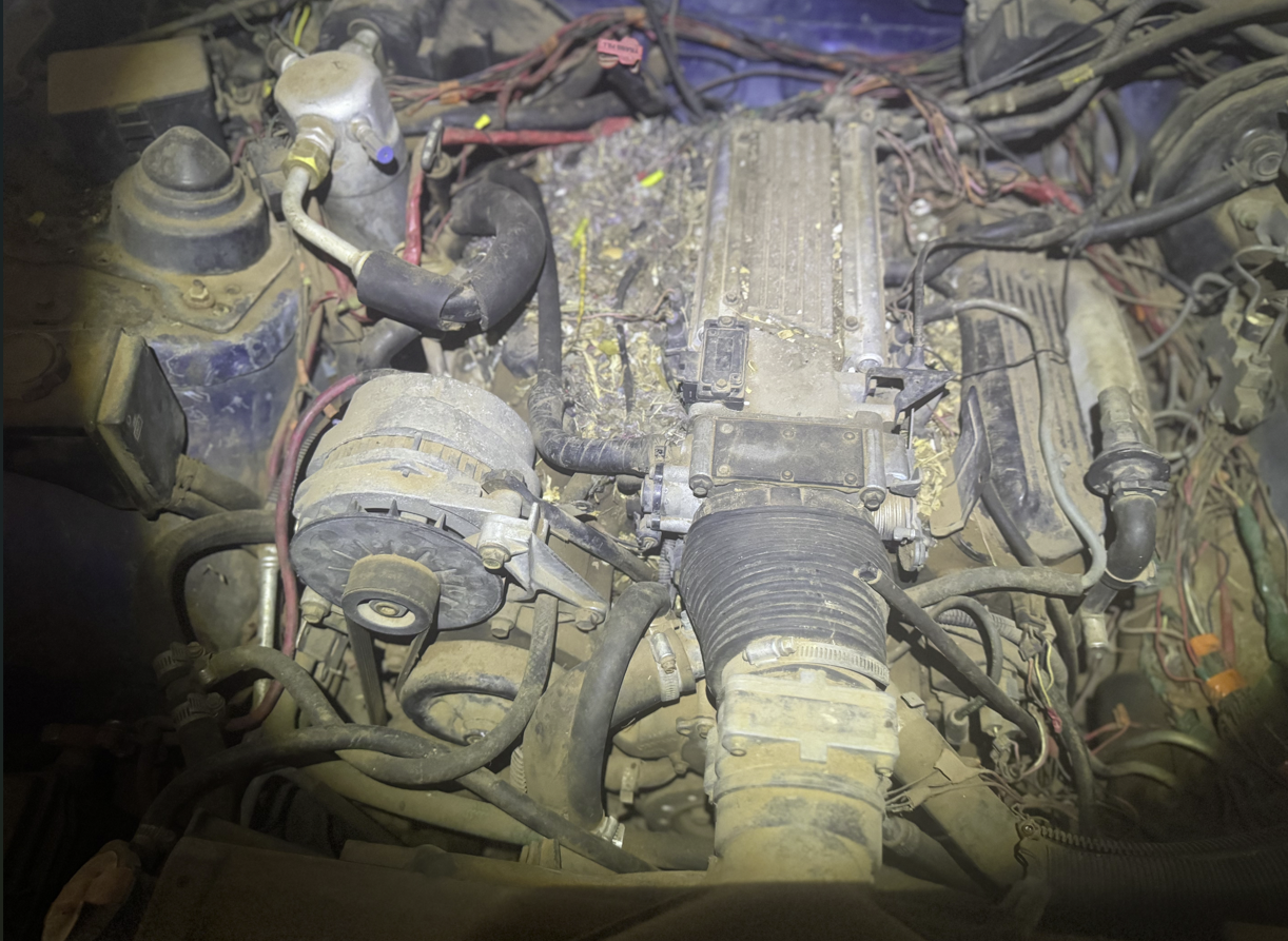

I'm new to this forum and appreciate being added. I'm excited about a car that’s new to me and looking forward to getting it running. The VIN indicates that it originally had a carbureted 305 engine, but when I opened the hood, I found an LT1 engine installed. I hope that whoever did the installation managed to properly redo the wiring so that the dashboard gauges and other components will work. So far, I have cleaned out the engine bay, which had 20 years' worth of debris and rat nests. The sides were filled with nesting material, and I found chewed wires for the injector plugs—it's quite a disaster. As I mentioned, I've cleaned the engine bay, changed the oil, disconnected the fuel pump relay, and installed a new battery. I sprayed some starter fluid into the intake and managed to get the engine to turn over and run for a few seconds.
I went out a few days later and disconnected the fuel lines going into the fuel rail and reconnected the F/P relay in hopes of forcing the old gas out, but when I did, I did not hear the Fuel pump hum, so that could be either bad wiring/chewed wiring, or a bad Fuel pump, etc. However, I’m facing issues with no interior lights or sounds, and I'm not sure where to begin troubleshooting. Additionally, the ECM has been mounted where the windshield washer fluid reservoir should go, which seems strange. I would appreciate any recommendations for my next steps, and I can post pictures of what I'm dealing with if that would help. Thank you!
How I found it!
How I found it!
After a vacum!
After a vacum!
After washing it and getting all the rats' nests and dirt out!

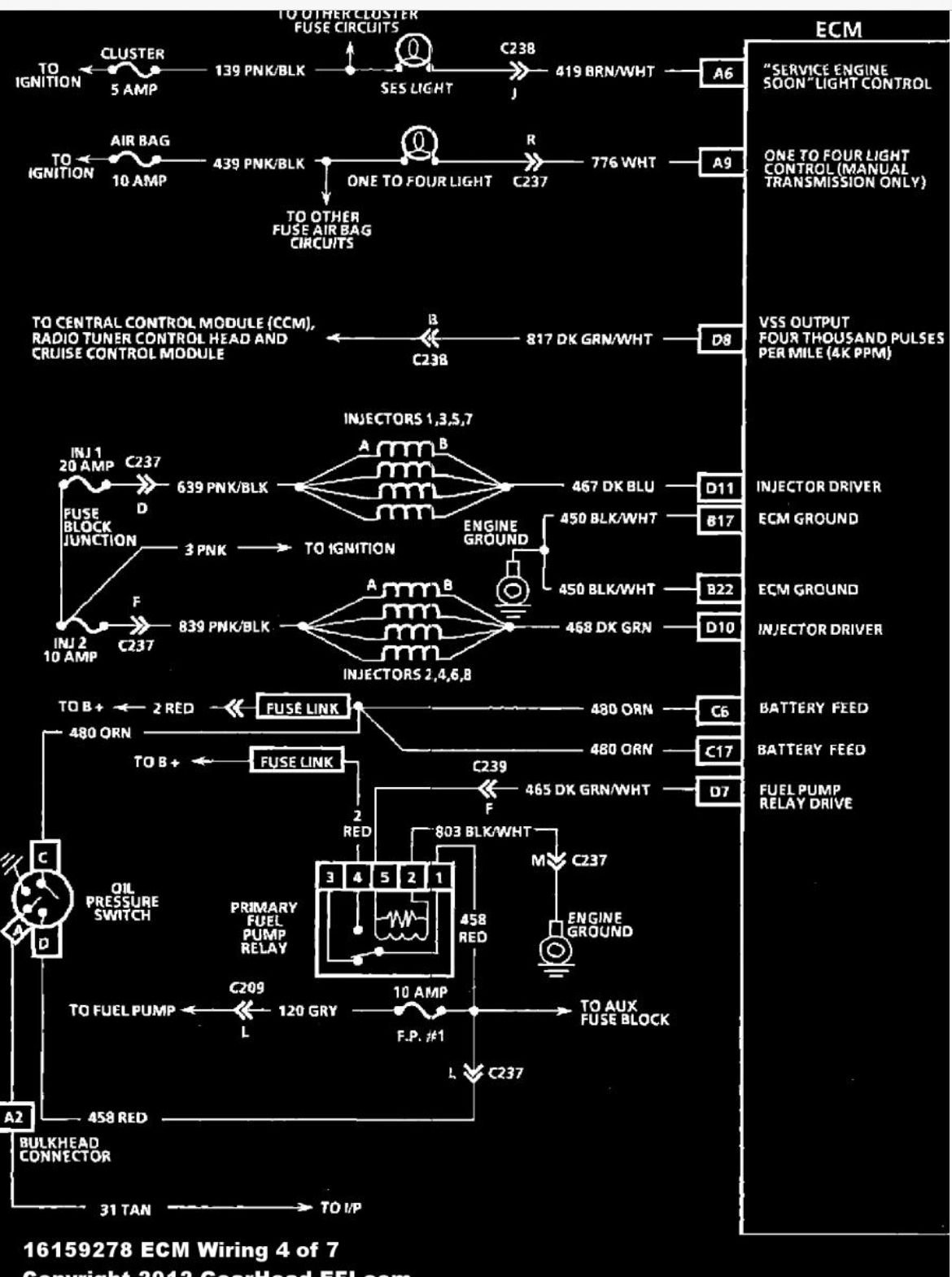

Re: 1986 Iroc with 93-94 LT1 Swap
