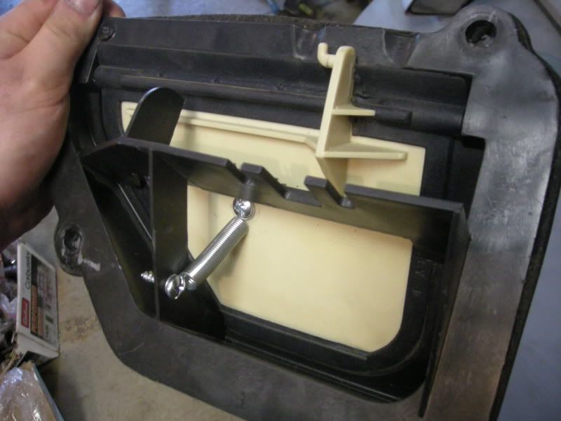

Originally Posted by FueledSoul
whats the purpose of this if any of you guys know

That's the inlet air peace. I had to take the diaphragm off it so i could fit fab up wiring board by it with out it interfering. I used a spring inplace of the diaphragm, im using this as a pressure relief when i shut the doors or hatch air now has a place to escape with out blowing out gaskets.

oh and i already had a explanation for this above thos pics you quoted.
but yea basically using this for a pressure relief now
