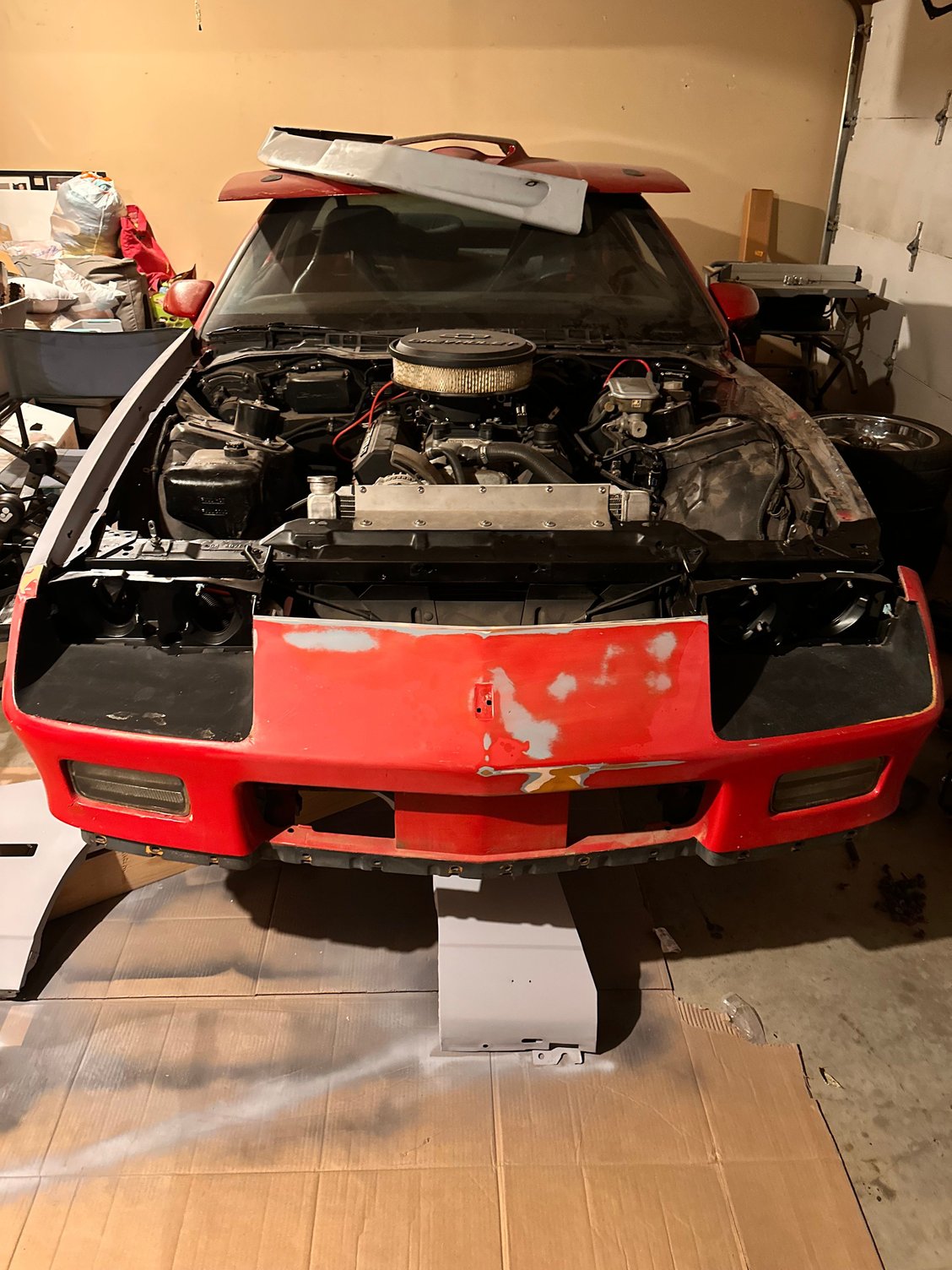

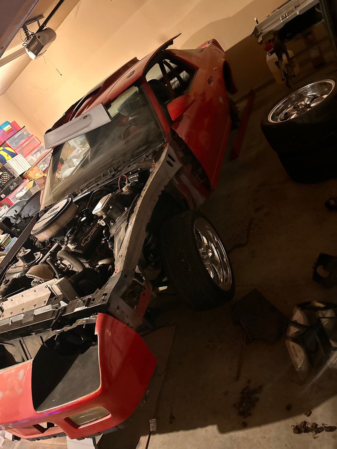

Well, I was able to get my car back. Started yesterday with replacing some parts that have worn out or where broken. Had to replace the header panel that house the headlights because of a missing stud to mount the fender. Also started doing some body work and hope to have the whole car in primer over the next couple weekends. I filled in the fender power antenna hole and am repairing ground effects. The interior has gotten trashed from the sun over the past 5 years so I'll be replacing a lot there. I need to pull my LT headers and fix some dents from bottoming out. So basically, I have a lot of things that need addressed to get it back into great shape. Totally see a lot happening in the next few months. Pics to come.

Started working on body work. Plan on getting it all in primer before Jan.
