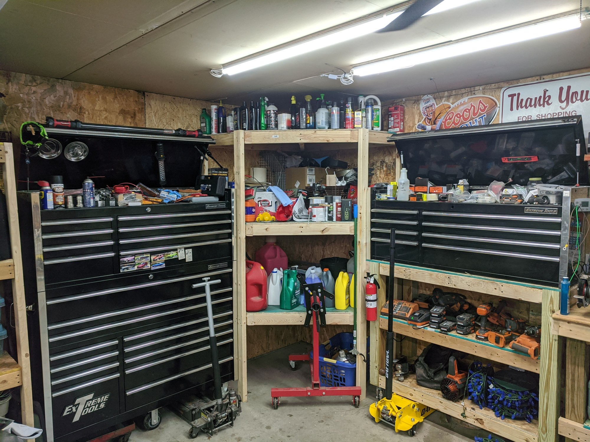

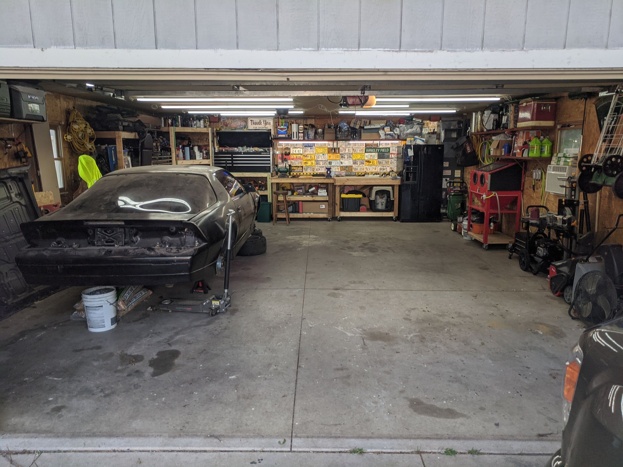

Now have a 24'x30' heated and cooled garage.
Upgraded my tool box situation thanks to Home Depot getting out of the "Fancy Box" game

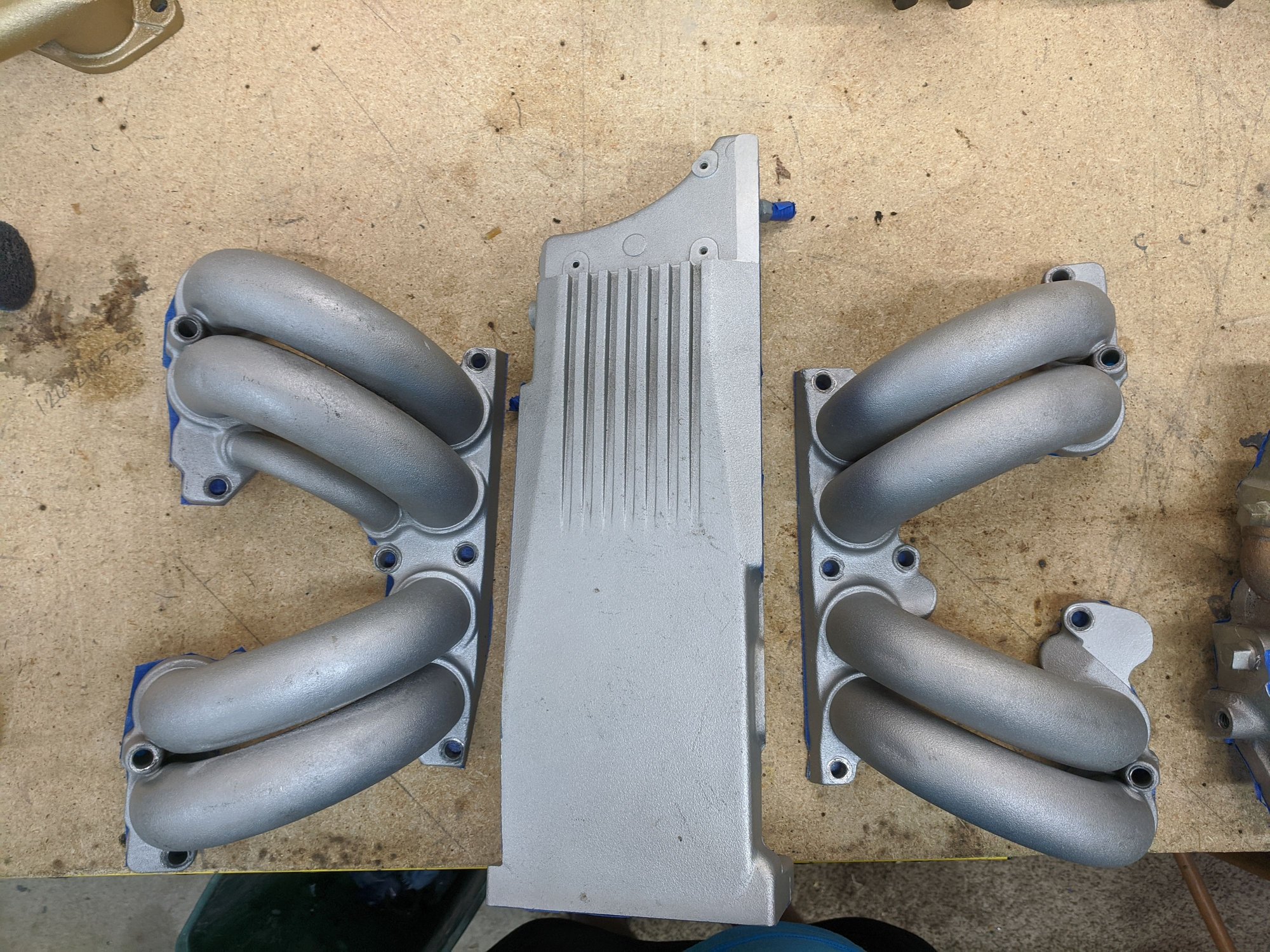

next up I pulled the intake off to re-seal it and found out a mouse thought it would be fun to leave a peanut in my motor and pee and poop at will. Figured since I had the intake off I would paint it gold to add some flare to the 'ol engine bay.
Cleaned and scuffed everything up, taped off the bits, and then sprayed on a few coats of VHT SP132 Universal Gold high temp engine enamel.

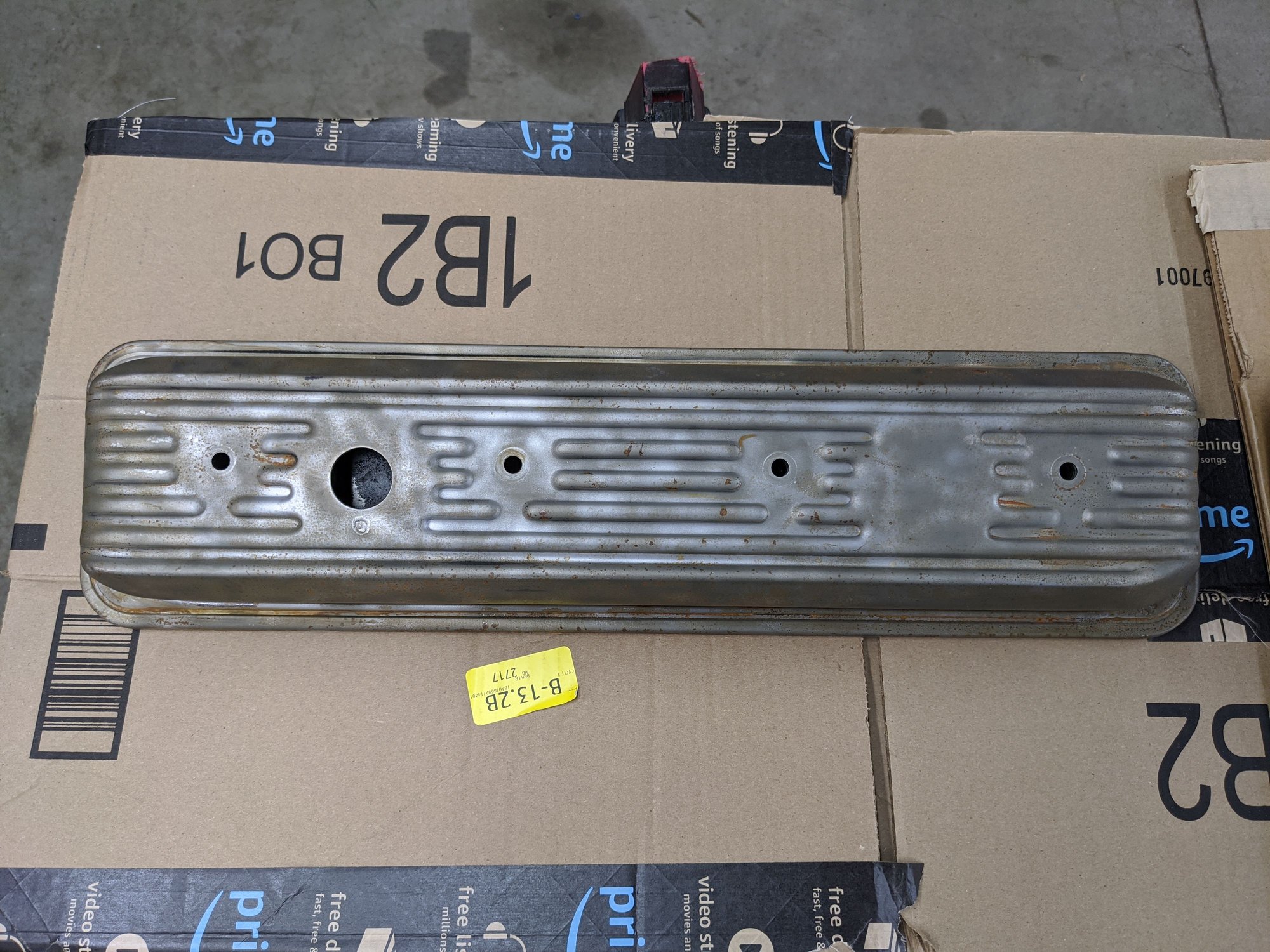

Sometimes my OCD makes me open up a can of worms and tuns my "quick projects" into something completely different. Case in point is my buddy commenting that its too bad the fuel injection setup won't look as nice as the newly painted intake... Next thing I know I'm buying a Harbor Freight blast cabinet and modifying it because YouTube told me I should lol! First issue was that my Craftsman 6hp 33 gallon 115v oil less compressor can't keep up with and I can get about four solid minutes of good blasting before I have to stop and let it catch up. Issue two is that the compressor runs so much that after 40 minutes I start to get moisture in the air lines.
It took me three days of tinkering with the cabinet to get the fuel rails and valve covers stripped, and at that rate I was going to be at it for a while. My solution to all of this was to sell my 33 gallon Craftsman and buy an 80 Gallon Masterforce 220v single stage compressor lol. Oddly enough it was cheaper then buying a 60 gallon due to it being on sale and the 11% rebate. I ordered it on May 29th and am hoping it'll be here this week.

Wow, your life sounds a lot like mine! Bad back and all. I too, also got sick of waiting on my old compressor and just upgraded to a 80 gal 220v compressor. Life is good now, lol. With the fast system, you should have sequential fuel injection. Way better than the batch fire that the factory system used.
Looking good, and LOVE your shop!

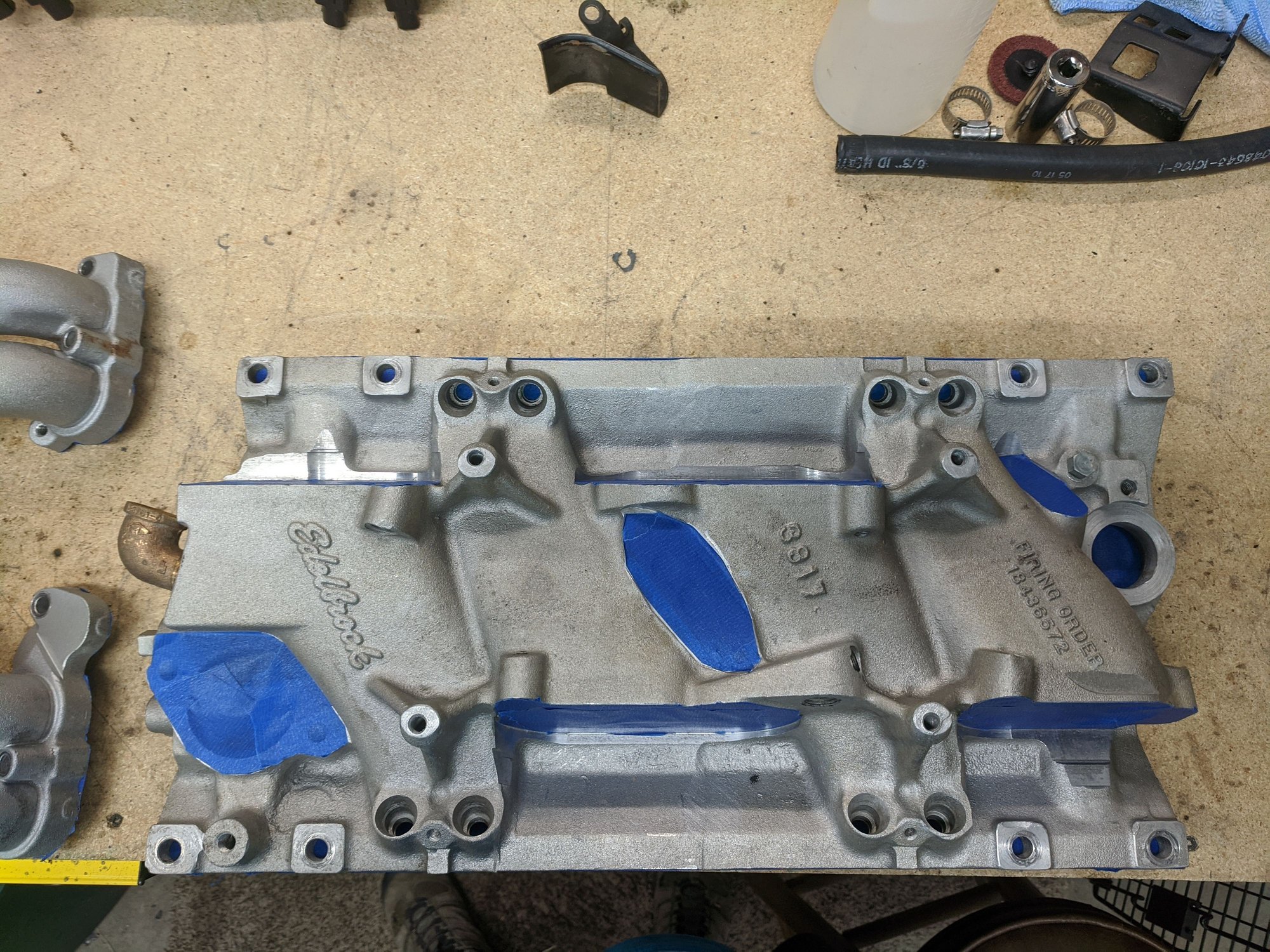

So after dealing with some subpar hose on the new compressor I am finally back to making progress on the IROC. Blasted the fuel rails with glass bead and after a good cleaning I installed new o-rings and got them all bolted back together. Since I'm an idiot and never had the injectors tested the first time I installed the TPI I had them tested and five of the eight were bad, so $360 later I'm now the proud owner of a new set of 30lbs/hr Accel injectors courtesy of Summit. Put the newly purchased bits into the newly cleaned bits and then installed all those bits onto the engine tonight after work. It only took me 3 hours and four beers to get it all bolted back on lol!
Blast quality was poor with the old compressor.
POS Python mystery injectors
New injectors with the harness adapters installed.
Newly blasted rail installed.
Plenum bolted back on.

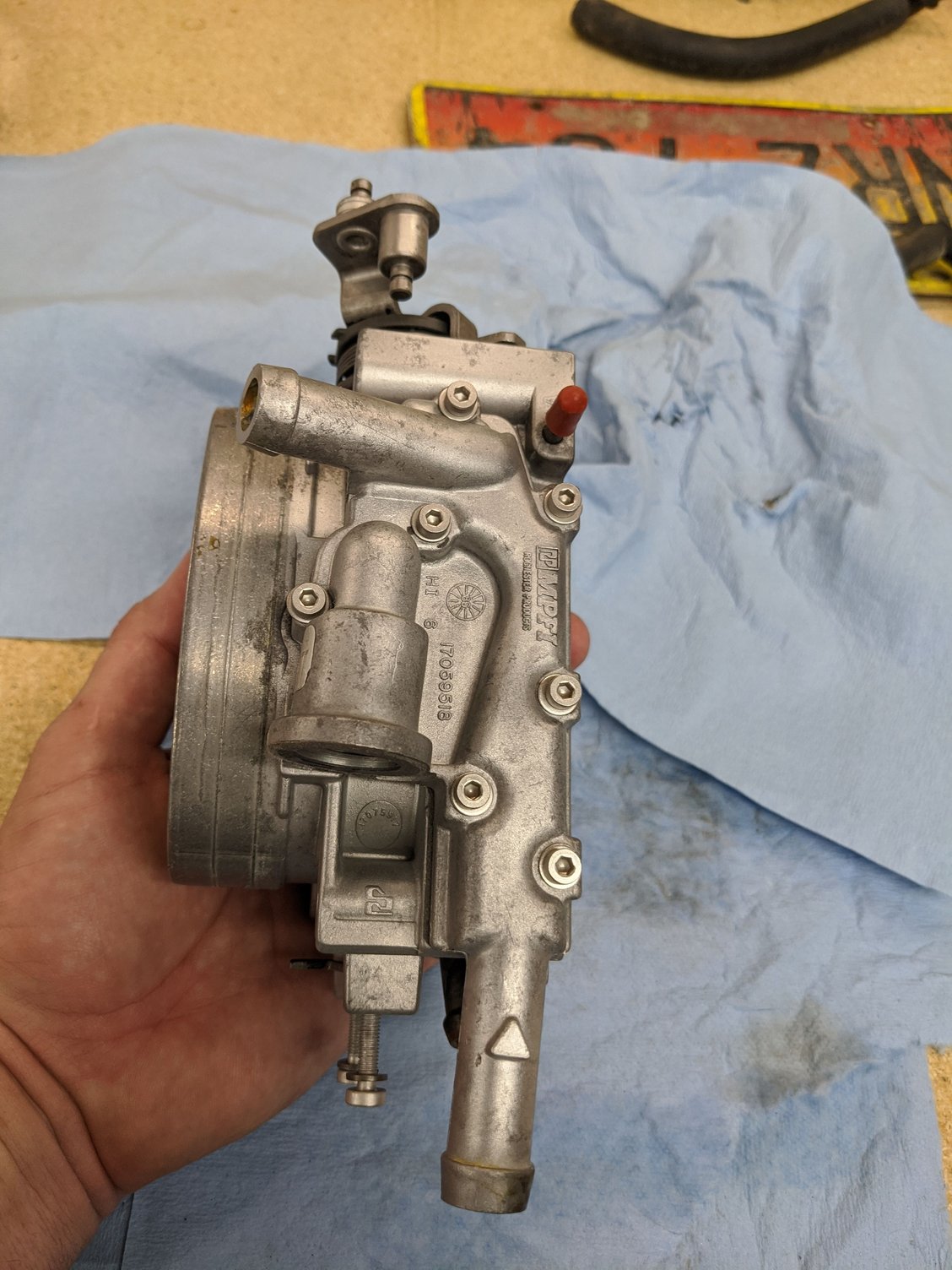

Pressurized the radiator and it revealed a leak on the rear driver's side of the engine. With all the stuff crammed in the bay I couldn't tell if it was coming out of the head or the intake to I took off the TPI plenum and runners and found out the intake is leaking from under the rear runner right where the coolant passage is. So either the guy I bought it from off of here sold me a cracked intake or it developed a crack when I installed it. Luckily Scoggin-Dickey still has them, so I placed a order for a new one...

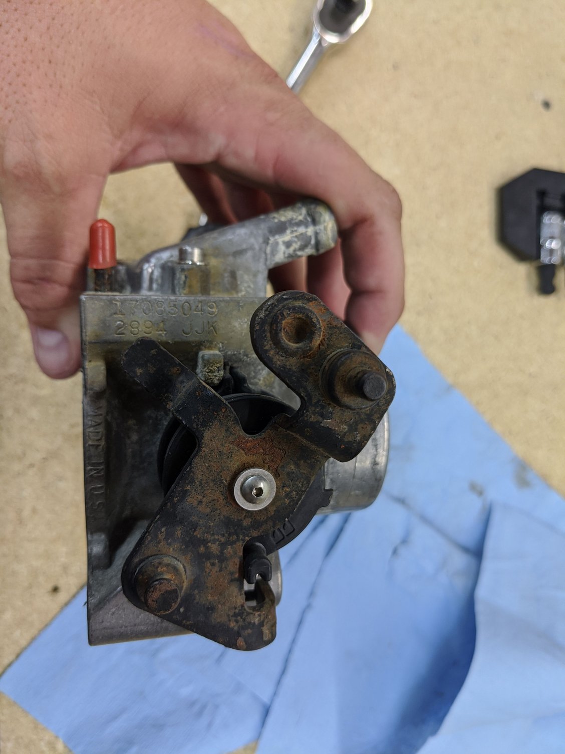

Since I had such good results blasting the fuel rails I decided to toss the throttle body into the cabinet and clean it up a bit too. Used the crushed glass media already loaded in the hopper and it looks a lot cleaner then before and will work just fine. As always I plugged and taped up all the areas I didn't want media to get into and then blew and washed it off once it came out of the cabinet.
So I guess while I'm waiting for the new intake base to show up I'll focus on the interior a bit and see if I can remember how to put the dash back together lol!

Well the new intake showed up from Scoggin-Dickey so I got it painted up and installed on the car. Now I have a running car however now the timing needs to be set because the vortec motor timing marks were set to zero from the factory. Since I'm running the stock balancer I have no way to know when it's set to 20 degrees and at this time I'm not too sure if I can get the FAST computer to recognize that it's set at 0 currently. With that being said I have decided to take a break from messing with the motor and focus a bit of time on the interior.

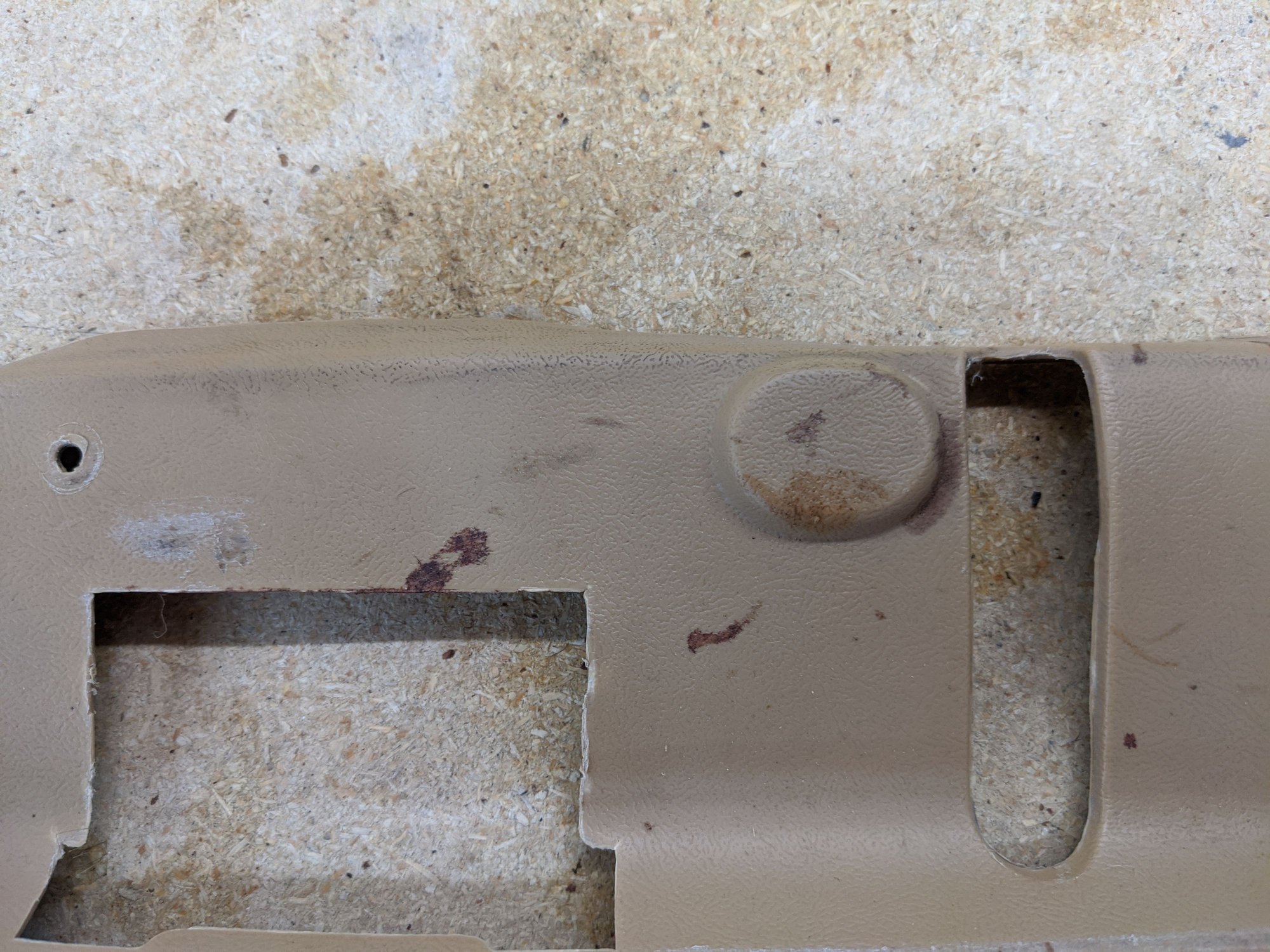

Now that I have shifted to interior mode and it has been beautiful out it is time to clean and dye the interior plastics. If you have been following this thread for a while then you will know that this car was infested with mice and was absolutely disgusting inside. I have found that a little warm water with some Dawn dish soap, a Magic Eraser, some prep spray, and a no scratch sponge will really clean these these things up.
As for the process of applying the dye, I treat it just like I'm painting any other part. Clean with soap, wipe with prep spray, three light coats of adhesion promoter, and then three to four coats of the SEM saddle tan.
Before the magic eraser
After the magic eraser
What I'm using to complete the job
Cleaned and ready for dye
Left has been dyed and right is cleaned, but has not.

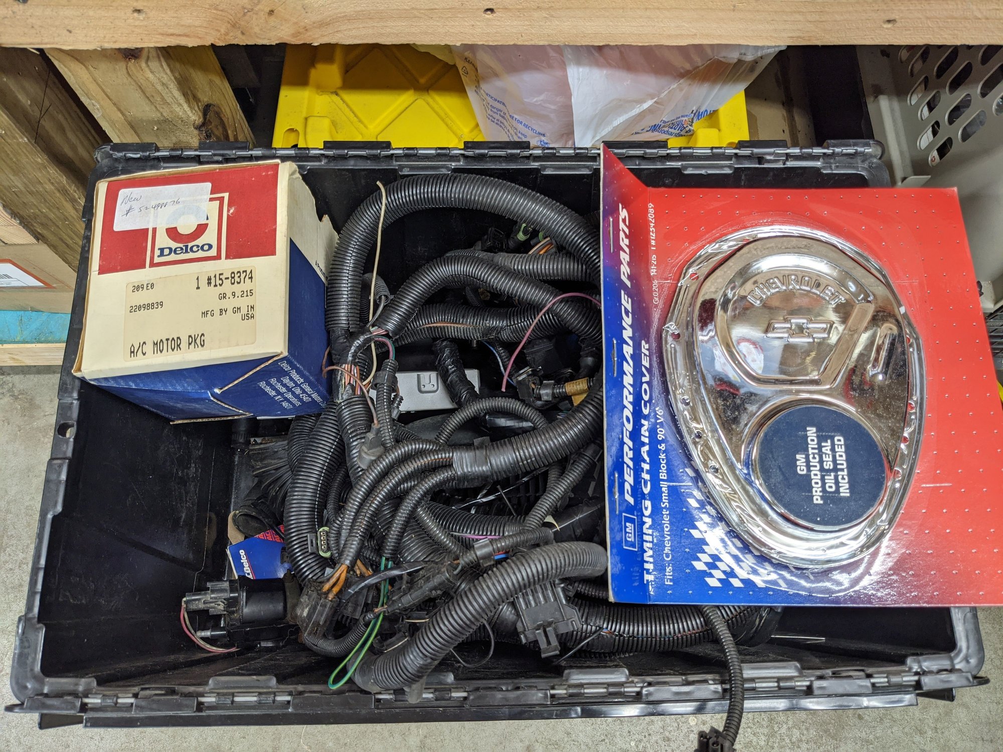

So Saturday night as I was laying on the couch drinking beer, thinking thirdgen thoughts, looking at Facebook Marketplace, and fending off kisses from the dog, I found an add for "pre 1987 small block parts" for $250 about an hour East of me in Omaha. Messaged the guy and setup a 2pm meeting on Sunday. Guy messages me Sunday morning asking if I was a serious buyer and if I could meet him at Noon instead. I agreed, we met, I handed over $250, and this is what I got for my money...
NOS blower motor, chrome timing cover, harness, ECU, extra PROM, distributor, extra cap, and misc hoses.
Once I had paid and was getting ready to leave he asked if there was something special about this setup because fifteen people were in line if I flaked or passed on the deal. I told him that if the runners are SLP then they are going for $400+ a set on eBay. He looked kind of bummed and asked if I was going to flip the setup and I told him no that I'm a hoarder and will put the runners on my IROC and stash the rest lol!

Spent most of last week clearancing the the SLP Runners and intake base base using some carbide burrs, Roloc discs, and my electric bandfile sander. I took my sweet time since I only wanted to remove the minimum amount necessary to get the fit right and keep the metal shavings out of the intake. In the end the runners needed material removed from the top where the fuel rail was hitting and on the bottom where it was hitting the intake and a few of the lower intake bolts, while the only place on the base was on the rear driver's side.
Overall these runners fought me almost every step of the way, but I really like the way they look.

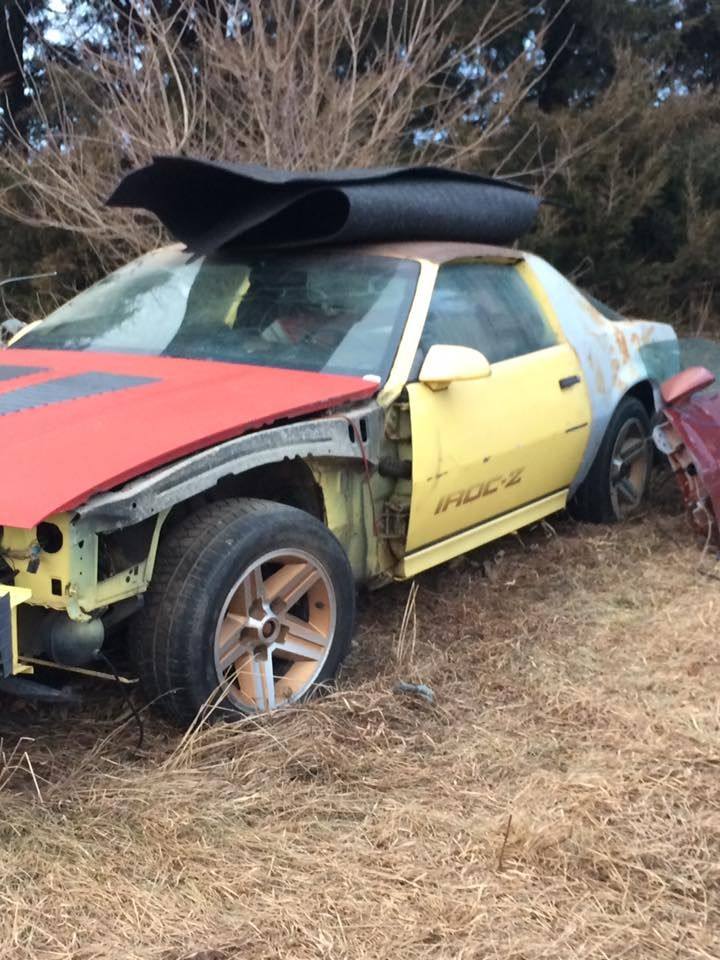

After finishing up the SLP runner install on Saturday I decided to head about an hour and a half Northwest of me on Sunday in Dodge, NE. to look at an '85 IROC a guy posted up for $1200. Figured since it had a title and the guy stated it was rust free that I would pick it up for a parts car, or possibly add one of my TPI setups to it and flip it. So after driving grabbing my trailer and putting eyes on this thing I decided to drag it home and add it to my collection because there was something really familiar about it.
Once I got home I jumped on my computer and looked for some pics of a car I tried to buy in January of 2017 located two hours West of where this car was sitting in Loop City. Sure enough this is the same car, but with different wheels and some body work done to it. If I remember correctly the guy wanted like $2k - $3k for it in 2017 as it sat and I paid a lot less then that on Sunday lol!
I asked the seller who he got it from, and he said a guy in Columbus a few years back, which is right in the middle of the last place I saw it and the seller's location.
Talk about small world and stuff coming full circle lol!
Pic from 2017
Pic from 2017 where you can clearly see that the windshield is broke in the exact same place.
As it sits today.
