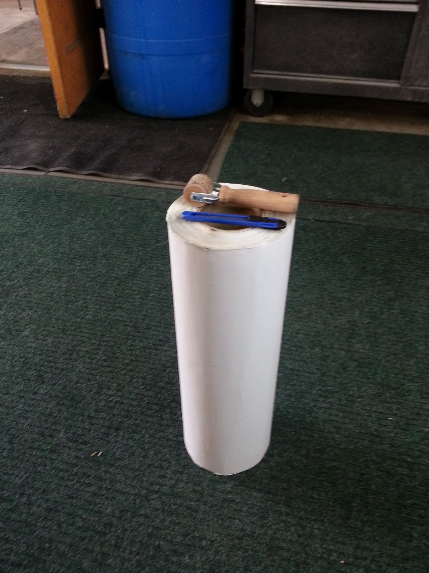

Put the sound mat down next and went with some "Fatmat" i found on eBay for $149 for 100 sqft. It went down really easy and even came with a roller and knife.

Apr 2, 2016 | 09:14 AM
Re: Second chance after 12 long years!
So how much of the fatmat did you have left over? My car's gonna need a lot of sound deadener. lol
Reply 0
Apr 2, 2016 | 09:19 AM
Quote: So how much of the fatmat did you have left over? My car's gonna need a lot of sound deadener. lol
Kit came with two 50sq/ft rolls and I used very little of the second roll. I would say a good estimate would be 60sq/ft total for e erything I did.
Reply 0
Apr 2, 2016 | 09:33 AM
Awesome. I was hoping that'd be enough to do the camaro and the trunk of my other car. Sounds like it will. Now just let us know how much it helps lol
Reply 0
Apr 2, 2016 | 09:19 PM
Quote: Awesome. I was hoping that'd be enough to do the camaro and the trunk of my other car. Sounds like it will. Now just let us know how much it helps lol
Even though I have yet to drive it, I can tell a difference when I shut the hatch and doors. It has a more solid sound and is less "rock in a tin can" sound.
