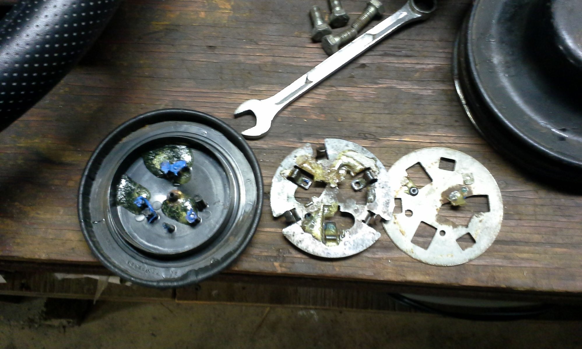

Old horn that was badly broken and glued together, I'm not sure how someone managed to break it in the first place.
Old wheel with no vinyl
New used wheel on and put my steering wheel cover back on it.

I replaced the motor mounts today, took about 2.5 hours and was a lot easier than what I had read about it in forums and I did it by myself. I stuck an open end wrench through the hole in the frame near the spring to remove the top nuts then stuck a socket through the bottom next to the A arm to remove the bottom nut. To reinstall I put grease on the nut and stuck the washer to it then put the nut in the open end of the wrench and stuck it through the hole in the frame near the spring and threaded it on by turning the bolt by hand. I did lose one of the big washers in the frame when I was removing it and after 10 minutes with a magnet gave up and just put a different washer on. Doing it this way is the easiest way I could think of, some said to use swivels and sockets on all of the nuts but that's almost impossible.

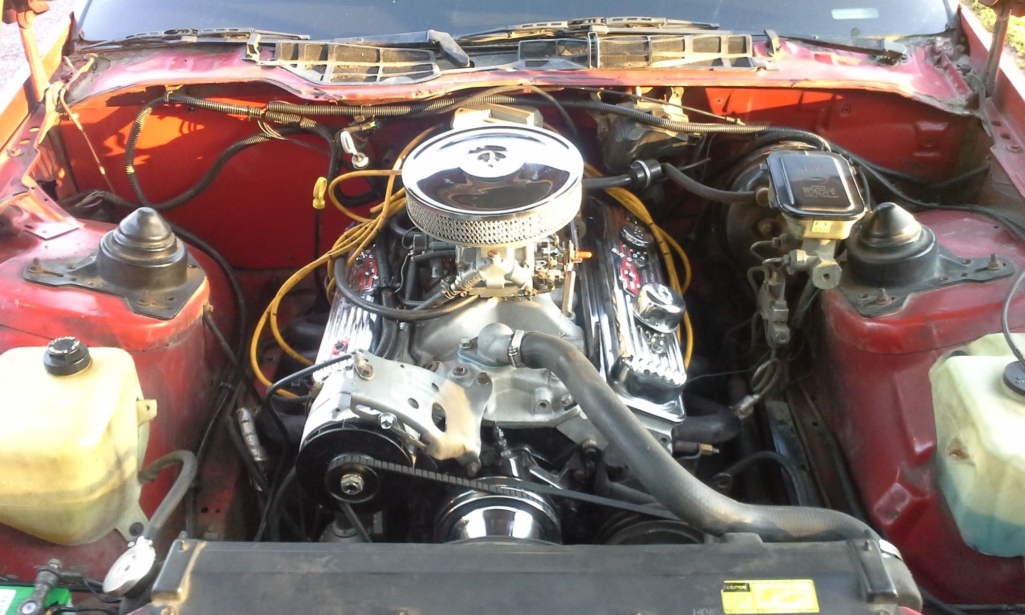

Rebuilt and painted, just waiting on a new distributor gear

Back in and running good

Got the motor back in last weekend and has been running good so far, now I just have to put some miles on it.
Basics of motor are:
GM Performance ZZ3
Bored 30 over with Speed Pro pistons
LT4 Hotcam
1.6 roller rockers
Isky valve springs
Polished crank and balanced rotating assembly
Replaced all bearings
High Pressure oil pump

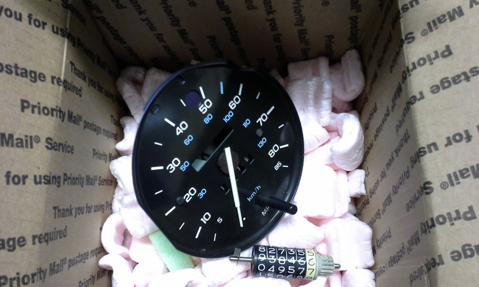

Finally did the 145 mph speedometer swap, swapped the odometer too so my mileage stayed the same.
