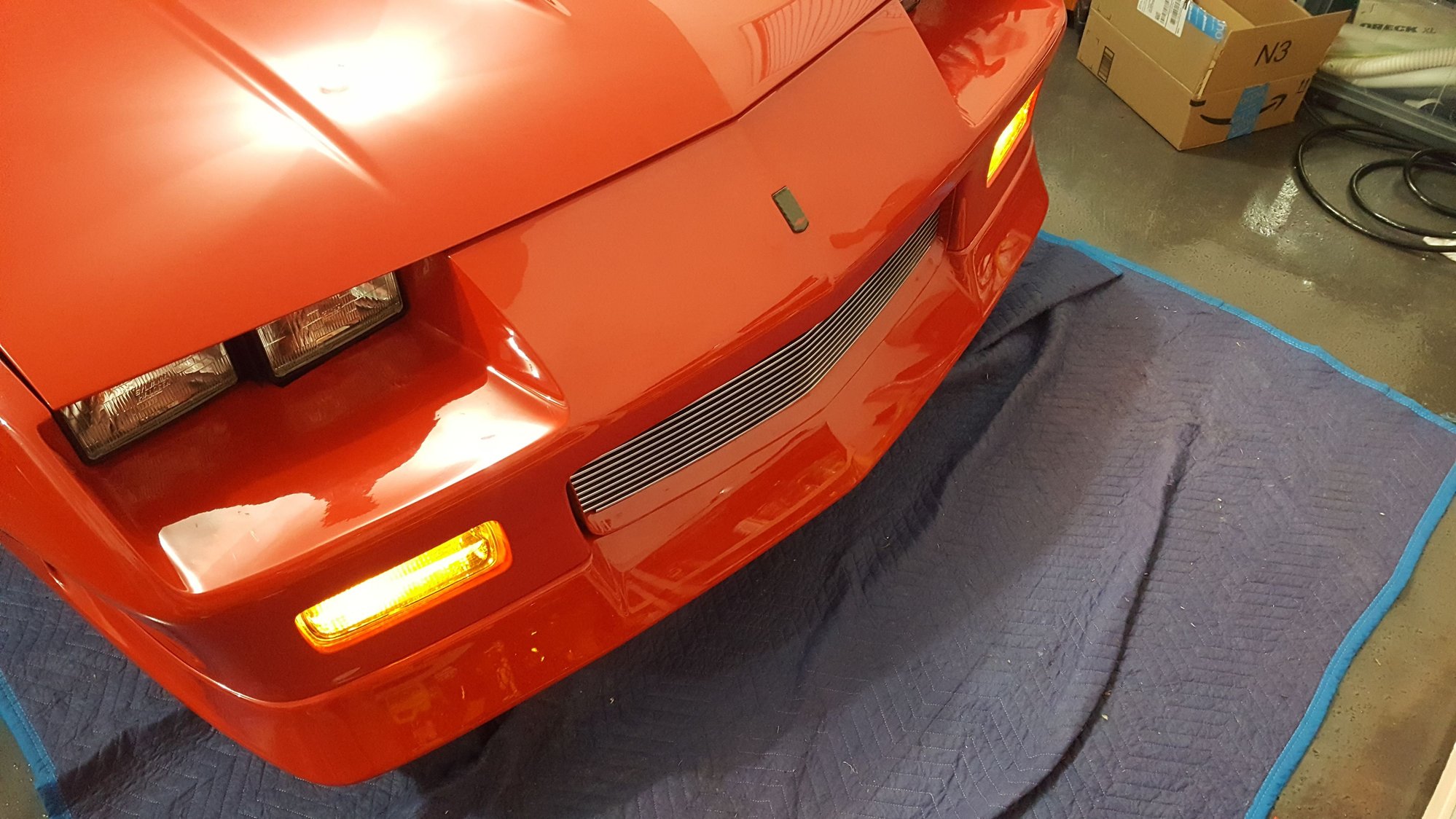

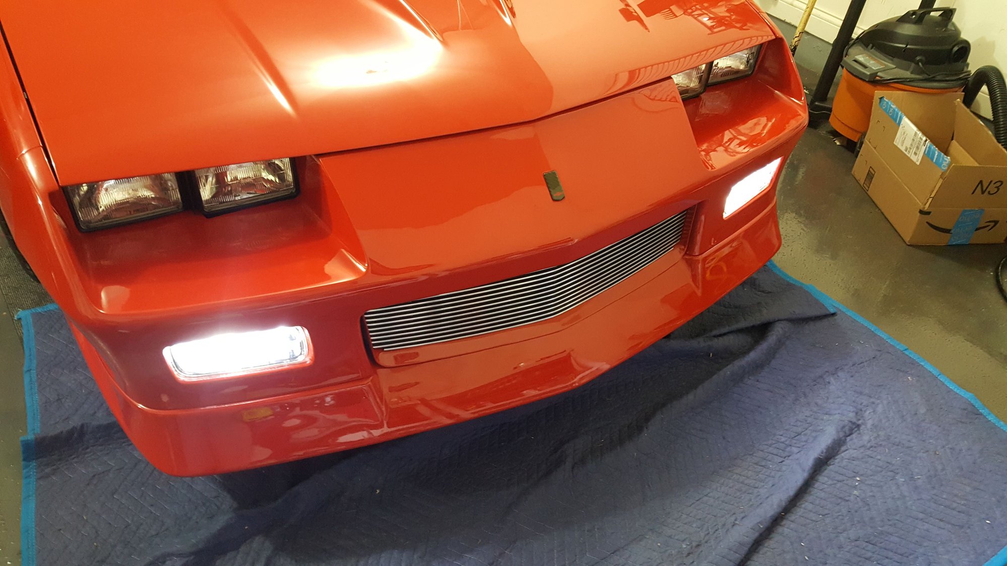

Flip flop front turn signals
Just installed these. Since I don't have fogs these will give a decent side illumination since the head light beam gets cut off being recessed

Re: Flip flop front turn signals
Is that just a special bulb? Normally white until you hit the turn signal/flashers?
Yes, they are white when on running light and the flip to amber with you turn on the turn signals or hazards. You have to use load resistors to make the switch actually work. I swapped to electronic flashers to try an avoid it, but while that solved hyperflash on the rear LEDs it did nothing for this. You need the additional resistance to get this to switch properly on our cars and make the side markers work correctly
