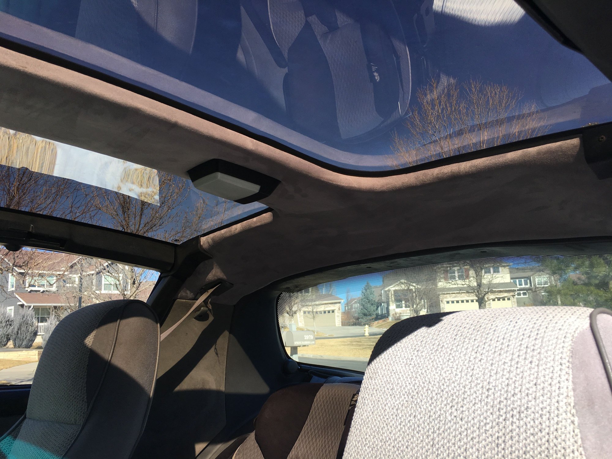

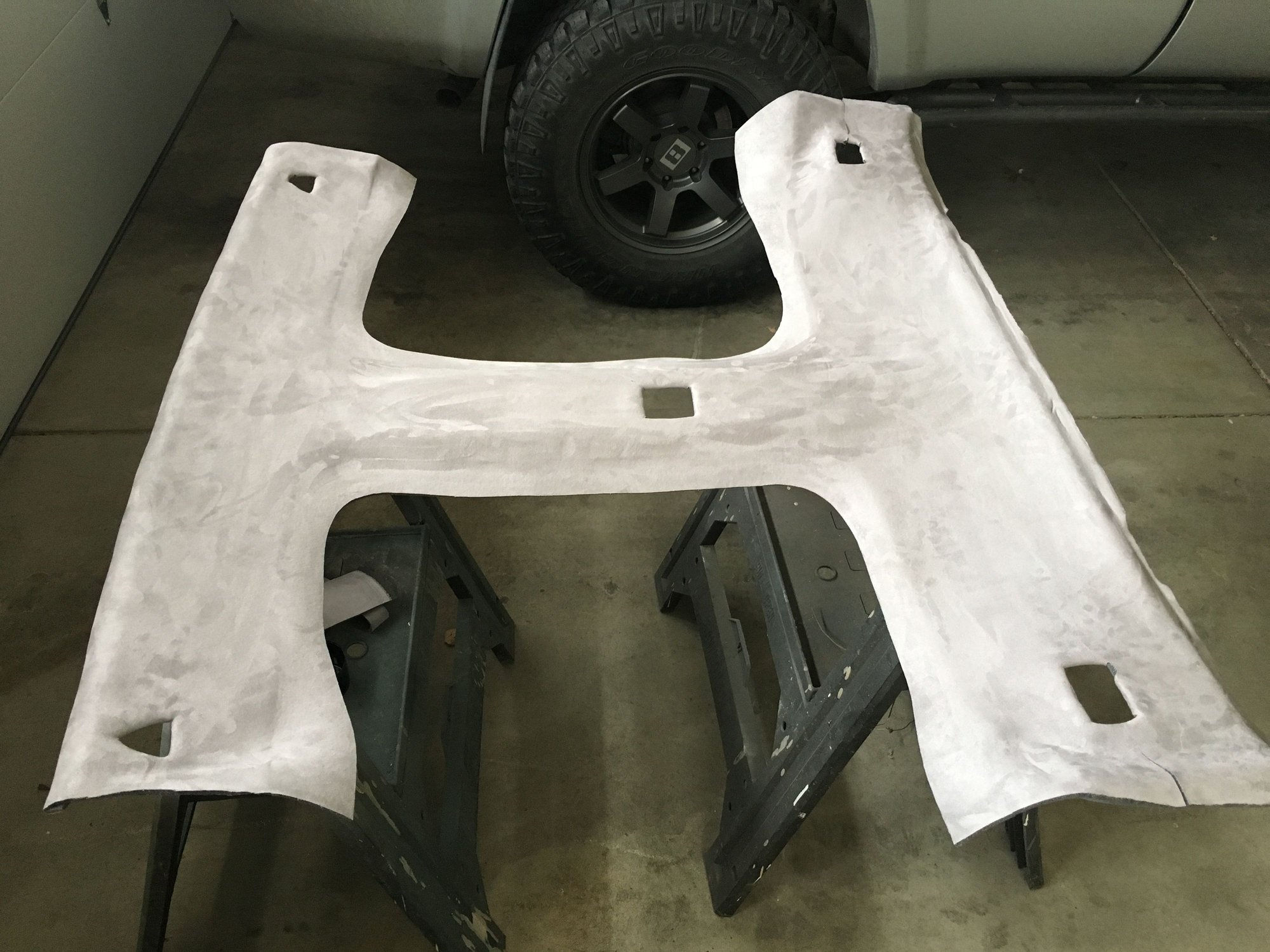

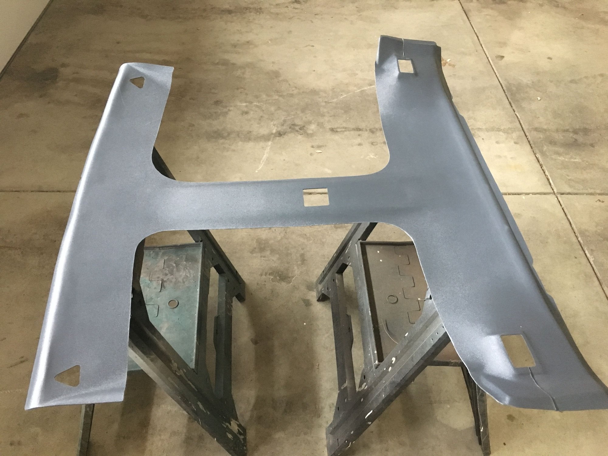

I'm catching myself up here, but if I remember right, the headliner was the first thing to tackle. (The PO had never removed the t-tops in 16 years because one was locked and he couldn't find the key) Because they are C&C tops, I picked up an ABS headliner to cut and I decided I wanted grey suede for the headliner. Came out pretty darn good if I do say so.

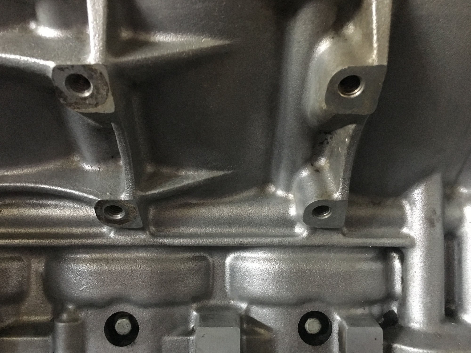

Taking artsy fartsy pictures while scrubbing down the LS1/T56 while I wait for parts to come in to freshen up and mount er.

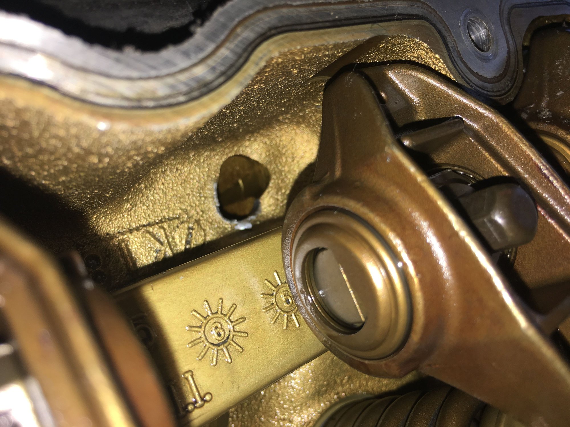

I managed to snap this while removing the valve covers for cleaning and fresh seals. Who says school stops in summer?

Well... nuts.

Isn’t that an oil passage? It looks a little boogered up but wth could’ve caused it?
Missing pushrod. The hazards of buying a used engine. Luckily, it looks like a clean break as you can see it through the hole next to the head bolt on the left. The guy who sold it to me seems willing to do something about it, so we shall see...

Ah I see now. I though it was an oil drain hole.

Passenger side damage report so far...
In addition to the broken exhaust pushrod on #6, #2 has a decent bend and the #4 piston tapped the cylinder.
I haven’t opened the drivers side yet, but I’m expecting some more bends and possibly more nicked pistons.
The seller said to let him know the damage and that he is willing to do something about it. (Local guy that makes a living parting cars) What do you all think is reasonable to ask for?

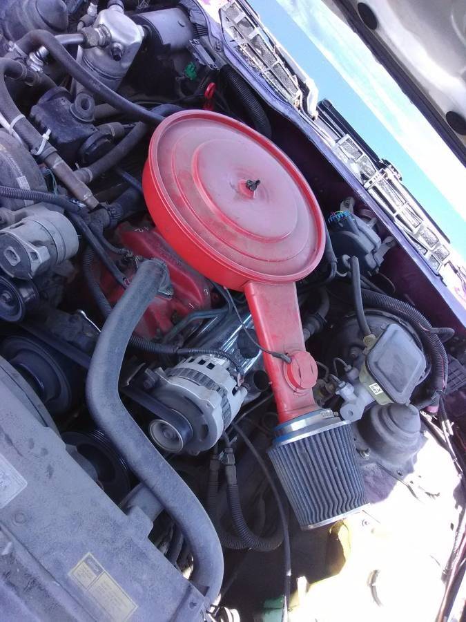

No real updates. Heads are back together with fresh valve seals and I’m waiting on the LS7 lifters to arrive. I did find this gem on Craigslist though:
Old Aug 17, 2018 | 07:18 PM
NoEmissions84TA's Avatar
Joined: Feb 2017
Posts: 4,185
Likes: 576
From: Meriden, CT 06451
Re: Mork's 1989 RS Build
If 1 air filter is good, then 2 MUST be better !!!
Old Aug 19, 2018 | 08:54 PM
DynoDave43's Avatar
Posts: 4,840
Likes: 921
From: MICHIGAN
Axle/Gears: 10 Bolt 2.73 Open
I guess you could remove the inner filter, and just use the cone, if you presumed that it offers better flow.

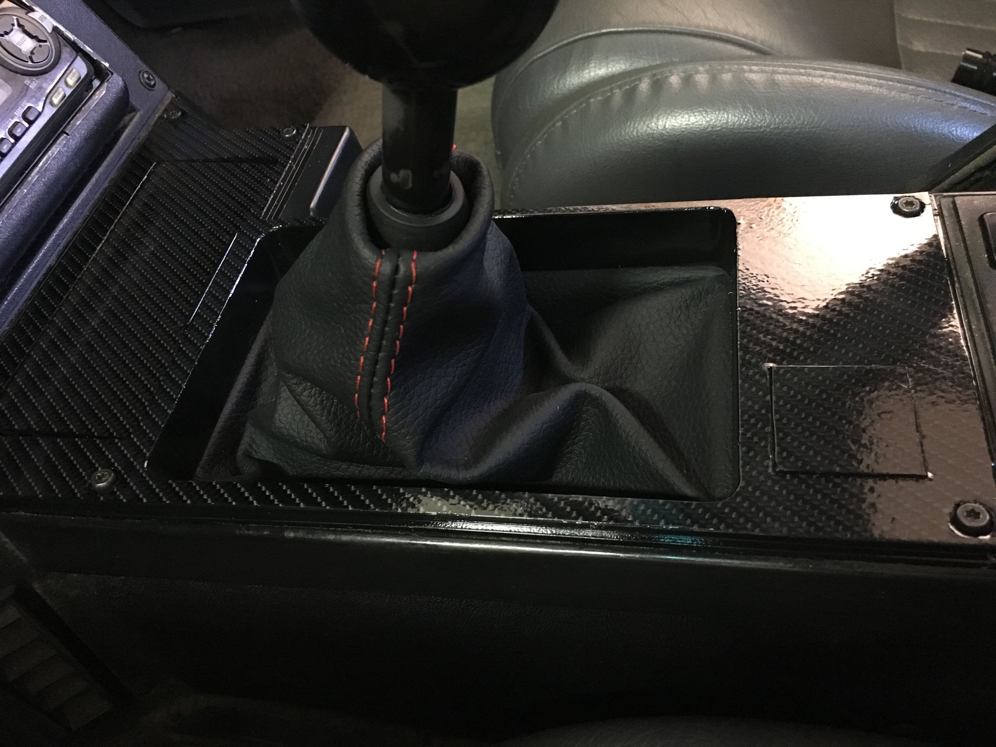

Making progress on little things that add up. Tore open the driver door and replaced the lower pin and bushings. The clunk was just getting to be too much for me. The ole doorman kit was just what it needed. Also replaced the outer seal and upholstered the upper trim piece. Eventually just about every crappy interior touch point is going to be recovered. Now I’m just waiting on the new Christmas tree tabs and the dynomat to arrive so I can finish her up.
I’m also putting a carbon finish on some of the console panels.

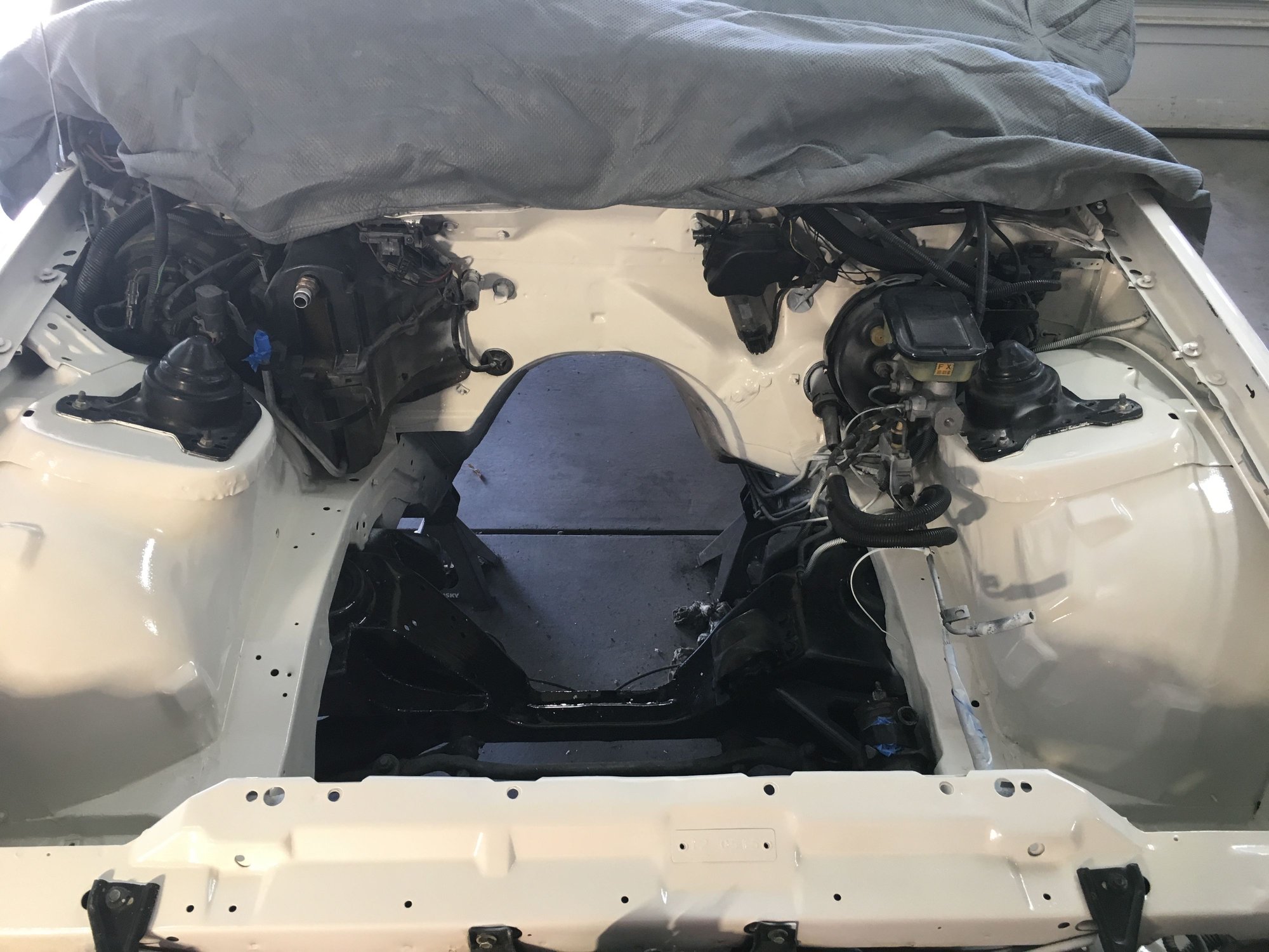

Little bits of progress here and there. Cut and rewelded the k-member for AC and while I was in there, put a healthy notch in. Also welded up and threw some spot putty on the big holes on the wheel wells. I’ll be putting a bit of paint to freshen up the bay, but by no means a shaved show car job.

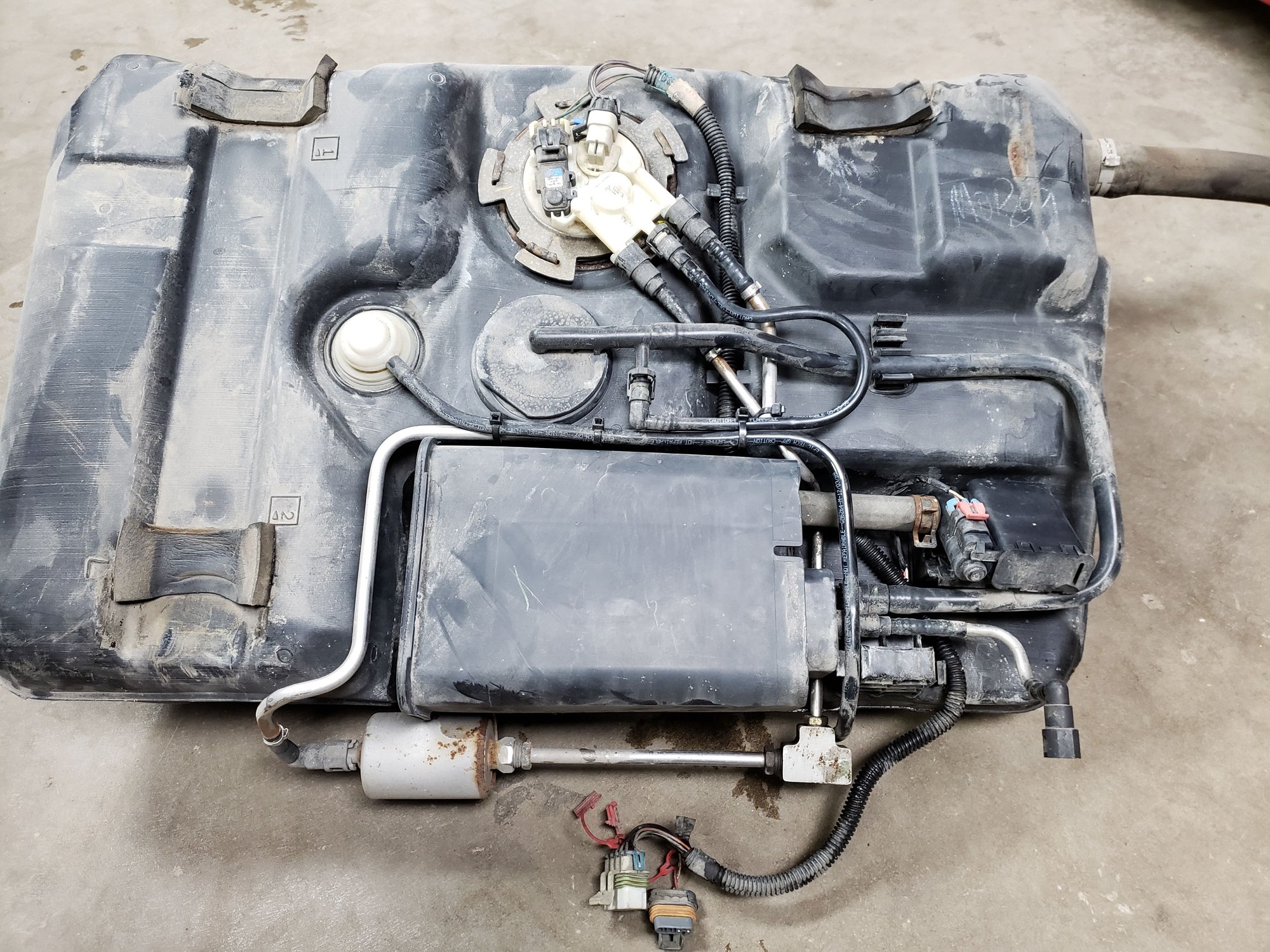

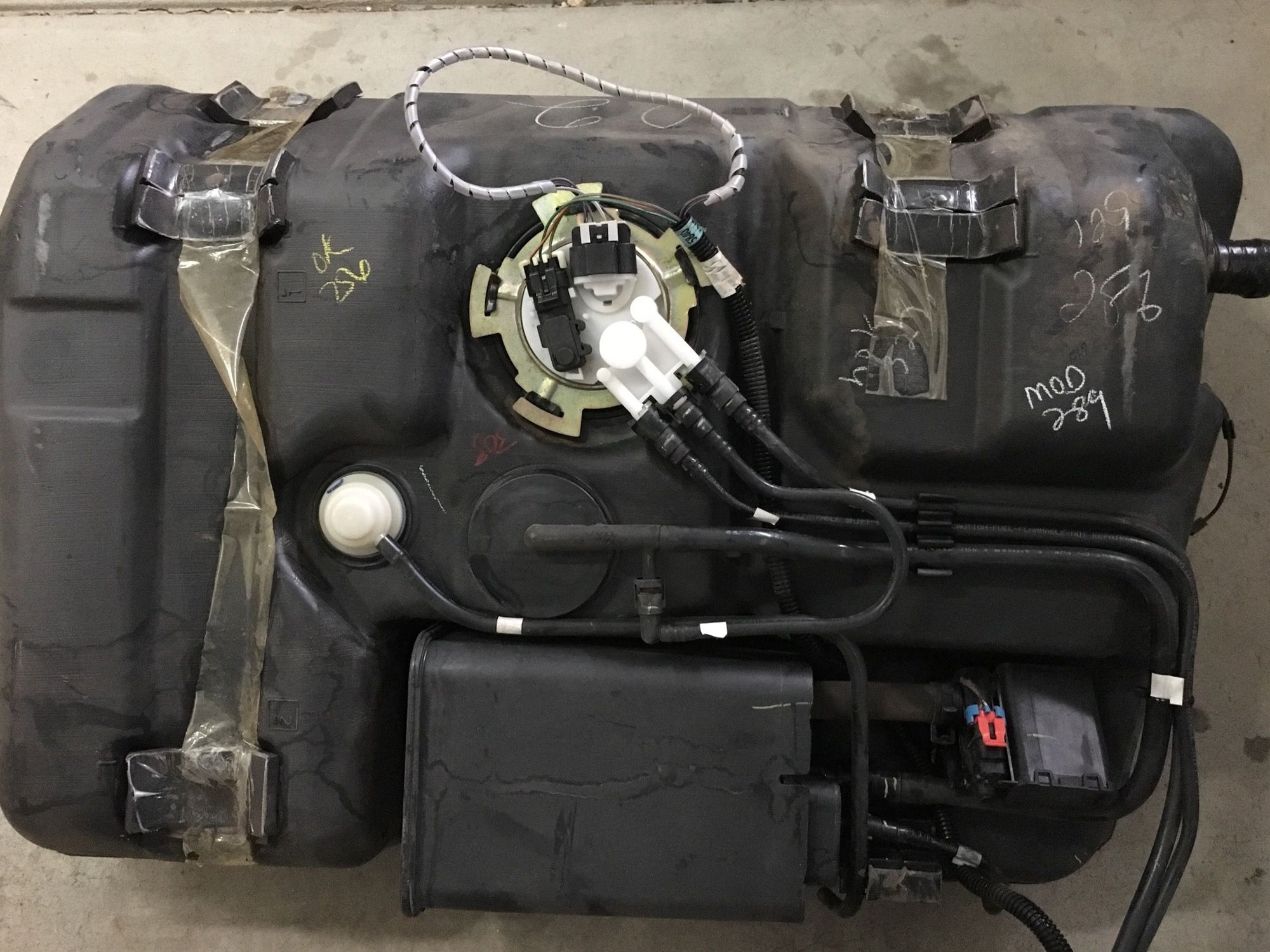

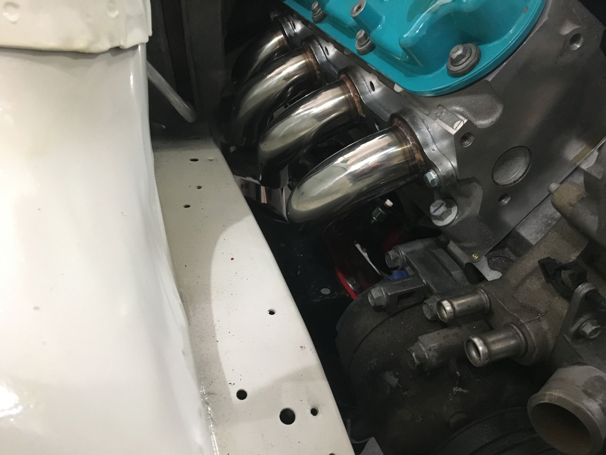

And a happy Christmas indeed. The UMI drivers mounts line up wonderfully, but the passenger is using completely different holes. The leading bolt and the bottom bolt both line up, but the third gen f-body specific one on the passenger side has no way of being close. I’m not sure if it’s caused by the AC notch, but another “drill” hole lines up and the tranny mount lines up as well, so...

10 min of googlin and looking at some of my old pics, I don’t have the top right 3rd gen specific hole on my k-member at all. The hole that I’m using for the 3rd bolt is the same one used with the hawks produced ones. Looks like there was just enough wiggle room for me to fit it.
so for others, ‘89 RS with the 305 has different k- member holes than what UMI used for their mounts.

The headers were a complete battle to get in. The motor is pushed back about as far as the UMI mounts allow so I barely had any clearance with the motor mount pin pulled and the hoisted up on each side. Both went in through the bottom as I had welded on the v-bands beforehand. Also, I will pat myself on the back as my first stainless TIG welding project is turning out fantastic.

More progress. LS1 tank is in, parts are on the way to finish the fuel connections, the filler neck is trimmed and finished. For the filler neck, I got the reproduction tube, but had to search to find a new connection tube to the tank from the metal pipe. Luckily a company called “Filler neck supply company” had the tube as the original GM part is discontinued. Had I known it was just a rubber tube and a reducer, I would have made my own.
Anyways, the rubber connection tube gets cut down 1 1/2” and I found the right spot to drill the hole to mount the upper tube. If you look at the first picture, it’s right next to the rearward spot weld/dimple. I’d say it fit up perfectly.

Very nice I ended up installing a second bracket, hose clamped to the filler tube and bolted to the car so it was much more stable. Probably not needed just made me feel better, as it doesn't move when filling it now.
What is your plan for the fuel sender?

A 2nd bracket isn’t a bad idea at all. For the sending unit, I have been considering replacing all the gauges. A full set of autometers or maybe Dakota digital. I’m not sure I feel like hacking something together just for the gauge.
i want to get it running first though.

Something I did to my tank to simplify fuel lines.
Just a feed line to the engine from the tee, stock LS1 filter and tee. Some stainless plus parts store fuel line repair parts. I did the evap line also.
interesting approach. I’m planning on running the 3rd gen filter with -AN lines to it with the T before the filter (I figure there’s no sense on filtering the return twice)
...But on that note, is there any benefit to filtering before the return T?
And regarding the evap, have you figured out how to run it without the data from a 4th gen cluster?

That is how it was set up from the factory, originally the 4th and 3rd gen filters are in the same place. I just moved it closer to the tank to make it a more compact package and not have a
return line for half the length of the car. What happens in the tank is kinda neat. There is no baffling of any sort and the pump is in a bucket. The fuel pressure regulator is just inside and it looks like it bleeds off excess fuel into the bucket. I am guessing that it is filtered before it is returned so it does not recirculate debris.
