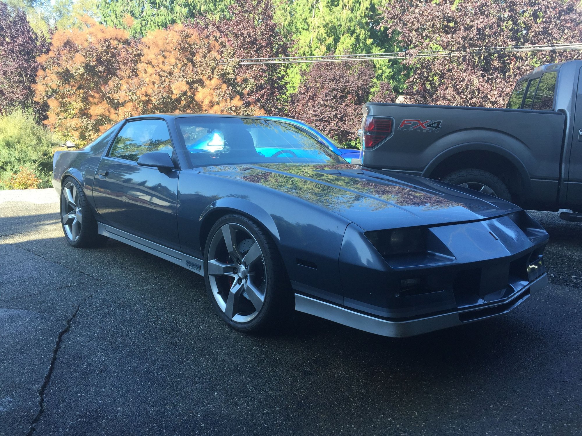

First time out after 25 years

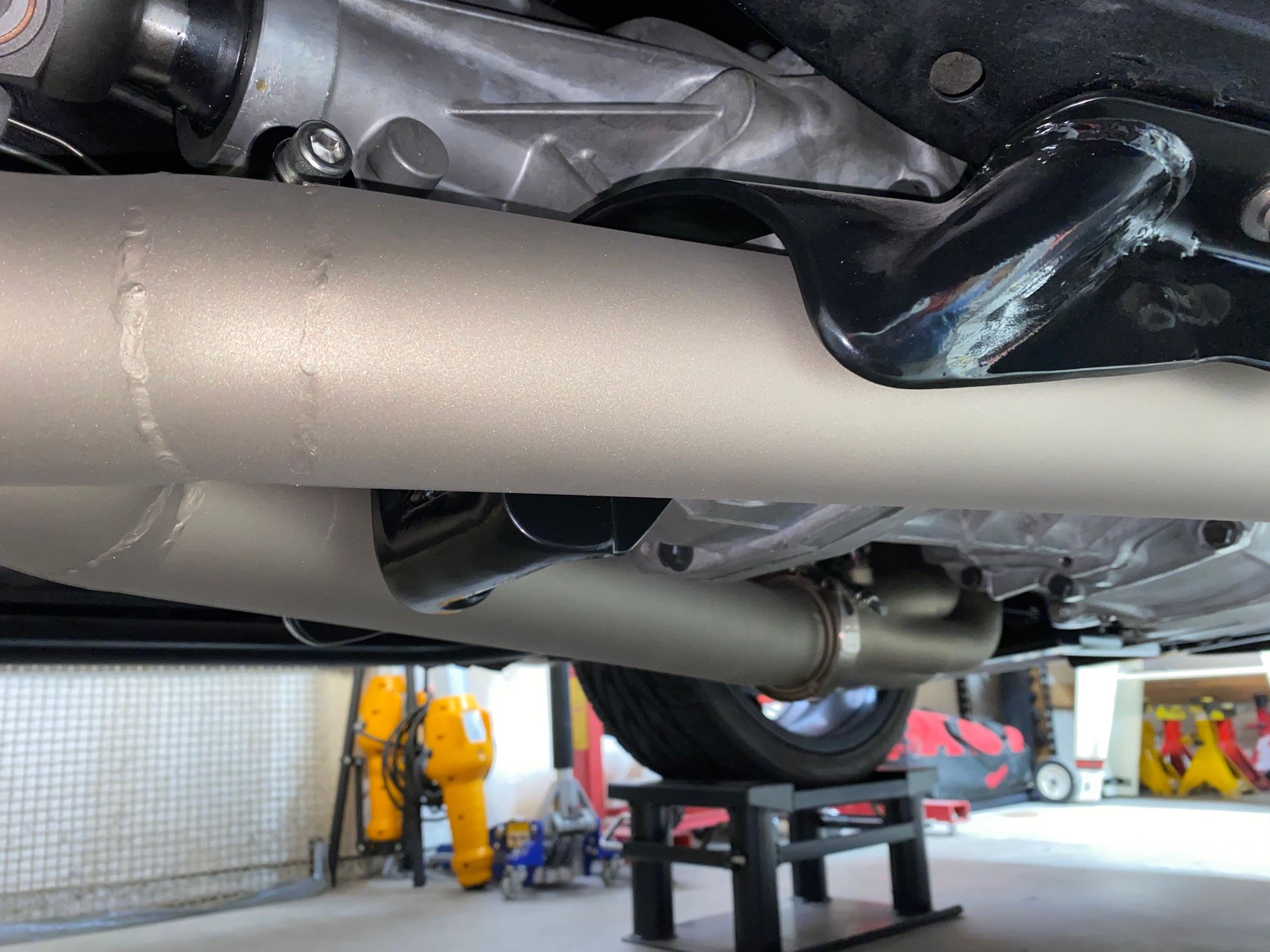

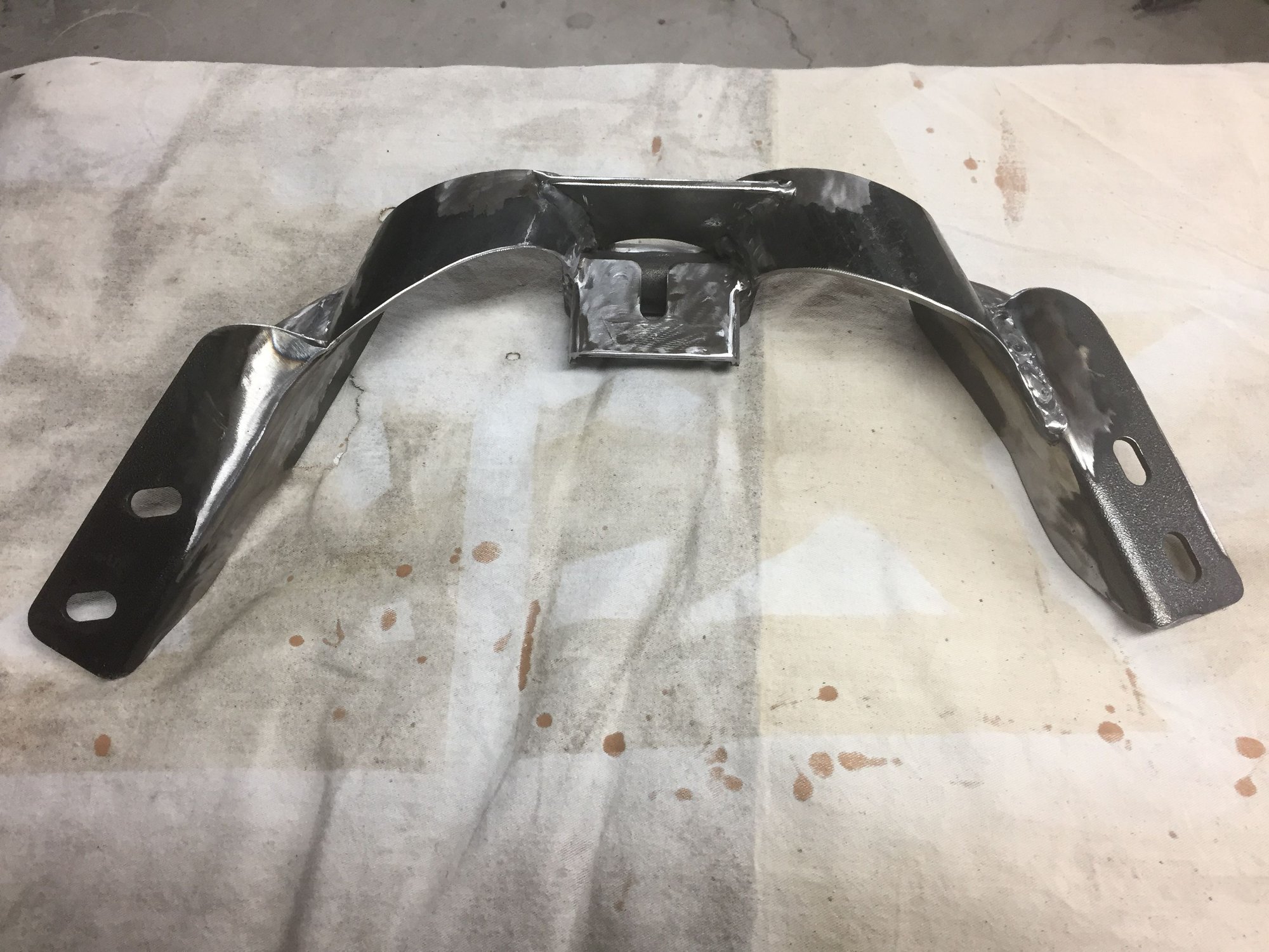

Stainless steel exhaust and transmission mount under construction

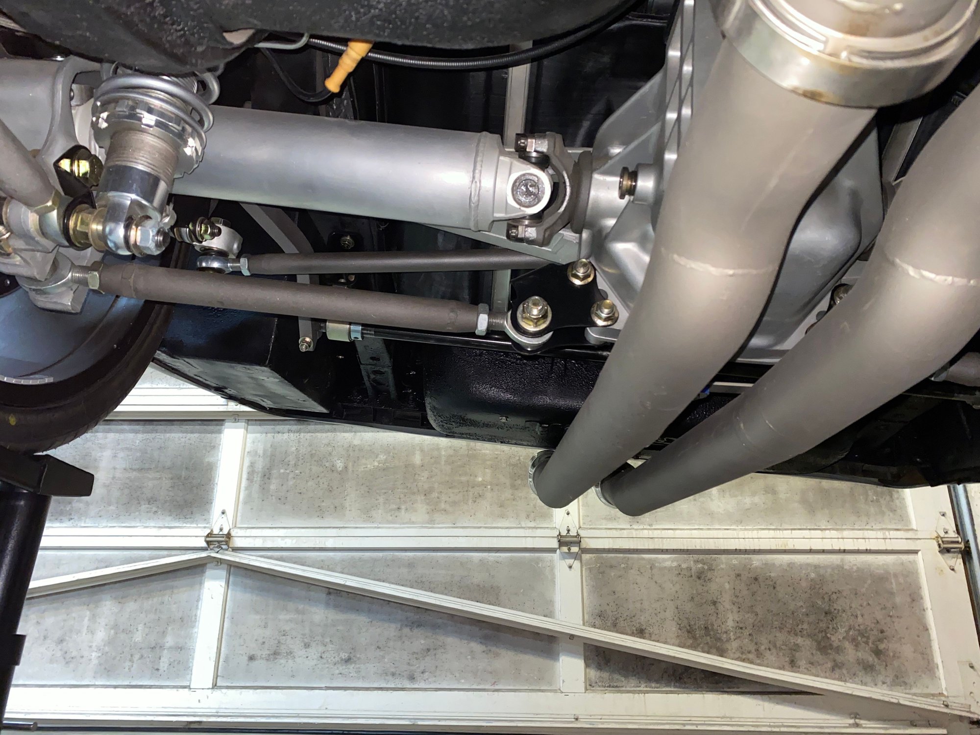

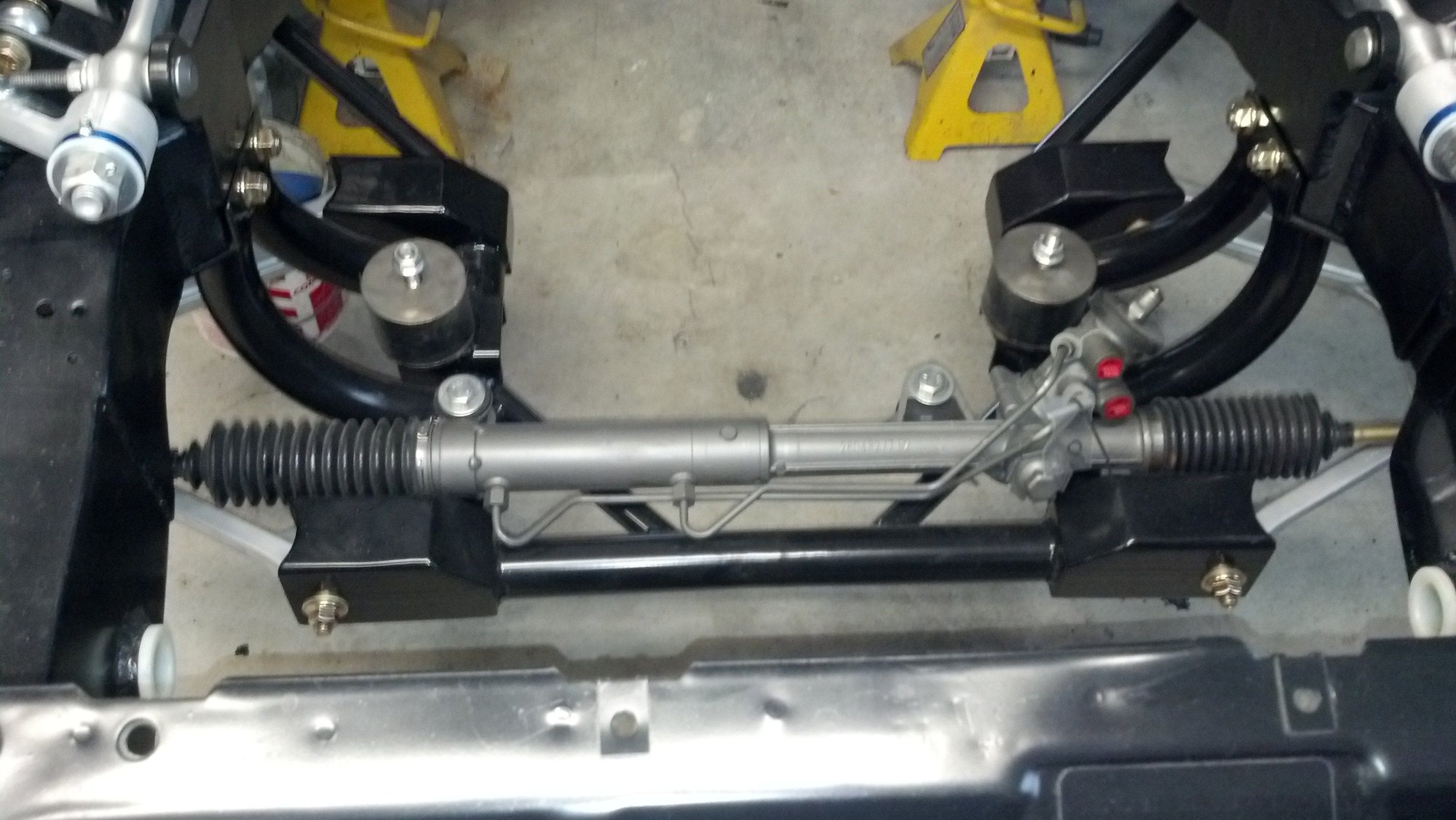

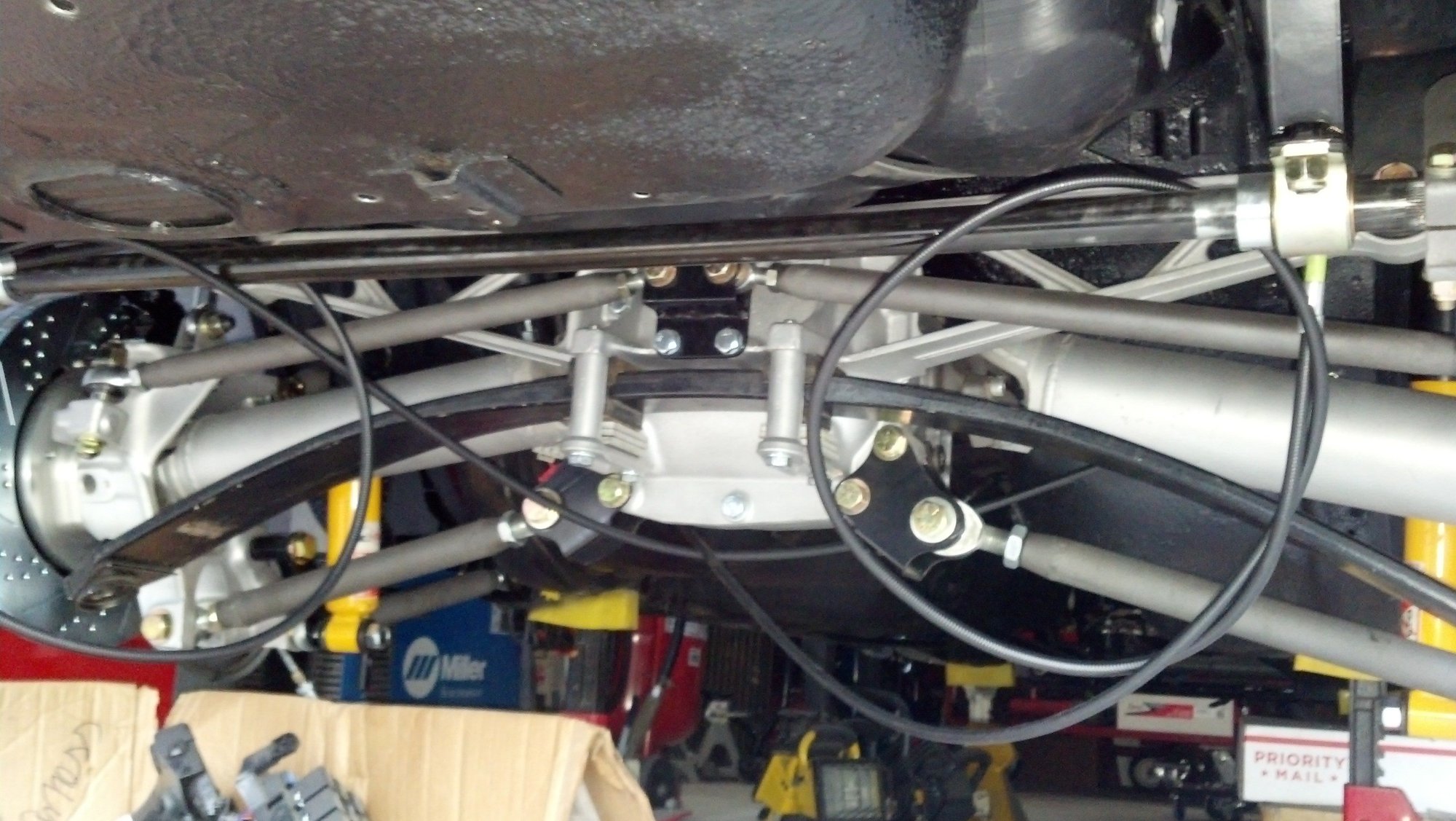

Rear suspension installed, but not finished
Filled the upper strut towers
Front k-member and steering rack
Proof of upper control arms
A few more images of the suspension

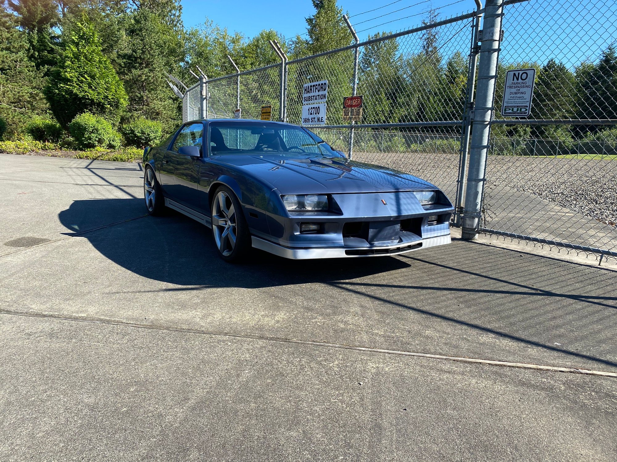

Took the car out for a cruise after installing a new cooling system and decided to take a few pictures. The car performed great, even when I got caught in traffic at the boat ramp. It idled for 10 min. In 87 deg. heat. Huge win.

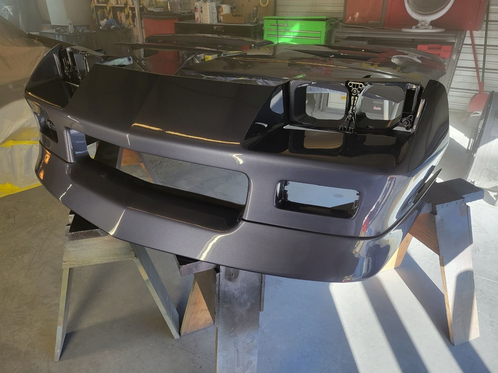

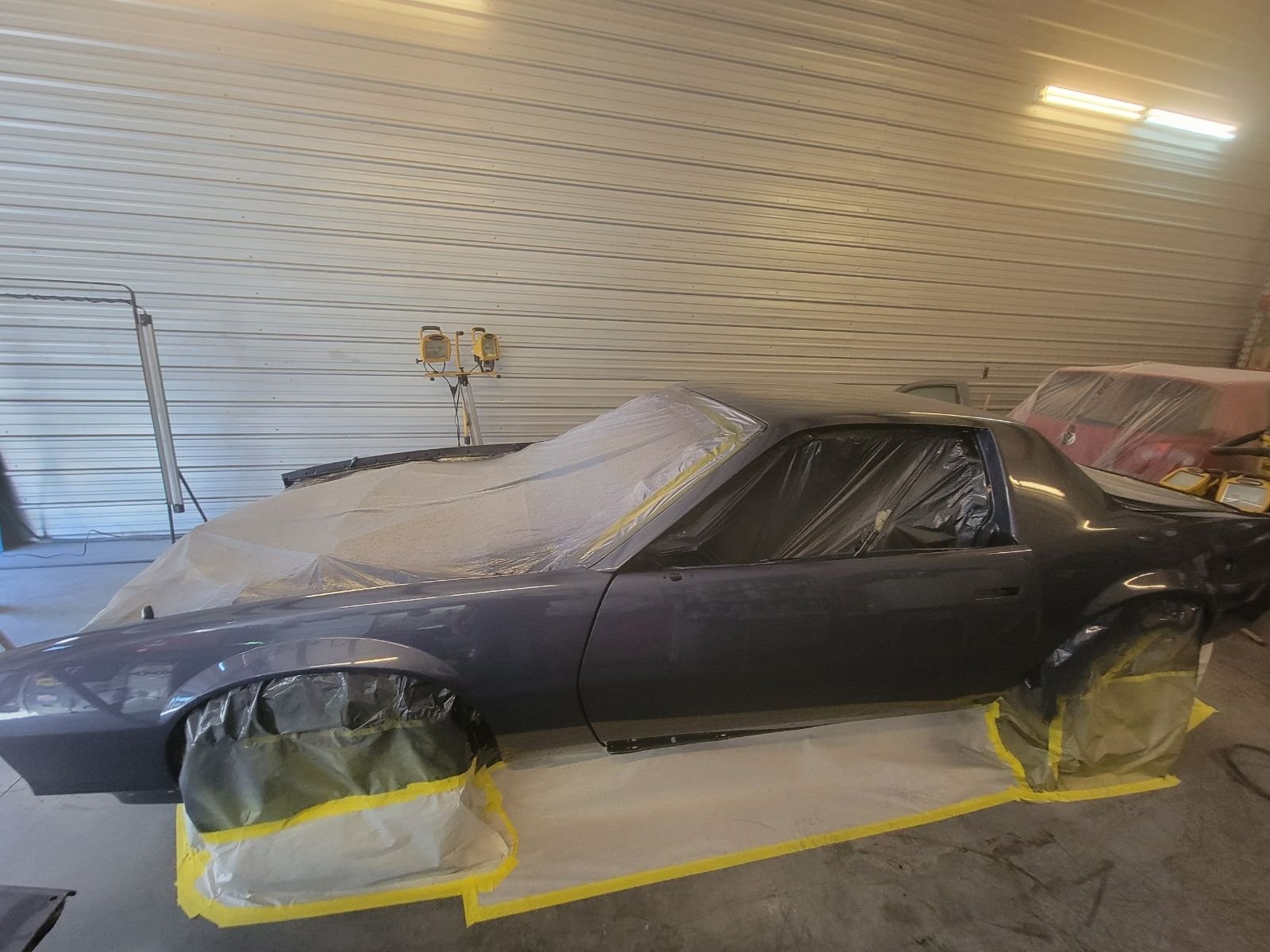

Starting some of the many body mods that will be done to the car over the winter.

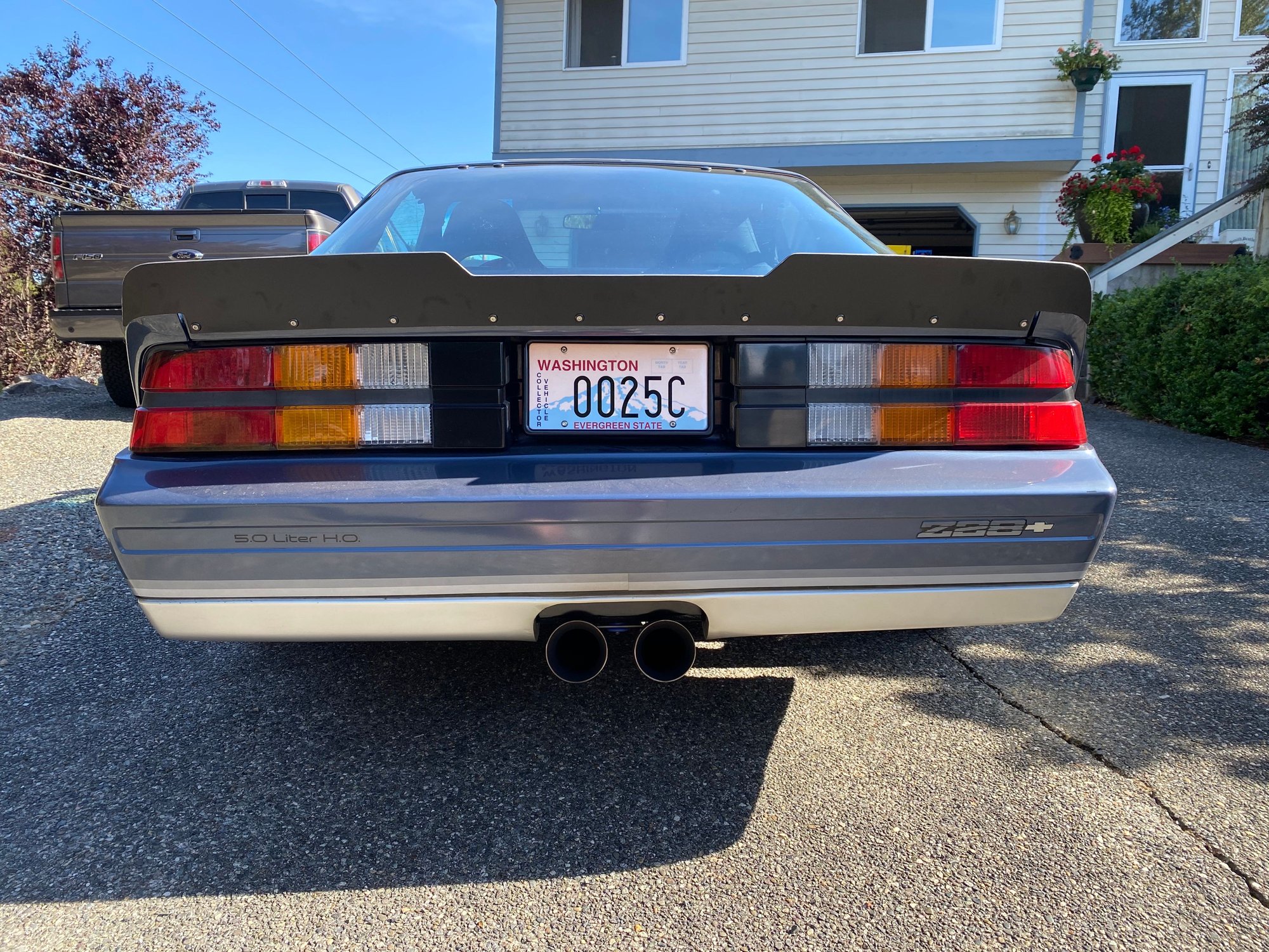

Added a spoiler extension.

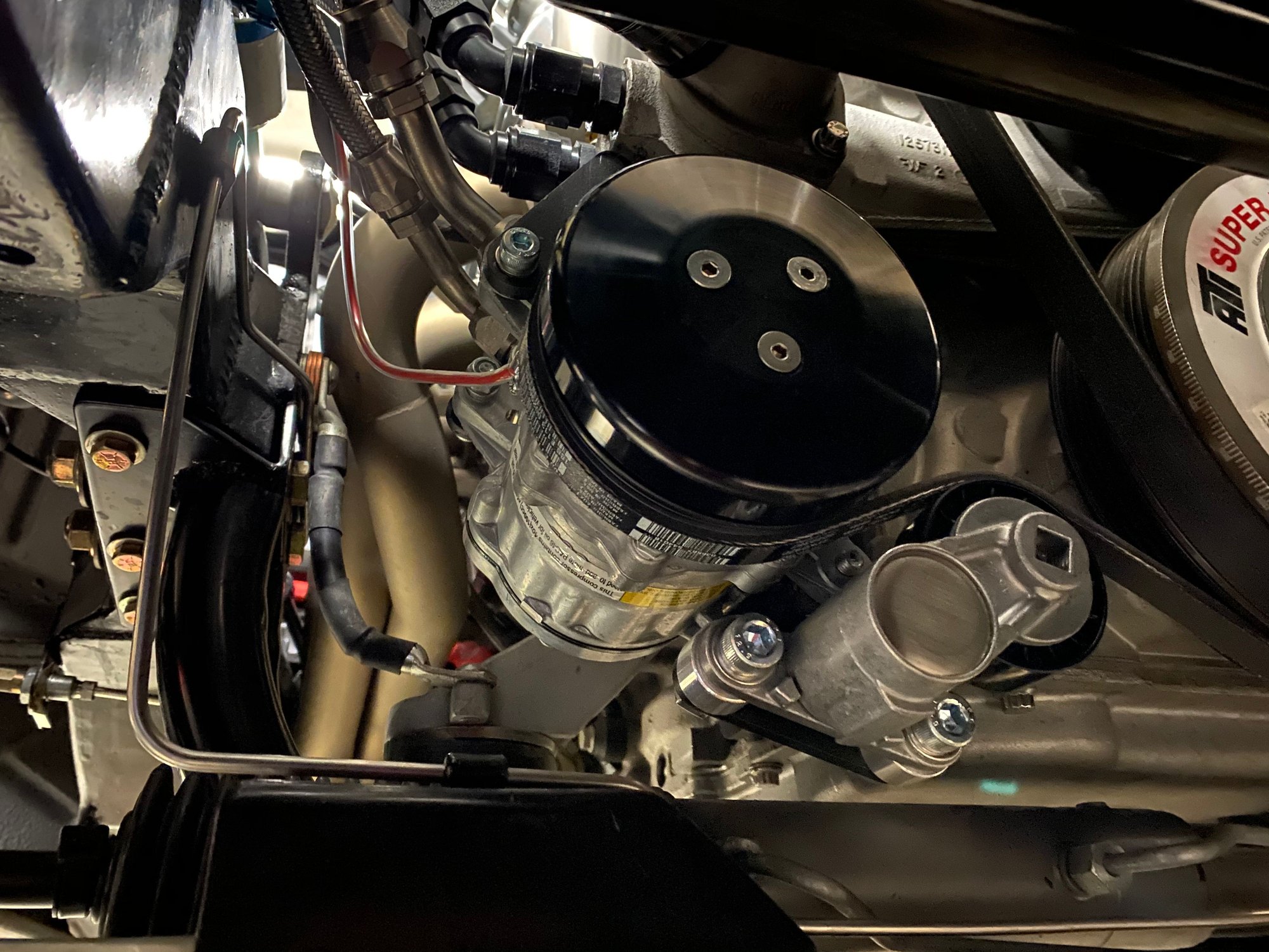

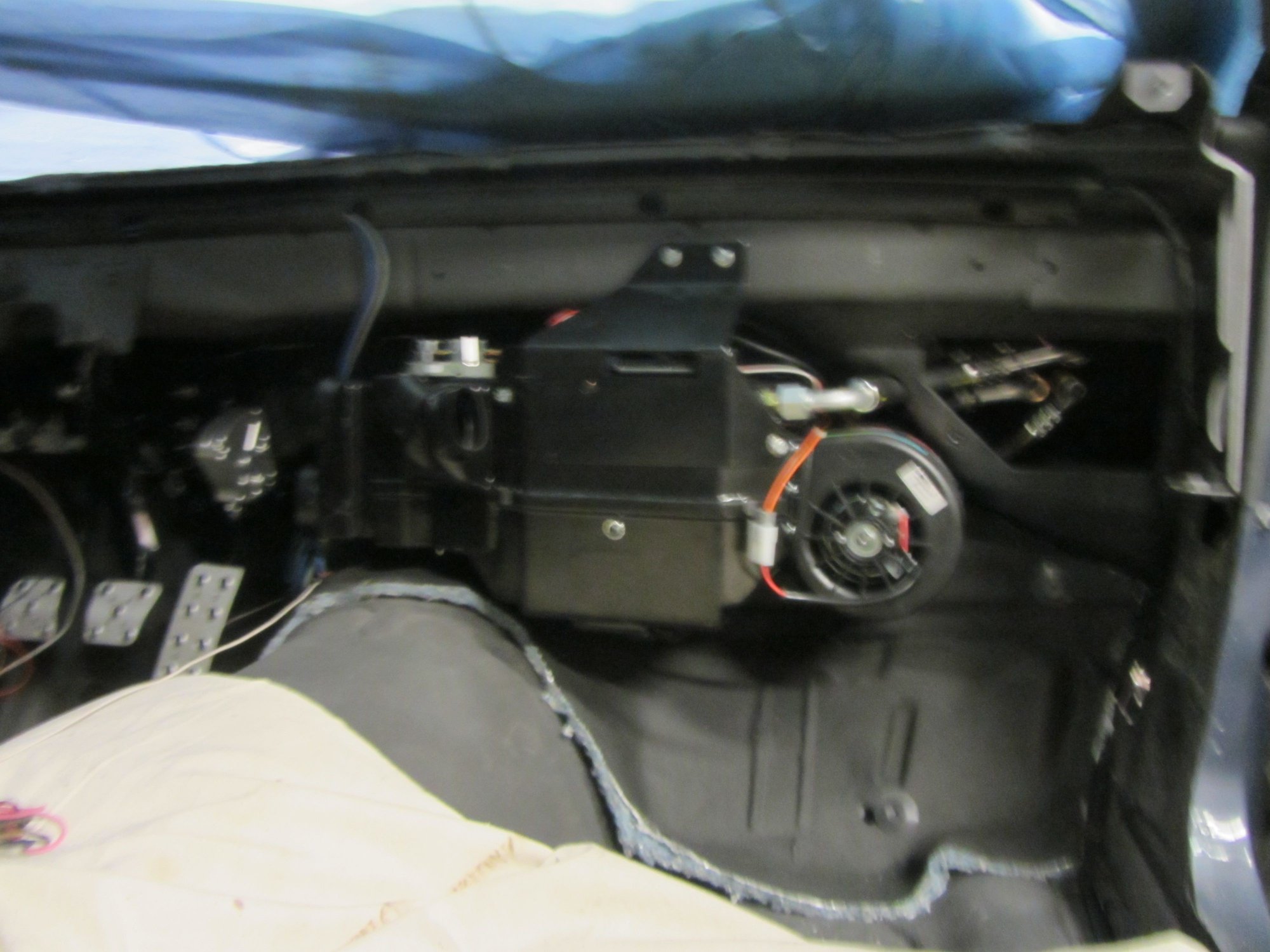

Dirty Dingo Sunden SD7 compressor

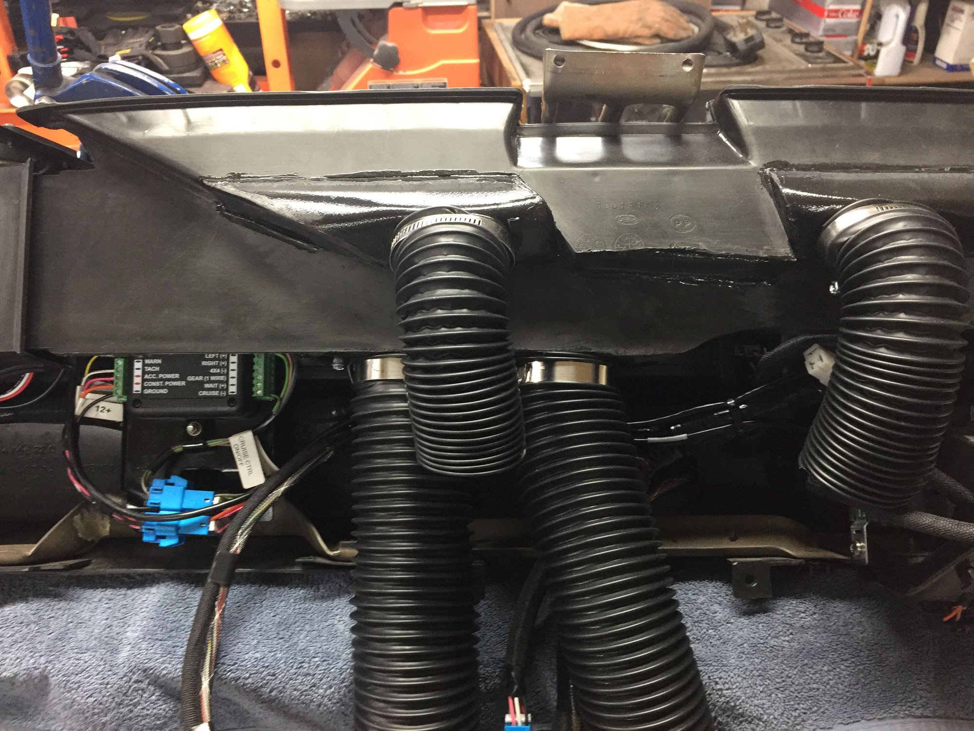

Dash vents and defrost ducts
Vintage Air Magnum IV system
Vintage Air system installed and operating flawlessly. Heat, cold, and defrost better than original.

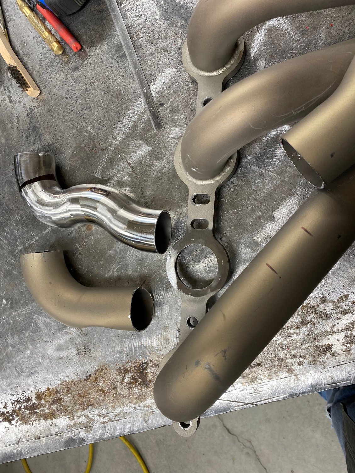

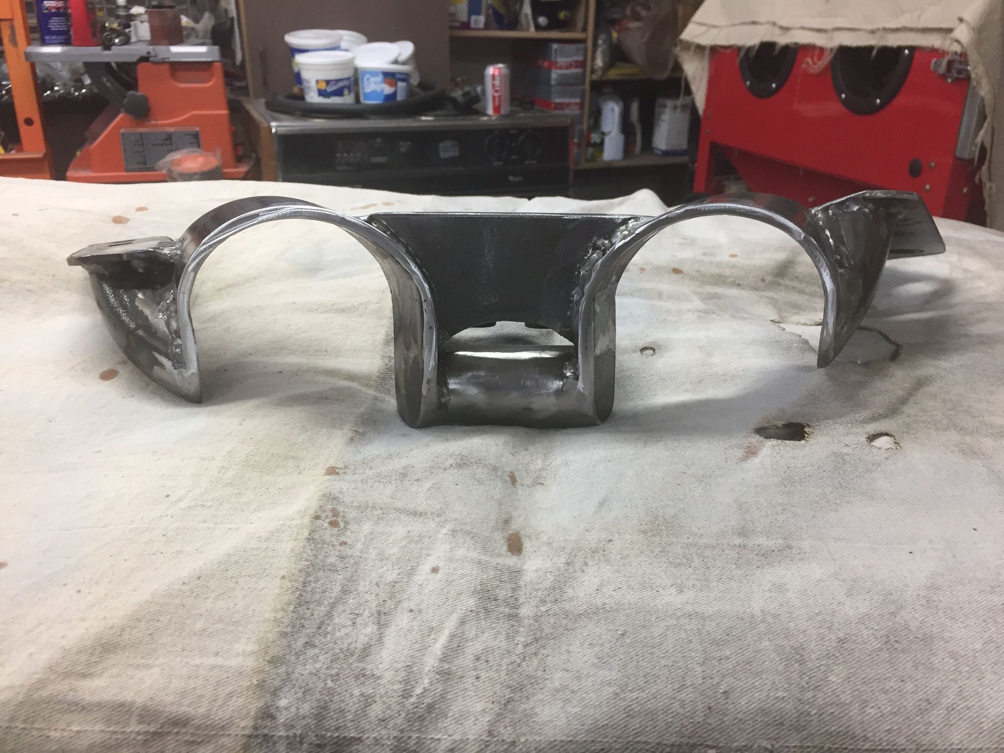

Modified #3 header tube
Clearance for the steering shaft for R&P steering
Cutting up a perfectly good header to make clearance for the steer shaft to the rack and pinion steering. Dimpling a 1/4” did not clear, so drastic measures were in order.

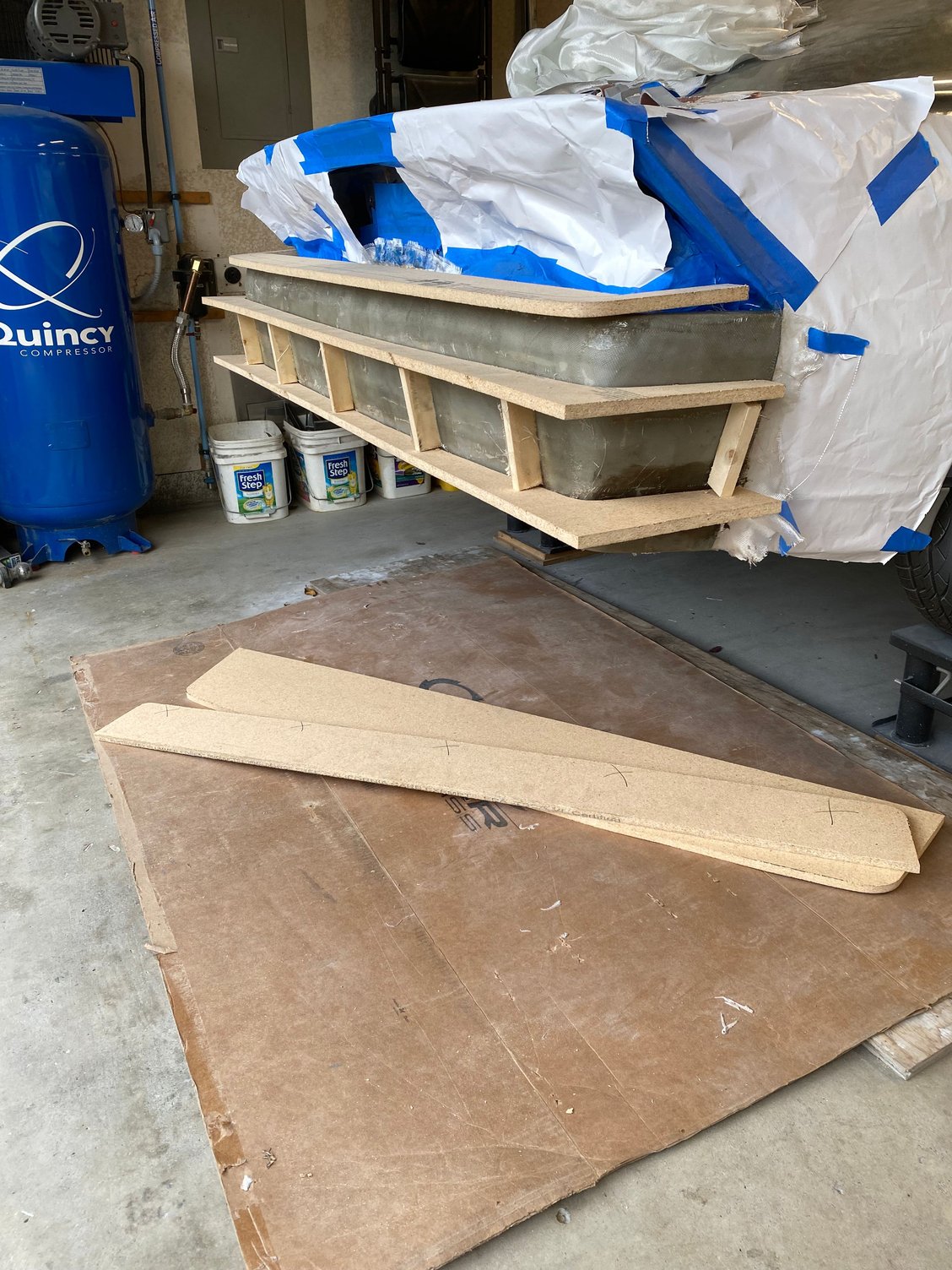

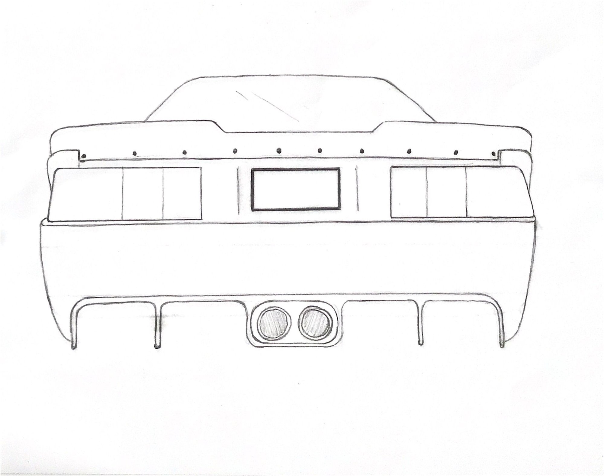

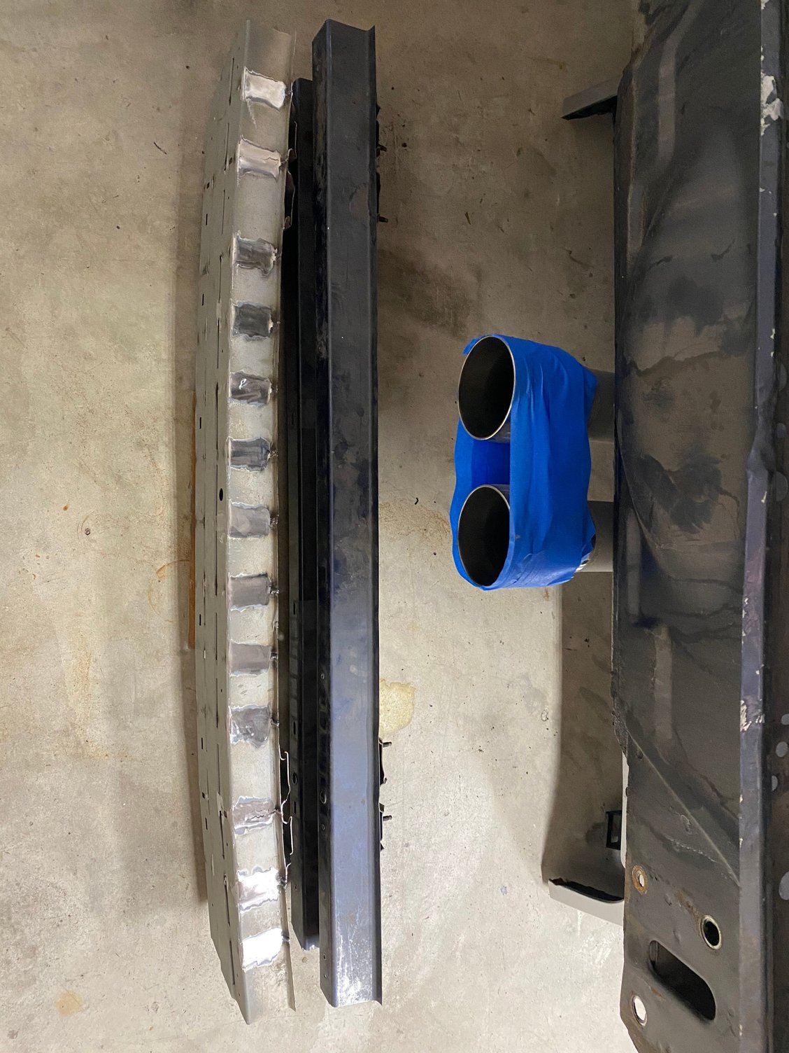

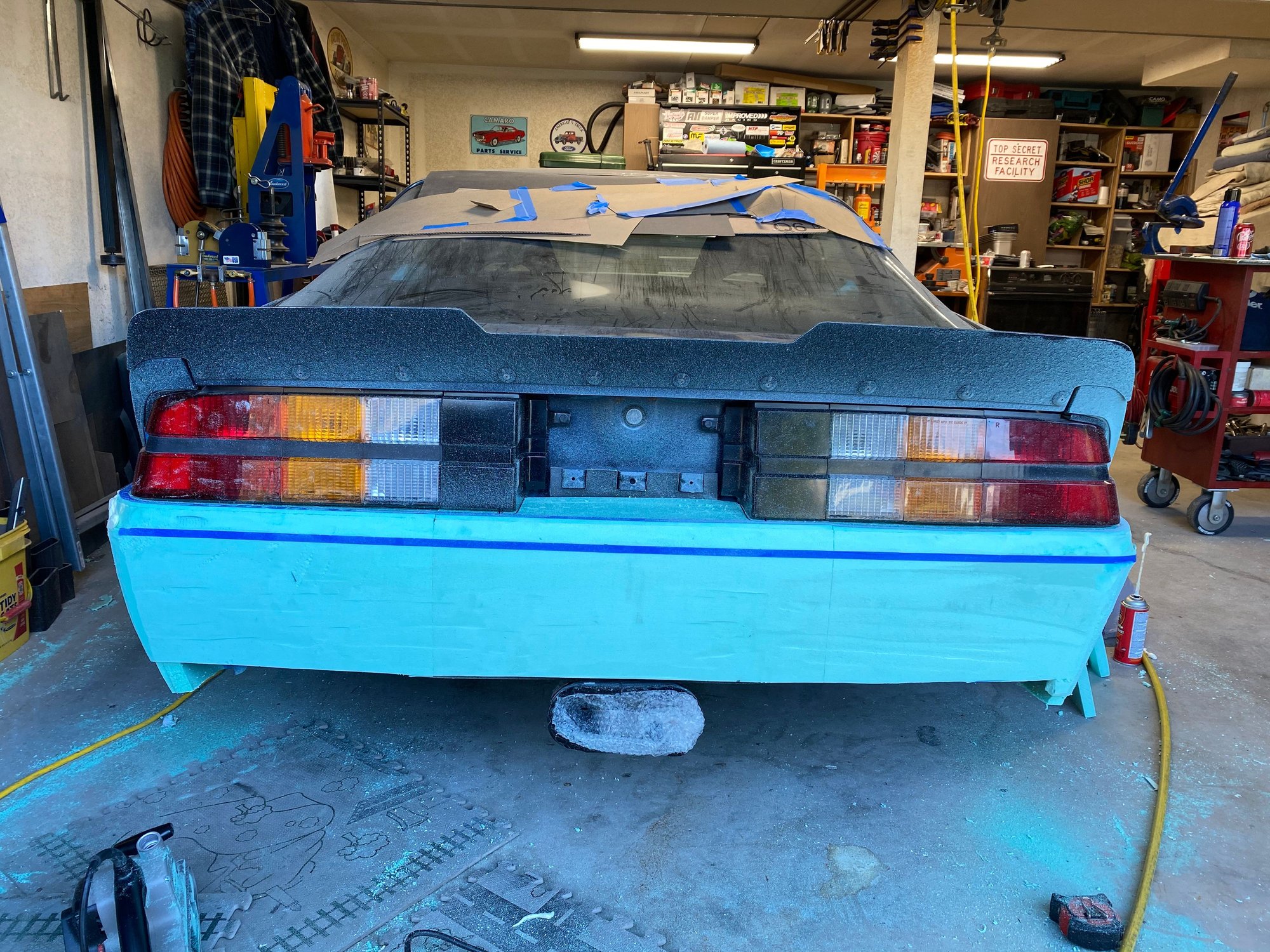

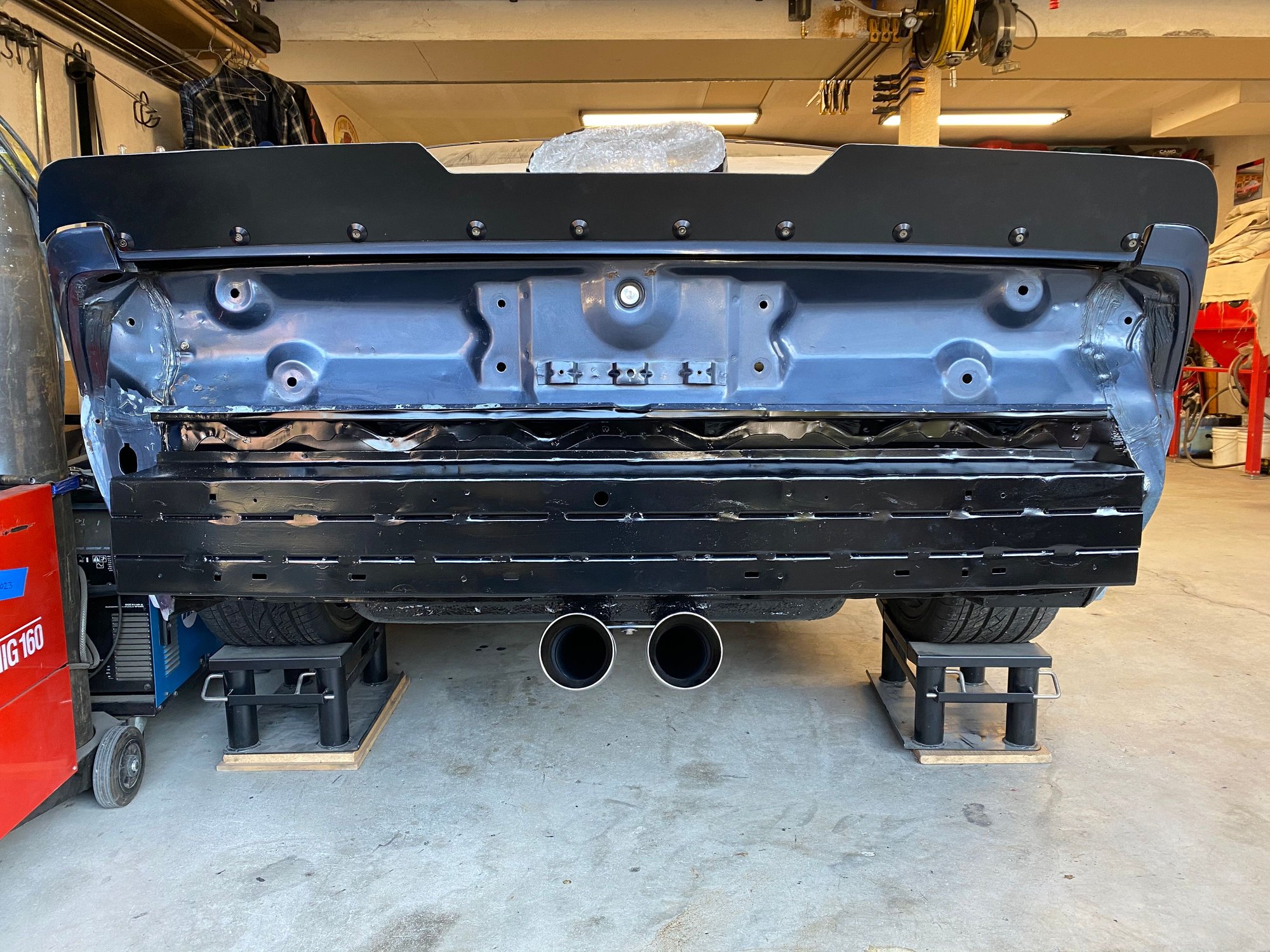

Concept drawing
Sectioned the rear bumper to the car profile
Reinforced the center section of the bumper
Male foam buck
Flush with the taillights
Supports for the female mold
Female fiberglass mold
Finished rear bumper
A diffuser will be made for the lower half around the exhaust
This is what I envisioned years ago for the rear tail panel. I’ve always disliked the rear bumper on these cars, it sticks out too far and looks like it was slapped on at the last minute in the design phase.

I’ve gotten a few things in epoxy primer.

Exciting, I like your paint booth setup.

That color looks amazing indoors, I can't wait to see it in the sun! What is the name of the color?
