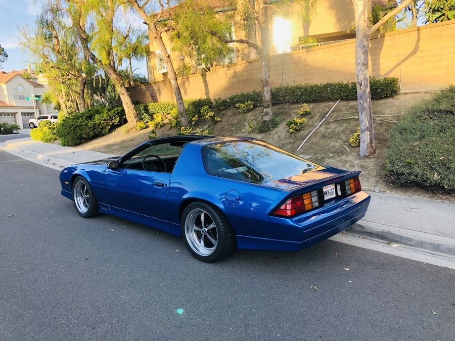

Some pictures of my build, 89 Iroc Five speed 373 Gears 305 stroked to 334. All California Smog Legal. I kept the complete drivetrain all original to the car.

Wow, super clean, congrats!! More details on the engine would be great.

This is one very clean ride you have! Great job and love the attention to detail! Those wheels and that blue are killer together!

Beautiful build, and impressive numbers from that 305! What kind of rims are those? They look perfect on your car.
