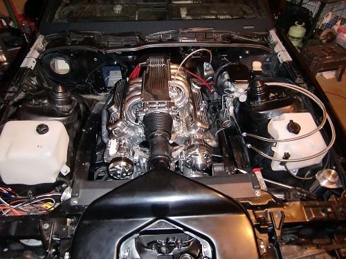

A.I.R. tubes removed from headers.
Nov 9, 2009; Motor was pulled back out not long after this for engine bay modifications.
Pure Choice braided fuel lines, MARCH remote PS reservoir on right, BeCool radiator, MSD6AL left.

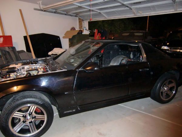

2011; engine bay & suspension modifications.

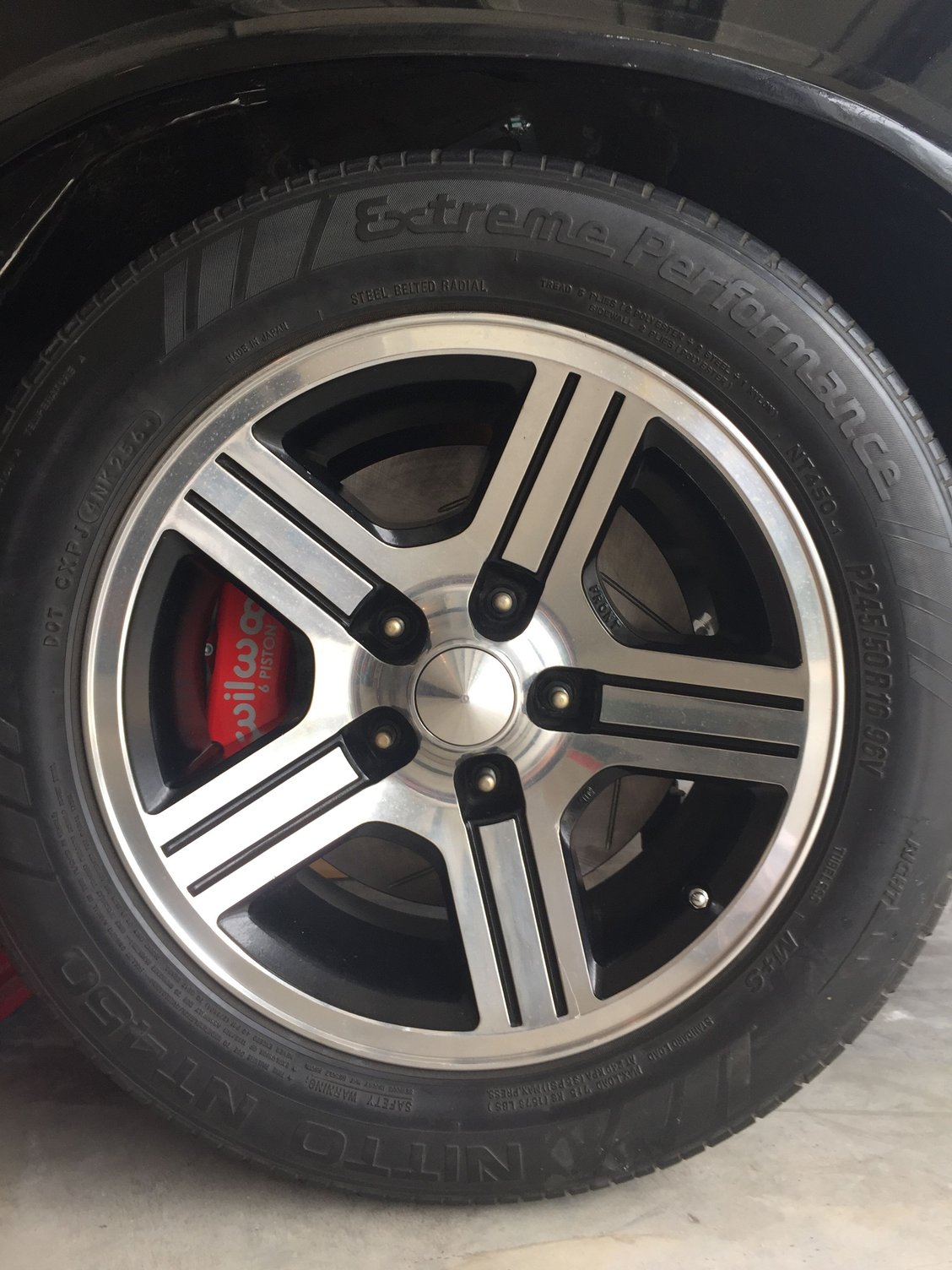

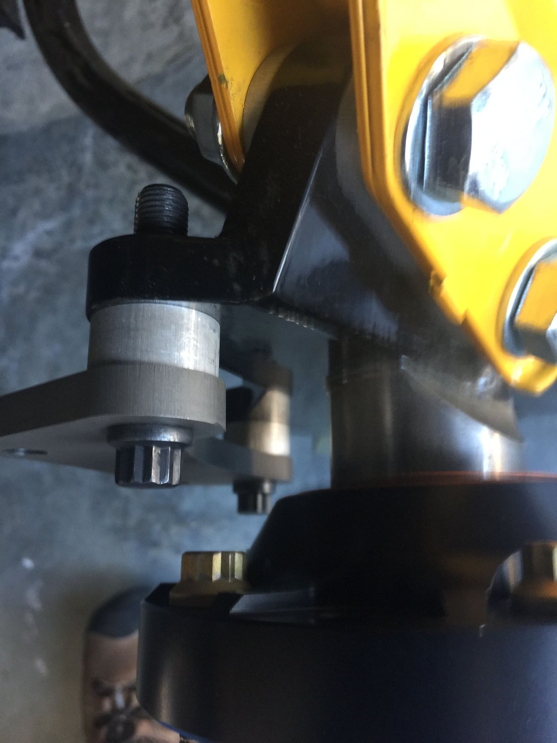

Wilwood 6-piston Billet Narrow Superlite calipers for 13" Dia. x 1.1" thick rotors (C4-HD). The .470" spacers that go between the bracket & spindle are missing in this photo. Also, the purple Tru-Coil 850lb springs shown above, were replaced with these Hyper-Coil 1000lb Springs.
KORE3 7075 Aluminum Road Racing Hubs (stock height). I tried to buy the Wilwood two piece rotor & hat kit for the C4-HD upgrade, but they quit selling it. These are Cryo treated Stop-Tech rotors that will work just fine.
The calipers have more than the Wilwood recommended minimum of .080 clearance. This tire is so old it barely holds air!

Here are the .470" thick, 6061 aluminum spacers installed

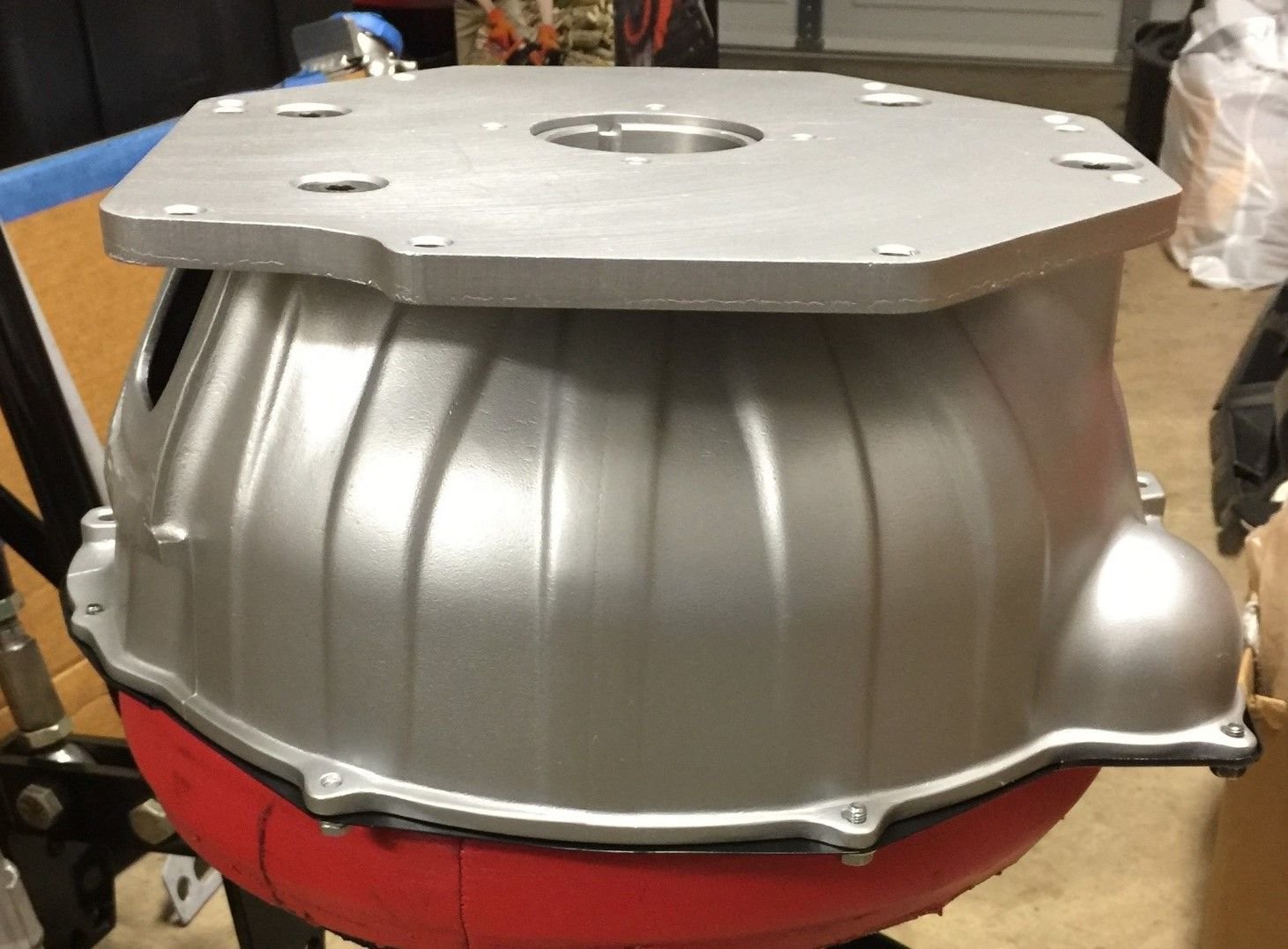

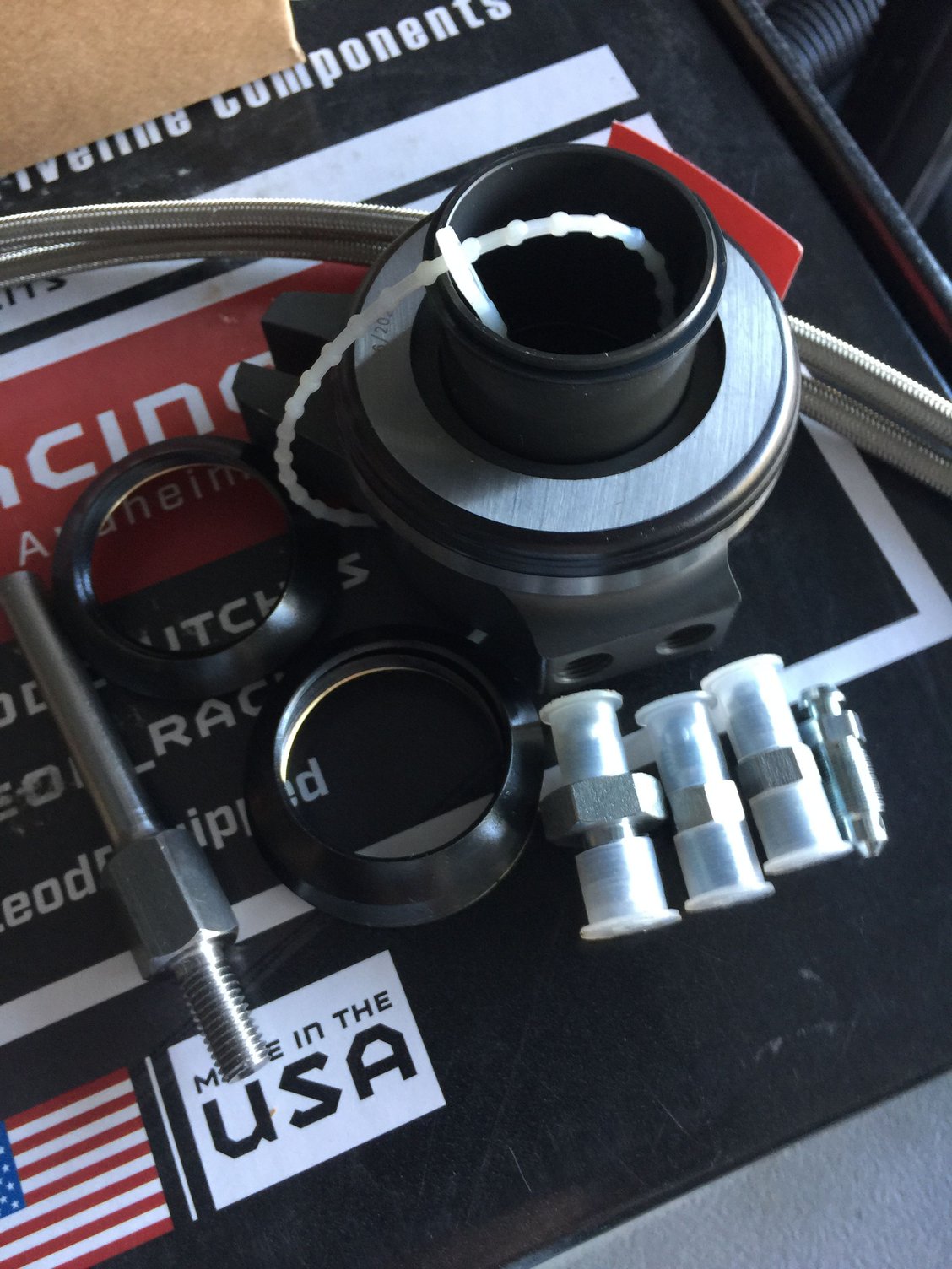

Here the T5 bell housing is being modified for exhaust clearance. A Hydraulic Release Bearing will be used.
Ready to install.

A RAM #78137 HRB and McLeod 75225 Super StreetPro clutch for a T5 will be used.

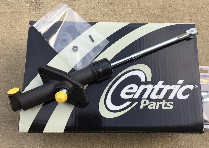

The Clutch Master Cylinder is a Centric #136.62011. It is aluminum and has a 1" bore for use with the RAM HRB.
-3AN O-ring fitting installed for MC to HRB braided stainless line. Russell #640281

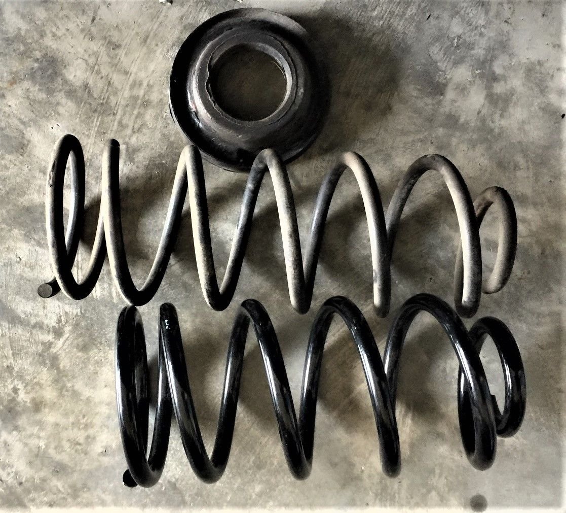

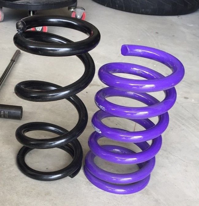

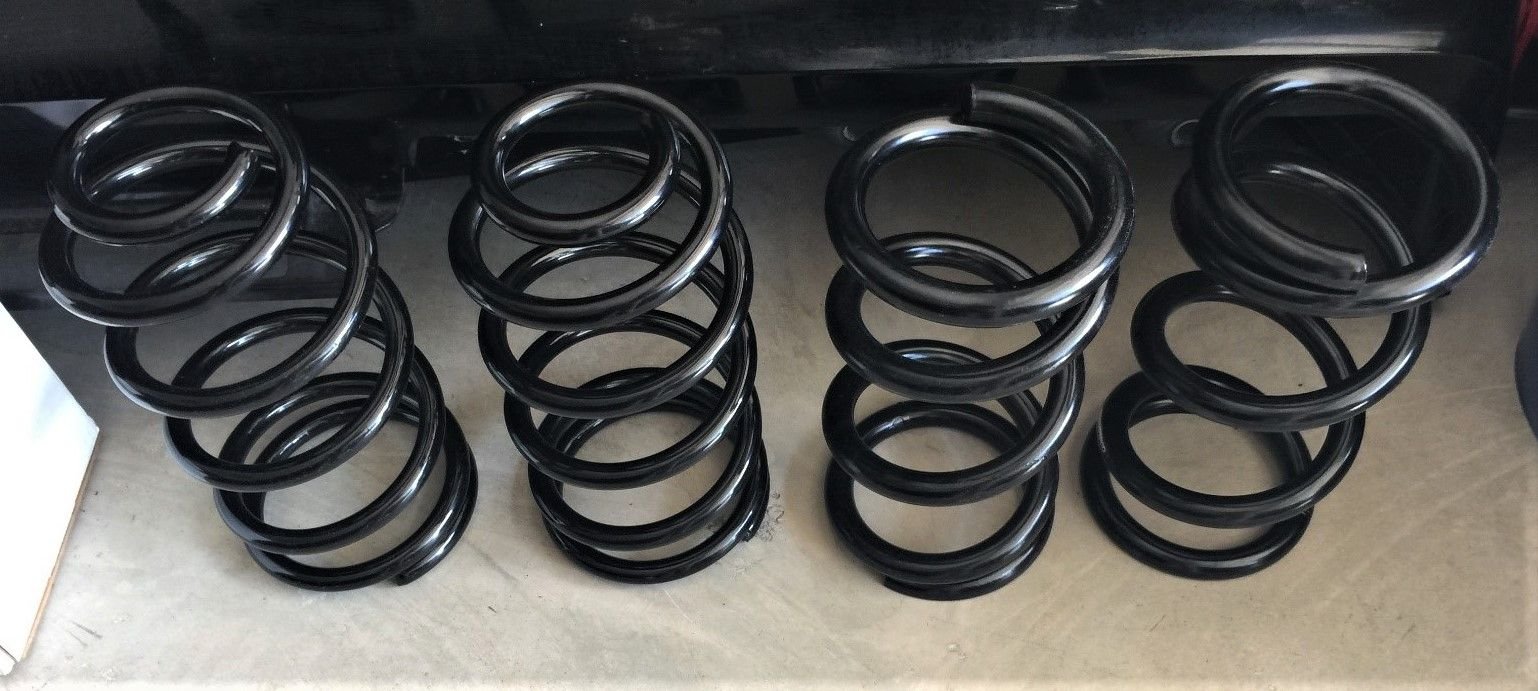

The suspension system is a work in progress. In the Spring of this year I replaced springs. Removed 850lb x 9 1/2" tall Tru-Coils in front and swapped in 11" tall x 1000lb Hyper-Coils.
In the back the factory springs were replaced with 12" tall x 250lb Hyper-Coils. The Hyper-Coils are what they call "Stock Appearing."
12" Hyper-Coil & 15.42" Stock rear spring

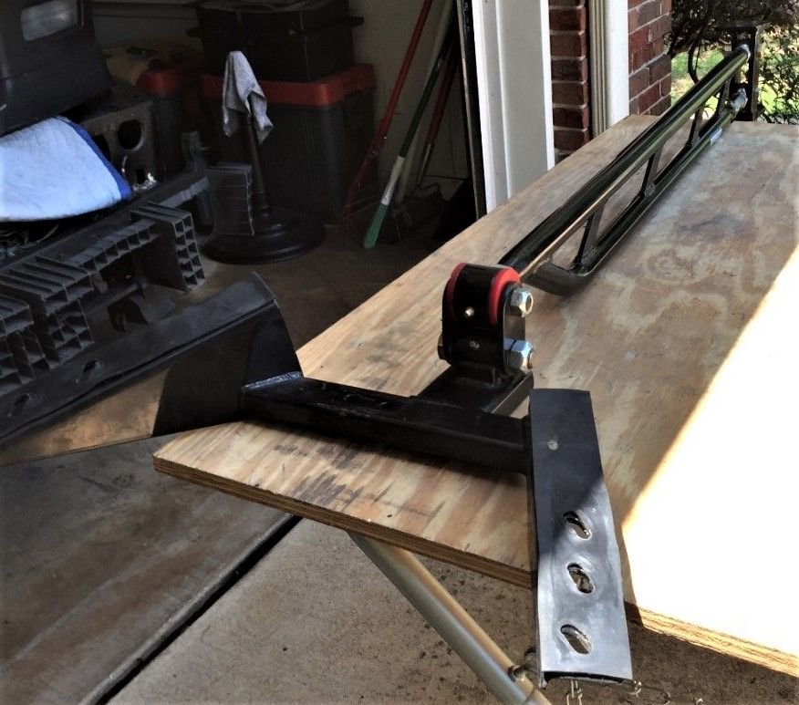

Here is the SPOHN #322 integrated transmission mount and Torque Arm for the Aftermarket T56 mentioned in the introduction. The polyurethane bushing has since been replaced with a Del-Sphere rod end.
Cross-member with weight-jack plates & jacks screws during modification phase. Beaucoup holes were filled, seams welded, everything smoothed, motor mount nuts welded in place and the locating pins reinforced. One fell off when I removed the cross-member, the other I removed by hand.
Cross-member powder coated, frame rails drilled & reinforced for weight jack bolts and engine bay in black primer.

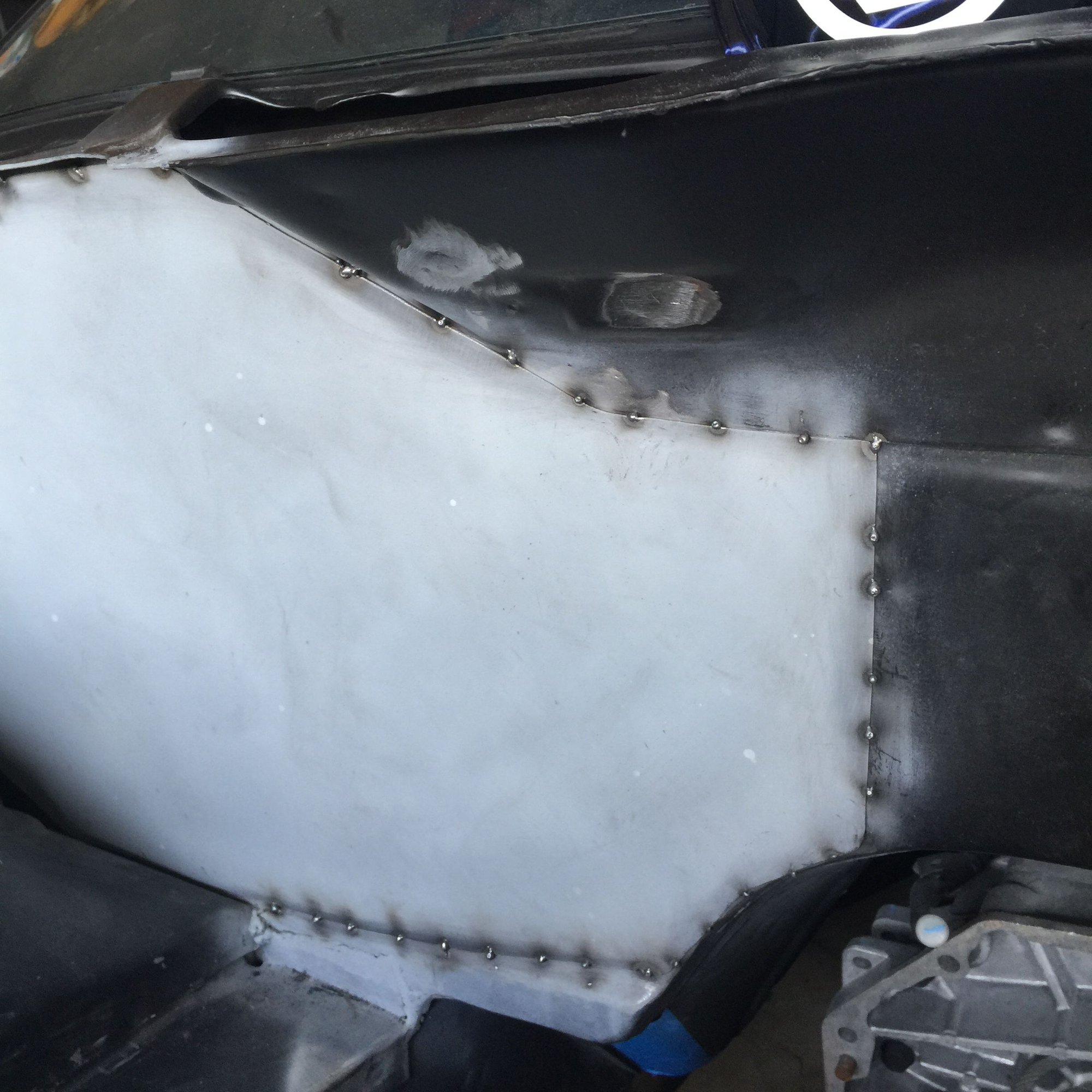

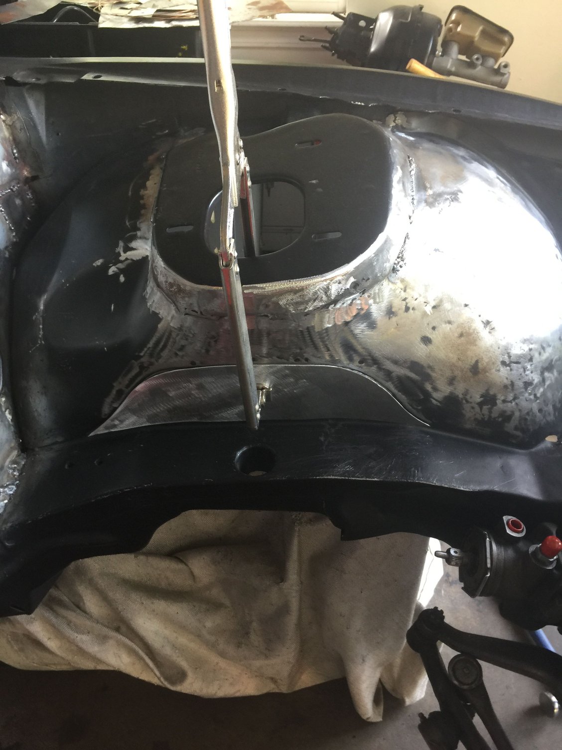

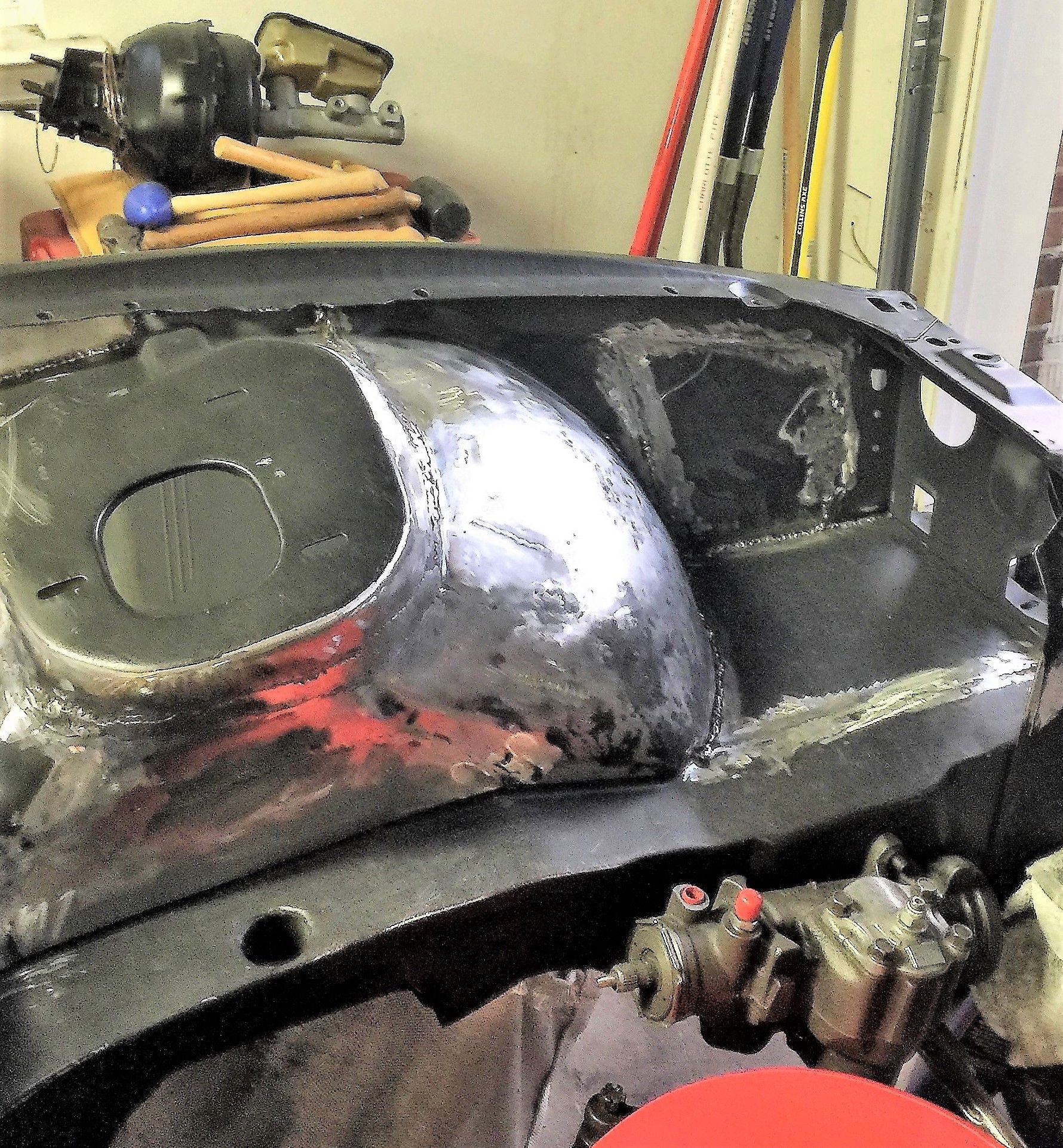

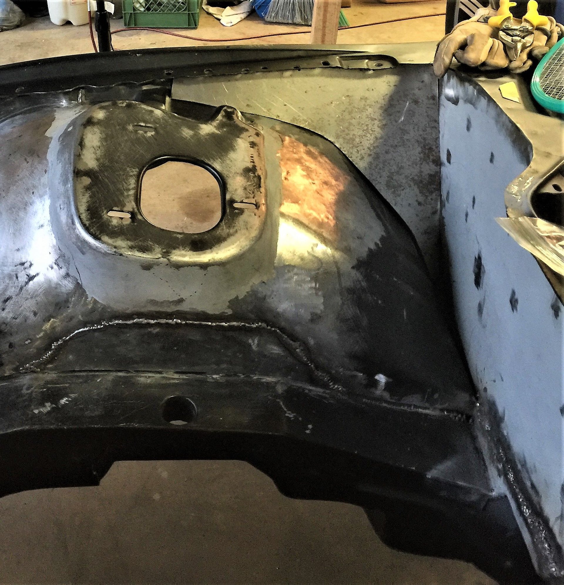

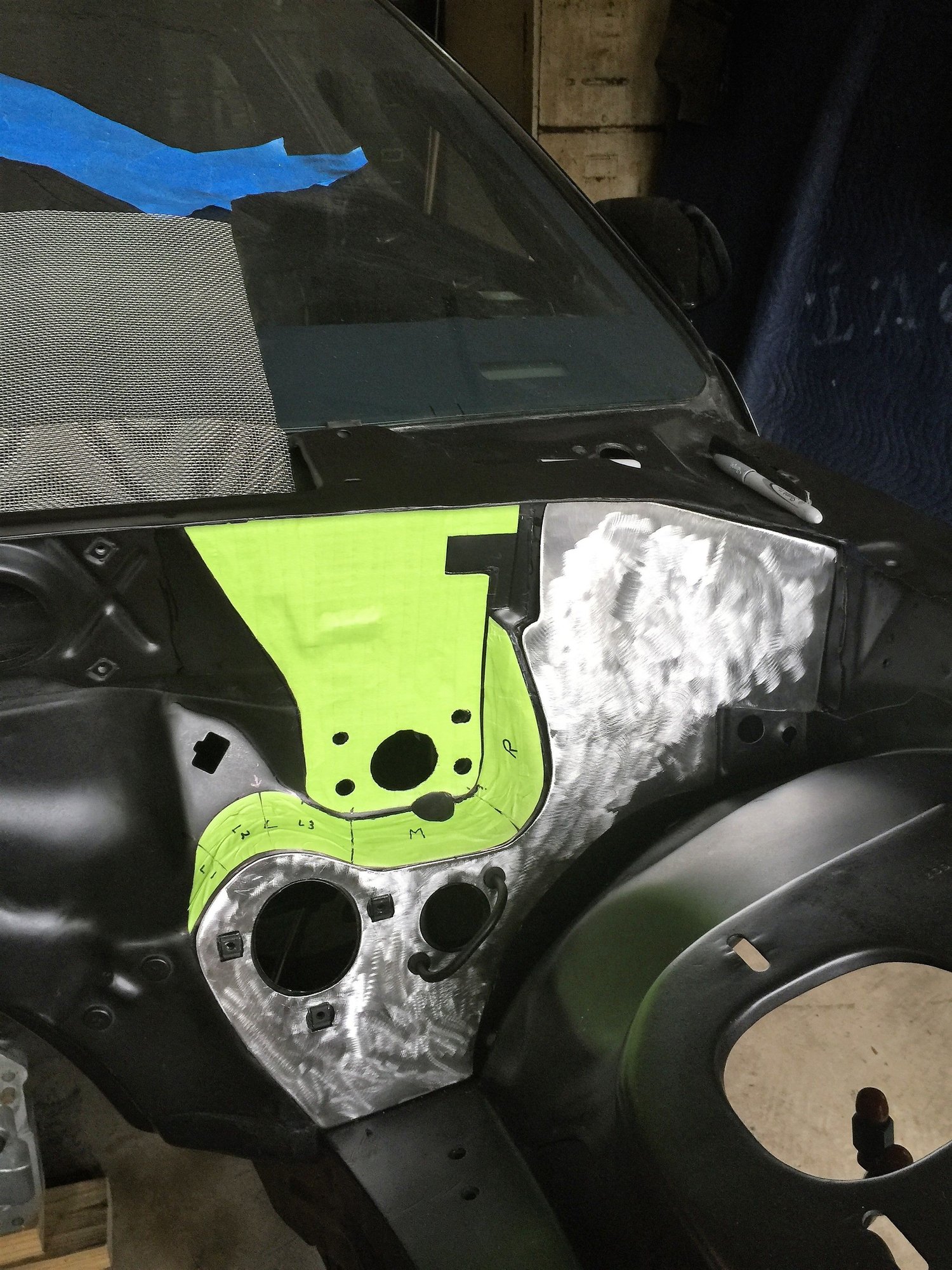

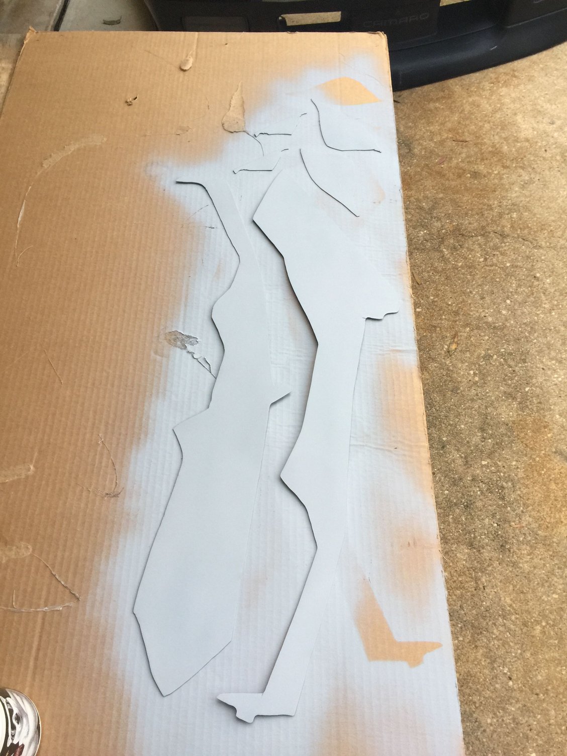

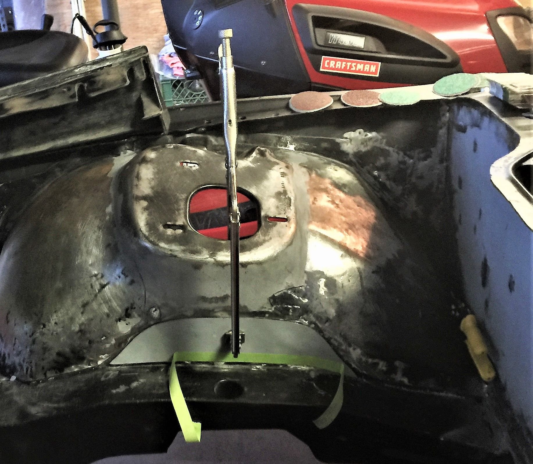

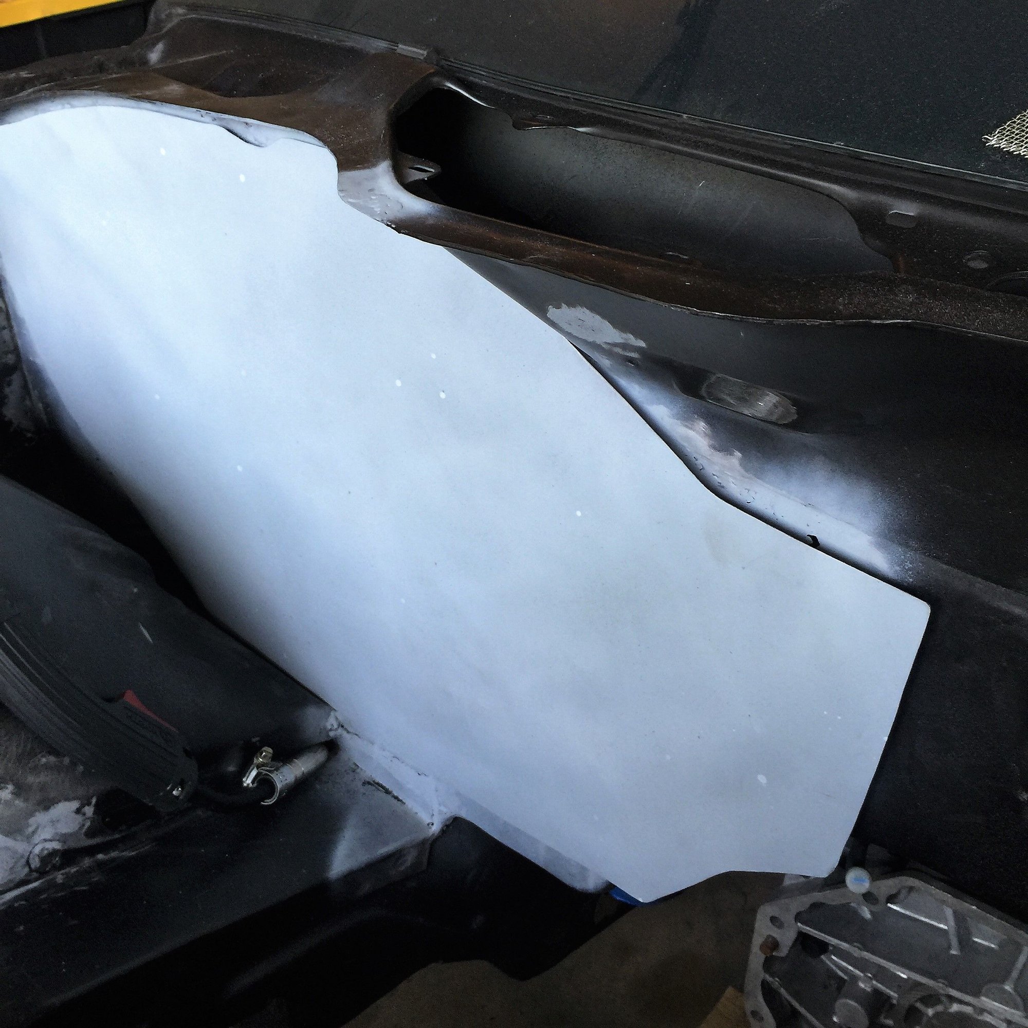

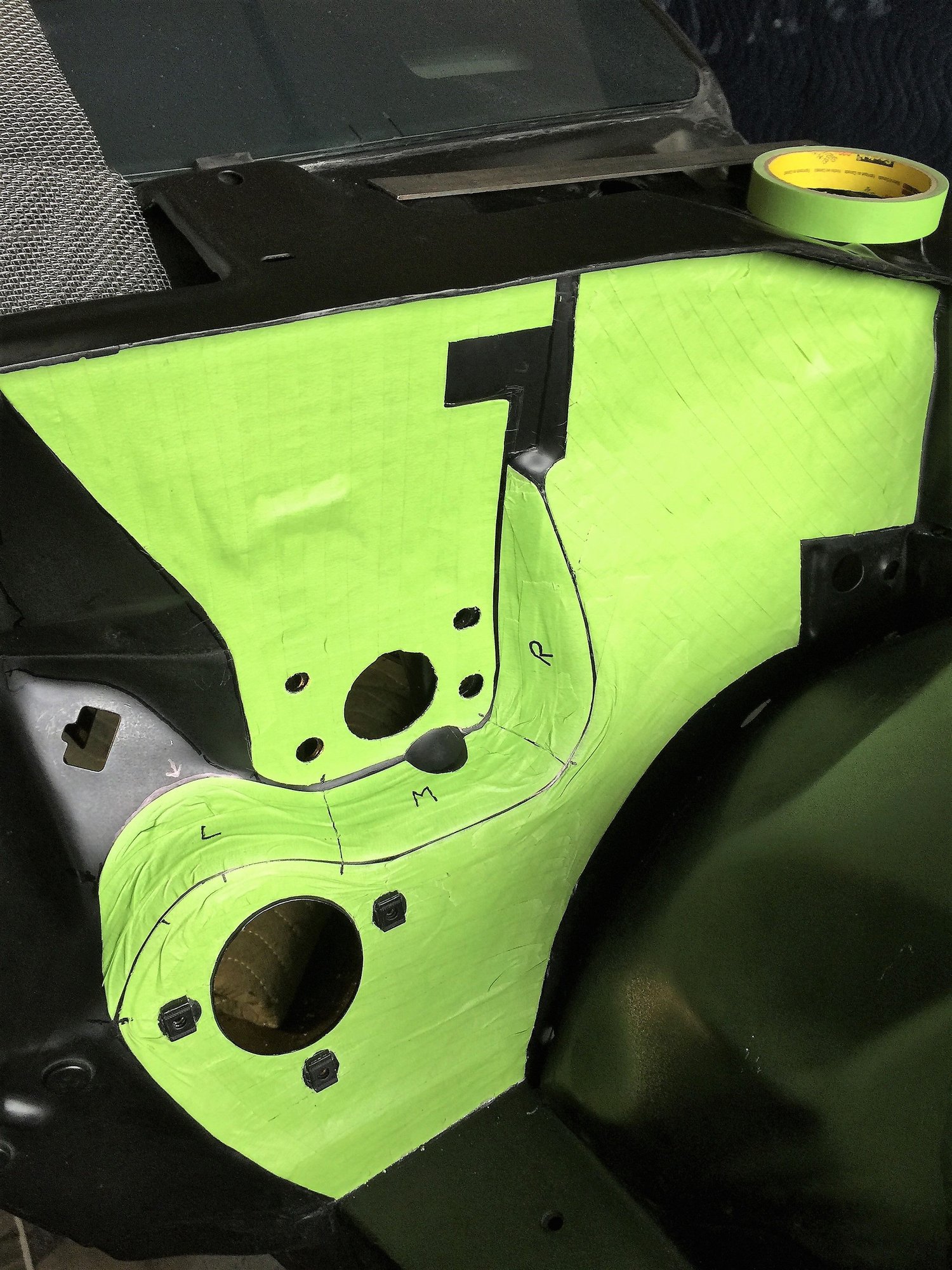

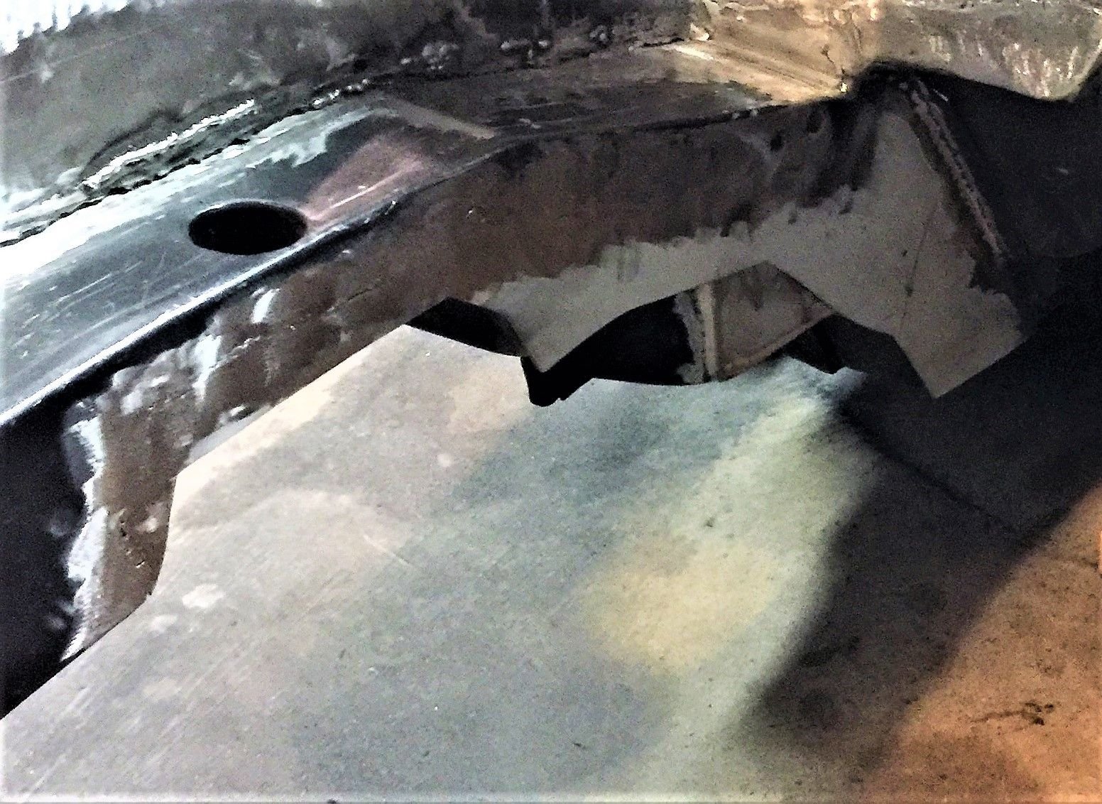

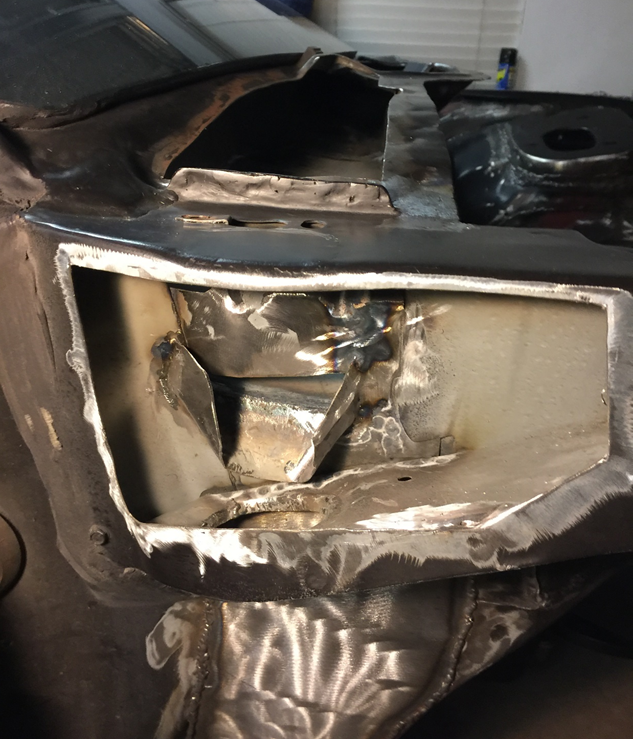

When I smoothed the firewall I removed the A/C bump inside the car. This required a floor for the rain gutter to be fabricated as that was removed with the bump. A directional water spout and drain were also fabricated. I more or less matched the Driver side drain. I planned to delete the antenna anyway, which made doing it this way possible.
Hammer formed rain gutter welded in place
Down spout & drain fabricated
Intermediate stage of welding it back together. The lower cowl was opened up for under dash welding access

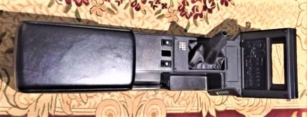

The reason for all the work? A Vintage Air HVAC system. Here the 4-Way bulkhead connector is being fitted.
This is how I "imagine" it will fit. Mounting brackets have to be sorted out. Tried it with the console in place and there is plenty of room.
Next the dash was test fit, and there is plenty of room. No picture, but I put the console & dash together and checked for clearance. No clearance problems so far.

Moving on to indoor projects, the Interior was in need of a lot of work. I found a good used dash pad and leather wrapped E-brake handle. Some rubber cushions for the cargo hatch rest on the back panel. And a "pawl" for the hatch lock. Cleaned everything good. Replaced the plastic lens on the instrument panel with a reproduction. Replaced the window switches & door plates with reproduction parts. Replaced all the dash lights with LED's. Also, the missing green plastic circles for the turn signals. Acquired all 3 missing, under dash, "close out" panels. Found the retainer brackets for the convenience center and the fuse block. And a replacement fuse block. The original had most of the labels rubbed off. That's the highlights. Anyone who has tackled one of these interiors knows there are a thousand little thing to do to make it right.
Console closeup after cleaning & treating with plastic restorer. That's a reproduction shifter plate. Also, a 6-speed shift pattern decal.
The cushion was a reupholstered piece from HAWKS. Kinda lumpy. A previous owner had hot-knifed the area around the console mounting screws to get it out. I removed the screws with vice-grips and still need to repair the floor. As with many of these lowers the inner structure had pulled apart. I used fiberglass mesh & epoxy to put it back together. It's nice & solid now and you can't see the repairs from the outside. If it wasn't for the RPO codes in the thing I would have replaced it.

Here's the Trans put together. The Reverse Lockout pigtail arrived today so I put it on. The rear seal for the driveshaft is torn and needs replaced. It's been in and out of the car too many times without checking for lube. I have a new seal for it

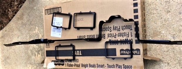

Re: Project88

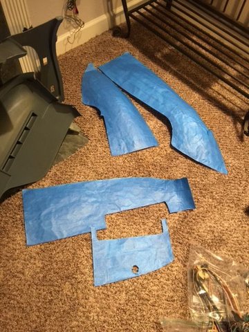

Used rust converter then painted the dash brace and headlight trim. Does anything look worse than rust in the interior?
These rear plastics had carpet on them as part of the Deluxe Interior. Adhesive residue was a bear to remove. I used everything I had, lacquer thinner, acetone, Naphtha, denatured alcohol, a scrapper, goo gone, a Scotch-brite, a putty knife, it was brutal. They needed to be smooth so patterns could be pulled from them.
Carpet patterns made from painters tape.
Other interior parts, some new, some used.

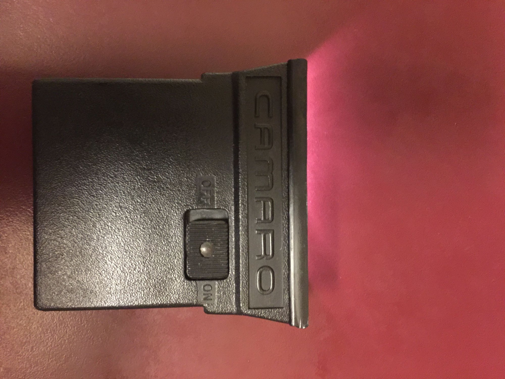

Re: Project88
I think these were discontinued in 87 but I always wanted one so. . . This came to me rough. Amazingly, all the wheels work and the felt was in the map light. I sourced a better dome light cover and map light lens. Then following various write ups on TGO, repaired the dome light socket area as the connectors had melted the plastic. LED's replaced the original dome & map lights to fix the problem. It came with a Camaro flashlight but it could not be saved. The batteries had exploded long ago and done irreparable damage. The one in the picture is just an empty case. I located a replacement in Canada that also needed work but cleaned up nice as can be seen working in the pictures. It has a new bulb but these were never very bright.

I'll post the engine bay progress to date and that will pretty much be it for past progress. I tried to install a set of rear hatch hinges and exploded the glass. I will be turning my efforts toward that for now. It's funny but, I have had those hinges on a wish list for years. Careful what you wish for. Anyway, first up is the firewall mods followed by inner fenders then frame rails. So much work has gone into this that recording it all here is unreasonable.
First firewall panel installed
First firewall panel drilled for plug welds
Second firewall panel

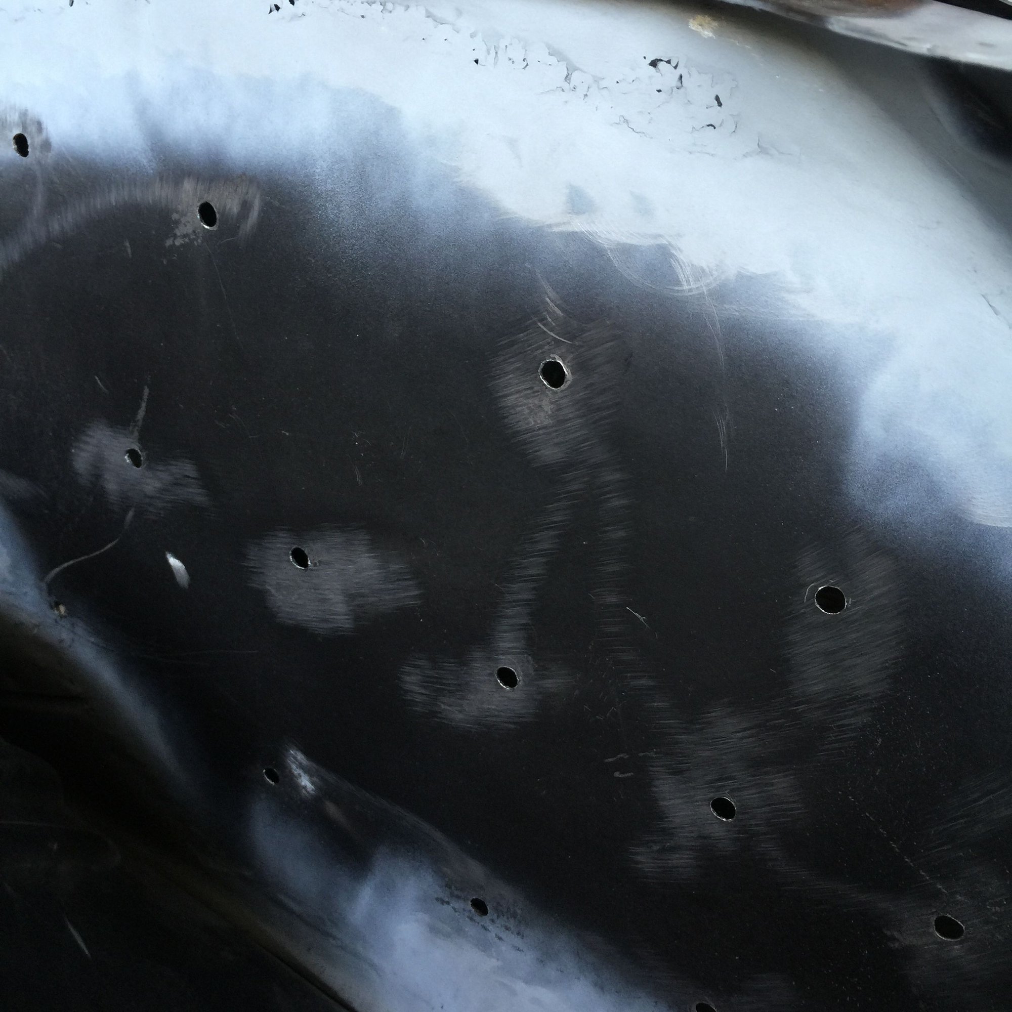

In keeping with the custom theme, several areas on the inner fenders are in need of modification.

Re: Project88
Changes of this magnitude take time
Another reinforcement plate for a total of 3 at the firewall, plus, inner fender close out panel
more welding
headlight area smoothed
Test fit of passenger side closeout panel. It was refined a bit before welding
starting to look better
battery tray delete

Re: Project88
Then the frame rails were filled in
Starting with tape patterns as usual
Cutting panels from patterns
Weld thru primer on both side
Driver side before hammer forming bottom to frame rail
Test fit of cross member
Passenger side before hammer forming with one piece missing
Test fit
