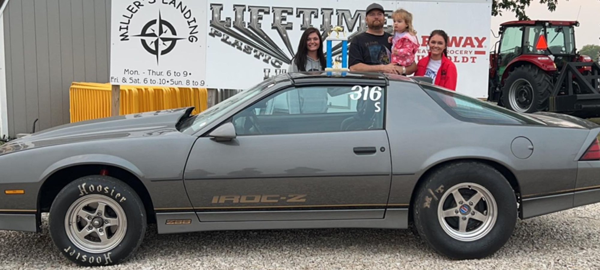

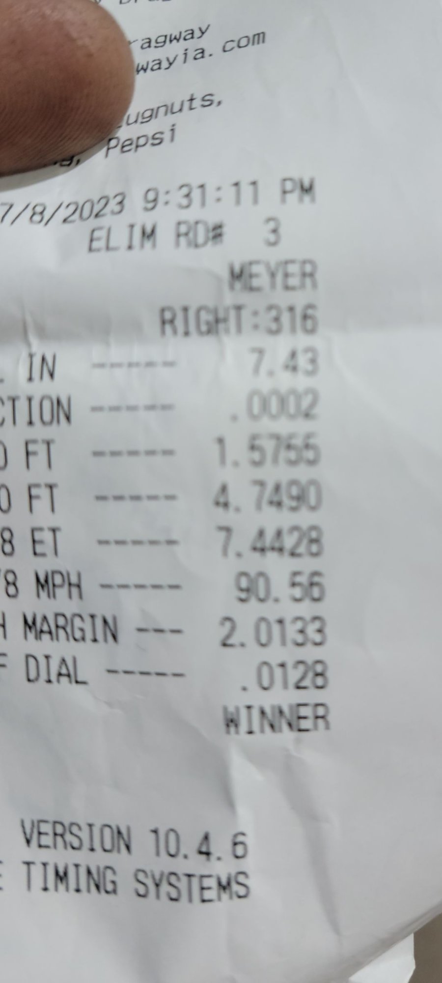

Not as good as I'd hoped, but definite improvement. But I still blew the doors off of a 2017 ZL1 with tons of mods and drag radials

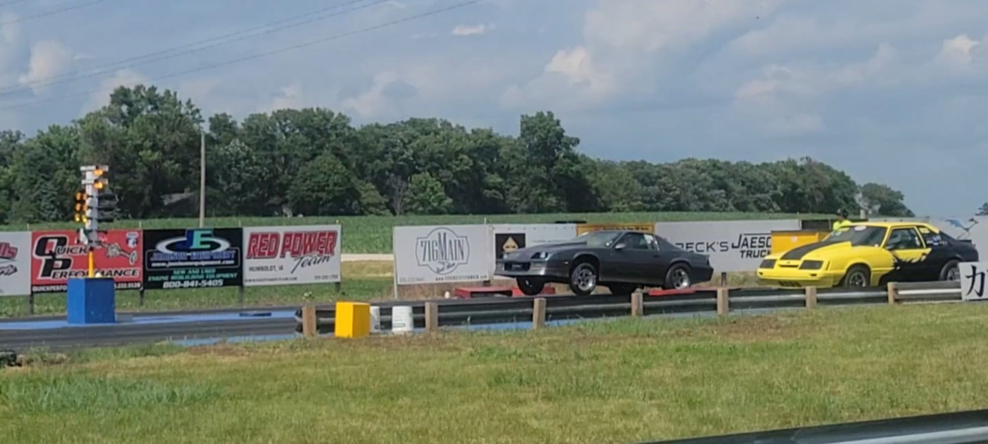

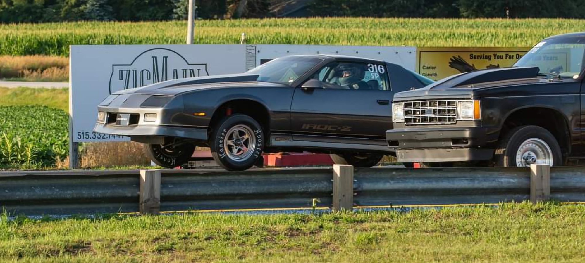

Our races were canceled Saturday due to rain, so they had them on Sunday. I took the car all the way to the final round, and then broke out by .0059 seconds. All of my family was there, and I wanted that win! I sure tried!! The car is SUPER consistent. Here's some launch pics..

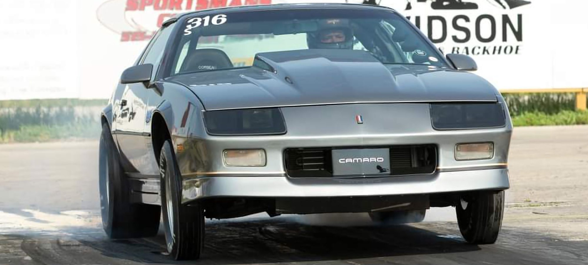

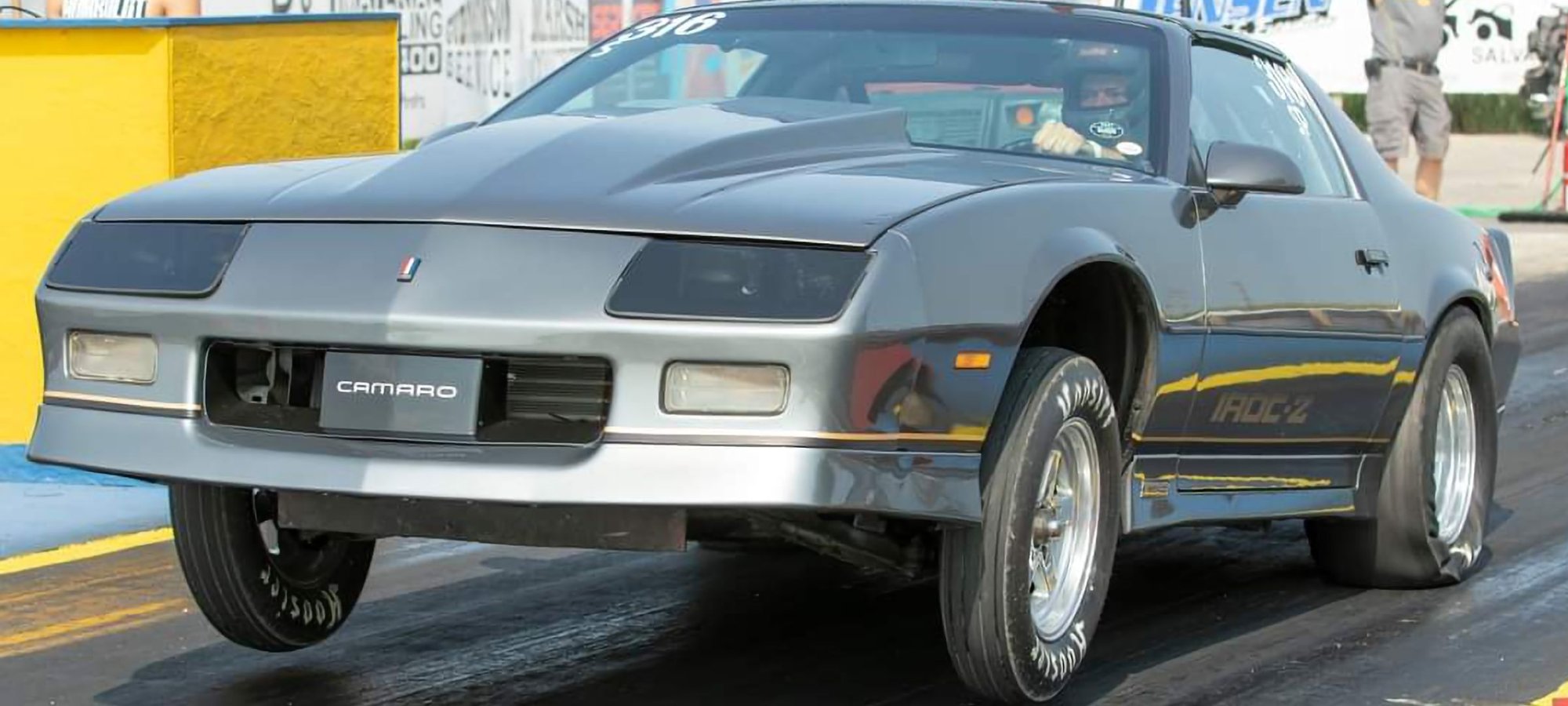

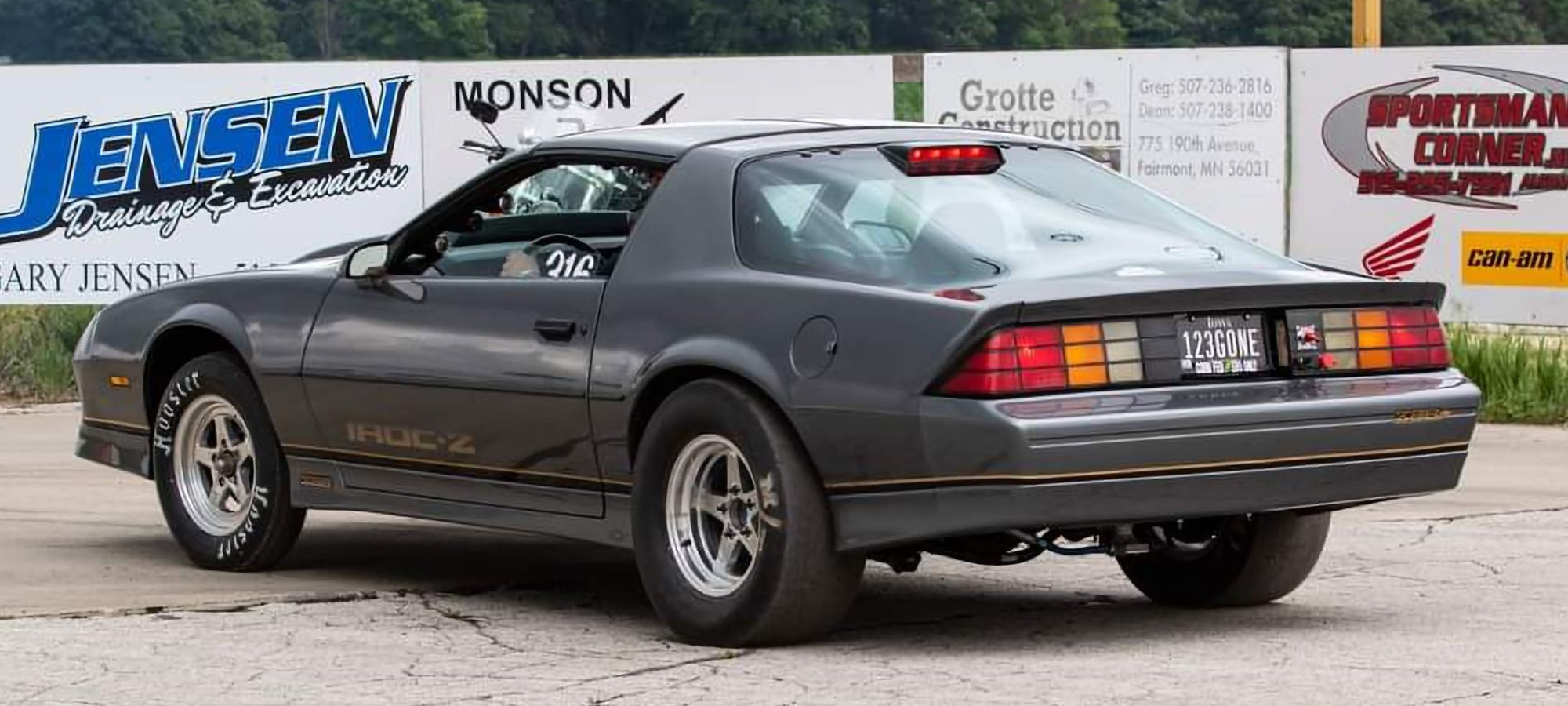

Not sure if these will do anything as far as e.t. is concerned, but thought they might help out the aerodynamics?? Havent seen blackouts for these things in YEARS...

Nice wheels up pictures.

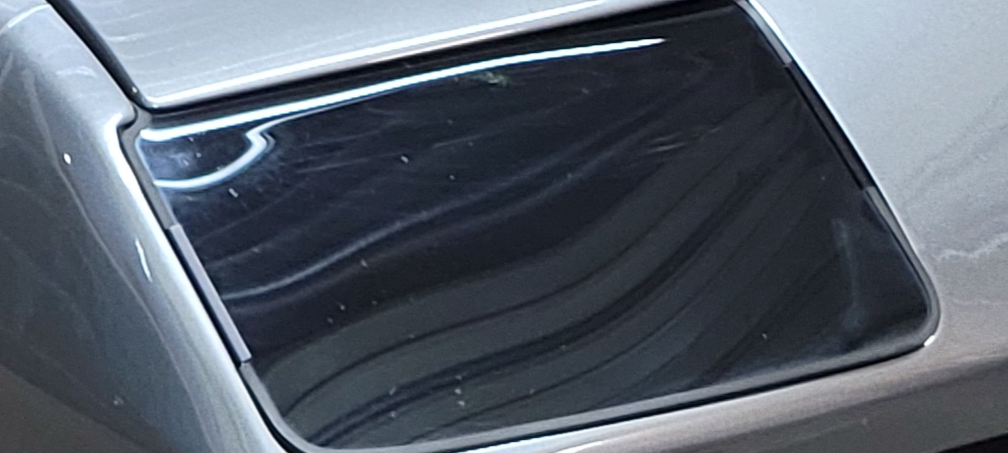

Recap? What do you have for suspension upgrades? Struts/shocks, springs, sway bars? Looks like some drag racing specific stuff under there.
As for the blackouts, I've always liked the look but not the hardware that fastens them.
Any detailed pictures?

Haven't seen blackouts for these things in YEARS...
There is a reason for that....
Don't do any shopping in the auto accessories section of WalMart.
But I really do like your car.
https://youtu.be/LOLbW2EWcl8
LOL!
Ive never been a big fan of how they look, but im curious if they will shave any time whatsoever off my e.t.
They're held on by 2 little do-flingys that are held on with 2 sided tape. Super easy to get rid of if I don't keep them on the car

Well, I had my car back at the track on Saturday. I made it to the final round AGAIN.....and lost AGAIN, lol. I ran a 7.486 off of a 7.48 dial. The guy that won ran a 7.582 off a 7.58 dial. And he got me on the r/t as well. It was neck and neck all the way down the track.
I'm sure wanting to get a win! Ive ran the car in 4 races since ive had it, and have made it to the final round THREE TIMES and haven't won. UGH.
Anyways, I had two personal bests on Saturday. The lowest R/T that I've ever had in my life at .0002 and my quickest ET so far with the car at 7.39
The car sure works great! I need to set the valves again before it goes to the track again.
Here's some pics...
This was the final round!
Old Jul 11, 2023 | 08:23 PM
  #123
skinny z's Avatar
Joined: Dec 2005
Posts: 9,931
Likes: 892
From: 53.0907° N, 113.4695° W
Re: Bought a mostly strip/kinda street car. 1986 Camaro
Originally Posted by dagwood
The lowest R/T that I've ever had in my life at .0002 ...
Excellent!
Old Jul 12, 2023 | 07:18 PM
  #124
IROCZman15's Avatar
iTrader: (25)
Posts: 1,924
Likes: 329
From: NJ
Car: 1987 IROC-Z
Engine: 406 on N20 w/ EFI
Transmission: P.B. 700R4
Axle/Gears: 12 bolt w/ 3.91
this is awesome! I love reading about dragstrip adventures and updates like this!
also, freakin awesome wheels up launch!

Check out the sidewall wrinkle on the slicks!
Heatin' the hides!
Old Jul 24, 2023 | 04:53 PM
  #129
skinny z's Avatar
Joined: Dec 2005
Posts: 9,931
Likes: 892
That's awesome!
Having a good look at that launch keeps the wheels turning in my head about what rear tire do I go to next.
I've always had some measure of a D.O.T. tire, whether it was for class rules or the convenience of driving to and from the track. BFG drag radials. McCreary Road Star treaded slick (best ever). MT ET Streets. (although the ET Street bias ply were quite the adventure on the highway).
I'm at that crossroads once again.
Is it MT Radials? Hoosier QTP (DOT bias ply slick)? The Hoosier appeal to me in that the track is generally not well prepped for Friday night test and tune. My understanding is that the radials like a prepped track and prefer to dead hook. The Hoosiers on the other hand incorporate some measure of wheel spin and while not the look of your wrinkle walls, work much the same way.
Do you have any side on video of the tire during launch? That would be interesting to see.

I got a win!!!! Ran a personal best 7.37 and also ran two 7.38's that night. Best rt was a .004. It was the Tall Corn Open at the track and they had some badass custom trophies made for it. It was awesome!!
Old Sep 12, 2023 | 09:16 AM
  #131
ironwill's Avatar
Joined: Jan 2008
Posts: 1,336
Likes: 567
Car: 1986 IROC Z
Engine: 5.0 TPI
Axle/Gears: 3.23 Posi
A couple of things:
*Good job on the win; congrats!
*I like that license plate.
*Cute little kid!

Got another win today! The car ran three 7.39 runs today, and all the rest in low 7.40's. My best R/T today was .0003! Everything is working awesome 👌
Me and my two daughters, and my granddaughter in Victory Lane

Originally Posted by skinny z
Launch RPM? 4500?
1-2 shift at?
Best MPH?
Launches around 4,800 for now, but i have a 2 step thats gonna be going in the car. Will probably launch at 4,000 after that
1-2 shift at 6,600 rpms
MPH is usally around 91 mph
Old Sep 17, 2023 | 11:01 AM
  #147
skinny z's Avatar
Joined: Dec 2005
Posts: 9,931
Likes: 892
Do you have a HP estimation and RPM? Pretty sure it's buried in the thread somewhere but I can't find it.
Some quick modelling is showing a more MPH in the 1/8th than the 91 you've indicated. It would seem my HP inputs are probably off. Either that, or you may be blowing through the convertor and not getting the power to the ground. Have you managed to see what RPM you drop into after the shift? I would think no less than the stall but it could be well above. (FTR: The new Yank equipped Monte Carlo, despite having a 700R4 and a really wide 1-2 gear split, wouldn't drop below 5k at any point. That's despite a 6500 RPM shift equalling 3400 in 2nd. Add 10% slip for 3800 with the old convertor).
With the wheels up pictures at the look of the slicks on the launch, I'd say traction isn't an issue so I can dial in your 60' easily enough.
Keep in mind though, that should you do the gear swap, traction may become a problem but I can simulate around that.
Old Sep 17, 2023 | 11:06 AM
  #148
dagwood's Avatar
Top Answer: 1
Posts: 2,678
Likes: 1,267
From: In the paint booth!
Car: 1986 Camaro Drag Car
Engine: 383 on Ethanol
Transmission: Automatic
My engine dynoed 476hp @ 6,300 rpm's. The engine builder told me their dyno is "tight" and shows around 10% lower numbers than other dynos.
I guess I've never paid any attention to what the rpm drop is between shifts. The stall is around 4,600 to 4,800 ish and i don't think it drops below that
Shift light comes on at 6,600 rpms
Old Sep 17, 2023 | 11:16 AM
  #149
skinny z's Avatar
Joined: Dec 2005
Posts: 9,931
Likes: 892
OK. With 476HP on the dyno I can work with that until I can corelate your time slips vs engine output. Typically I see a reduction in actual as installed HP when compared to the ideal dyno numbers.
That said, it'll be a bit before I can get back to this. I'm putting my own engine together (and hope to have at least between the fenders by tomorrow's end) and I really should get back to it! It's fighting me every step of the way though.
Old Sep 17, 2023 | 11:18 AM
  #150
dagwood's Avatar
Top Answer: 1
Posts: 2,678
Likes: 1,267
Good luck with your project! And THANK YOU for playing with my numbers!!!
