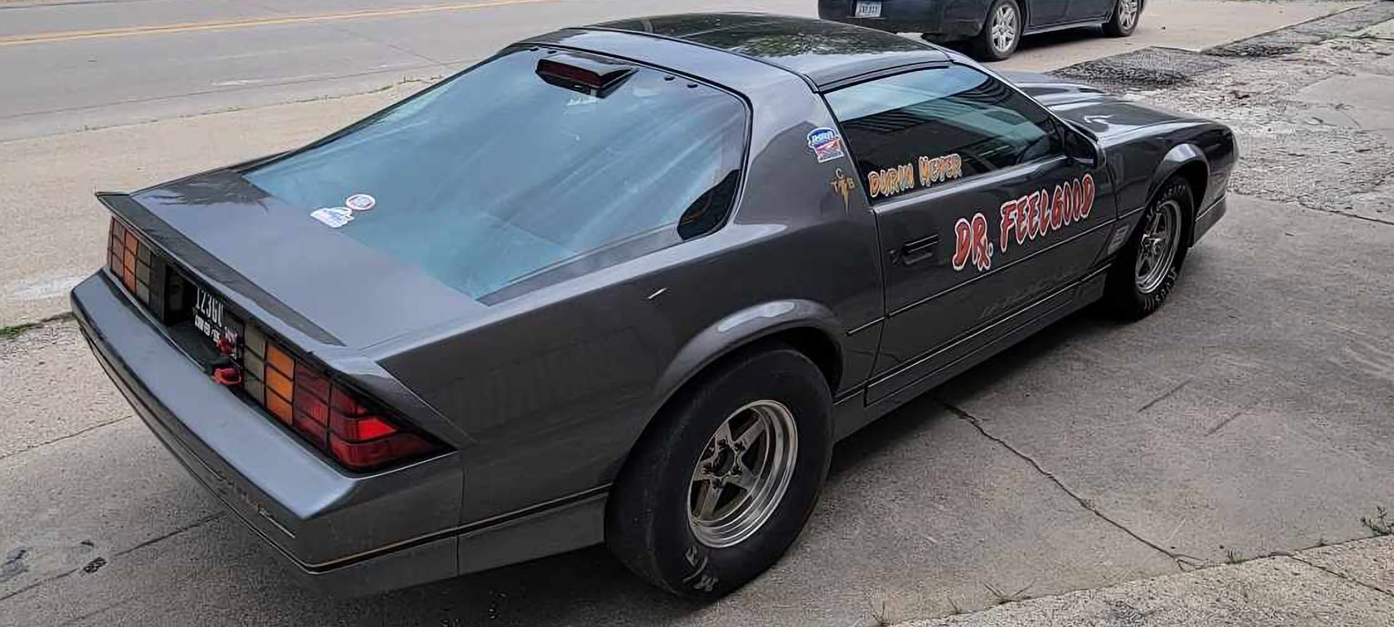

I gave my youngest daughter a ride in the car during time trials on Saturday. Here's a view from the passenger seat...

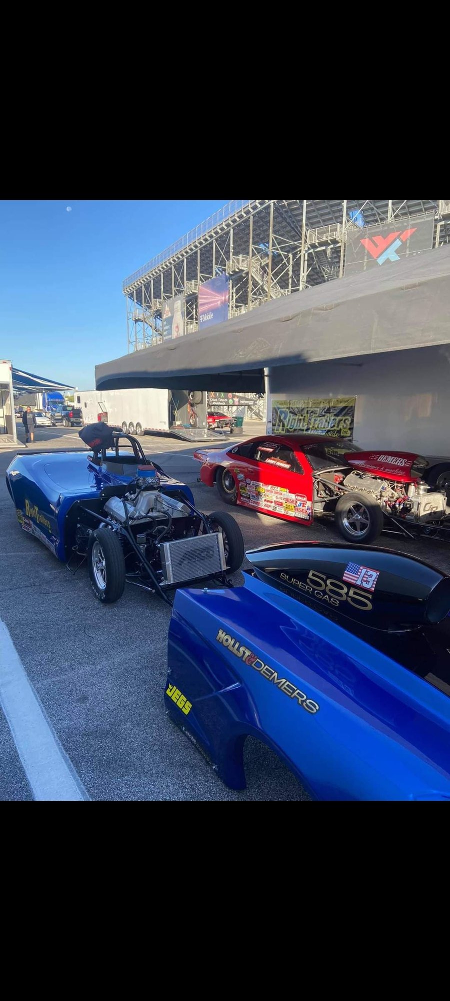

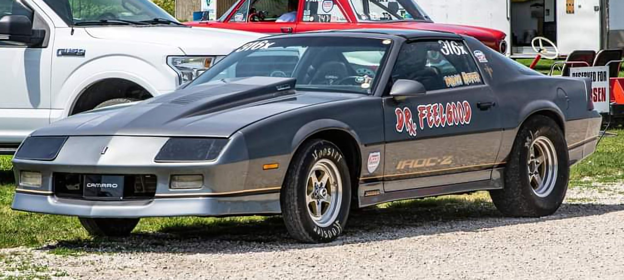

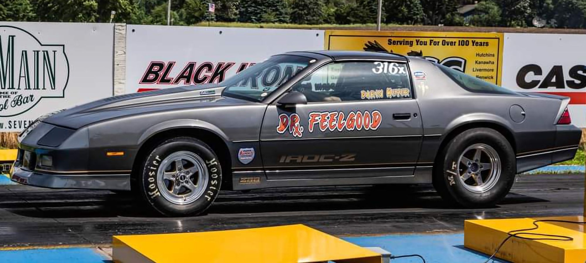

I made it to the final round AGAIN today, but didn't get the win this time. My car still runs the stock fuel tank, and sometimes after I refuel the car, it will bog after the launch on the first pass. We'll tonight when I got to the fi al round, I was waaayyyy low on fuel. I took a chance and didn't refuel it because I was worried it would bog. Well....it was a little too low on fuel, and when I launched the car, it BOGGED......and all i saw was taillights. The car is getting a fuel cell this winter. (I already have one) Anyways, I was super bummed that I didn't get the win, but laid down super consistent passes all day, and was killing them on the tree. I even had the holeshot on the final round! My best r/t's today were a .004, a .003, and a .002. Lots in the .01 range. Anyways, just thought I'd share!

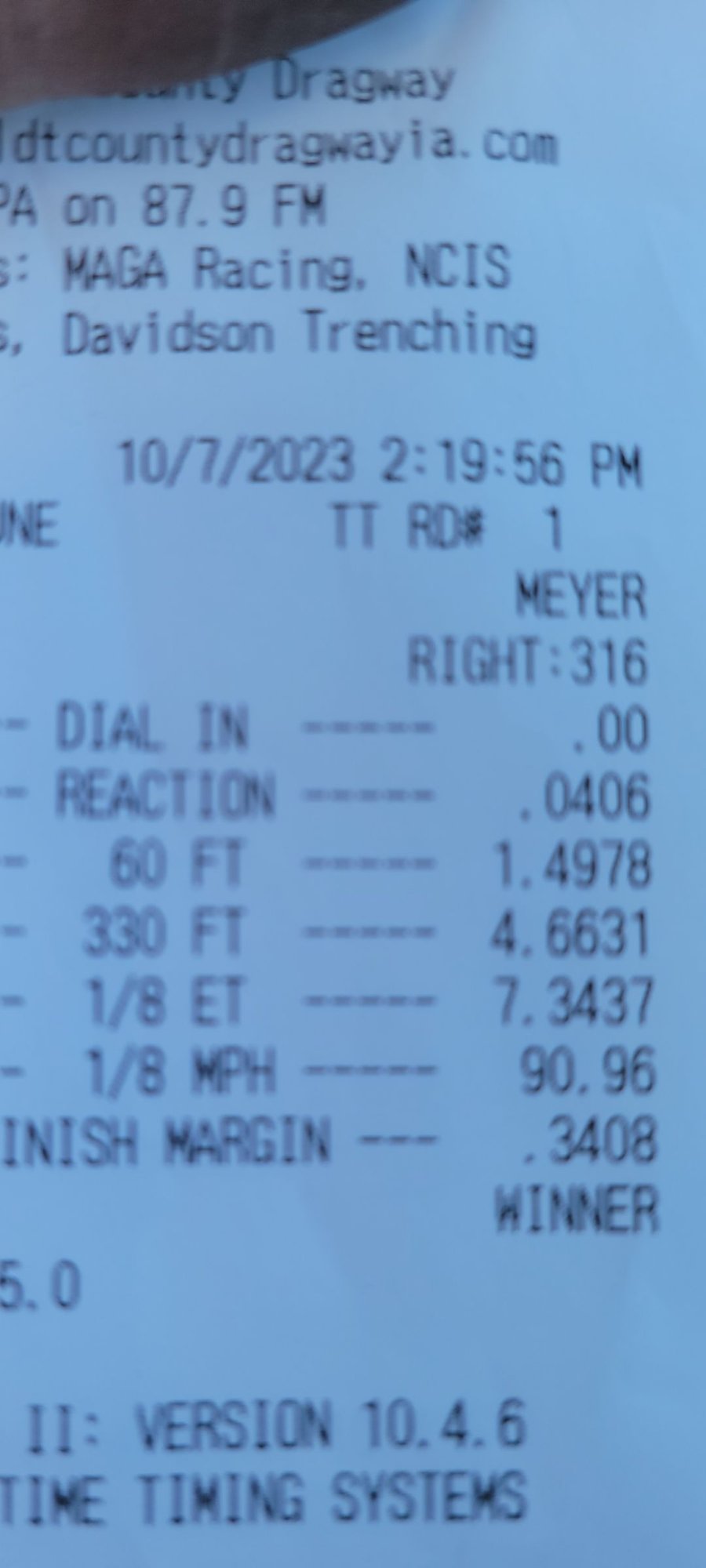

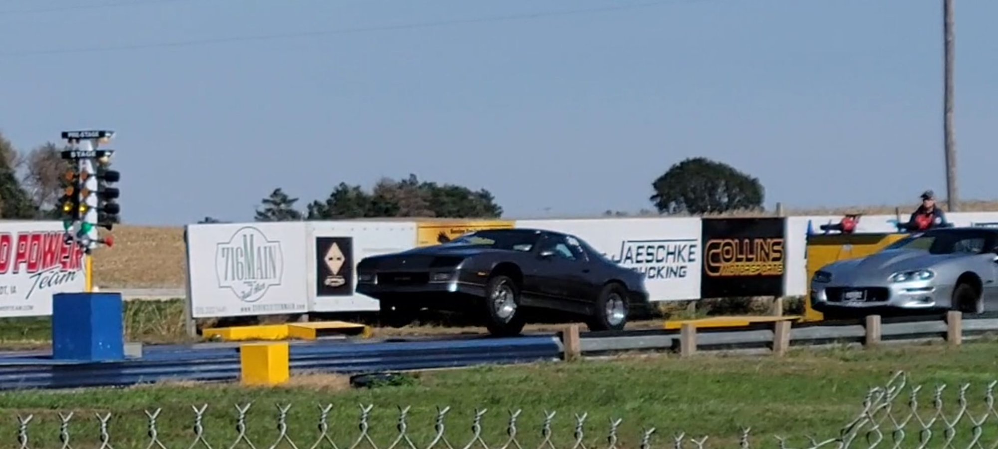

Had a fun day at the dragstrip today! I red lit in the 2nd round of eliminations, so that was a bummer. But I ran a personal best 7.34 in time trials today, and backed it up immediately afterwards with another 7.34. Also had a personal best 60' time at 1.49 seconds. The car ran great all day. I even had my 2 biggest wheelies! 😁

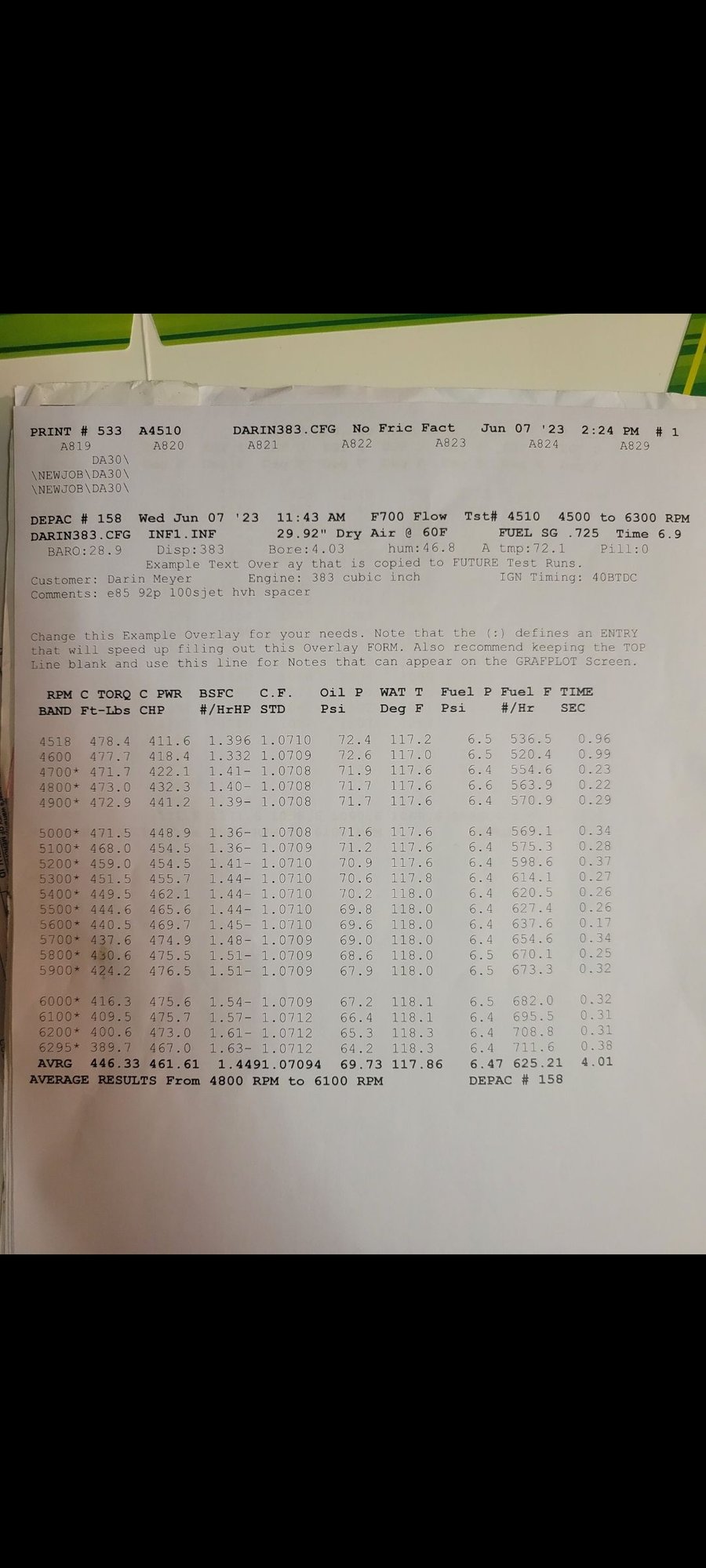

I was a little off...it made the most hp at 5,900 rpm's. I didn't have the sheet in front of me before. The shift light comes on at 6,600 rpms.

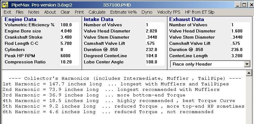

I sent that off to my thread at Speed-Talk. Rick took off further with it and now Mr. PipeMax, Larry Meaux has tossed in his two cents.
There's a lot of data and dialogue. I think too much to post here but I don't think you can see the graphs and charts unless you're a member.
I'll download them and post them when I have a chance.
The thread is here:
https://www.speed-talk.com/forum/viewtopic.php?t=68217
It's a couple of pages and a half dozen spread sheets. It's gets meaty at the end.

In case you're interested in a data overload, this is one Speed-Talk members input and calculations.
Thanks for the dyno sheet. It also raises more questions.
BSFC for a naturally aspirated E85 engine should be around .65-.7, which makes for .65*476 = 309pph of E85, not 680-700. Something isn't right with the dyno numbers.
I can make the trans a 2.48/1.48 2 speed but the rpm at the 1/8th is 7300 and change, not the reported 6700.
Anyway, I can pretty much nail the incrementals with the dyno numbers for the given data with a little massaging and lowering all hp numbers by 11%.
That gives around 423hp which nearly matches the high number from Wallace calculator for 1/8th mile.
Now, just substituting 4.86s, traction is lost due to the increase in starting line ratio. Adding an inch of tire width and reducing convertor slip due to rear gear and it's possible go a tenth faster and maybe .7-.8mph faster.
Feel free to ask questions as there are some tweaks made to "cheat" the program to mimic the data and accommodate improved traction with the changes.

My engine was built at Demers Performance and Machine, a high performance engine shop, and the owners have a multi car NHRA team, and they have lots of Wally's. I'm 100% certain there is nothing wrong with their dyno numbers...and one of the owners was the guy that dynoed my engine
To put things into perspective, I ran a modded 2017 ZL1 Camaro on beadlock drag radials, and blew his doors. He was running 8.0's.....and computer calculations would show his hp at like 370, and hes probably double that.
I do, however agree that something is holding the car back. Like the converter.....I don't even know what brand the converter is....it's pretty small, and it's purple??

Just a follow up from Rick who has obviously checked out your posts here.
You may or may not find it accurate or relevant. But between him and Larry, they see the obvious potential that you're looking for. Both men are men of science. Racers too but very much into the virtual development and are, just like your dyno guys, highly experienced.
The models work from engine hp and not wheel hp. They are also straight physics and equations of motion, which is why Larry's calcs are coming up with very similar results.
Dagwood seems to be a drag racing enthusiast which is fun to see.
The correction factors for the timeslips he has posted on Thirdgen are as follows:
6/16/2023, 7:32pm: 1.090
7/08/2023, 5:54pm: 1.084
7/08/2023, 9:31pm: 1.075
7/08/2023, 10:11pm: 1.068
10/7/2023, 2:19pm: 1.048
Dividing 476hp by each of the CF gives reasonable engine hp for the ET and weight of the car. It also shows a reason for the ET dropping later into the night and the season. Once he figures out what air pressure and burnout time, along with torque arm and shock adjustments are needed to hook with the 4.86 gear, he'll do fine with the way the car is set up. Proper changes to the convertor and sealing the air cleaner to the hood will also help reduce ET without changing its consistency in printing time slips.
Dagwood will figure out how to be a big fish in a small pond once he figures out how to cut "teen" lights consistently. As long as he's having fun, that's pretty much all that matters.

Even more reason to look closer at the combo.
For example, during your engine dyno the engine is said to consume 670 lb/Hr fuel. Does that pass the laugh test? Seems like a **** load of fuel compared to Hp figures.

I looked up the Specific Energy of Gasoline and E85, Wiki Link to Specific Energy
Based on those numbers, it appears that E85 requires +40% more fuel by mass (or +30% more fuel by volume) to make the same power as gasoline.
A typical good running naturally aspirated gasoline engine has a BSFC = 0.5 (in SI units),
meaning it consumes 0.5 lb/hr of fuel for every 1 Hp produced.
E85 would be +40% above that, BSFC = 0.70
Your engine has a BSFC = 1.5, as reported on the dyno chart,
meaning it consumes 1.5 lb/hr of fuel for every 1 Hp produced.
That seems insanely inefficient.
Maybe I made a mistake somewhere, but it seems there is MAJOR power gains possible if you can get your engine to run more efficient.

Hmmmmm......ill have to talk to someone to try to figure out what i can do!
It has a Quick Fuel E85 850DP carb on it, so i wonder if the carb is too big?

Do you remember this comment from Speed-Talk?
Thanks for the dyno sheet. It also raises more questions.BSFC for a naturally aspirated E85 engine should be around .65-.7, which makes for .65*476 = 309pph of E85, not 680-700. Something isn't right with the dyno numbers.
​​​​​​You dismissed it citing the shop's reputation.
It may be a problem with the dyno on that day. Or something with the engine that was overlooked at the time.
​​​​Perhaps, seeing as it was dynoed there and they produced the numbers, you could ask.
A couple of questions though. And an observation.
Are you running the fueling system as it was on the dyno? GPH and PSI specifically. Obviously it was tested with the carb that's on it now (wasn't it?).
How about headers? Did you use your chassis headers or ones that the shop had. If it's the latter, what are the differences in spec?
As for an observation, with 11.2:1, why bother with E85 or the racier stuff? There are plenty of pump gas engines with that CR that race. I've been part of several of those.

As for the BSFC, there's something strange going there as was pointed out (here via QwkTrip and at ST).
You might owe it yourself to give your engine dyno guys a call.

Re: Bought a mostly strip/kinda street car. 1986 Camaro
Originally Posted by dagwood
I should have specified that since this engine was built, I have been running open headers. They have the flange on the ends and I have those little header mufflers on them. They don't do much..
That might even be worse but the facts can't be known without some investigating.
I've an old copy of PipeMax. If you'd like, I can run your numbers and see what the header secondary diameter and length should be.
Something else to consider is how the muffler behaves with respect to what it presents to the collector flange. Some, like a Flow Master chambered muffler, reacts somewhat like open atmosphere. The result is a very short secondary which is almost exclusively a torque killer. I've many memories of driving my fresh builds to the muffler shop with open collectors. They were absolute dogs at any RPM below 5000.
Other mufflers, like a glass pack, behave as an extension of the header secondary and add length overall. That's generally better for TQ.
Two entirely different results.

My engine was also dynoed on pump E85. I'm not sure if there's much of a hp difference compared to race E85?
For the record, this is what PipeMax specified for my exhasut. Header primary diameter and length and the same for the secondary/collector. Full exhaust lengths are also included although as mentioned some of that length is muffler specific.
On race days (as it'll still be streetable) I'll test the 18.5" open collector. If I can get proper muffler data, then maybe 36.9" with a glasspack header muffler. That is if the data supports the glasspack behaving like an additional length of open exhaust pipe rather than open air.

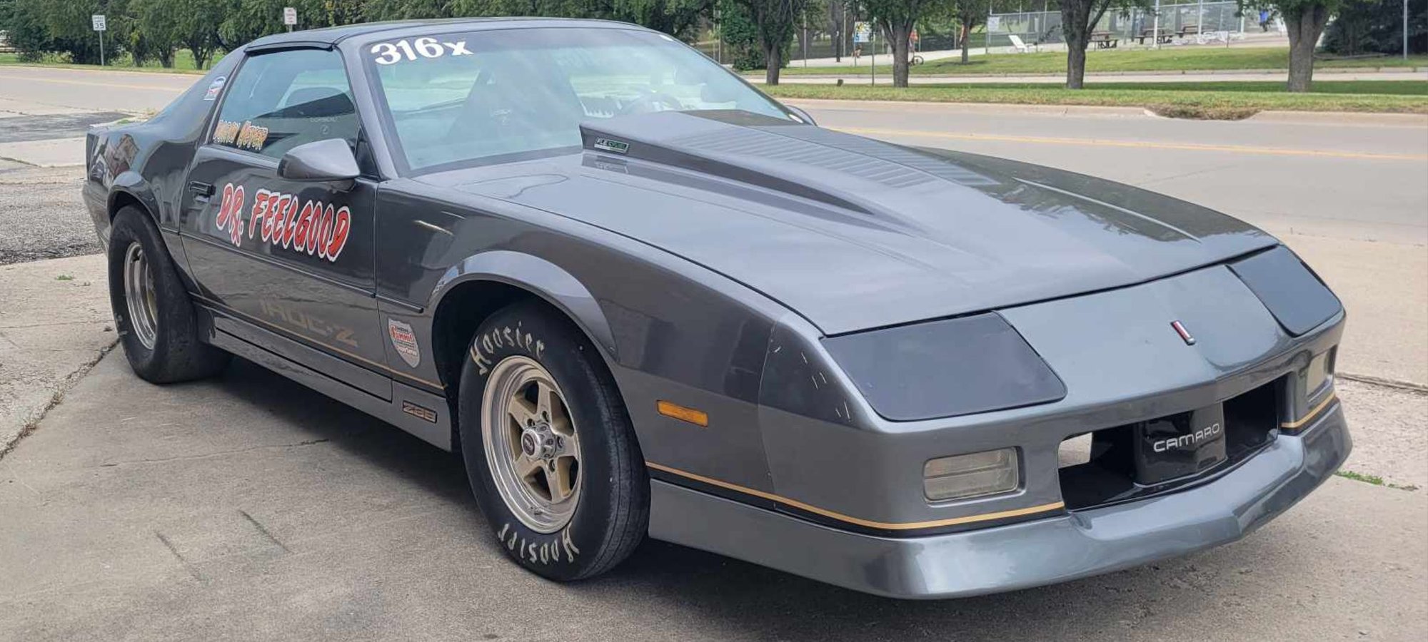

Alright, I haven't made an update for a while. I have made some changes to the car, and I have a race tomorrow so I will see if anything changes with my et after the last change.
#1, The car has a name, lol. I wanted a name that screamed 80's. Ladies and gentlemen, let me introduce you to Dr. Feelgood!
#2. I changed the gears from 3.90 to 4.86 and it changed the shift points A LOT, but the car still ran 7.30's and 7.40's. Maybe 1 or 2 mph gain.
#3. My torque converter failed at the last race. So I just finished up a converter swap. It previously had a 10 inch with 5,000 stall, and I just put in a 10" Monster converter and the same 5,000 stall. I installed a 2 step box this week, too.
I had a few people tell me that my converter was possibly holding the car back, so tomorrow will be the first time at the track with the new converter. So I guess I will find out of there's anything to that. The sprag was coming loose in the other converter, so who knows how long that was going bad??
Anyways, I have been running the car in the IHRA Mod ET class, and have been doing pretty good. It's the biggest class at our track, and there are some heavy hitters in it! The last time the points were updated, i was sitting 6th in points. Im still having the time of my life in it! I have a GoPro in the car now, too.

Well, the weather conditions were absolutely garbage yesterday, so it wasn't a good day to get a good comparison. But I will say this. The best I have ever got the car to run was a 7.34 in the eighth mile. Most days it ran around the 7.44 mark pretty consistently. Yesterday, the car ran two 7.39's and a 7.38. 1.48 was my best 60' time. And it did it in 90 degrees, 65% humidity, 73.7° dew point, 4,500 ft Density Altitude, and about a 30mph head/crosswind. Everyone else was running 2 tenths slower than normal.
She's gonna run in great air!! I'm thinking in good air conditions and cool temp, I might be able to get this thing 7 flat or close, anyways
Few pics from yesterday.....
