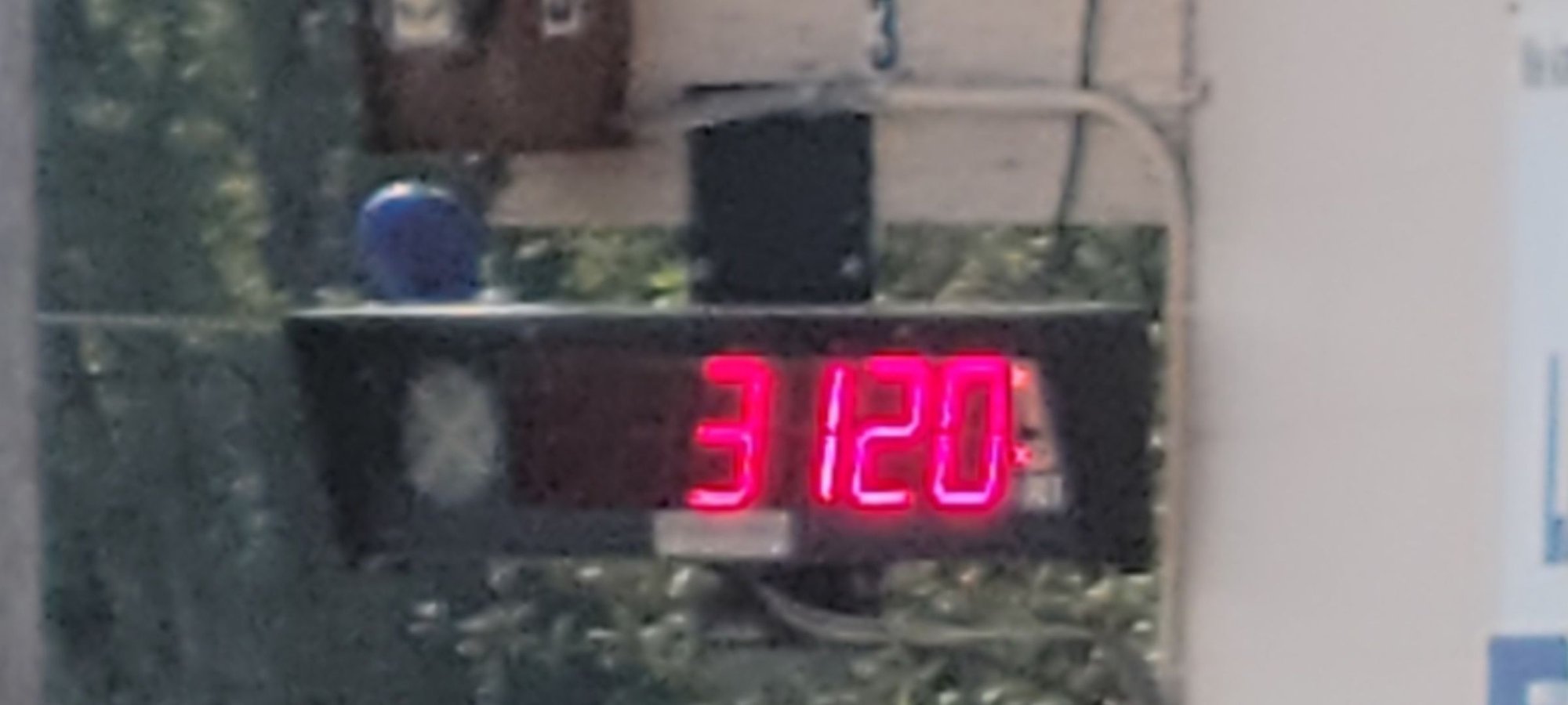

Old Jul 28, 2024 | 01:21 AM
  #204
dagwood's Avatar
Top Answer: 1
Posts: 2,678
Likes: 1,267
From: In the paint booth!
Car: 1986 Camaro Drag Car
Engine: 383 on Ethanol
Transmission: Automatic
Re: Bought a mostly strip/kinda street car. 1986 Camaro
UPDATE....
I got the win at the track the last 2 weeks in a row!

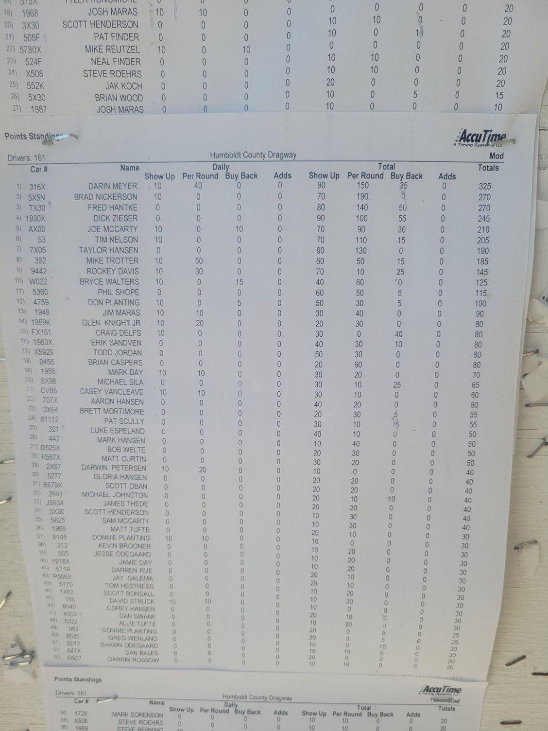

Old Aug 3, 2024 | 09:38 PM
  #219
dagwood's Avatar
Top Answer: 1
Posts: 2,678
Likes: 1,267
I just had a dream night of racing at the Humboldt County Dragway....
I got the win in Sportsman for the 3rd week in a row!!!
And I also took the win in Mod ET!!! That's my first Mod win!!
The car ran it's number all day long, and I couldn't be happier!!

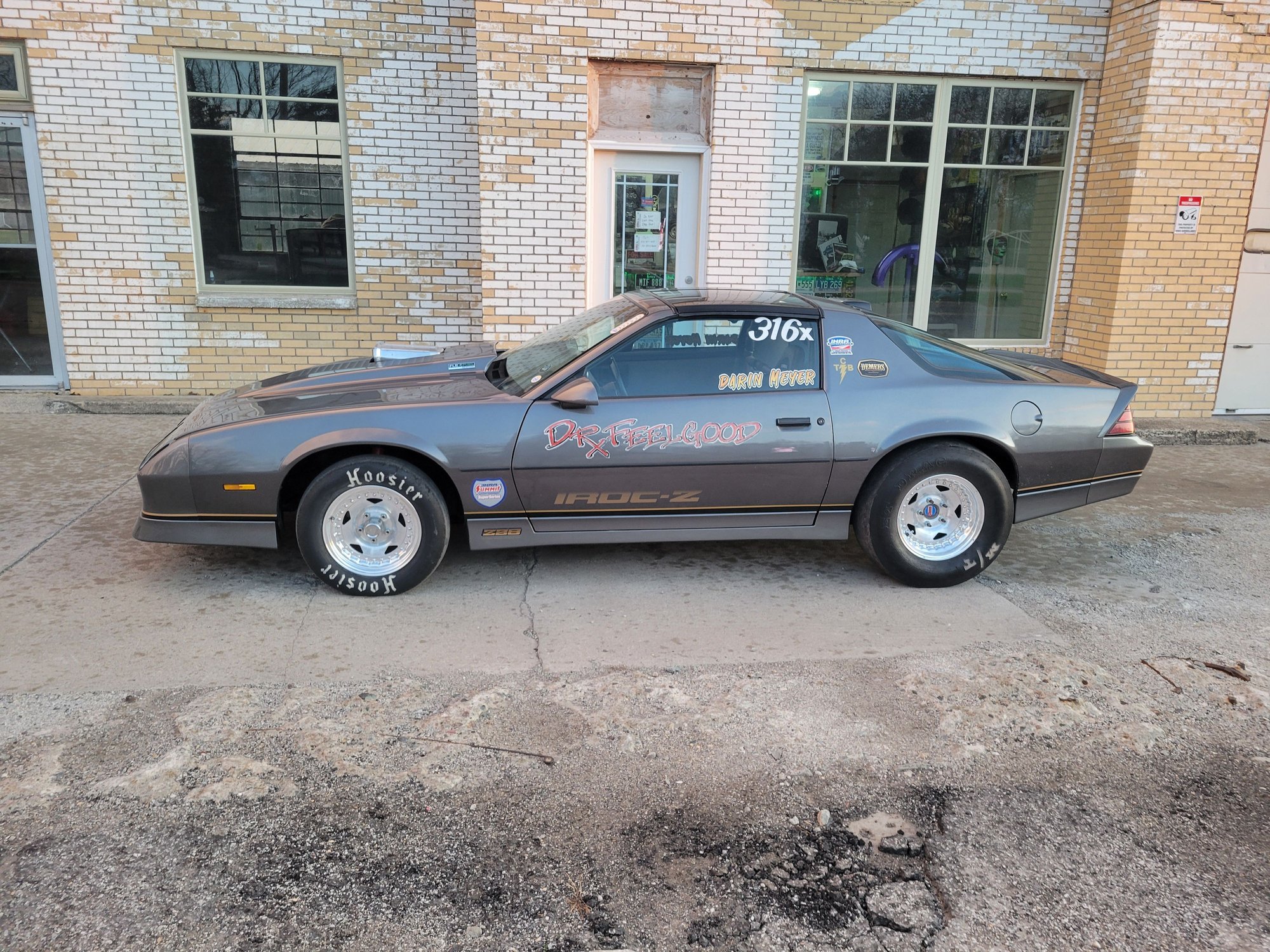

Old Apr 14, 2025 | 08:18 PM
  #224
dagwood's Avatar
Top Answer: 1
Posts: 2,678
Likes: 1,267
I finally got the correct Dr. Feelgood lettering for my car!
I see something more than some door art that's also new.
Care to elaborate? Yes. I'm referring to the "bug catcher" poking through the cowl.

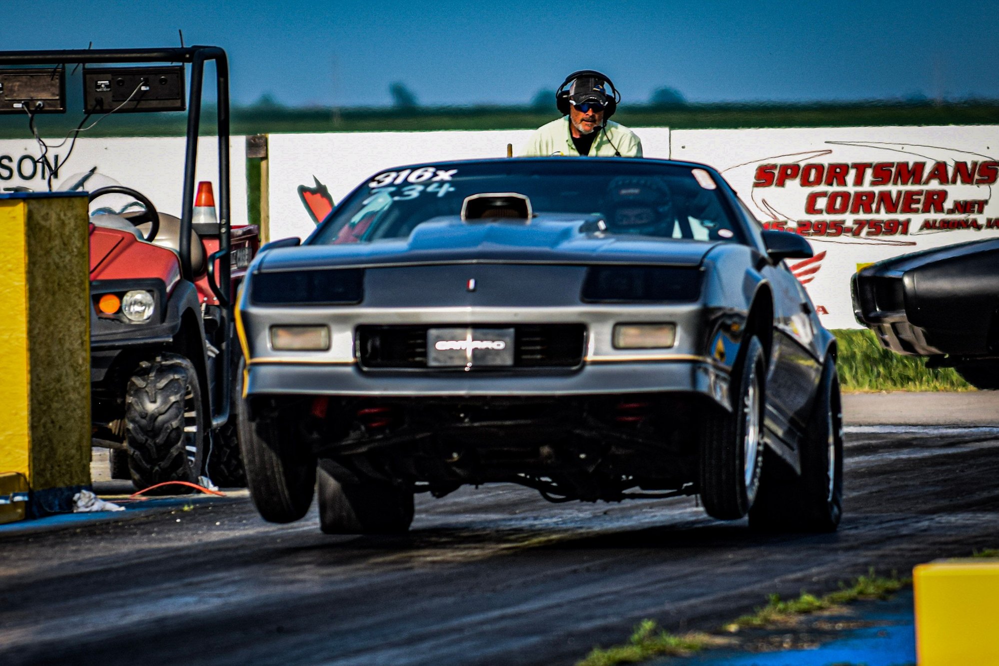

A couple launch pics from this past weekend....we had absolutely horrible air last weekend. 3,000 ft DA, 88% humidity, and maybe 70 degrees. Car was running .2 slower
Oh, and I'm sitting 2nd in points for Mod ET class at the track!

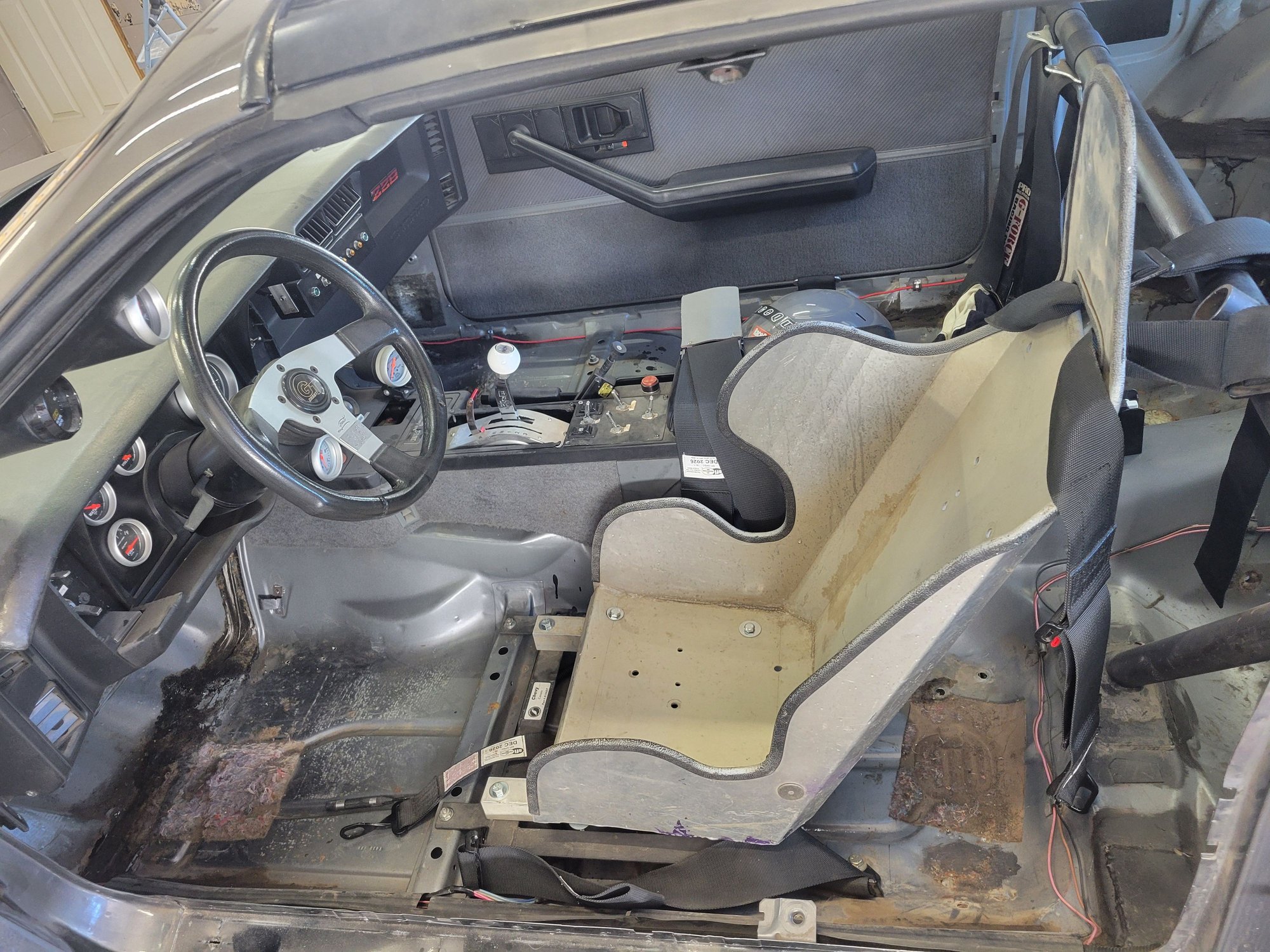

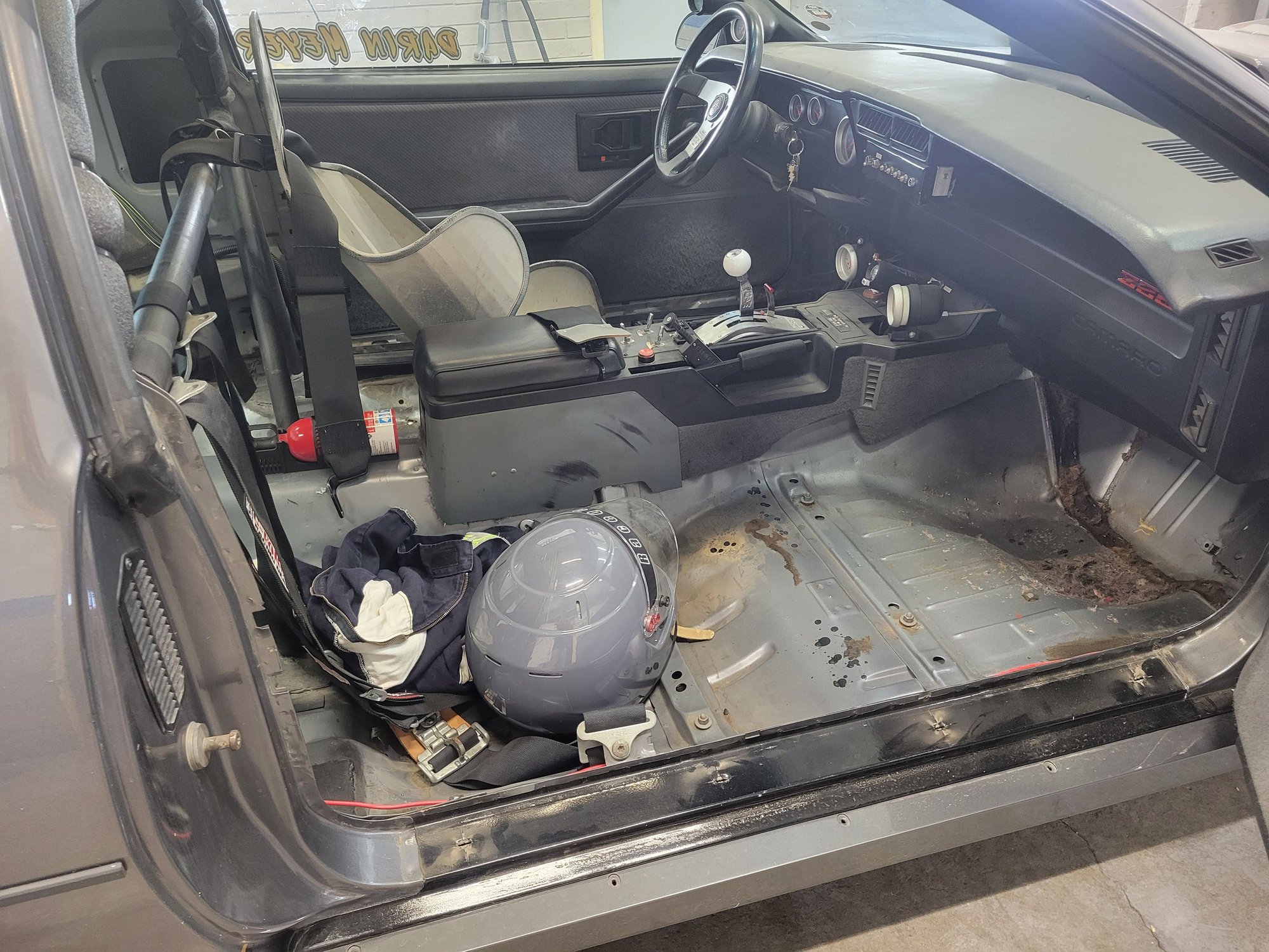

I just put the car on a diet. Gutted the interior, aluminum race seat, and removed the rear bumper reinforcement. It still has the door panels, power windows, etc. This weight is with the fuel cell completely full.

Getting under 3000 is the ticket, and as we all know, taking weight out is the same as putting hp in. The 'old-school rule of thumb' states that removing 100 pounds is worth a tenth in the quarter.

What did it weigh before the diet?
I'm curious too about how much cutting out the door bars would save.
Heres the weight before...

Almost 200 pounds. Not bad. I can feel that amount of difference in my car when there's a passenger.
Imagine being at 3600 lbs! That's my current race weight including driver (200 and change) and about 8 gallons of fuel.

Well I have a few updates since my last post. I have been leading points in Mod ET at my track for the past 6 weeks or so. I've been in the final round the last 3 races in a row, but lost all 3 times. Last Saturday I had the race won by 2 car lengths, but broke out by. 0002 seconds, even after tapping the brakes. Ugh.. Anyways, the car has set a new personal best, too... a 7.07 @ 95.79 mph. The car is gonna get in the 6's with some good air, for sure. And I also removed the hood hinges and latch stuff, and installed hood pins. Shaved another 13 pounds
Well done on all counts.
While our cars used to look the same you're far away built better as far as drag racing goes. My hope would be to break into the 7's with all the new bits. Ultimately, I'd call it a day with an 11 second timeslip. 11.99 would do it for me.
The transbrake is game changer for sure. Your 60's are envious. Soa re the wheelies!
