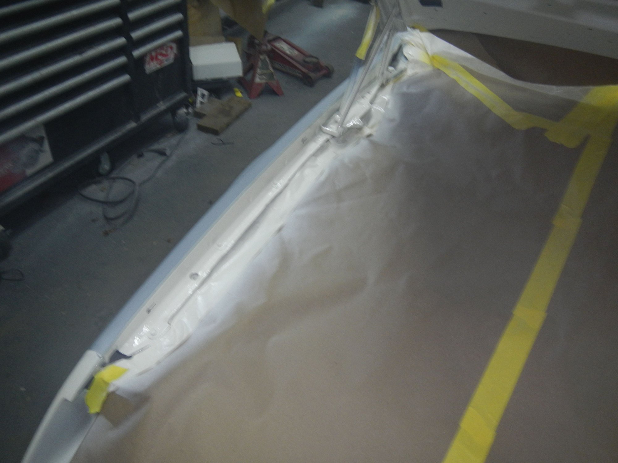

Bumper cover install.
Just setting on the studs.
I dont have any of the center brackets in yet as I need to blast and paint them but the gap between the hood and bumper will go away when I do.
Safety first.
Driver side bolted up.
Passenger side bolted up.

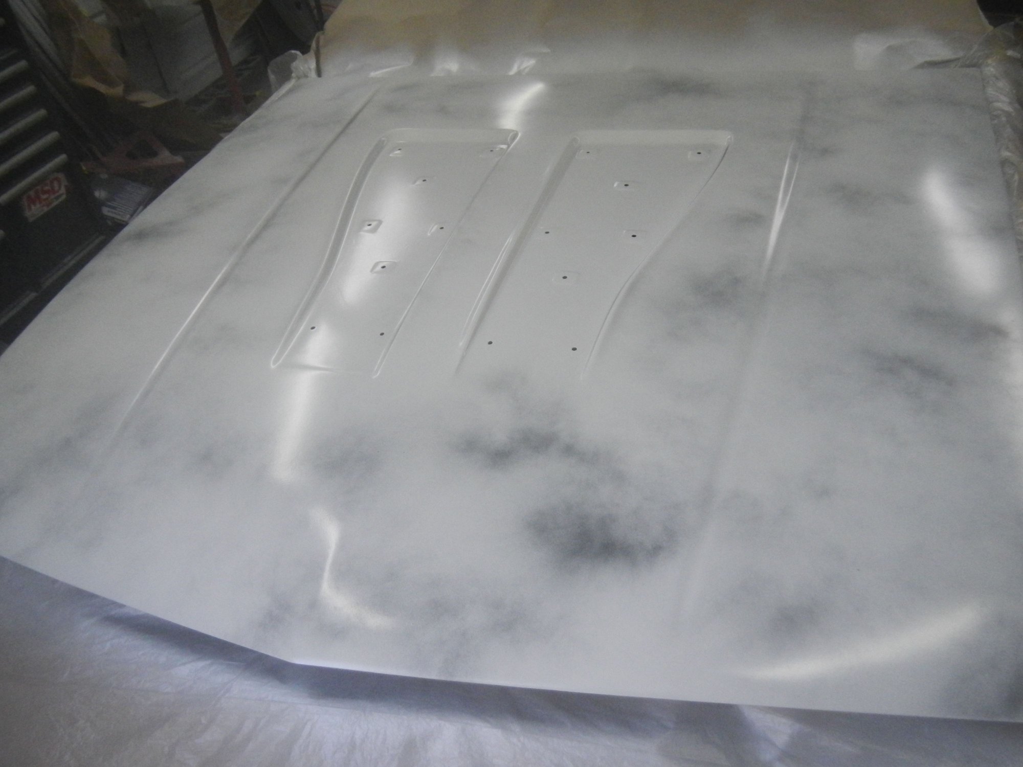

Blocked the 2 repaired spots on the hood and then sprayed the white epoxy primer on it. One day next week hope to get base back on it.
Sealed the repairs back in with a light coat of gray epoxy.
White epoxy. Not too shabby for primer.

Blocked the hood in 180 and then 320 followed by 400 wet. Plan on spraying the base on Monday.
Sprayed guide coat on it prior to blocking.

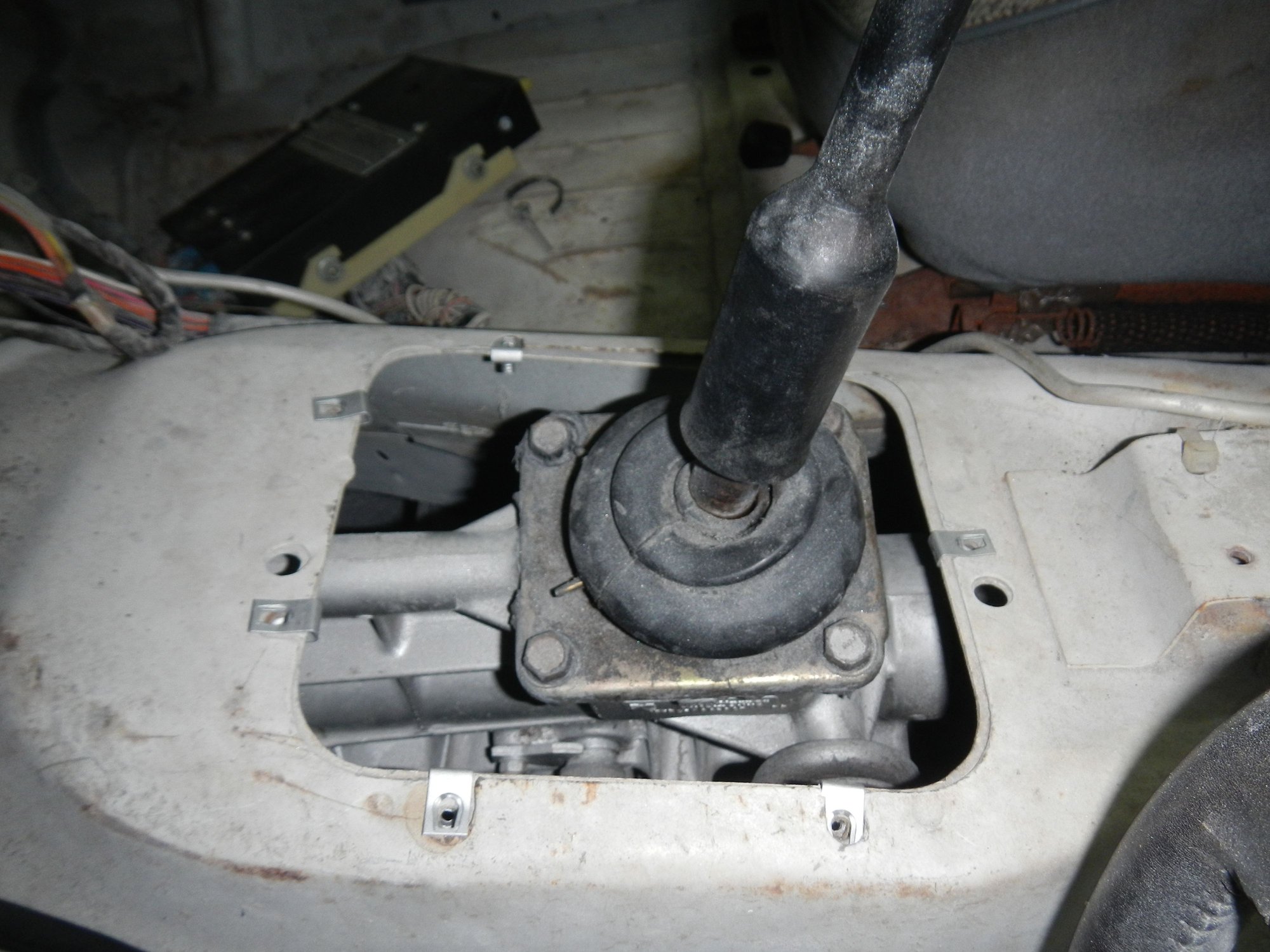

Got the new shifter boot bolted in it today. The GM parts counter book does not show a clip being used for the bolts however the bolt size it shows fell right through the threads without so I added them. There are recessed spots in the pan but both my stick cars didnt have any.
