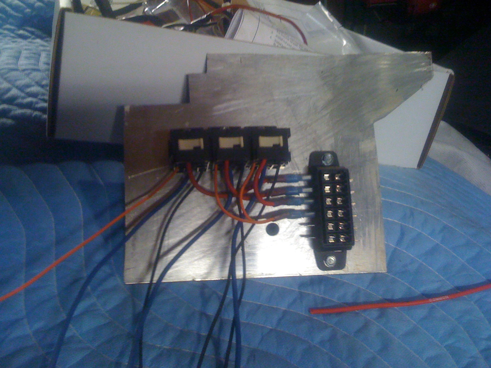

Starting on the wiring, Here's the relay and fuse box for the fans and fuel pump.

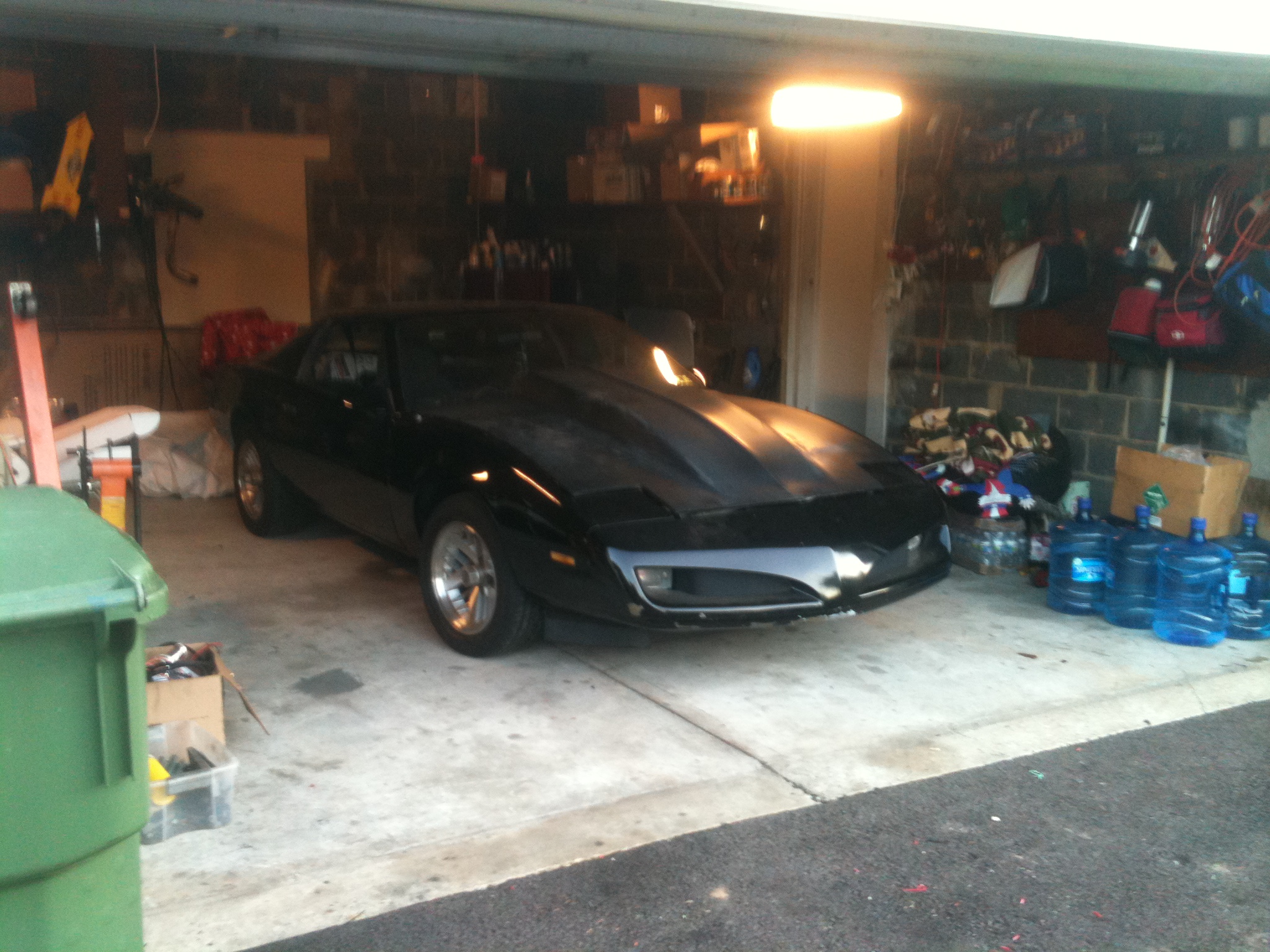

Shes still dirty.
Attached Thumbnails Glamour shot-20130215_174923.jpg   Glamour shot-20130215_175006.jpg   Glamour shot-20130215_175018.jpg

Wash wax & take more pics!!!!!! Lol

Old Mar 31, 2013 | 02:31 PM
  #50
Killert's Avatar
Joined: Nov 2008
Posts: 473
From: Norristown PA
Car: 88 Firebird.
Engine: 383 HSR
Axle/Gears: 9 Bolt, 3.27:1 Diskbrakes
Re: Glamour shot
Miniram installed. Still have to clean up some wires. Gonna lose the cowl hood soon too.
Attached Thumbnails Glamour shot-20130331_112547.jpg   Glamour shot-20130331_112541.jpg   Glamour shot-20130331_112556.jpg
