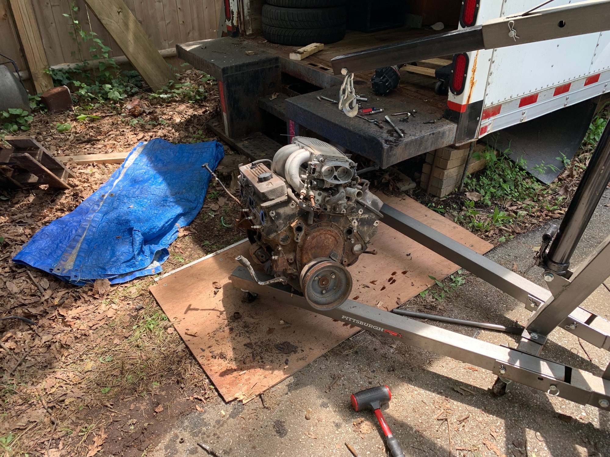

So an update for you folks.
i went to see the 1988 corvette L98 last night and it turns over very smoothly by hand and has decent compression feel by hand if that makes sense. It was very well maintained, no front or rear main leaks, no pan gasket leaks, no headgaskwt leaks, not even valve cover leaks. Minimal carbon/coking inside the valve covers it had maybe 5 year old Bosch super single electrode plugs that showed a bit rich running, the exhaust manifold and TPI plenum gaskets were also relatively new. The injector bodies are also very clean with the green stripe still.
I do believe it is a 80,000 mile motor from a wrecked car and the owner of it is a Japanese American and German car guy we clicked and hit it off. Plug wires were even relatively new and Delphi, minimal block corrosion on the outside.
the plugs read fairly well if anything it was running a hair rich. Popped the plugs back in he inspected the billet wheel turbo and is sticking the 600hp precision on his Miata he is doing a four rotor swap into. So imagine a ratty looking 600hp rotary powered Miata.
everyone is happy with the deal.
The L98 has the oil drained out of it what I found on the dipstick was dark but not bad. It was definitely using conventional oil and likely needs a flush.
now as time permits I am going to be stripping the seized motor of accessories and pieces to get it out.
Next question, how do I get this thing out since I can’t get to the flex plate bolts? Is access to bell housing bolts easy on these with a seized motor? I’d rather not drop the trans. I can paint mark the torque converter to flex plate as suggested so it goes back on proper.
Literally, never done a motor swap or anything non an automatic vehicle. Well once I did VR6 timing chains on an auto Jetta but I think we just left the converter in trans and did flex plate bolts that way.
everything I’ve done or owner has been a manual until now. Sort of excited for a traditional American auto and 250hp 350ftlb V8.

Re: Help me. Got an 89 T/A out of a backyard. Has aluminum calipers and an alum D sha
You won't be able to get to all of the torque converter bolts without being able to rotate the crank. I would leave the torque converter attached to the flexplate and separate the transmission from the motor. The torque converter just slides into the transmission input shaft. The tough part is going to be to get the motor to come far enough forward for the torque converter to clear the transmission housing and the firewall before pulling it upward. Normally you don't need to remove the front engine accessories, but in this case I would in order to give you more clearance. Take off the two aluminum accessory mount brackets, water pump and crank pulley. Hopefully that gives you enough room.
Worst case you have to take the transmission out from the bottom. It's really not all that bad to do.

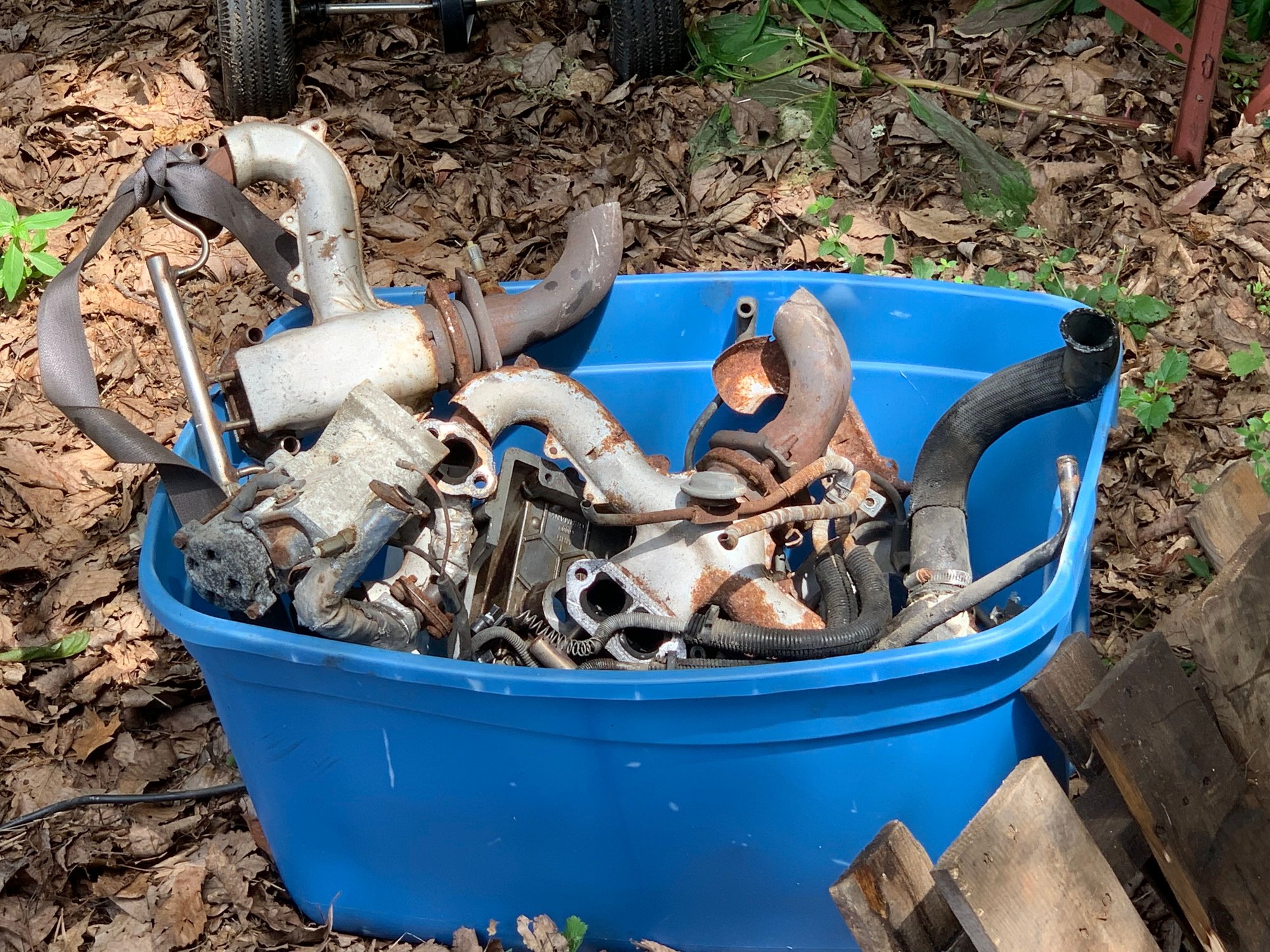

Random 80,000 mile corvette L98 from a 1988 C4

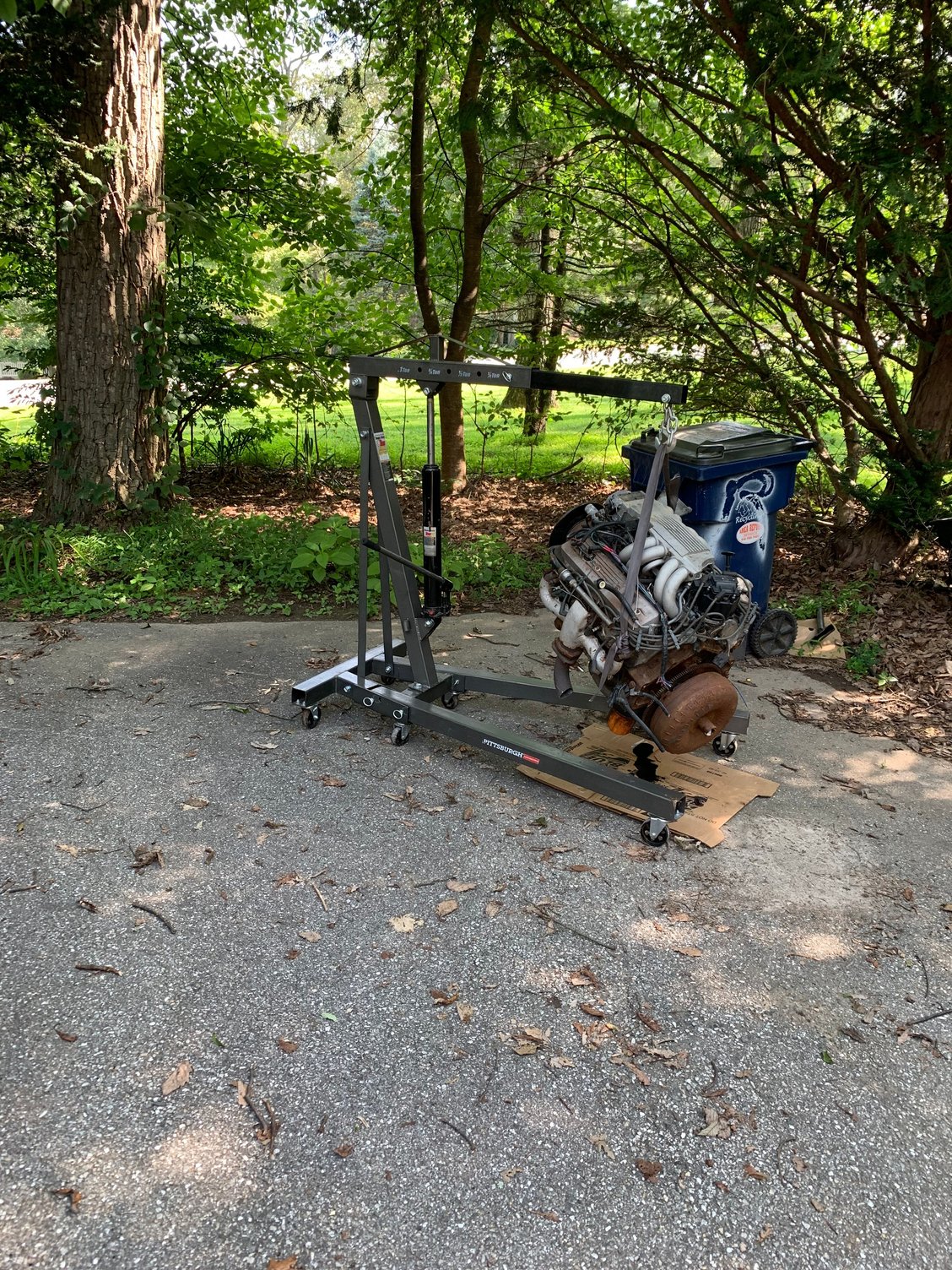

This 350 is heavy and hanging by a seatbelt. The wood under the lift is thick. All the crusty accessories and C4 intake must come off anyways. So before I try to fight getting it into this trailer I’m stripping it to the heads and block.
has nice carbon buildup in ports. Turns over very nice by hand.
Seatbelt support to accessory bracket and drivers manifold. Yeah that’s going away.
Stripping
Work spot
Pretty stripped
I pulled a ton of weight off this motor. More to go.

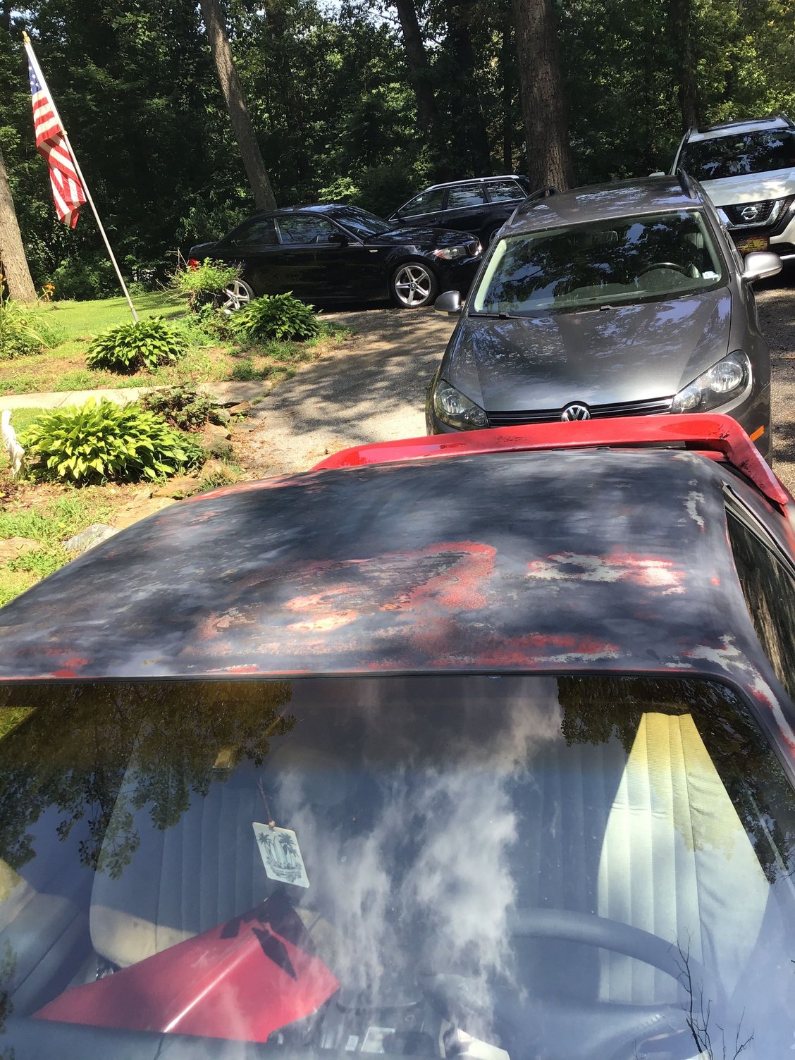

So I steel wool scrubbed and soaked the roof with paper towels coated in evaporust. Got the sailpanel to quarter transition and deck lid. May as well be less ugly even if ugly.
while im waiting for other things I remembered I had a small bottle of evaporust and said why not. It’s leaving quickly. Next nice day I’m taking it to bare metal and masking it off then using spraymax catalyze two part epoxy primer on the roof sail panels and then the rear quarters.
night and day difference the black rattle can crap is coming off too. At least two part epoxy primer will properly seal the steel once clean. May be a good while before paint. Piece by piece bit by bit.
front fenders coming off to go to bare metal and hit with epoxy later this month too. Have a new fuel tank coming but may soak old tank in evaporust and pump pure evaporust through lines. Not sure may get all new stainless lines for sanity sake. Have a brand new sending unit too so it will have a new uncontaminated fuel system for the vette L98 and fresh injectors. Basic basics.
