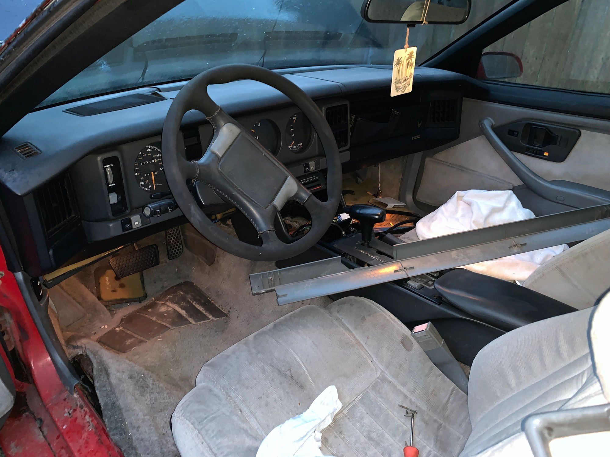

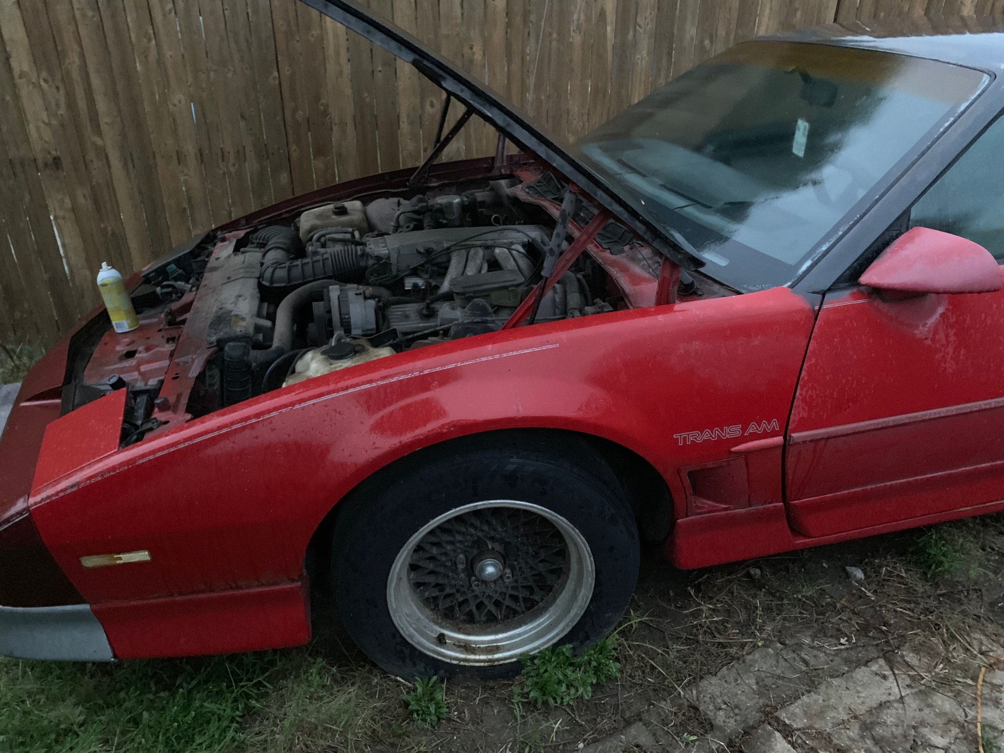

Here are pics of this abandoned neglected beast. It’s in **** poor shape with lots of wiring hacks and surprisingly only a small floorboard hope with minor surface underneath. Bolts for every suspension component look untouched. Anti roll bars are massive.
be patient with me, this is my first third gen.
Rusted primer roof
Haggard bird
Maroon nose from cosmetic accident
Maroon passenger side fender
Vin 8 for L98
Wrecked interior
This hatch has tried to kill me twice
Rust primer and neglect
Original drivers fender

Looks like you have a 5.7 Trans Am. Definitely not a GTA. The headers look like Edelbrock headers. They made them for all the emissions stuff. Aluminum spare was pretty common. Aluminum driveshaft wasnt very common. You said you have rear disc brakes....should have 3.27 rear gears.

Unless the car was an export, you likely won't be able to retrieve the RPO codes from any GM dealer as the records aren't accessible. If you have the VIN, you can send it to me via PM and I'll check. Most likely it won't turn up.
You can order a copy of the factory invoice from GM Media Archive at the following link but it will not contain every single RPO code - only some of the major ones:
http://www.gmmediaarchive.com/?page=1
It would appear to be a 1989 Trans Am and if the 8th digit is 8, then it's the L98/B2L/350. Almost all options on the GTA was also available on the Trans Am. So a 30 year old car with parts that could have been replaced and the similarities, it sometimes is not a 100% guarantee without documentation. But If the driver's side fender is original, then it is a Trans Am as no GTA had the fender vent or the "Trans Am" sticker. It also has the non-ultima seats to further suggest a Trans Am and not GTA as GTAs all had the ultima seats.
According to Robert Casey's book there was approximately 613 1989 Trans Ams with the L98. The aluminum drive shaft was not too uncommon. Many ThirdGens received it. 305 or 350.

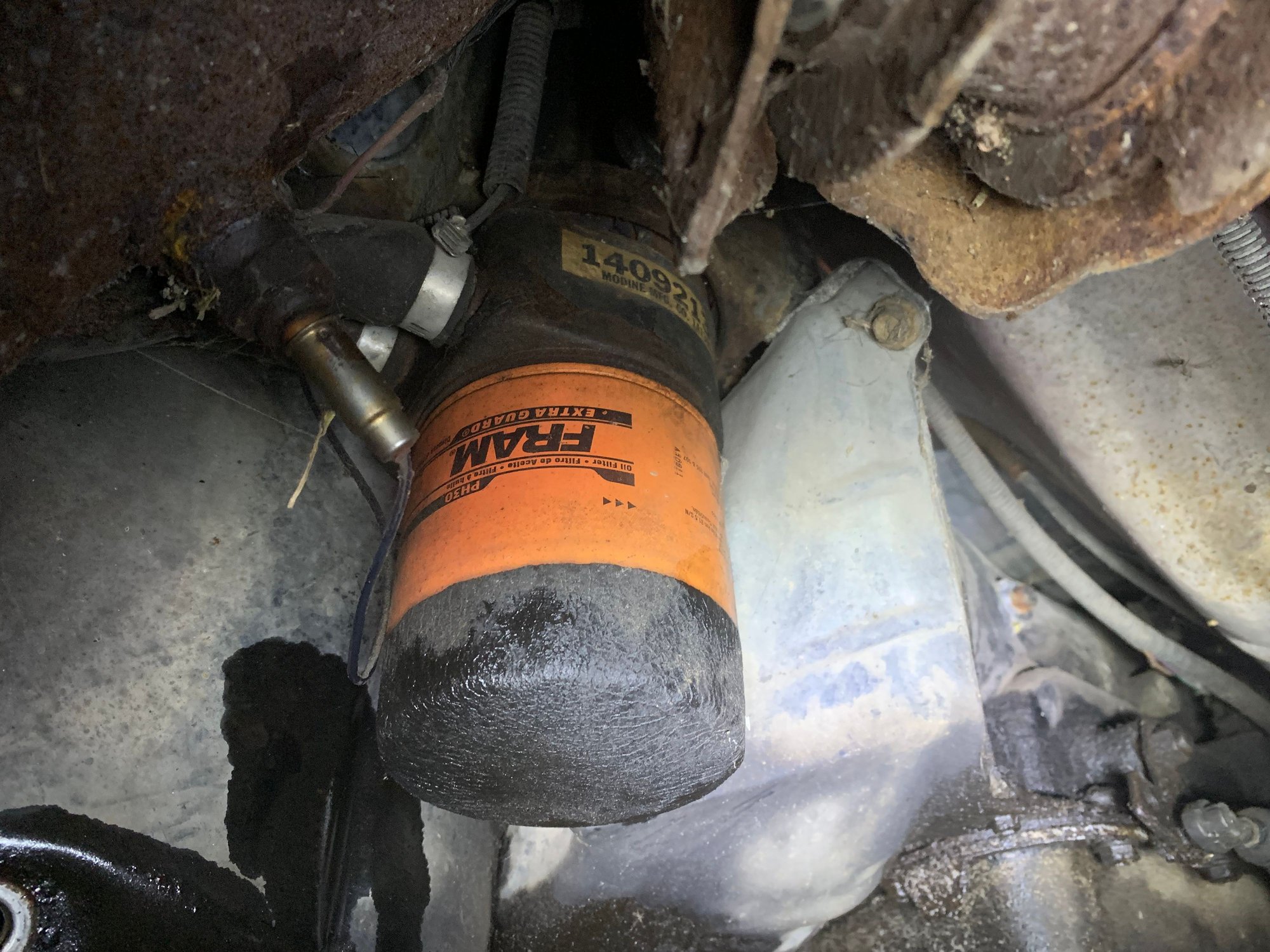

Once the gas tank and fuel pump issues are sorted, put a gallon or 2 of gasoline in it, and a gallon of lacquer thinner (acetone or methyl ethyl ketone also work well).
Change the oil filter and add a quart of auto trans fluid to the oil before starting it. Let it run long enough for the motor to get to full temp if possible, shut it down. Let it sit for a couple of days. Start it up again and let it get warm again. Change the oil & filter. The ATF will dissolve a good bit of the crud in the crankcase and free things up. Use 10W-30 oil not 10W-40; just regular stuff, nothing special like moly or any of that, except maybe use Mobil1. Doing this will also fill the entire fuel system with the solvent and flush it out; much of the crud will go to the tank, but of course some will inevitably end up in the injectors. Take them off after this and send them out for cleaning & flow-matching, or replace them. Stock, they are 22 lb/hr; can't recall exactly how many cc/min that is if the ones you have access to are measured that way, but if memory serves, the conversion is somewhere near about 10.25:1, so that should be around 225 cc/min. You could even put in Bosch light blue top 24 lb/hr (250 cc/min or so) ones, although they might be a different enough height to need some adapting; with the headers it may benefit from the slight bit of additional fuel.

Drained the gas and oil in crankcase. Tons of it probably 9quarts. Lovely.
More soon.
Factory oil cooler and heat exchanger.
