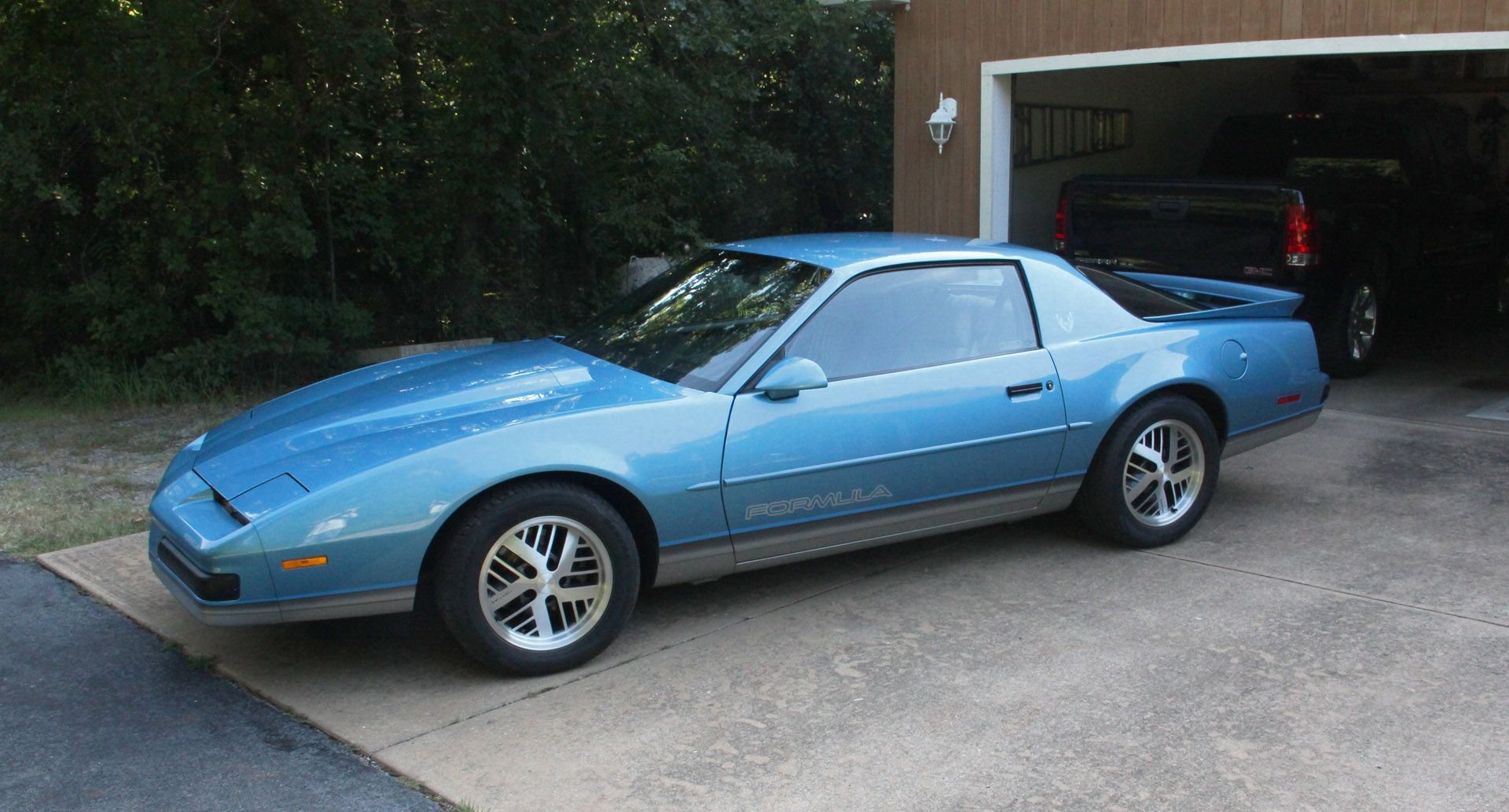

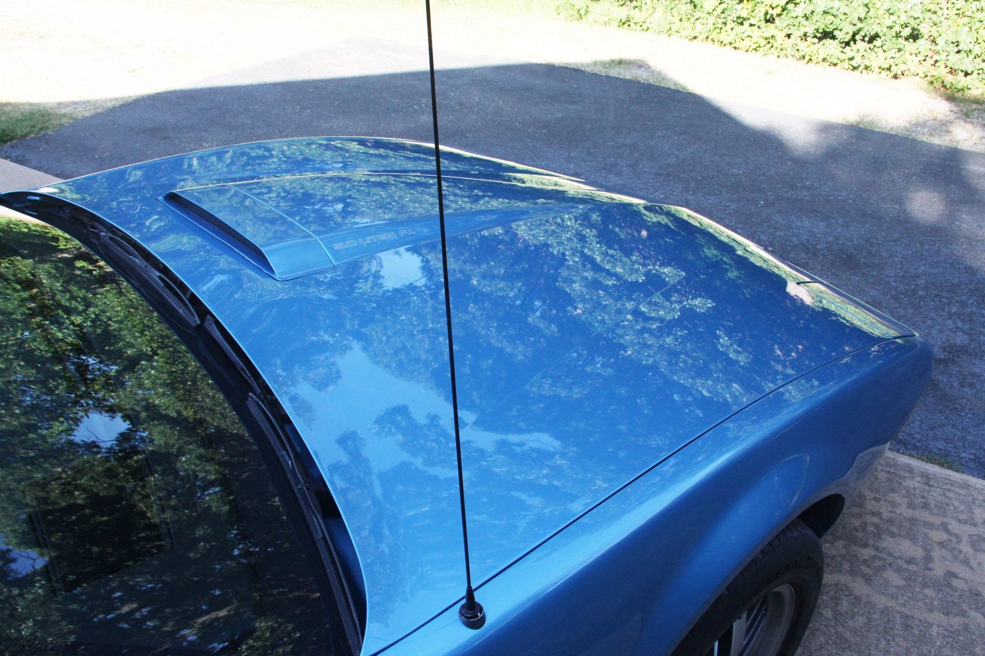

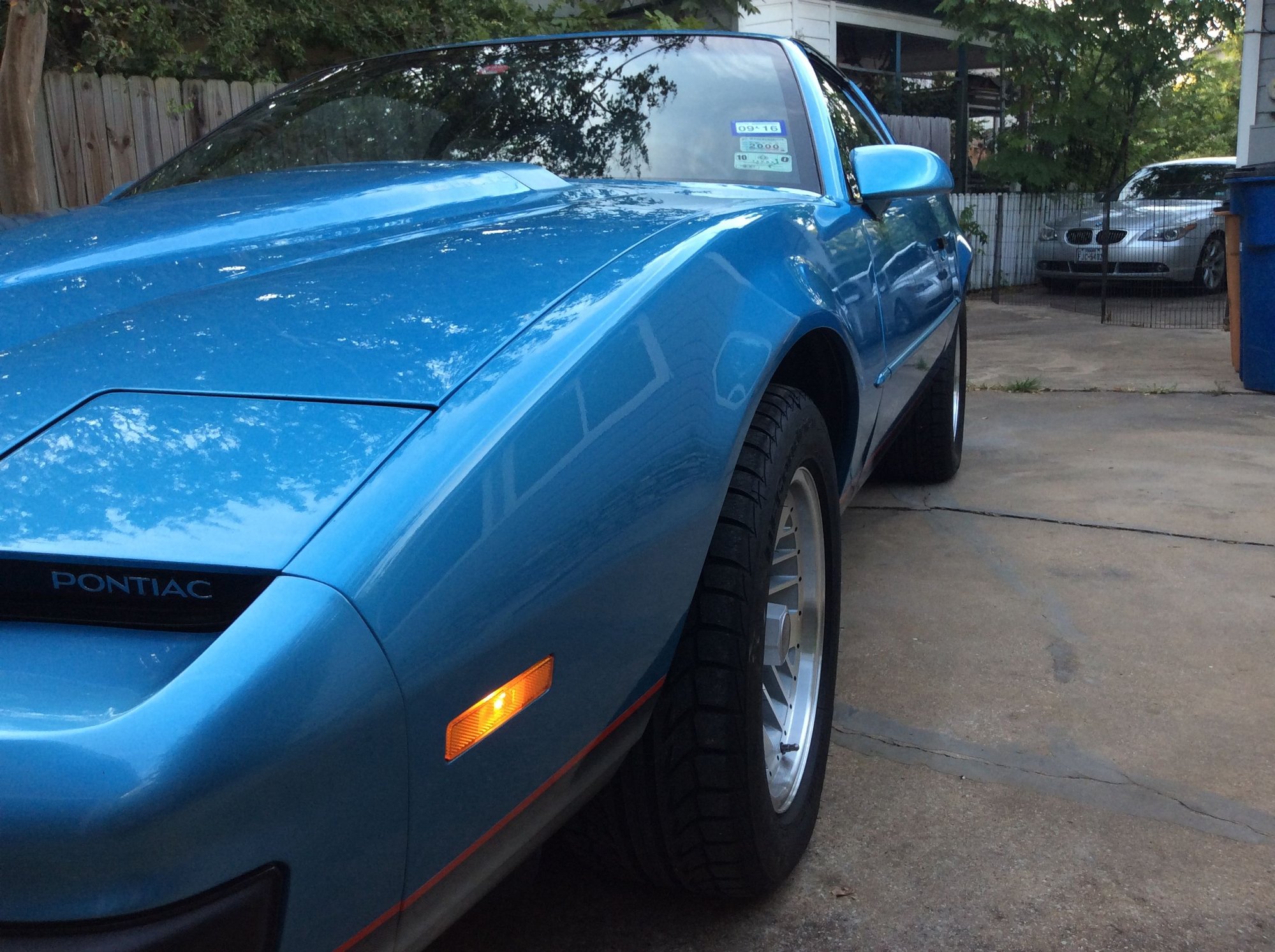

after 25 years finally getting around to take care of the paint. this photo turned out pretty cool. looks like i’m somewhere else besides my driveway. wild.

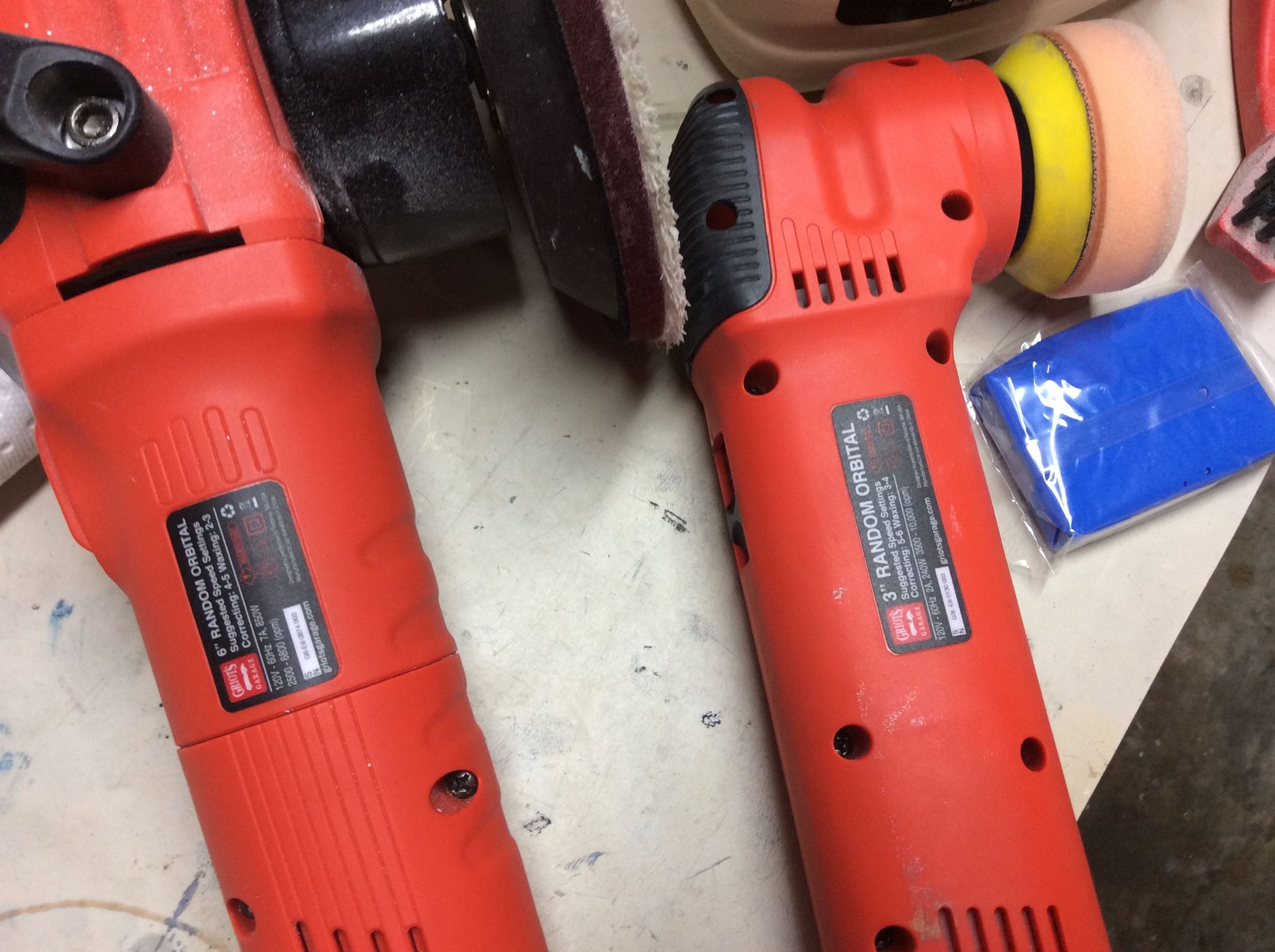

i’m referring to compound, polish, wax. i practice on a few other cars before touching the paint on this one. got a few items to make it happen. cheaper in the long run and you don’t have to let some one else drive your car
Reply 0
Aug 7, 2019 | 02:37 PM
Re: LB Paint correction underway
here is all you need. i forgot to mention clay bar first and final finish with a hand polish of your choice

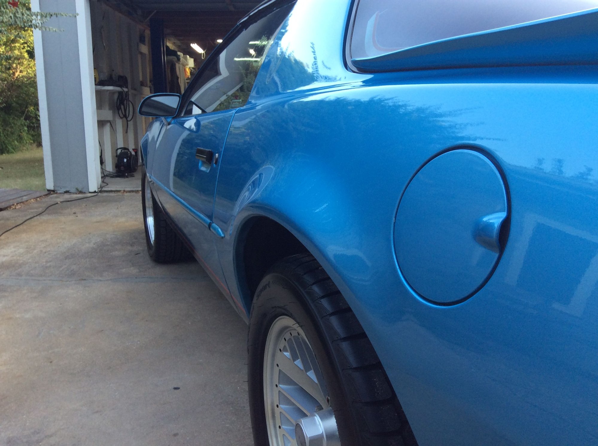

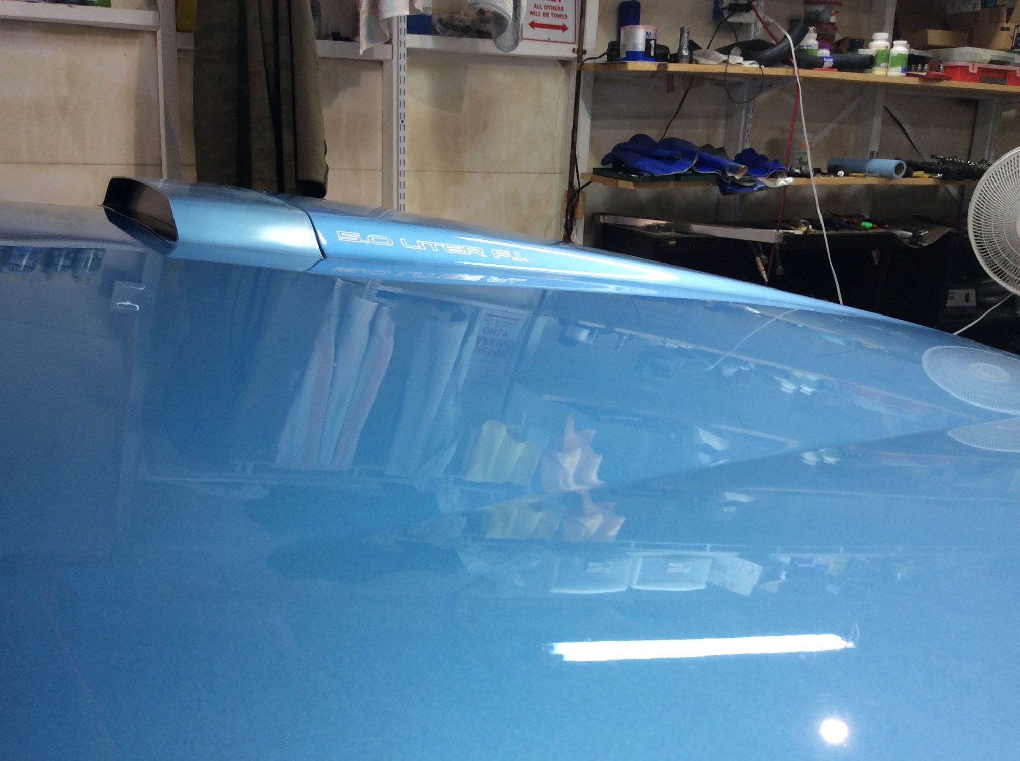

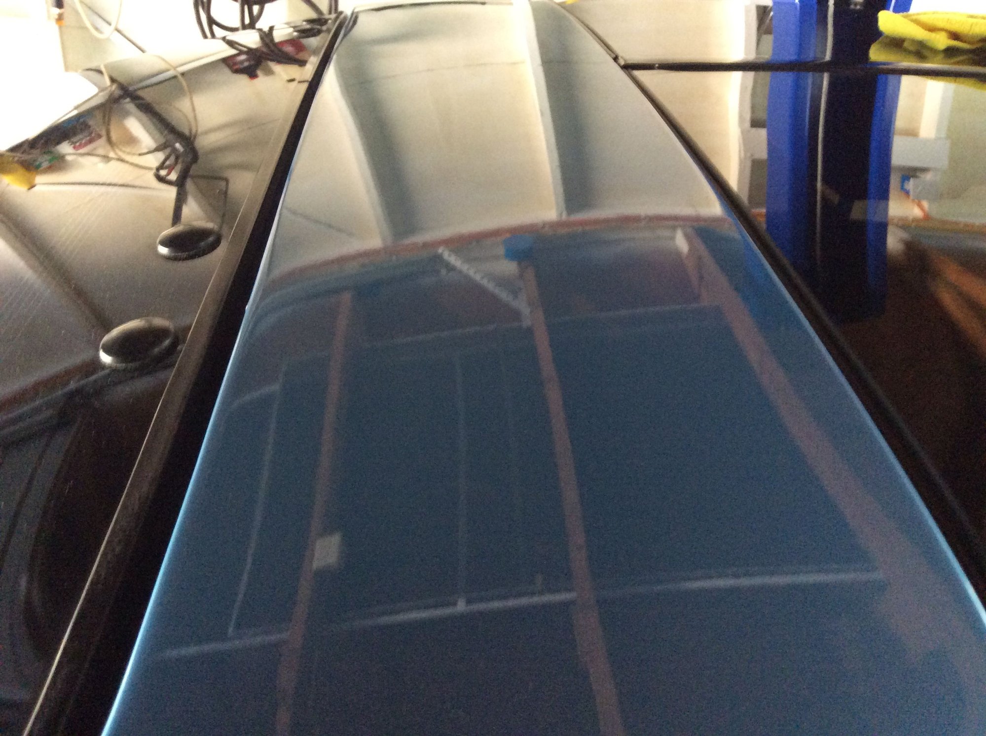

i’m just starting polish phase. here are a few shots
Reply 0
Aug 7, 2019 | 02:42 PM
it’s exhausting but rewarding

Well, you definitey need time, but you can easily acquire the skill just by reading up at a website. These type of buffers make it very hard to screw up. Also great for working on your other cars and you'll need the equipment to maintain it in the future.

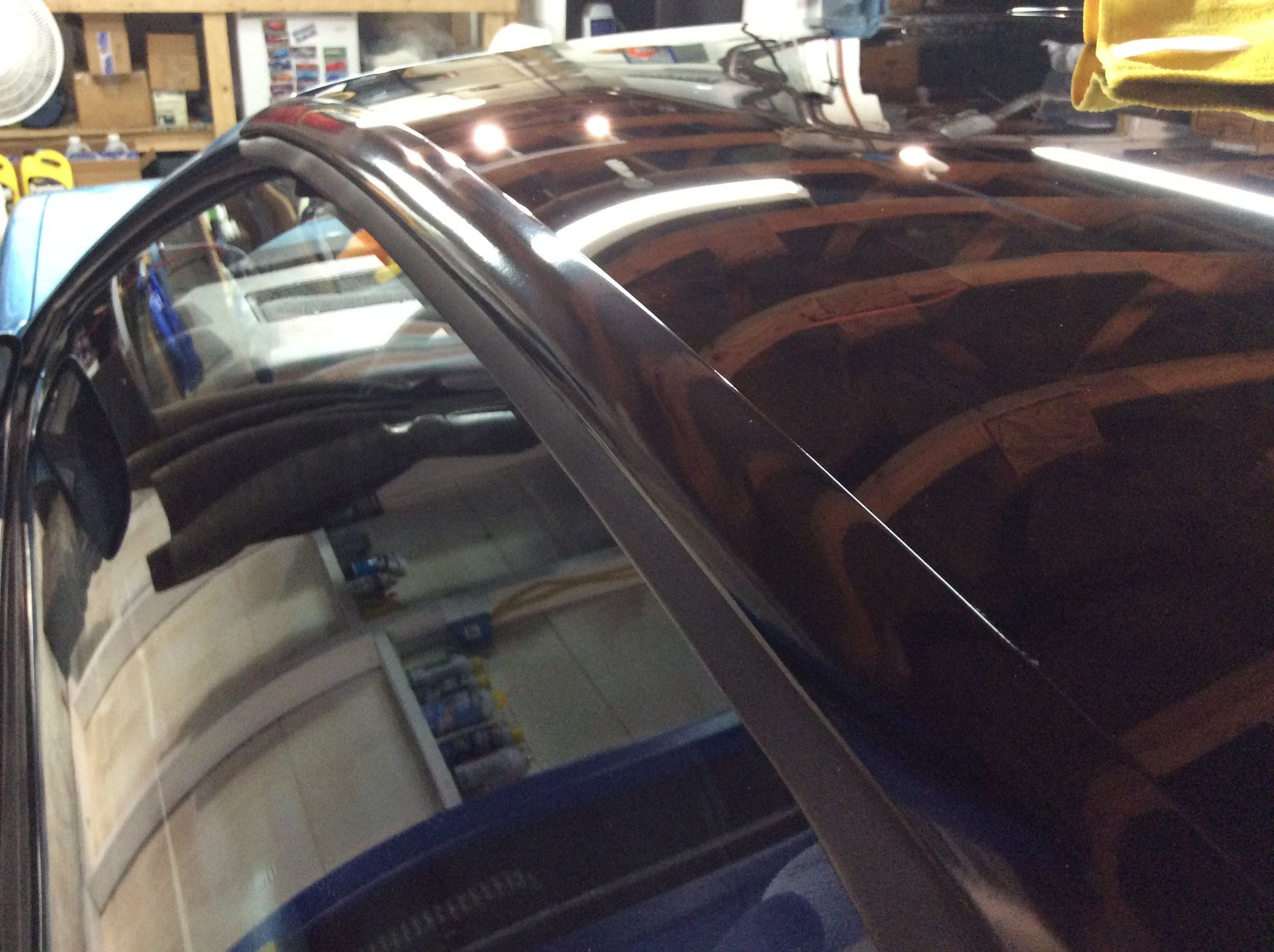

coming along, may need to take a break and do something else. this is tiring!

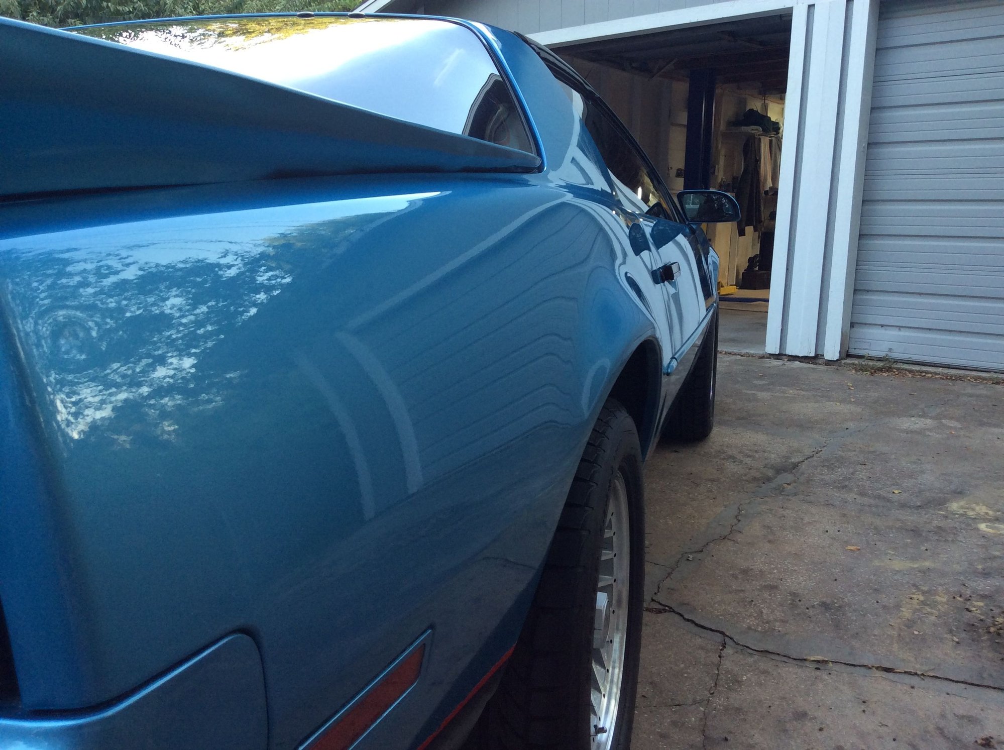

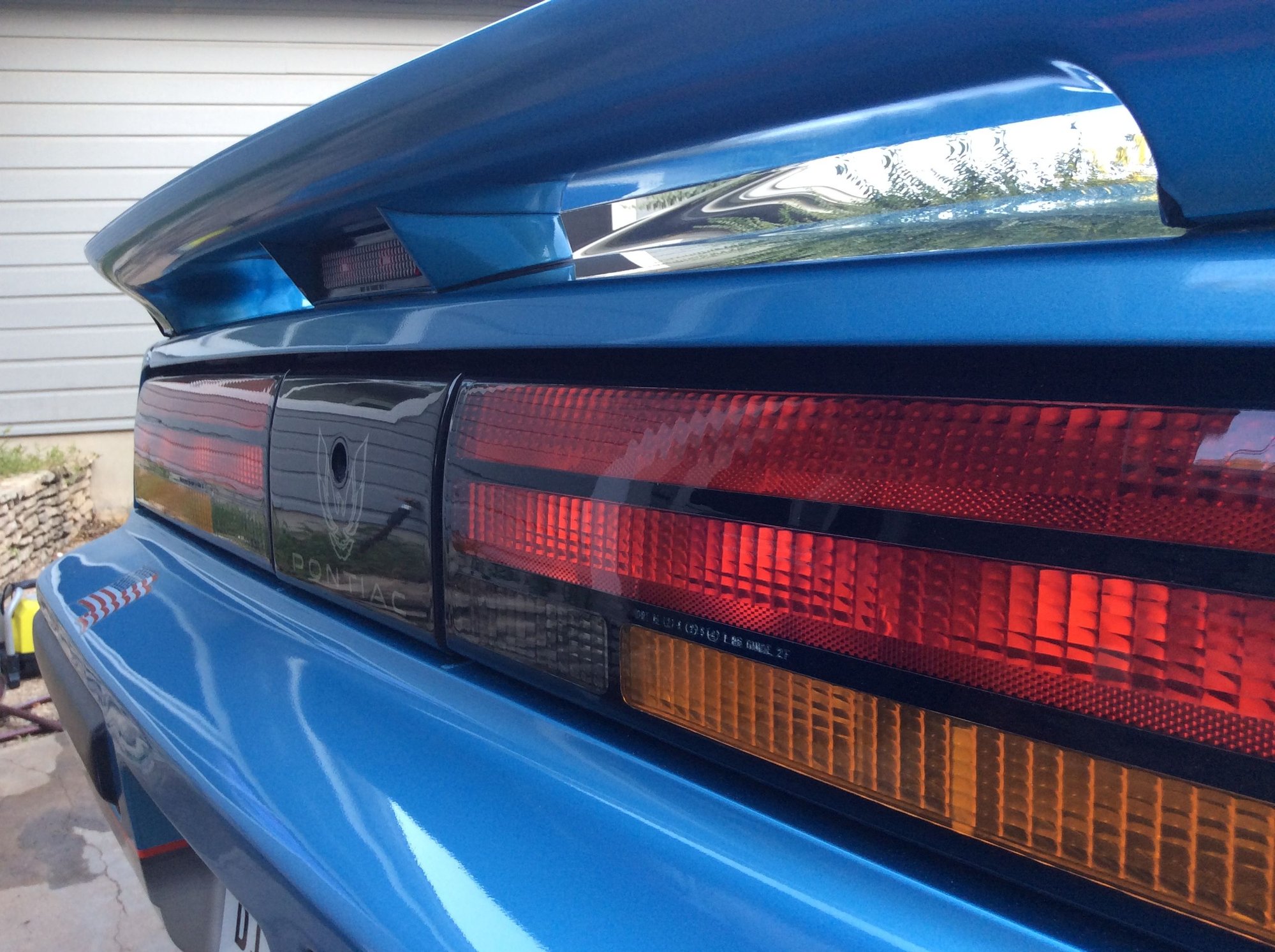

paste wax on, still plenty more to go. 30 years of dirt accumulating. removing all of it a tough job!

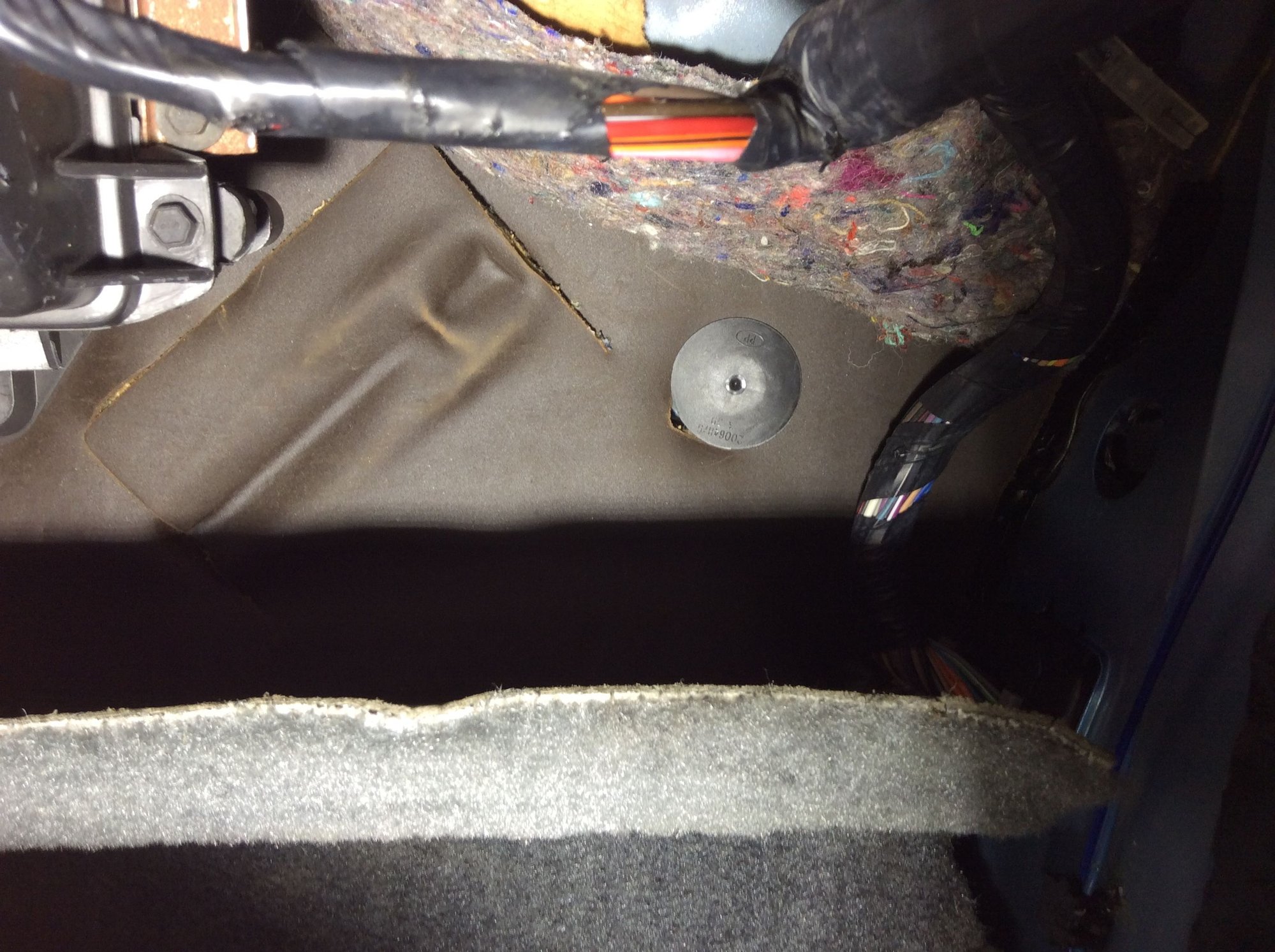

amazing what you can get done one panel a day. btw - i’m fixing electric antenna and saw your old post talking with same guy who did yours. noticed you had asked what this is for if i recall correctly.
Reply 0
Aug 13, 2019 | 10:12 PM
Yes, I asked, and never got an answer! You know they put it there for some reason. But darned if I know what it is.
Glad to hear Barney is still doing those repairs. Mine is still working smoothly.
Yeah, tonight was Woodward again, after getting the grass mowed. Tomorrow is LOF for the van, then Woodward. Thursday I will finish the van and car hauler, then I'm on the road. Next week is all the prep time I will have, and then it's off to Dayton on Thursday night. So I'm just out of time. I will have several weeks until the next show, so maybe...
Are you doing anything to protect edges, the vents in the hood and fenders, door handles, etc.? Taping them off, or ???
Reply 0
Aug 13, 2019 | 10:26 PM
get a cordless and work it while someone else drives . i thought it holds up that tannish firewall insulation, never explored to find out for certain. went to Barney’s house today to drop off antenna. neat guy. showed me around the digs and all what he does to the antenna to rebuild it. took it apart while i was there to show the details. definitely worth the extra money if you are not on a super tight budget. hope you enjoy the nationals!

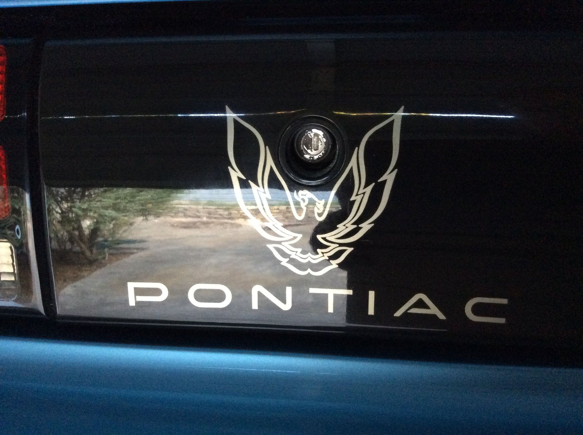

Have you tried Dr. Colorchip? That worked incredible on my Formula.
Just remember that it does not apply like traditional touch up paint. You’re not trying to fill in the chip. Rather, you’re laying down a lot more paint than you would normally use and then smoothing it over the chips (if you ever have applied spakle its a similar process) with the squeegee. You then go back over it with the removing solution and buff away everything but the chips.
Because you can always remove the touch up paint you can never apply too much.
Reply 0
Aug 23, 2019 | 12:02 PM
Quote: Have you tried Dr. Colorchip? That worked incredible on my Formula.
sounds incredible. their website does a good job selling too. can you see the repair at 4 feet distance with good eyes?
Reply 0
Aug 23, 2019 | 12:20 PM
Can you see the large chip on the center of the bumper in the first and second pics? The third and fourth pics are after using Dr. Colorchip.
