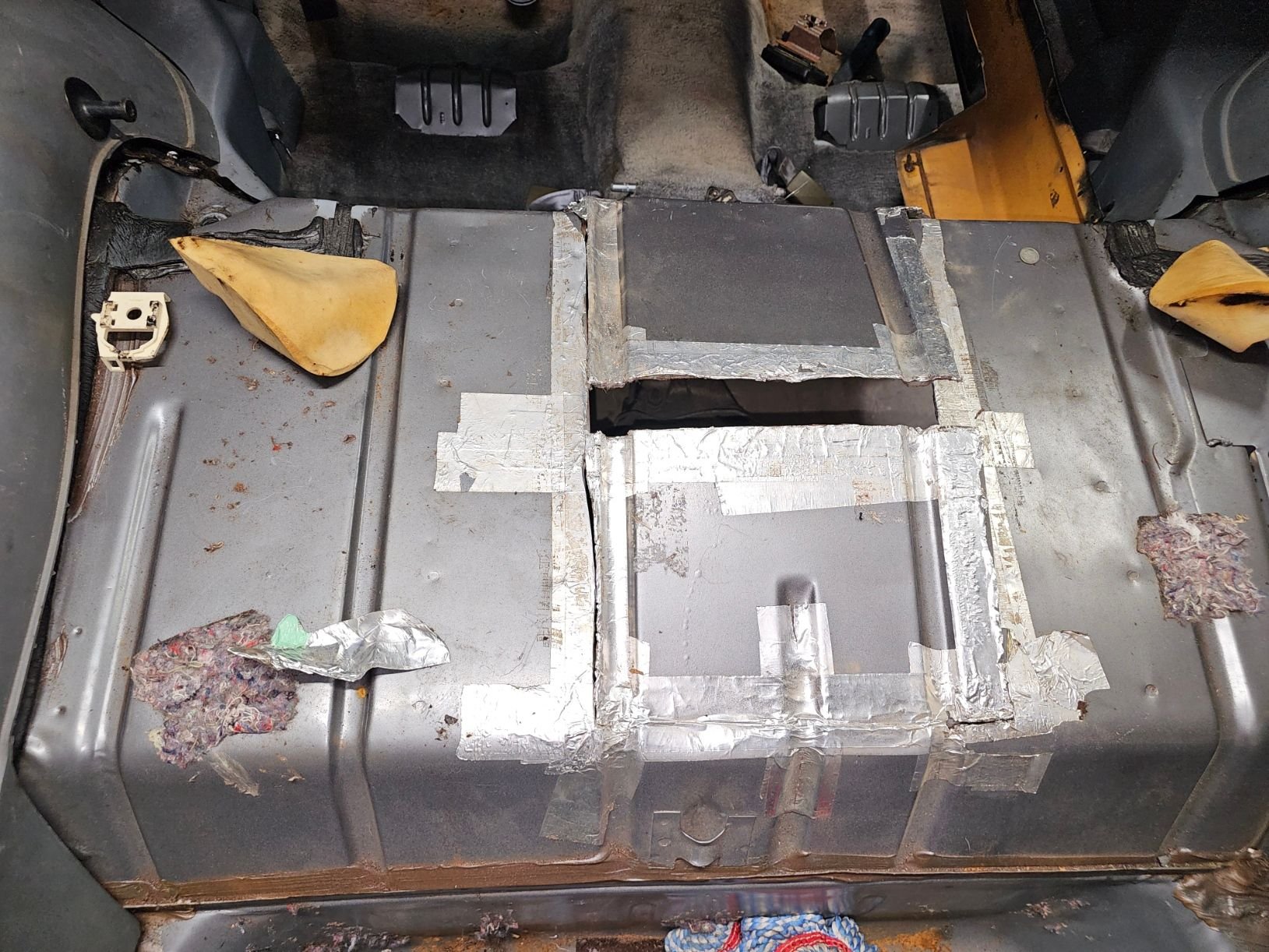

First things first, trying to get this thing started. When I turn the key on, no fuel pump prime... SO I pulled the carpet to CHECK for a fuel pump trap door and low and behold... there was. Behold one of the worst trap doors I have ever seen. Cut with a die grinder, and tapped back together with HVAC tape. So I dropped the tank and welded everything back together. I should Clarify here, I am NOT a fabricator, nor a welder. This was a very tough project for me. The gaps were very large, and I had to bridge the entire panel back together. the sheet metal was paper thin and I kept blowing holes through it. I eventually got my settings figured out and got it back together. The welds are ugly, but the panel is strong. In my opinion, I know that its not ideal, but... It's better than a trap door in my opinion. I didn't grind the welds down, but i cleaned everything, coated in self etching primer, multiple coats of paint matched spray paint and clear coat. This entire panel will be coated in Sound deadener, so I am not worried about the weld beads being present. I know this may not be the BEST way to do this, but I'm just a diy guy making it happen.
I want to confirm here, I DID NOT cut this trap door, I'm just here trying to repair someone else's hack job.
My supervisor is present here.
You can see from this picture, the gaps range from 1/4 inch to 1/8 inch, and some sections were butted together directly.
Bridging the panel back together, one tack weld at a time. Spacing out the beads to keep the heat and warping to a minimum.
All painted. I realize that I created a hard tape line and I wasn't a fan of that but... it's getting covered in sound deadener so this was basically just to seal in the metal.

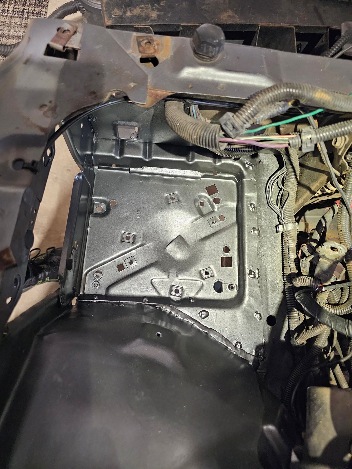

Next welding project... The typical rusted out battery tray. I found a seller on ebay selling an entire patch panel including the battery tray and the surround metal. So I drilled out all the spot welds on the old panel, trying my best not to butcher the metal that was going to remain. Again, I'm no welder and honestly don't care to grind down the plug welds, as most of them aren't visible anyways. Chances are that I won't even be using a bettery in this area, so this was a bit overkill. Battery will probably be relocated to the trunk for the sake of the project.
Old tray
Old tray
self etching primer
self etching primer
The wheel well side will be undercoated in the future. This is just the current fix so that I can move onto to other projects.
New tray looks really good.

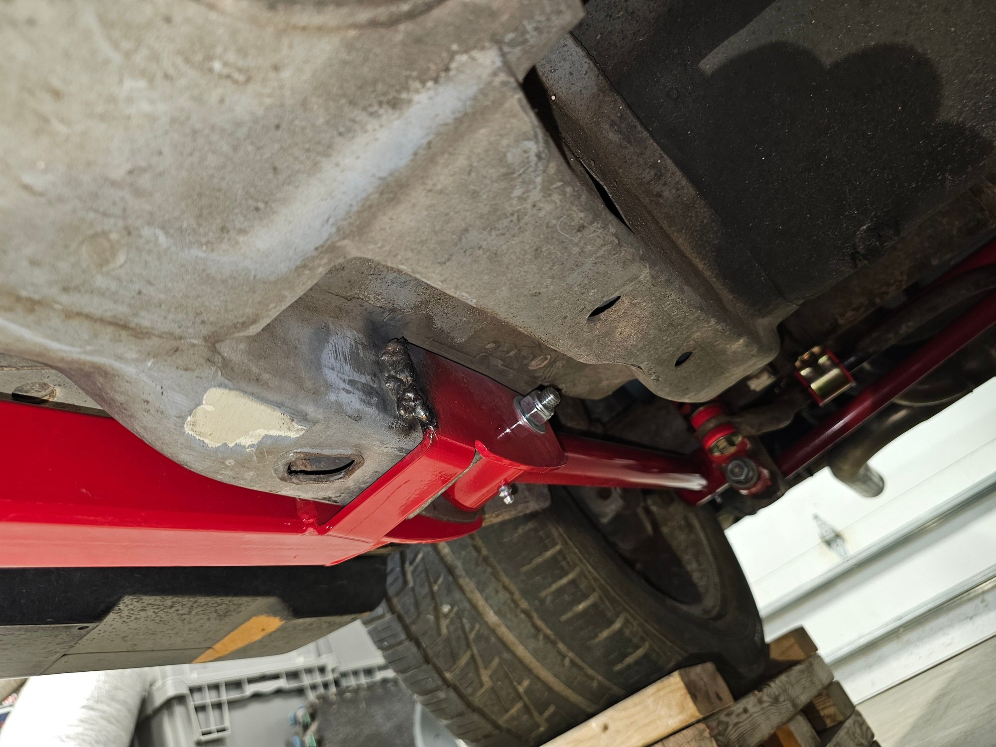

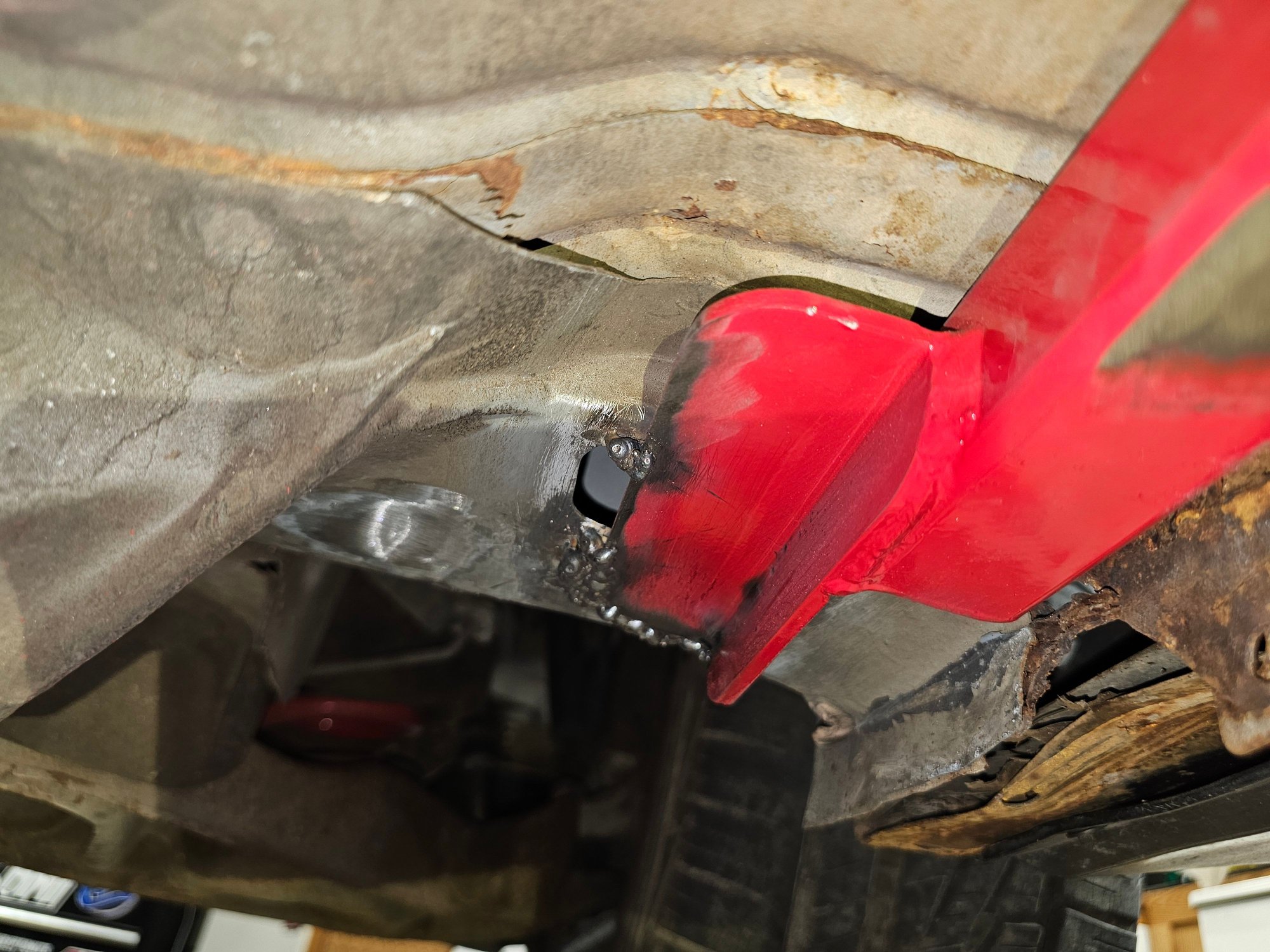

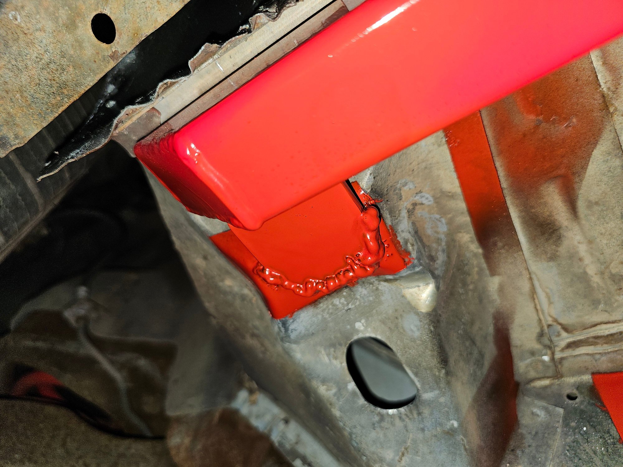

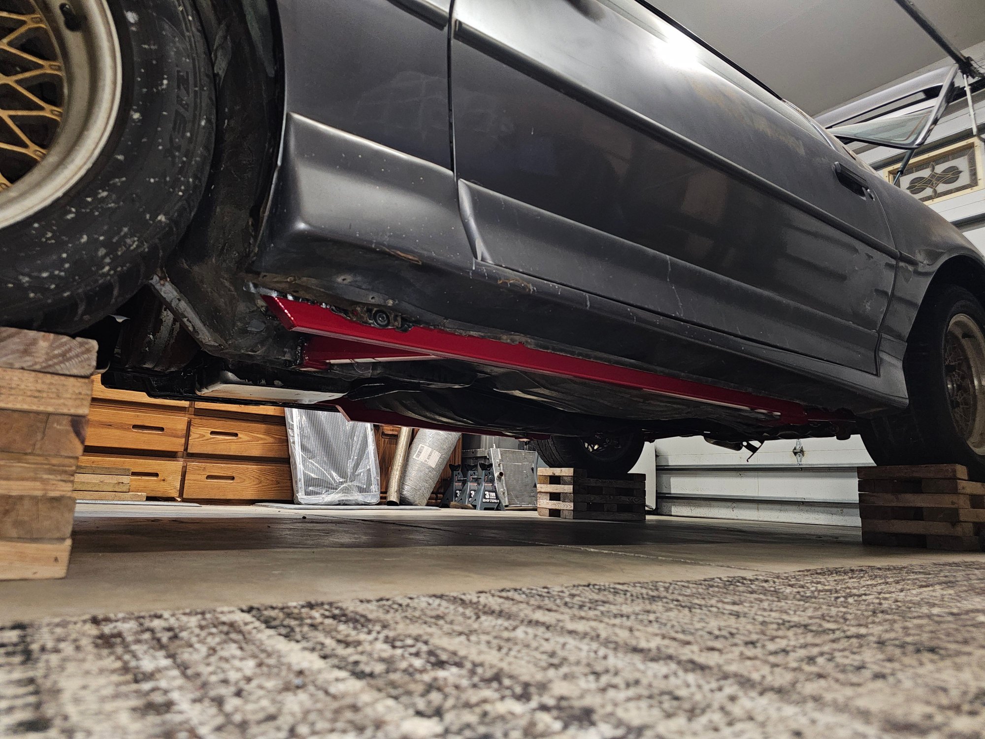

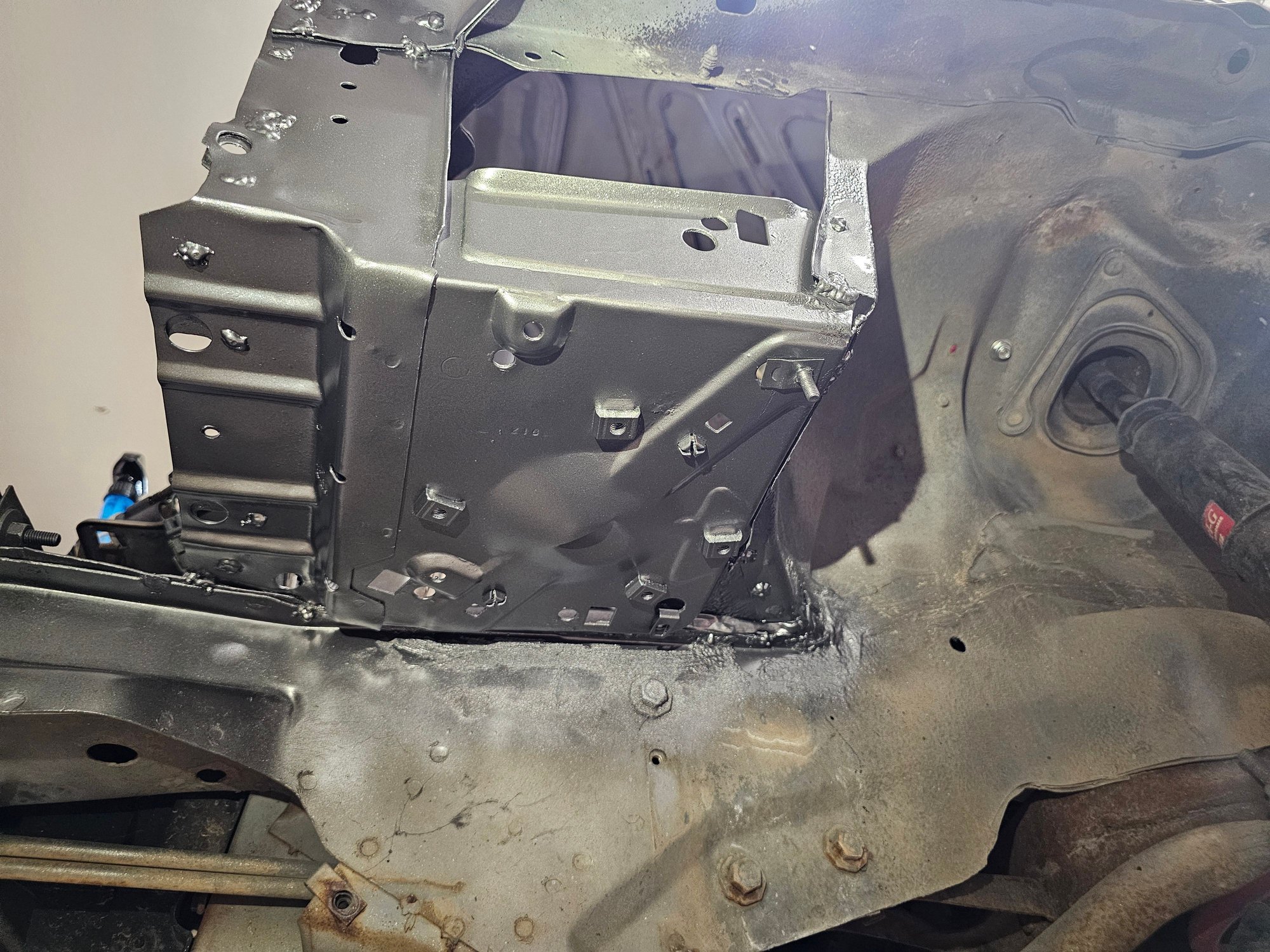

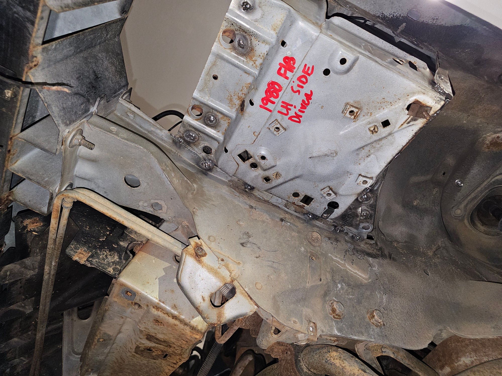

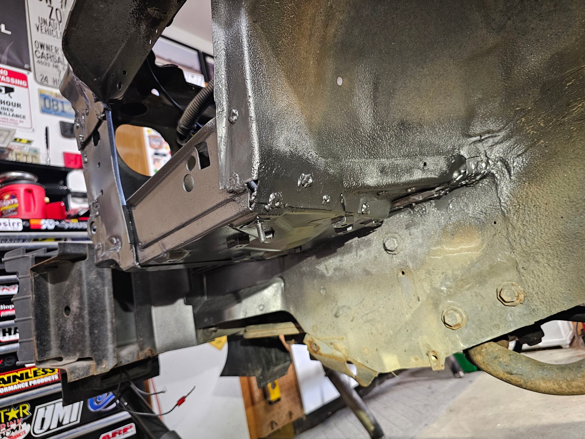

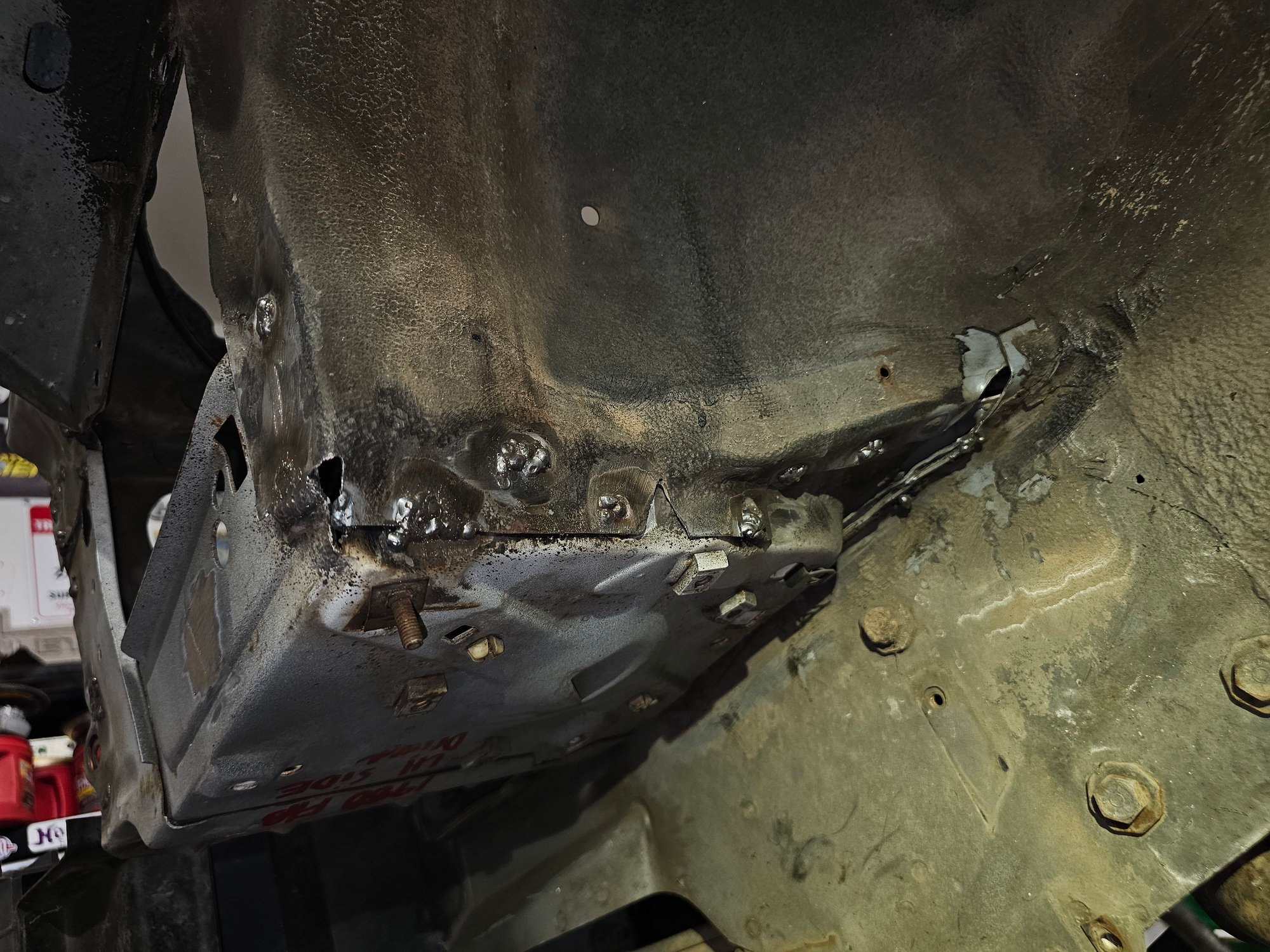

UMI Subframe connectors officially welded in. Now i just need to protect the metal and paint them, and its on to different projects. No more welding for now.
Side view of the car
Driver side inner frame connection
Driver side overall view
Passenger side
Passenger side, I opted not to use the "optional" crossmember for the passenger side, as I plan to run Dougs header and y-pipe and have heard fitment is basiclaly impossible with the little extension in place.
I welded both rear sides the same way, only took pictures of one side.

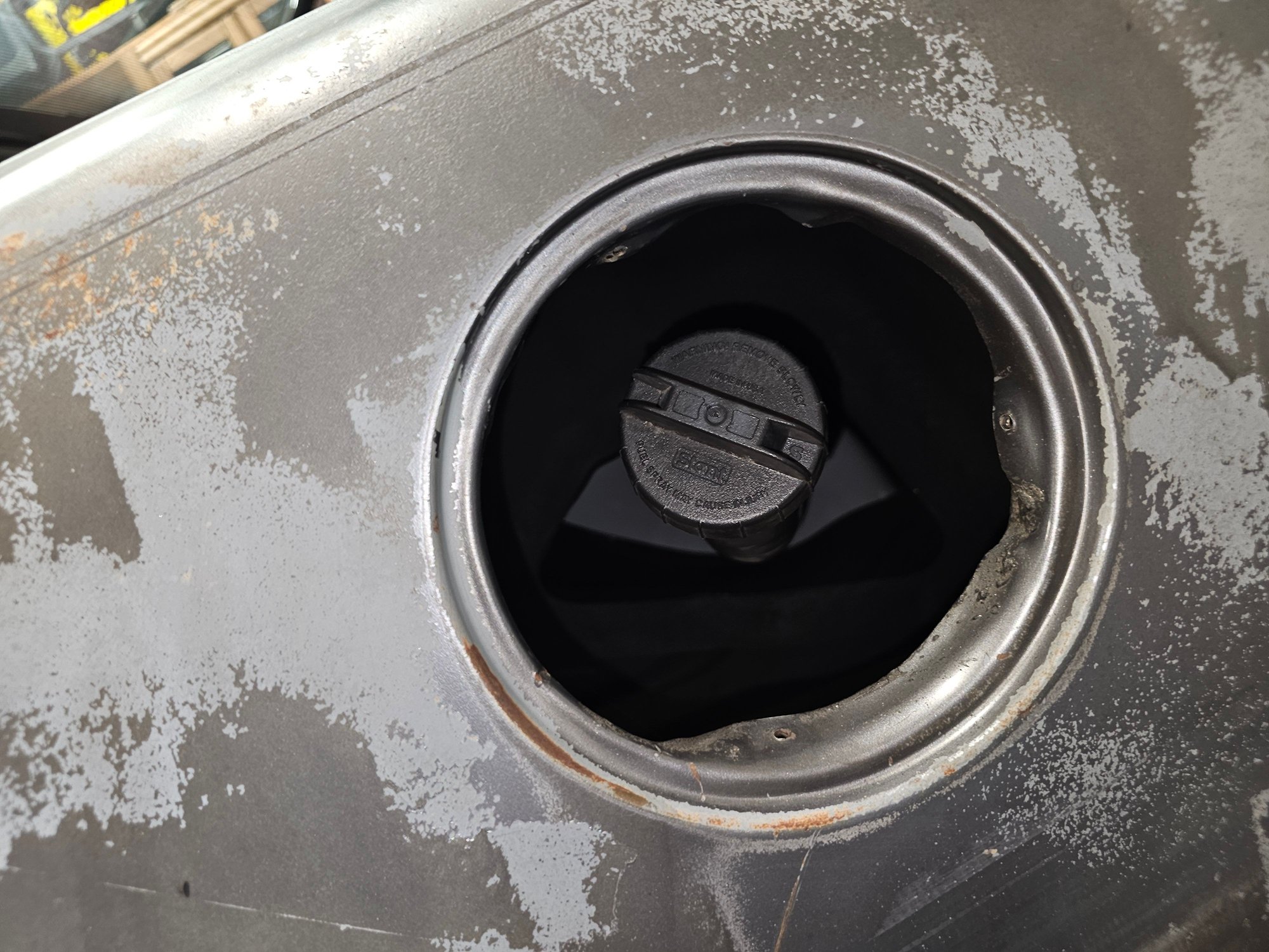

Some more progress on the build... I'm actually catching up on pictures saved in my phone.
I put undercoating on the bottom side of the fuel tank trap door repair. Bought a Jegs brand coated gas tank, and sending unit. Running a Racetronix 255lph fuel pump, and a hotwire kit. Since the entire rear end was out, I swapped out all of the rear suspension with UMI performance parts, and KYB struts.
JEGS brand coated tank. JEGS states that this tank does not fit 88 and up, but that is just not true. This is the cheapest tank they offer and its one of the bettercfitting in my opinion. I have used it numerous times.

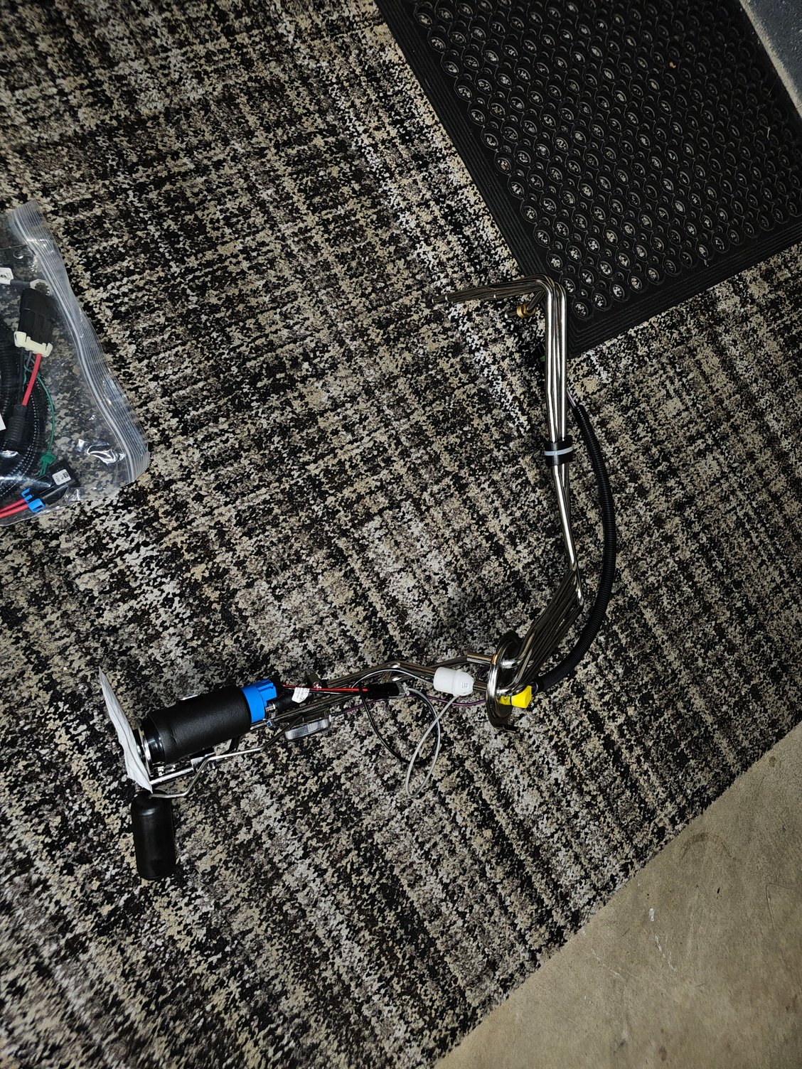

Racetronix fuel pump, sending unit and hotwire kit.
Racetronix pump. I remember when these used to be purple plastic.
Tank living in its new home. Undercoated the whole rear fuel tank area.
You need to run a 4th gen vented cap with the JEGS tank, but they dont tell you that online.

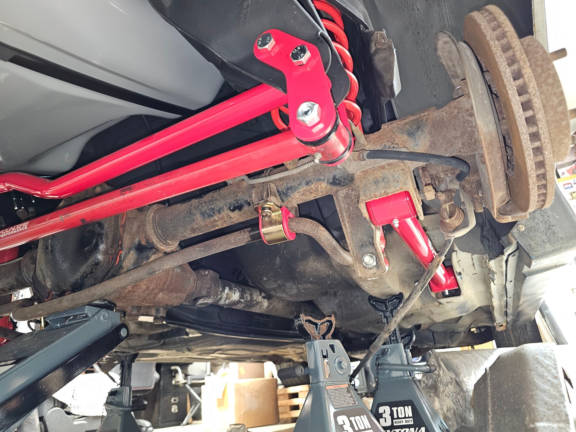

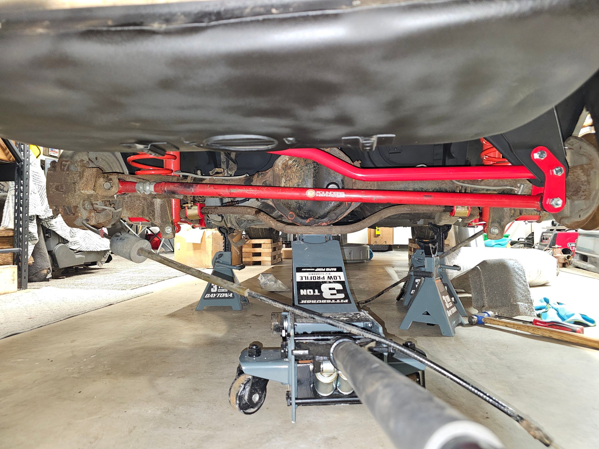

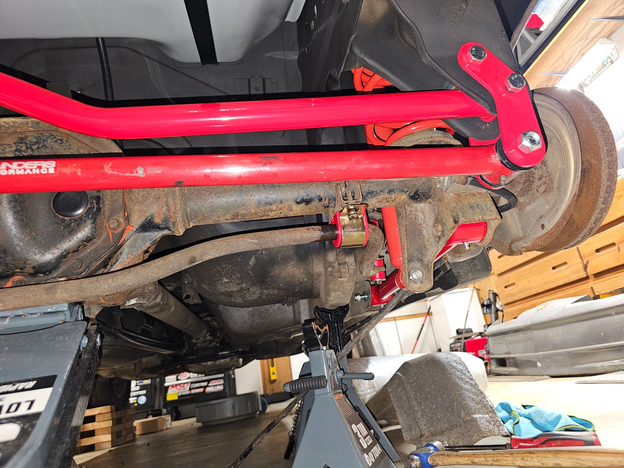

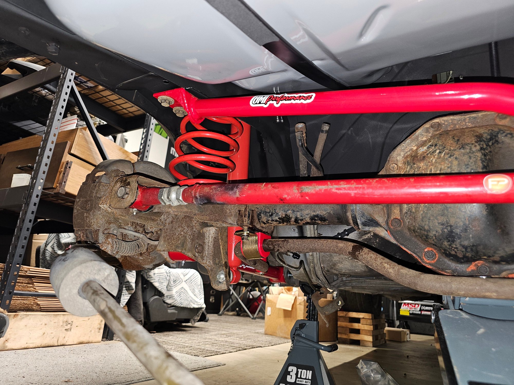

Founders adjustable panhard bar, UMI performance lower control arms, upper panhard bar, Eibach sportline springs, and energy suspension bushings on the stock rear sway bar.

Painted the subframe connector welding points with primer, engine enamel and a few coats of clear. Nice and protected.

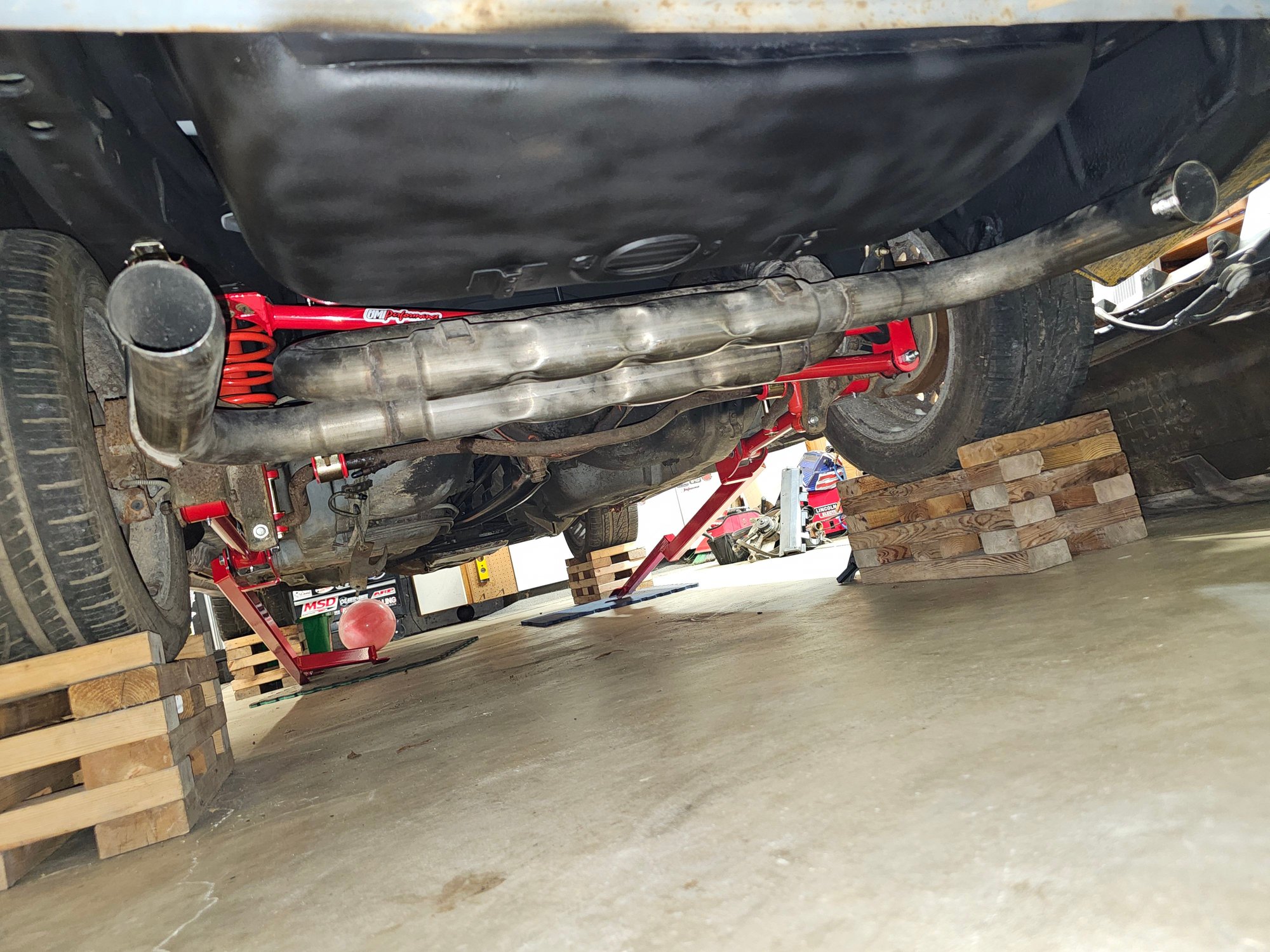

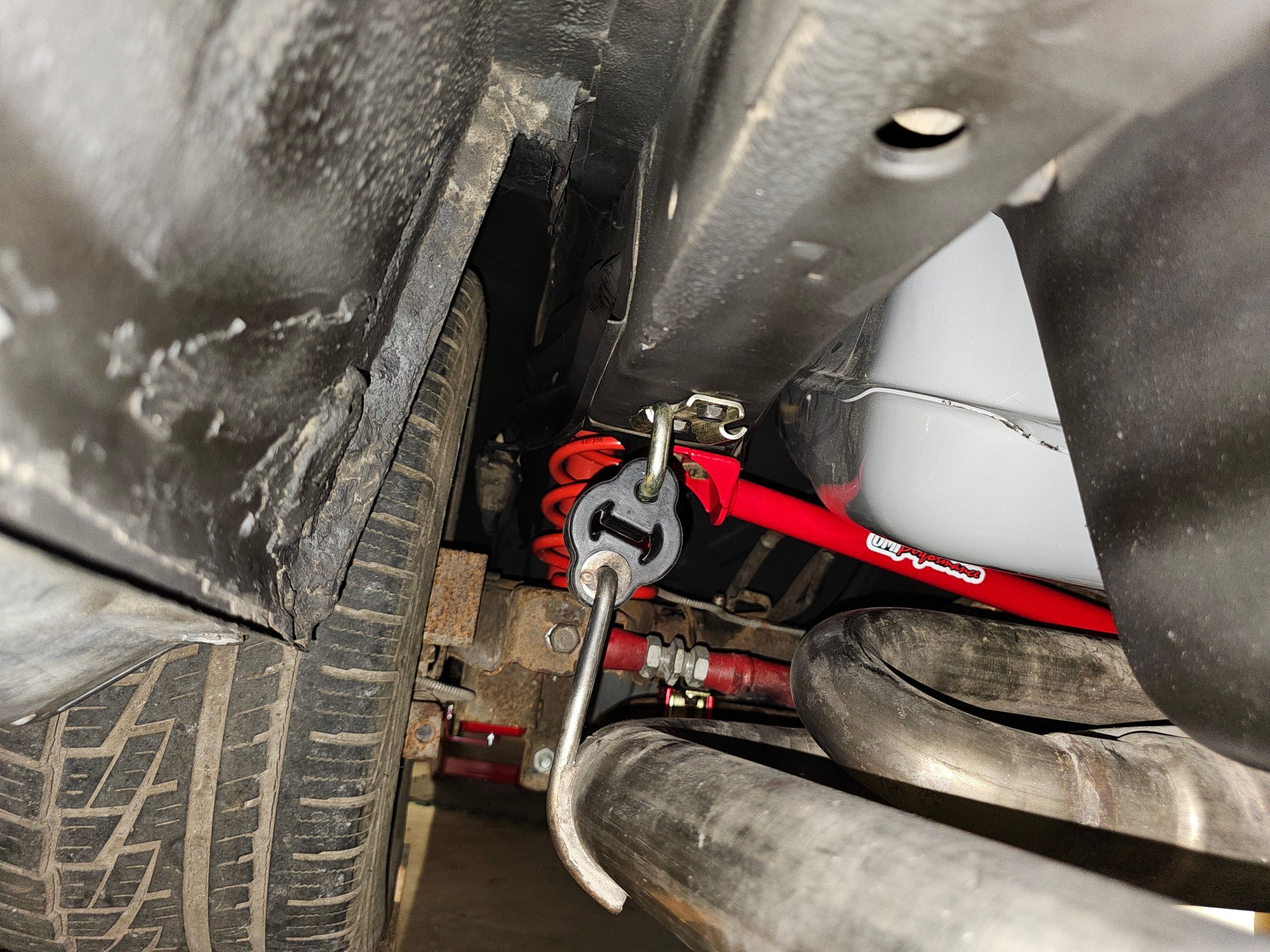

Got the GMMG muffler installed. I want to weld a collector right over the axle hump so that i can remove the exhaust easier in the future when messing with the fuel tank/pump and dropping the differential.
Obviously these photos are out of order because in these pictures the subframe connectors are not welded to the car yet. I'm still catching up on my photos.
4th gen exhaust hangers from Hawks.

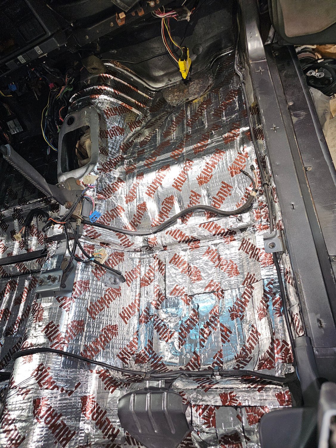

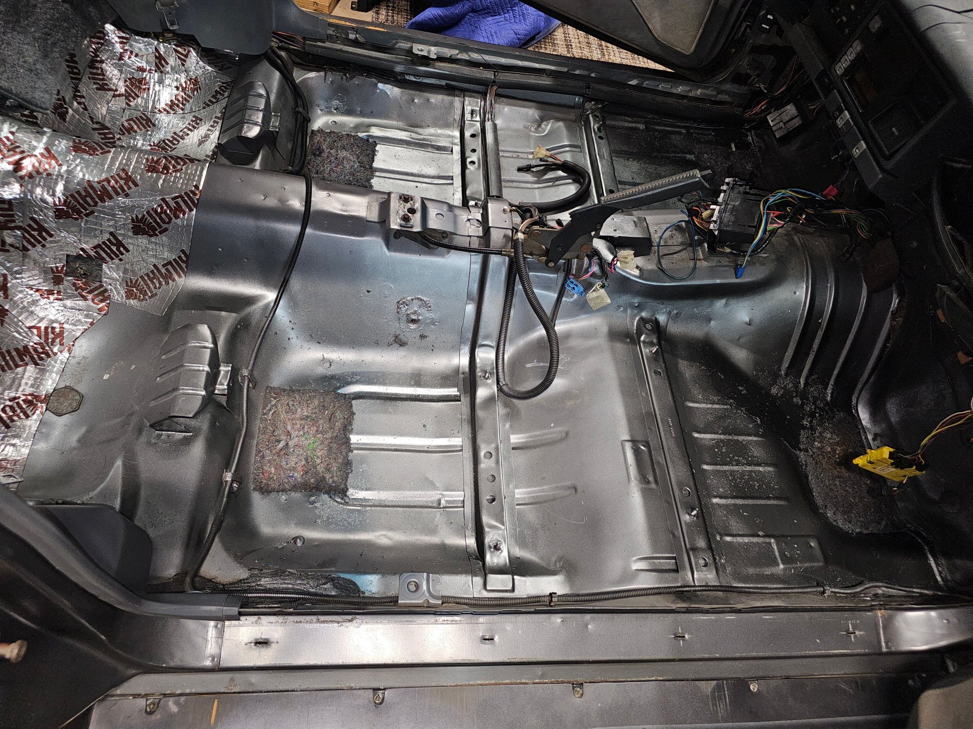

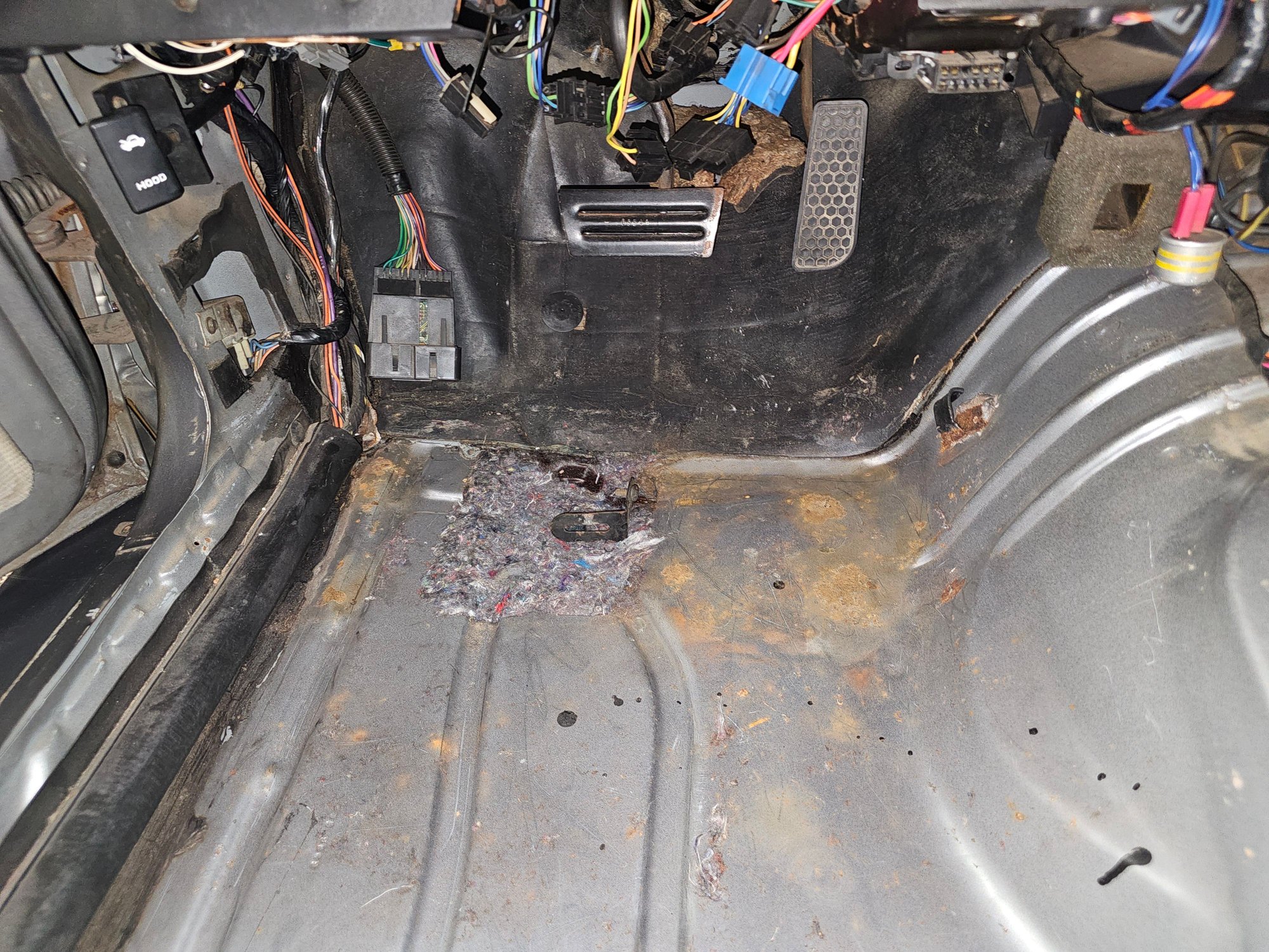

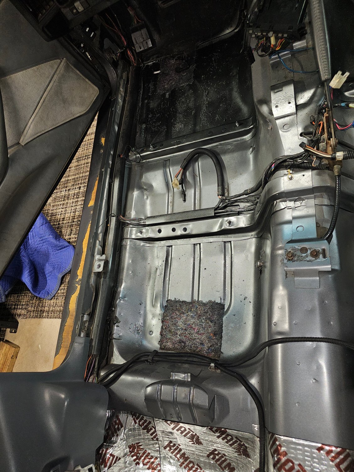

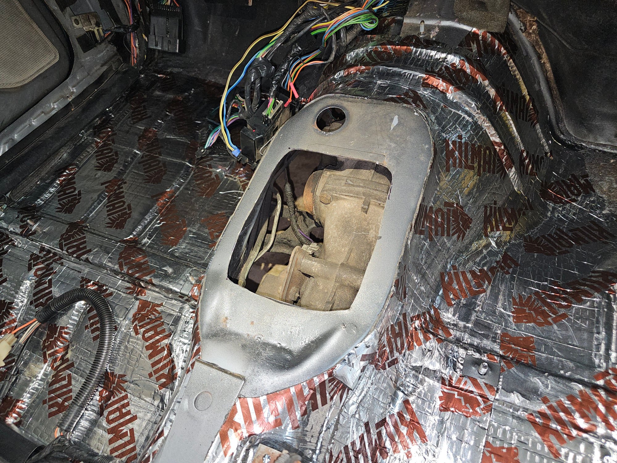

Switched gears this week and worked on cleaning up the floor pans, and get the sound deadening finished. For some reason my pictures won't upload properly.

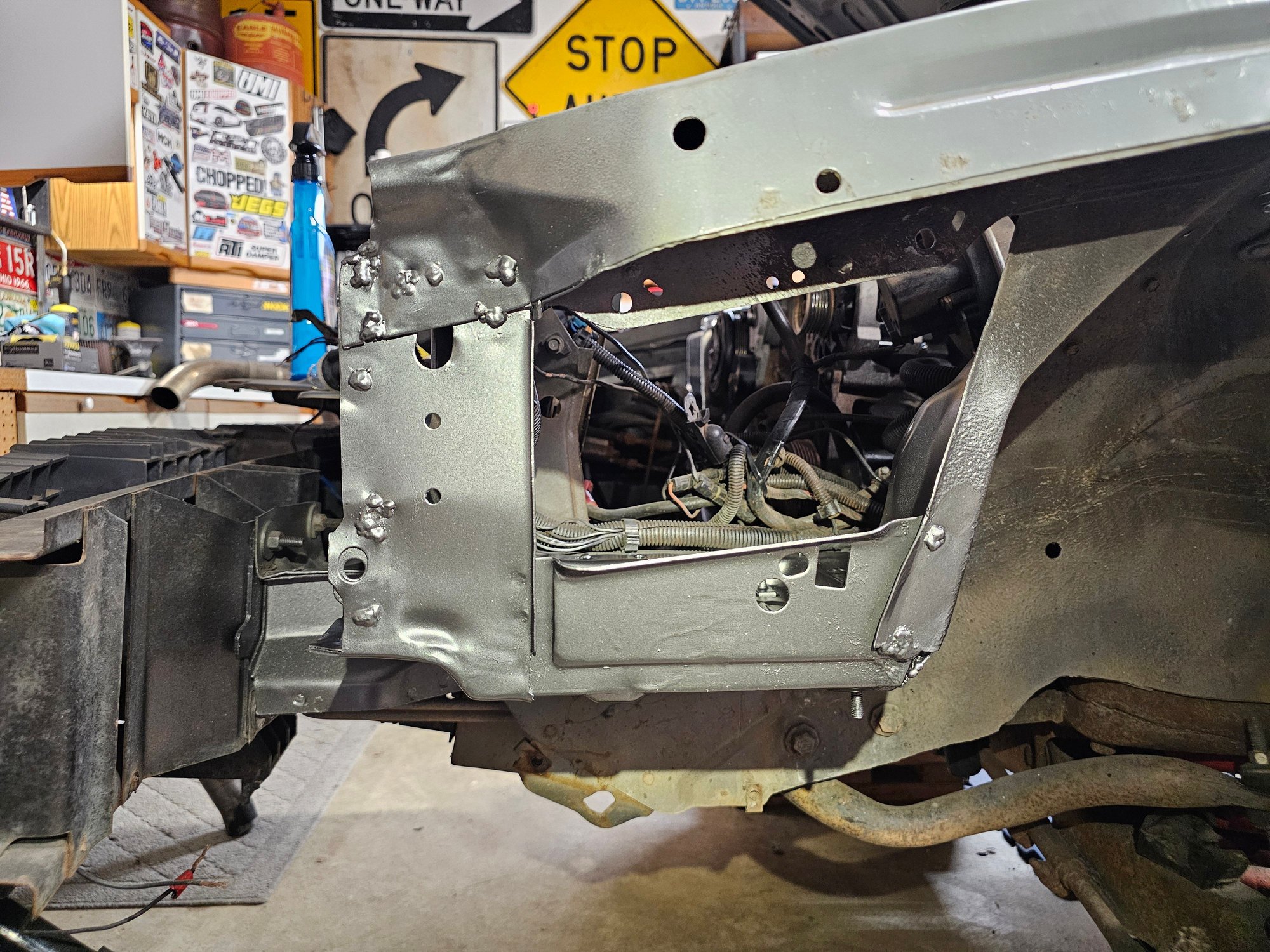

Small update, threw in a 3rdgenguy Firewall Master Cylinder brace. I also have his brace for the Clutch hydraulics. I'm gonna pull the motor first so that I can reseal the Oil Pan, front timing cover, and rear main seal as part of my T5 conversion. hoping to wheel the car into the barn this weekend and get the motor yanked out.

Measure out and cut my trans tunnel for the manual swap. Came out pretty nice. The older I get the more patience I have for doing things right.

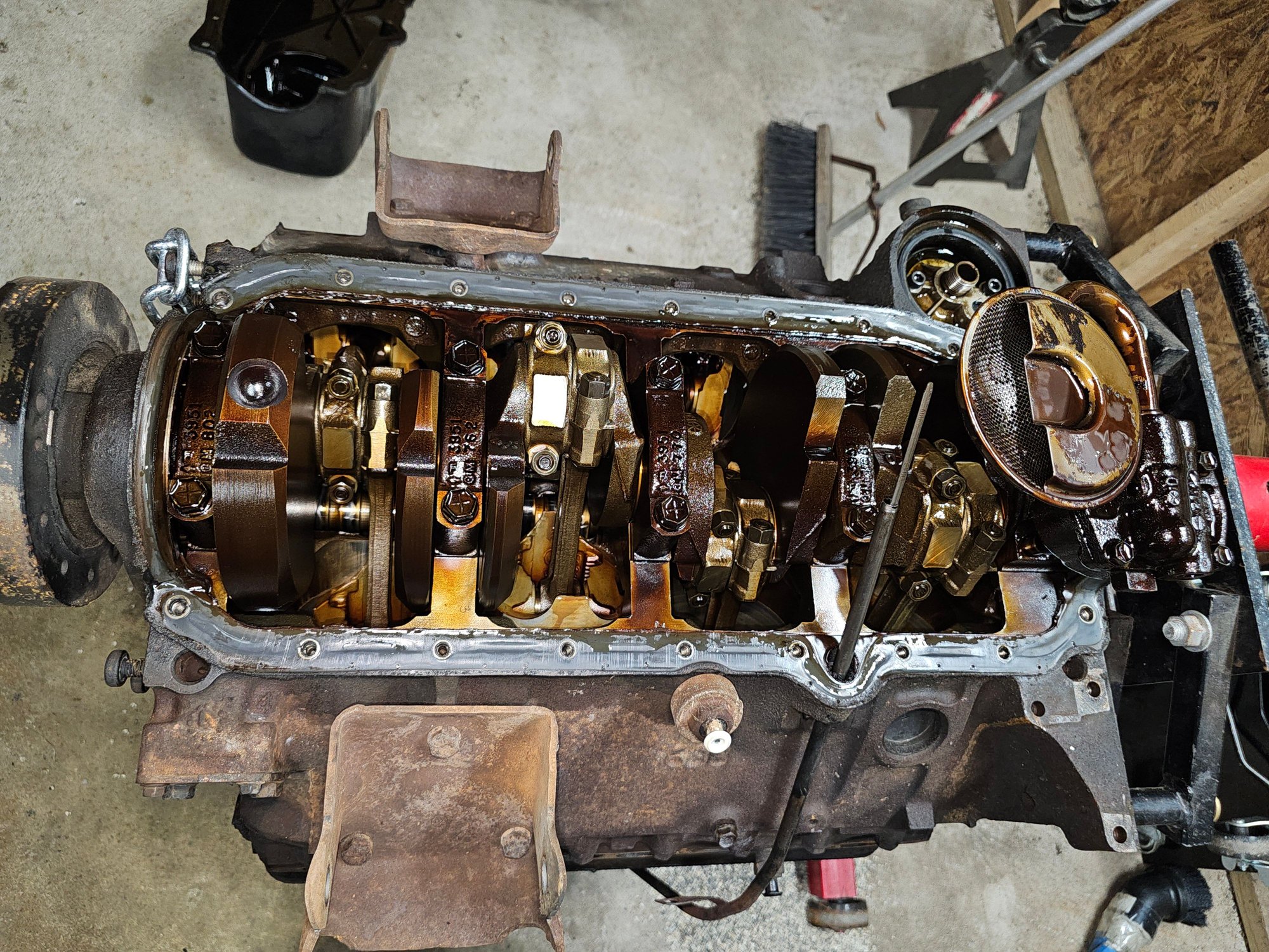

Hit a bit of a roadblock. I have 2 broken pistons skirts sitting in the bottom of my oil pan. Now I need to decide what route I want to take. Tear the motor down and rebuild, or send it and go full ls swap. Neither is in my budget, but if I had to build a motor, it wouldn't be a sbc. I can't tell if the pistons themselves are cracked, or if its the rings. So either way I need to tear it down.
Cylinder 5
Cylinder 6
Cylinder 6
Cylinder 5
Chunks in the oil pan
