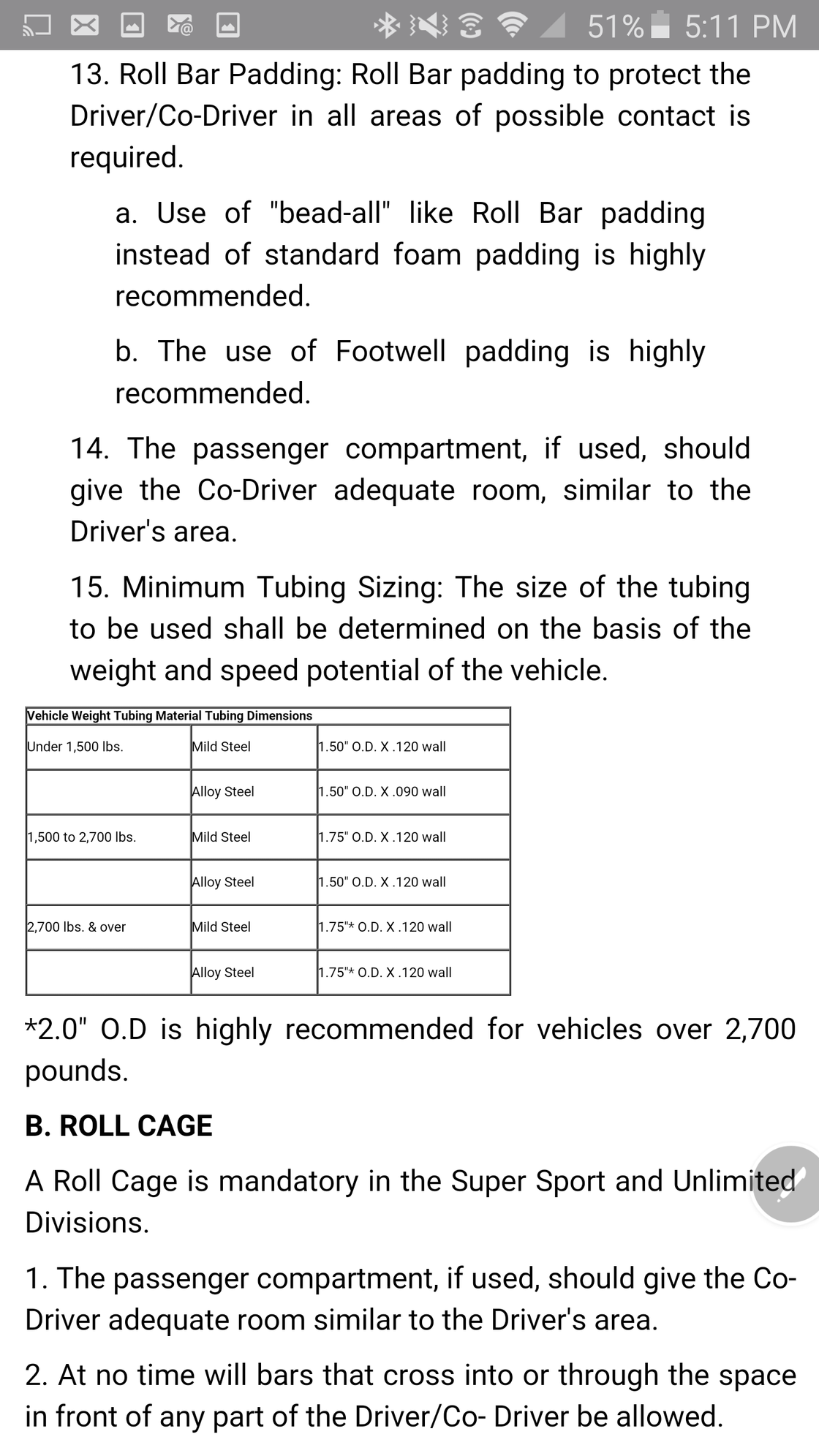

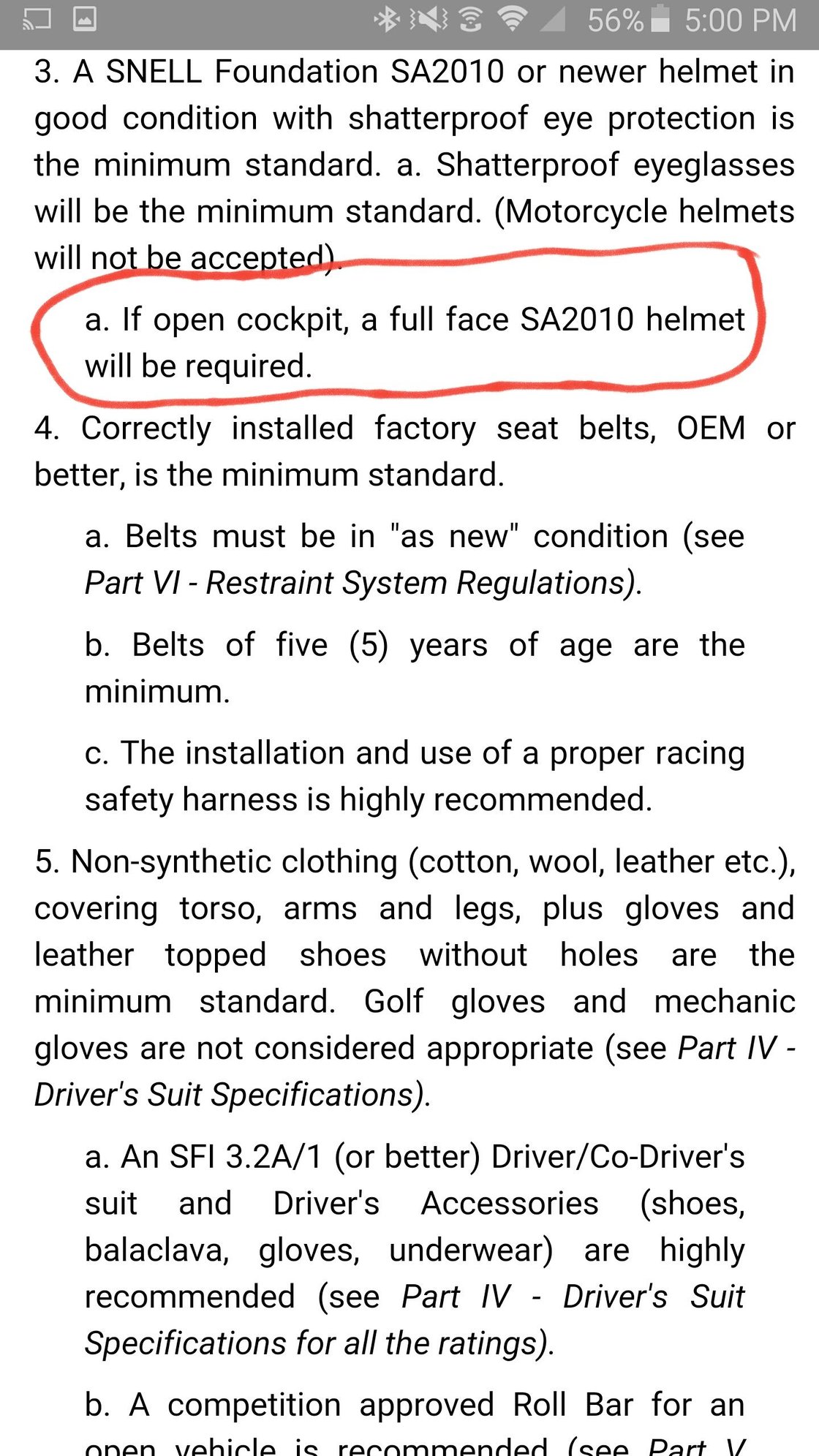

These were some of the tech aspects I was reading when I decided to post a thread to see if anyone else has done an ORR.
I think all of this stuff is very reasonable and not hard to do in preparation. With the goal being to have fun why skimp on prep and have an issue on the road even if I am running only 124mph (SR2) or 112mph (SR1). I guess for me after reading thru all the regulations I just wanted to know had anyone with a 3rd gen F-body run an ORR. If so I want to know their experience and fbody specific issues to be aware of.

Wasn't even thinking about seat belt or fire extinguisher . Yeah, new seat belts, new tires, good shocks /struts, good breaks & roll bar . ..
